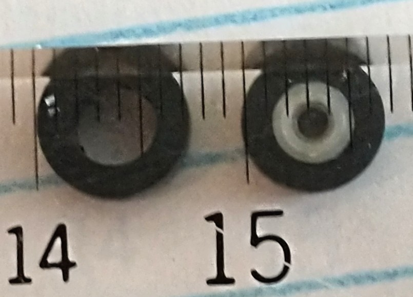

    I recently ordered 7mm pinch rollers, for Aiwa 2ME-7 mechanisms (J09, J360, J10 etc.) from:
    https://www.ebay.com/itm/234003385653
    The rollers they sent are 6.5mm. The diameter of pinch rollers is critical. Too large and they rub on things and are engaged when they shouldn't be. Too small and they don't exert enough pressure.
    I reported the problem to the seller. They asked for the device name and a photo. Then they said the photo wasn't sharp enough. I sent nother photo. (Below, original roller rubber is on the right.) Now they say my original roller is 7.4mm. I won't buy from them again.
    When ordering you also need to match the axle diameter.

    I just checked the carrier for the roller and it is spring mounted. Pressure for the roller against the capstan is a function of that spring, not the roller diameter. So it can accommodate a (small) range of roller diameter. 6.5mm vs 7mm probably is ok.
    Since the 6.5mm rollers have a smaller core but thicker rubber that the OEM 7mm rollers, I swapped the rubber from the 6.5mm rollers onto the cores for the 7mm rollers and ended up with 7.2mm pinch rollers. They seem to work fine.
