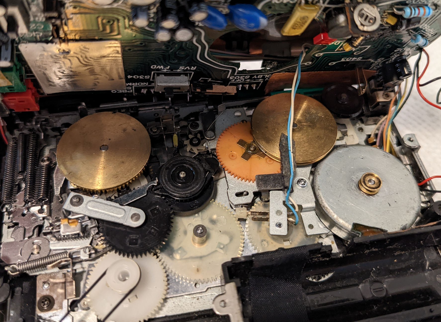

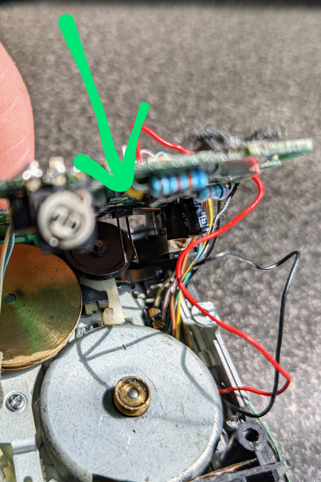

  8. walkmanoob
    walkmanoob New Member
    20
    Third update replying to myself just in case it is helpful for someone else in the future.
    It turns out that two little metal plates were touching each other the whole time when they shouldn't. I think they are supposed to make contact only when they white plastic arm underneath moves (whatever that mechanism is).
    Can somebody let me know about the idler? I will be ordering one soon. I think I have to remove a ring from the front but I don't know how and I don't want to break anything. Any suggestions would be appreciated!

  9. stuck-in-time
    394
    Jakarta, Indonesia
    Yes, those are the symptoms of the idler needing replacement.
    To remove the capstan, you need to remove the washer ring from the front. The unit does not have to be disassembled. But do be careful, the washers are tiny and they tend to fly out and disappear, which is very annoying.
    The idler and gear assembly is also held in place in a similar manner, but from the backside.
    The casptan is a metal rod and it has a groove where the locking washer sits. The washer is a thin flexible ring shaped like an O, but with a slit on 1 side (like a closed C). This allows it to open up to be removed from/attached to the capstan. Don't lose it!
    Don't forget to take pictures before disassembly so you know which part goes where.
