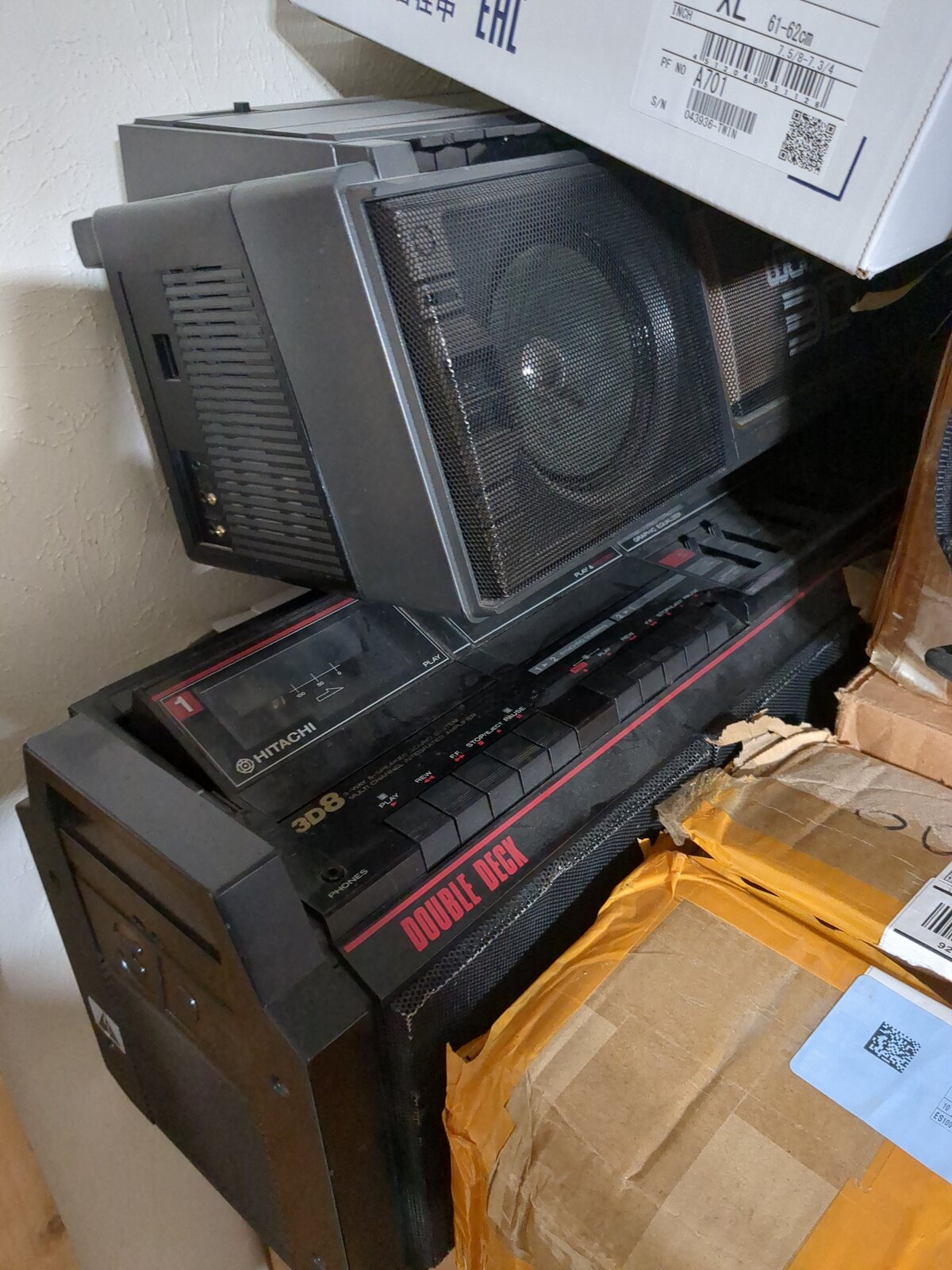

  7. Cassette2go
    1,563
    I have a Hitachi 3d8. I'm not digging it out but here it is. 17186499607341211928985080195287.jpg
