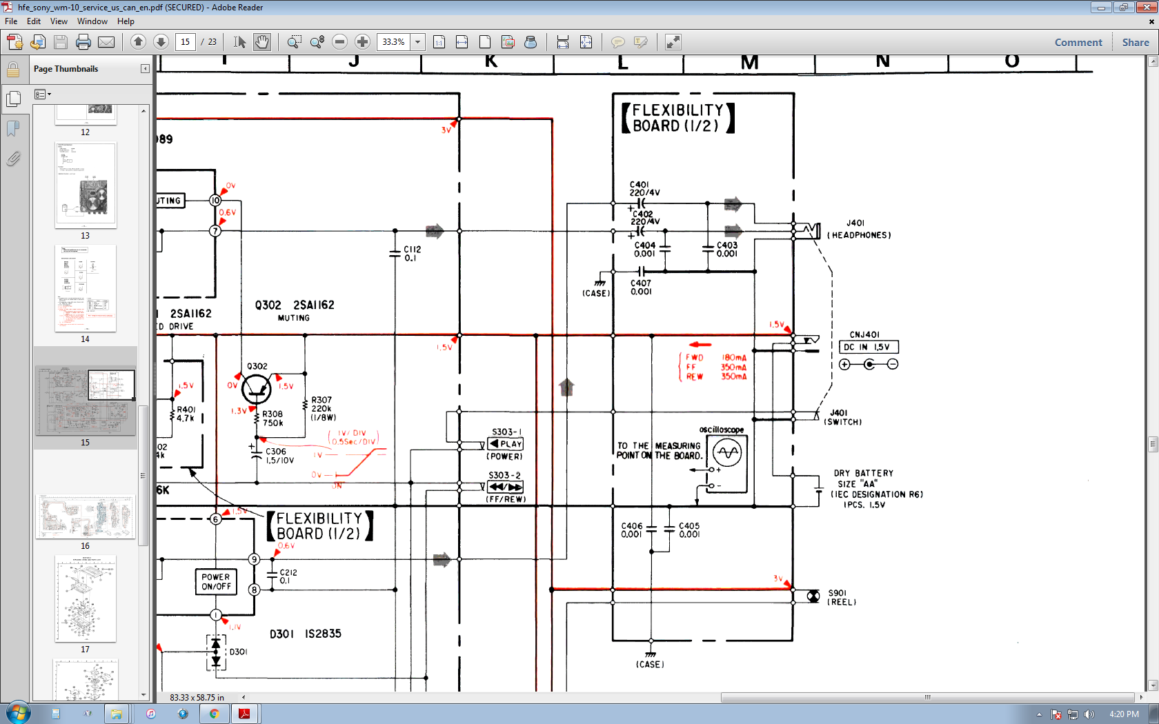

    If you check WM-10 schematics you will see that the case is used to connect h/p to the common Ground. Make sure that the points where screws, board and metal case are joined for the common ground are not oxidized. Re-flow the solder at the h/p jack, actually start here.

    Stripped the unit down and cleaned the ground points with contact cleaner. I don’t believe that there is any improvement from the motor noise. It’s worse with sensitive headphones (which require lower volumes of course).
