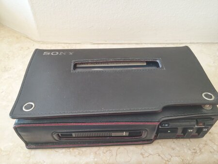

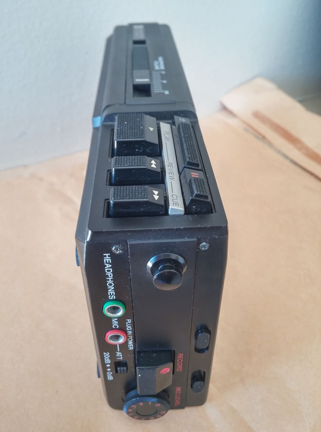

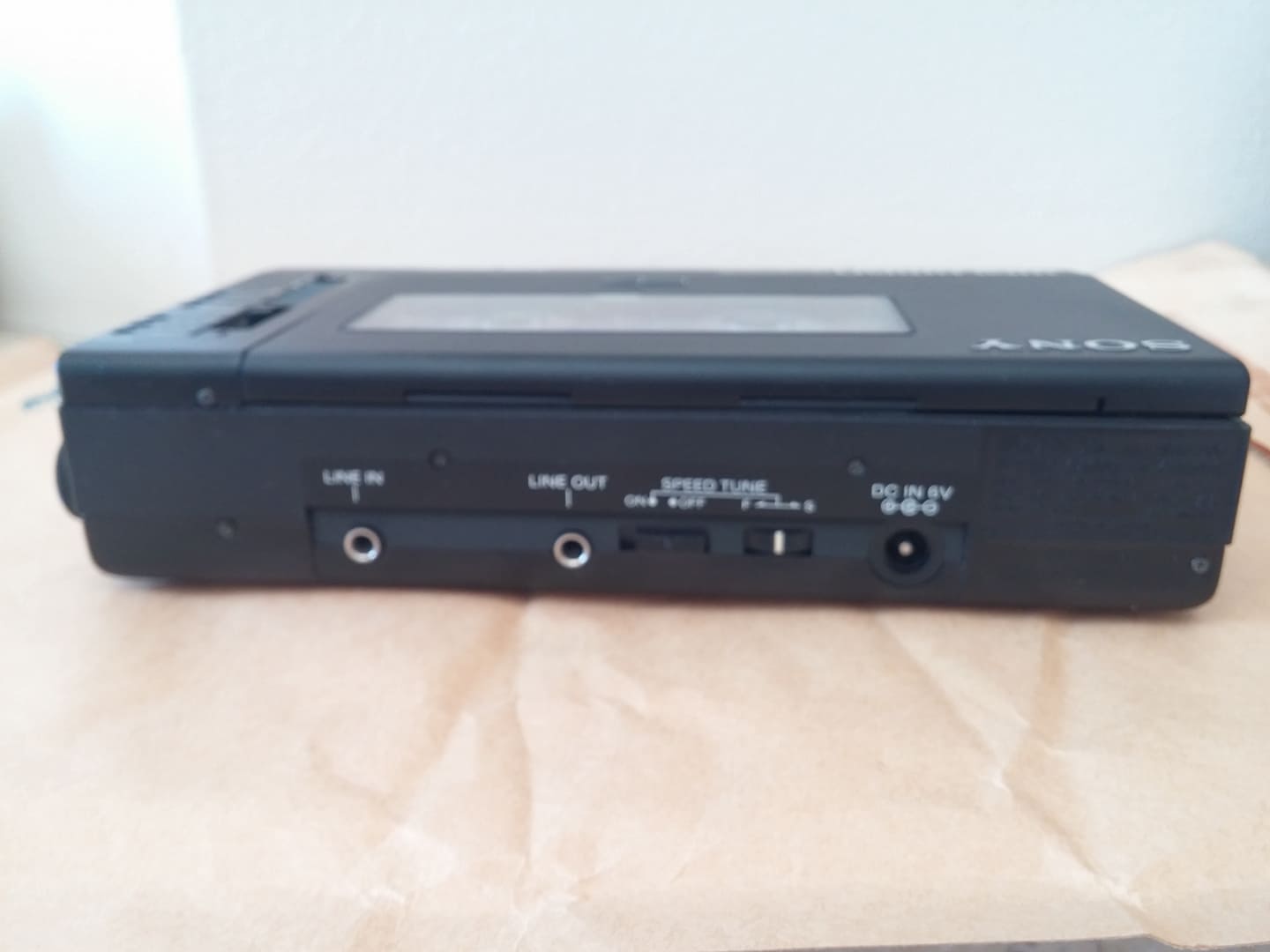

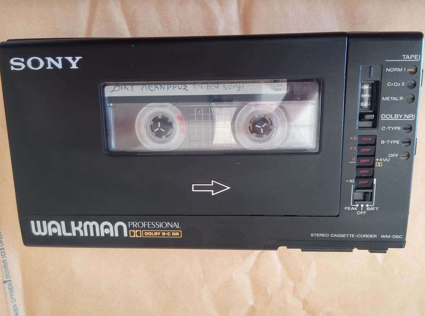

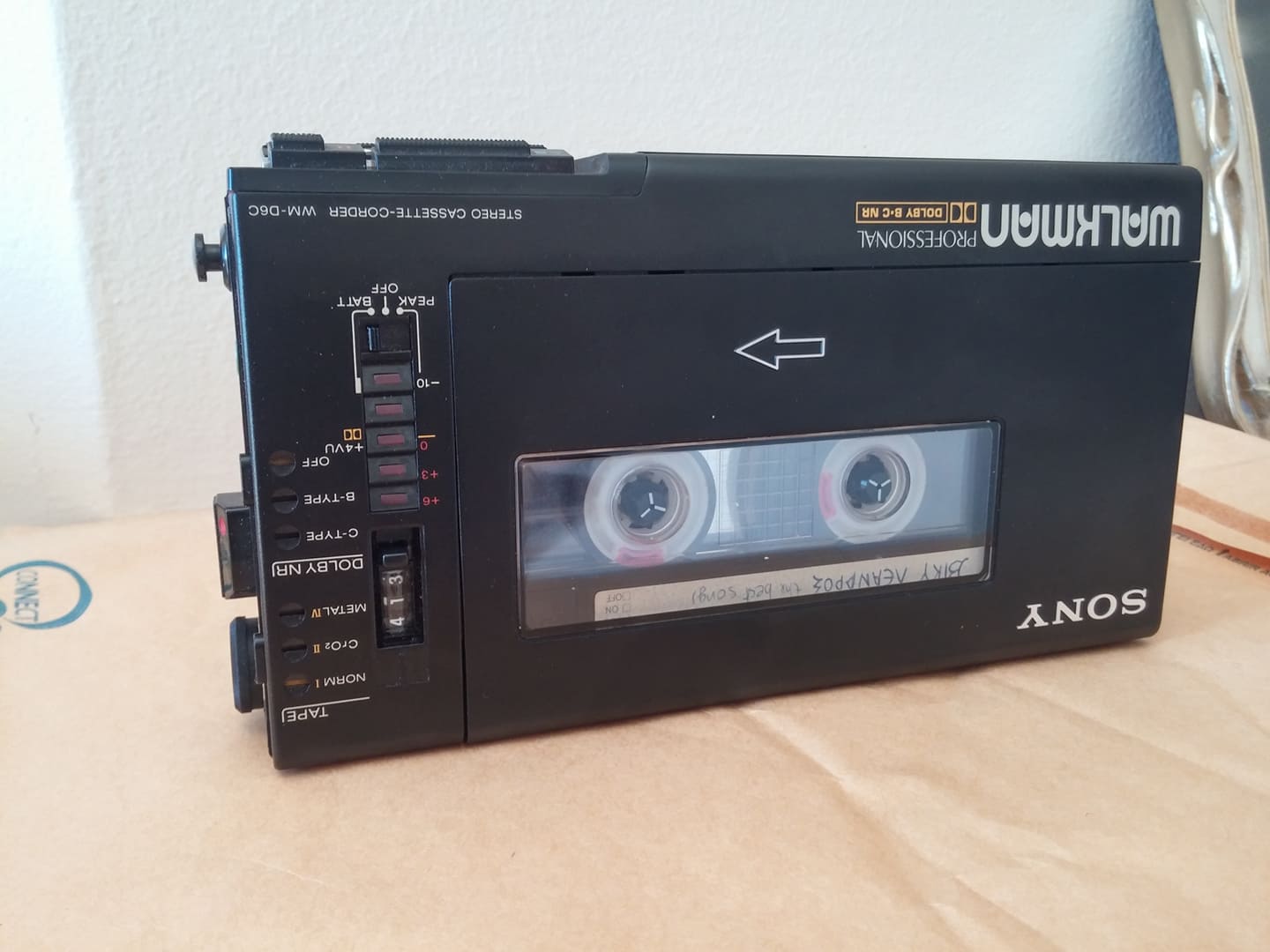

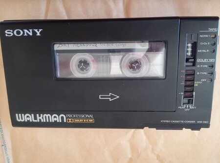

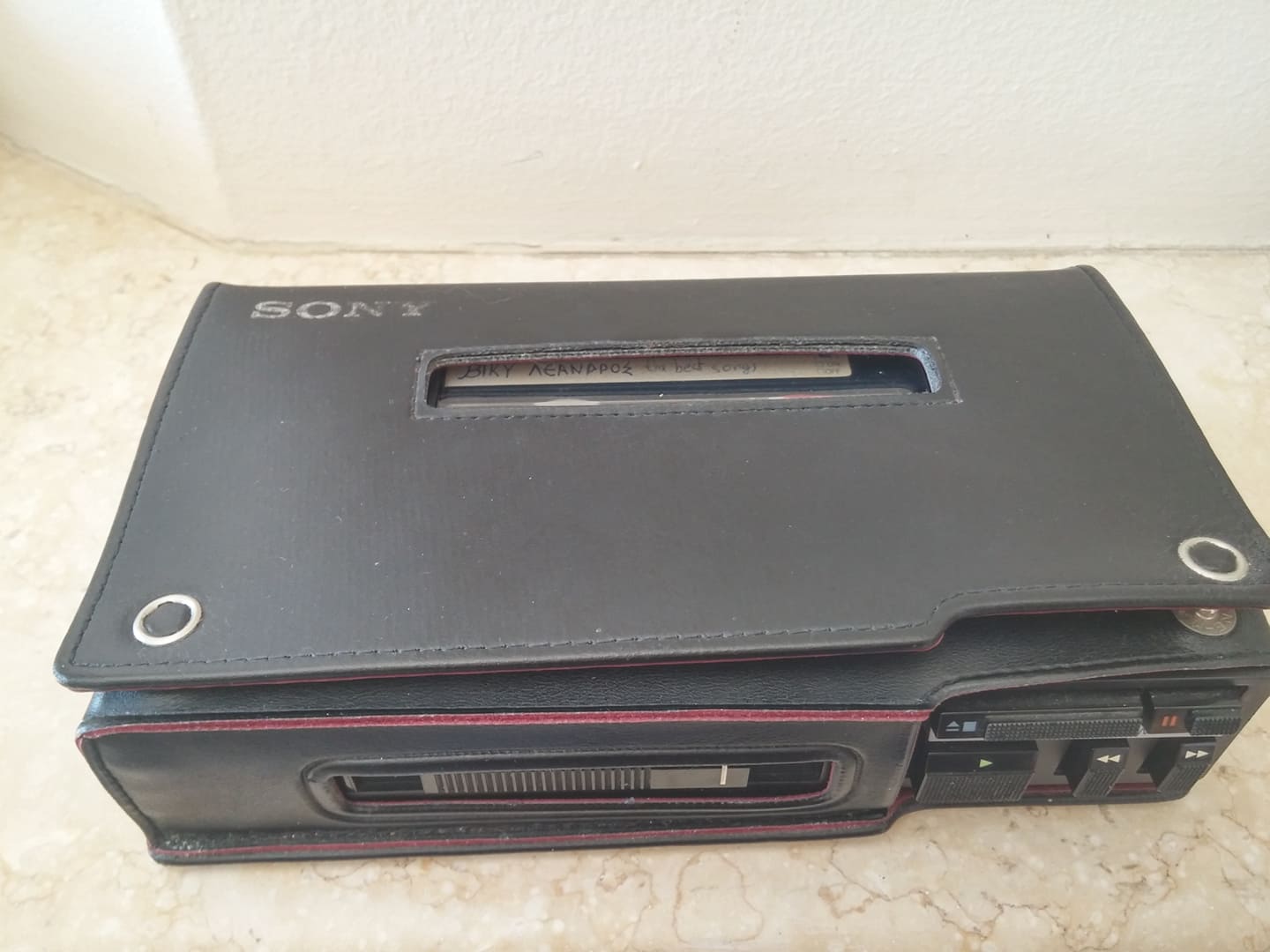

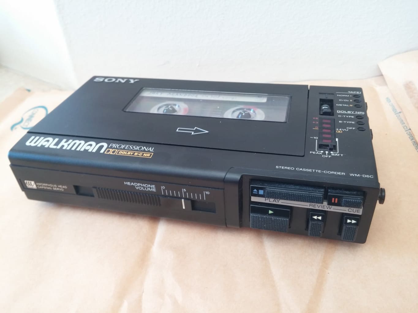

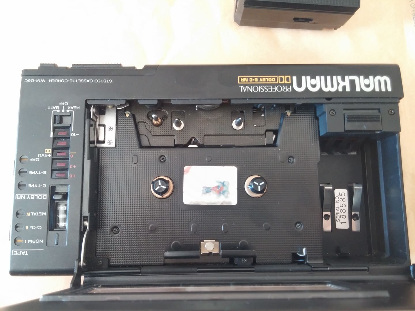

    I was very lucky to be able to find a perfect D6C,for a very reasonable price,in my country (185e total)
    I happily present you some pictures of it,taken with my crappy 12y old phone.

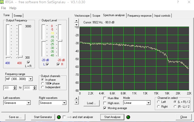

    And a white noise test to determine frequency response. An approximate measurement.
    The sound is amazing...The unit does not have a scratch or mark on it at all...its literately like new.
    And here are the pictures!!
    278825335_1056269978304297_1529483845722690150_n.jpg 278574654_712813623476830_7320433776597993145_n.jpg 278653038_697789481428961_1306186577354243703_n.jpg 278690699_348765750553755_5765060520719378041_n.jpg 278698952_519409483185377_3434843502437888257_n.jpg 278762123_966983690631929_2604693519497600254_n.jpg My D6C White noice FR responce..jpeg 278670099_358080646339874_2945791113142355687_n.jpg 278917881_382911487078795_6809728975129643206_n.jpg

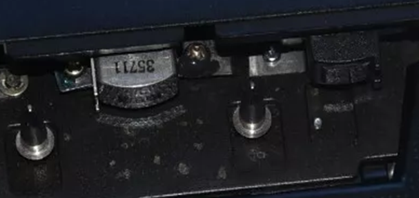

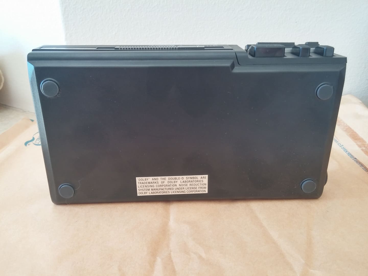

    Something interesting with your D6C is the 6 digit serial number would suggests its a second revision of the D6C with the brown "through the hole" PCB. That's good but most of these have the black Dolby sticker with white text affixed to the rear panel. Yours has the silver sticker with black text as you find on 5 digit SN "pointy head" units. That sticker is identical to mine and placed in same location as my D6C with serial number below 40,000 and V shaped head. Does the head have "35711" printed in black on its upper surface?
    woofaki and Emiel like this.
  9. woofaki
    woofaki Member
    Greece
    Yes its a 35711 head.

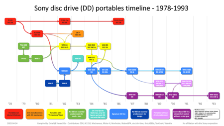

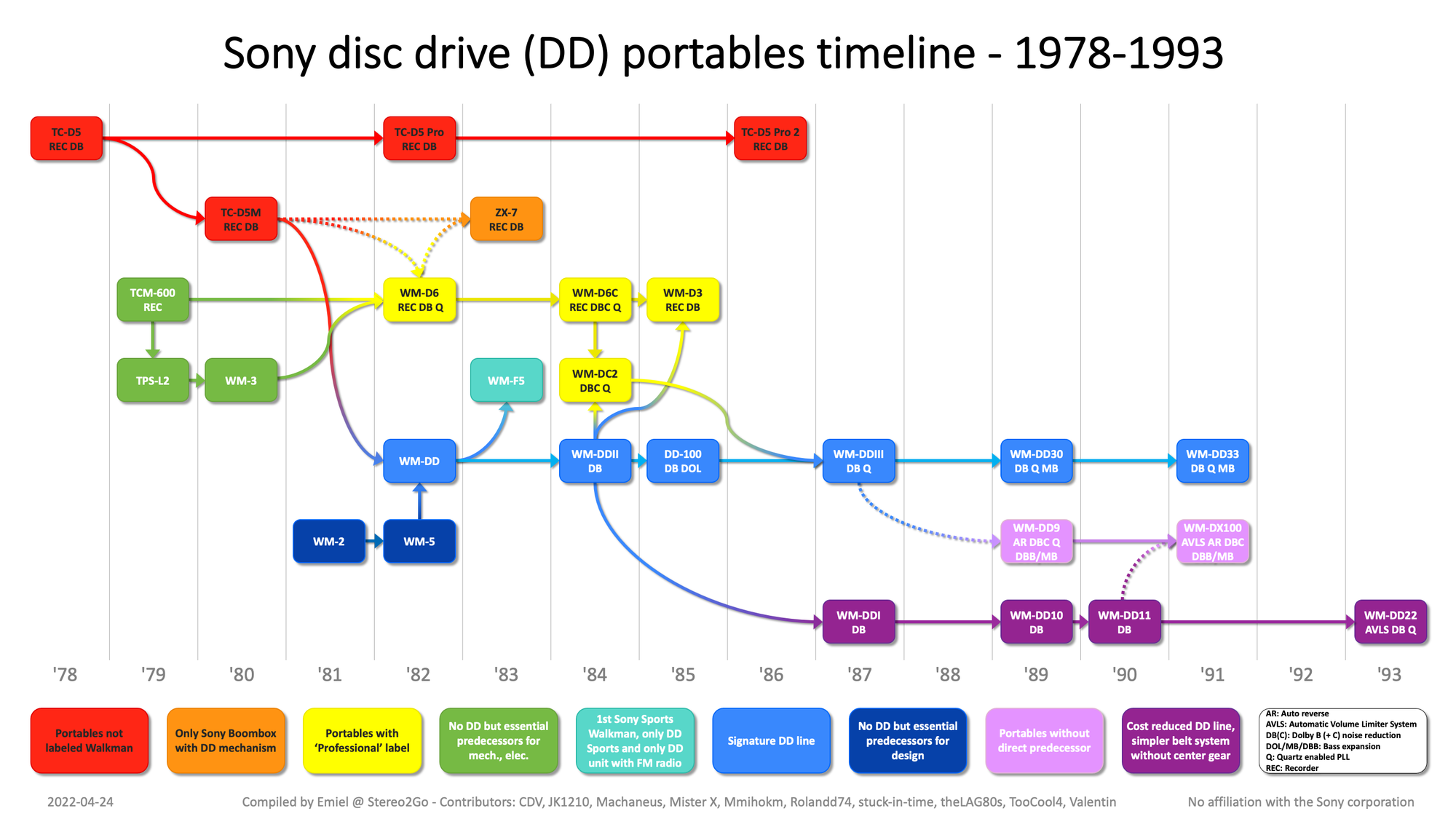

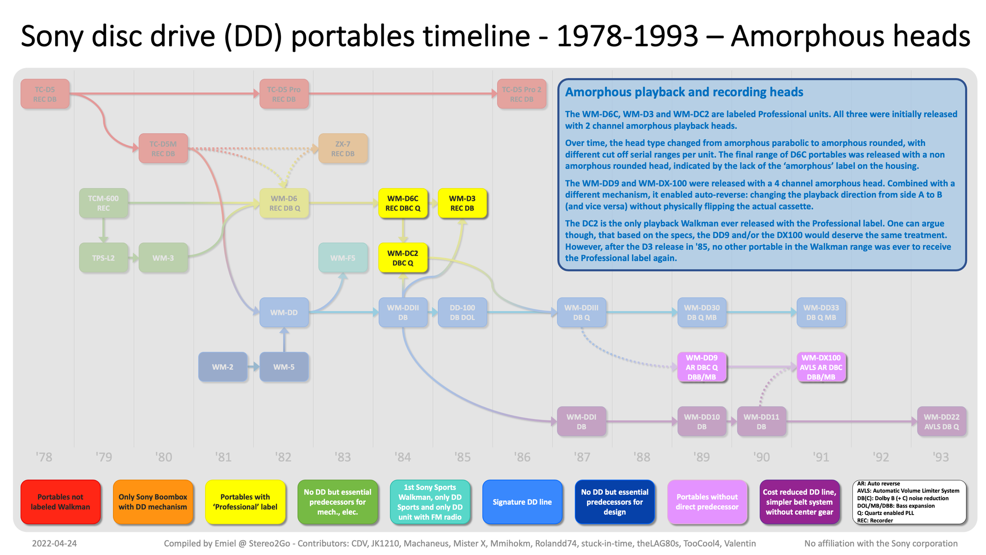

  12. Emiel
    1,001

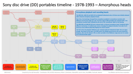

    I wanted to capture some of these essential in an animated version of the DD timeline I created, but I first focused on getting the timeline complete enough.
    As an example, here is the timeline and the amorphous head highlight:
    woofaki and Valentin like this.

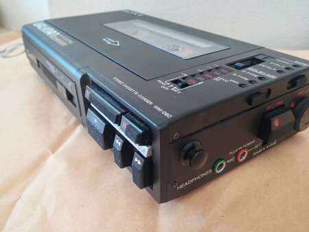

  13. Emiel
    1,001
    Can you post a picture of the front, the volume slider side?
  14. woofaki
    woofaki Member
    Greece
    I have it packed already to be sent but i think i do have one picture that i took before i do.I will add it up in the 1st post.

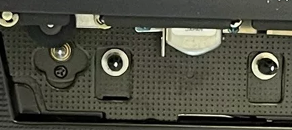

    "I would like to know when the V shaped head was replaced with the "32711" head by serial number. "
    Good question. What I have found so far is that serial #71236 had the "pointy" head and serial #72265 had the rounded 35711 head. Exactly where the transition was I don't know.

    That's what we all want to know. Whilst it's clear that any D6C with a 6 digit SN did not have the pointy amorphous head I have anecdotal evidence that a SN in the 90,000's did have the V shaped head. I'm inclined to think may be the owner was mistaken. Unless the head was marked "Japan" and had the distinctive V shape. Unless we can get documents from Sony listing the manufacturers specifications by SN and date built we are never going to know for sure.

    Here's the pic I had of serial # 53613: ('pointy"
    And #72265: (rounded 35711)
