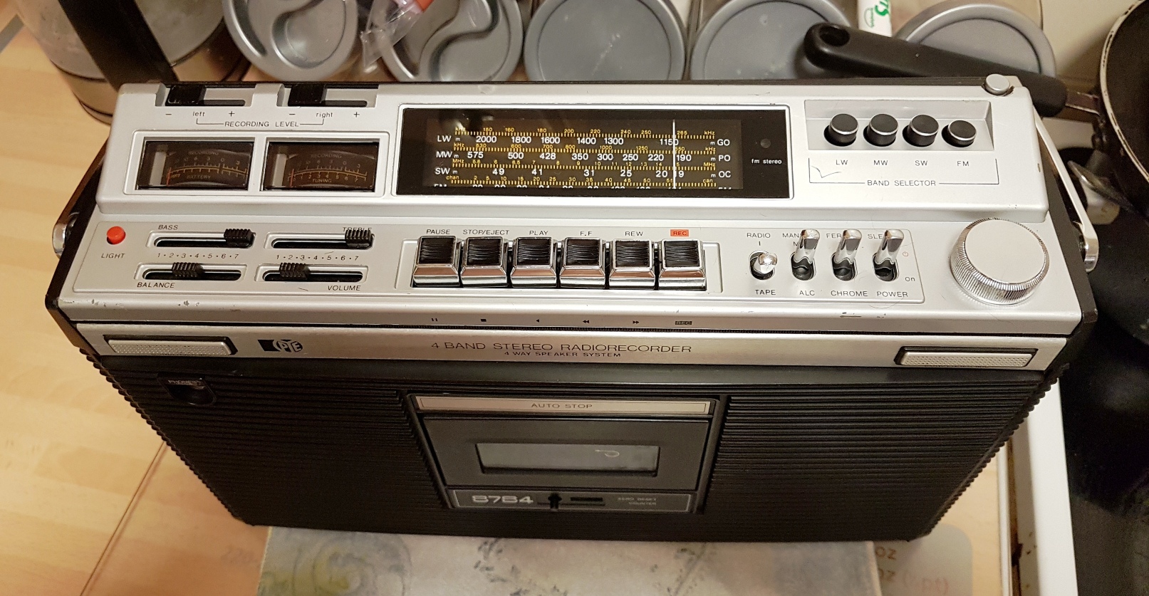

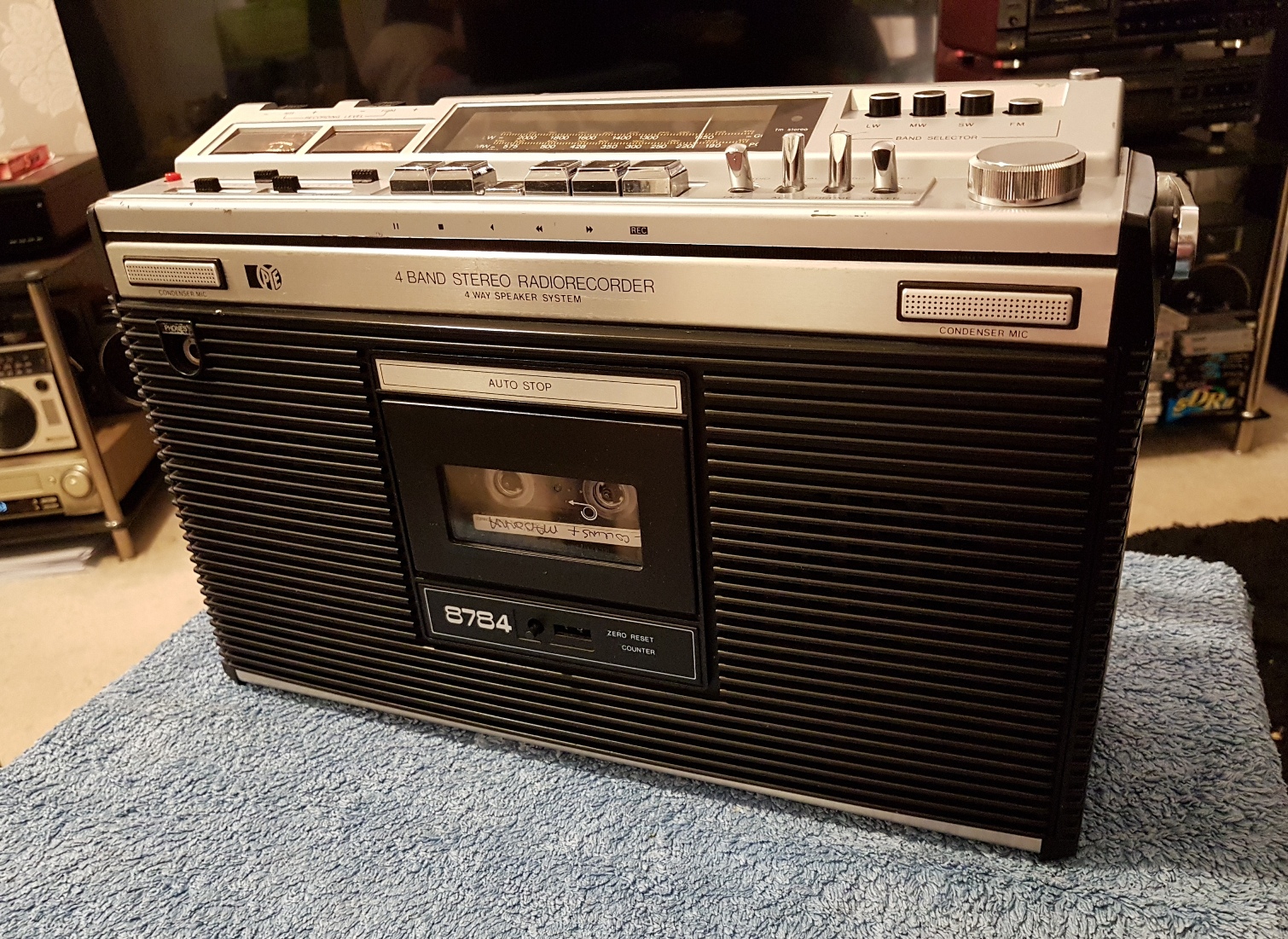

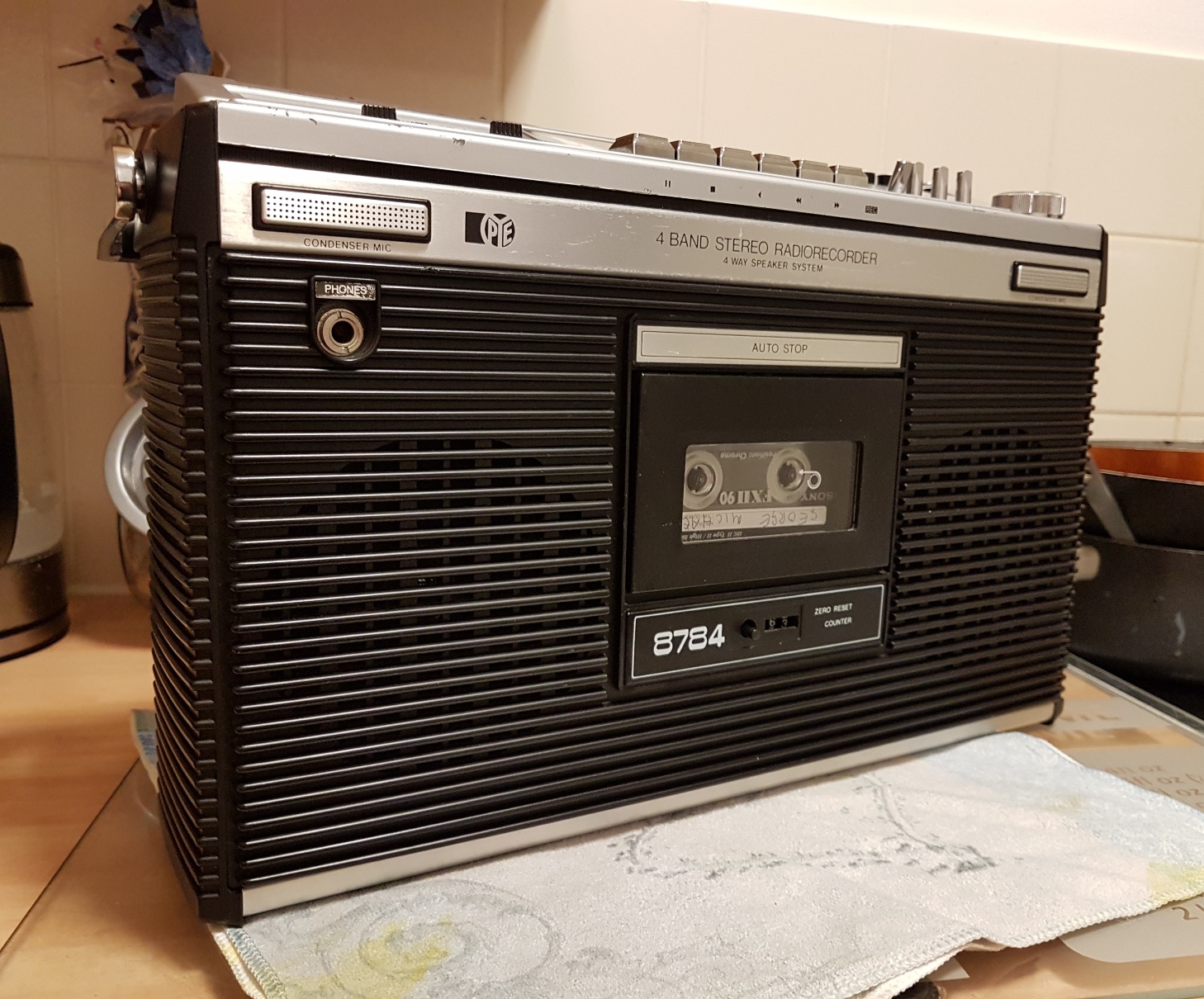

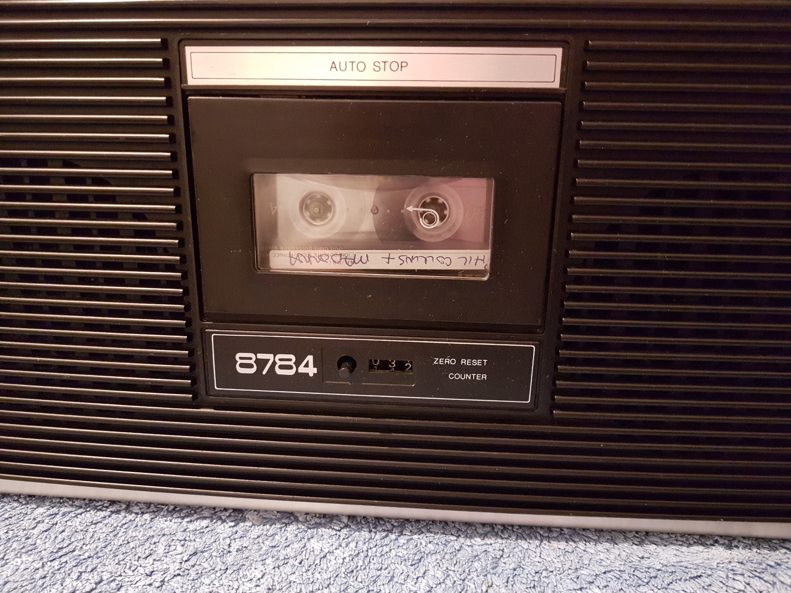

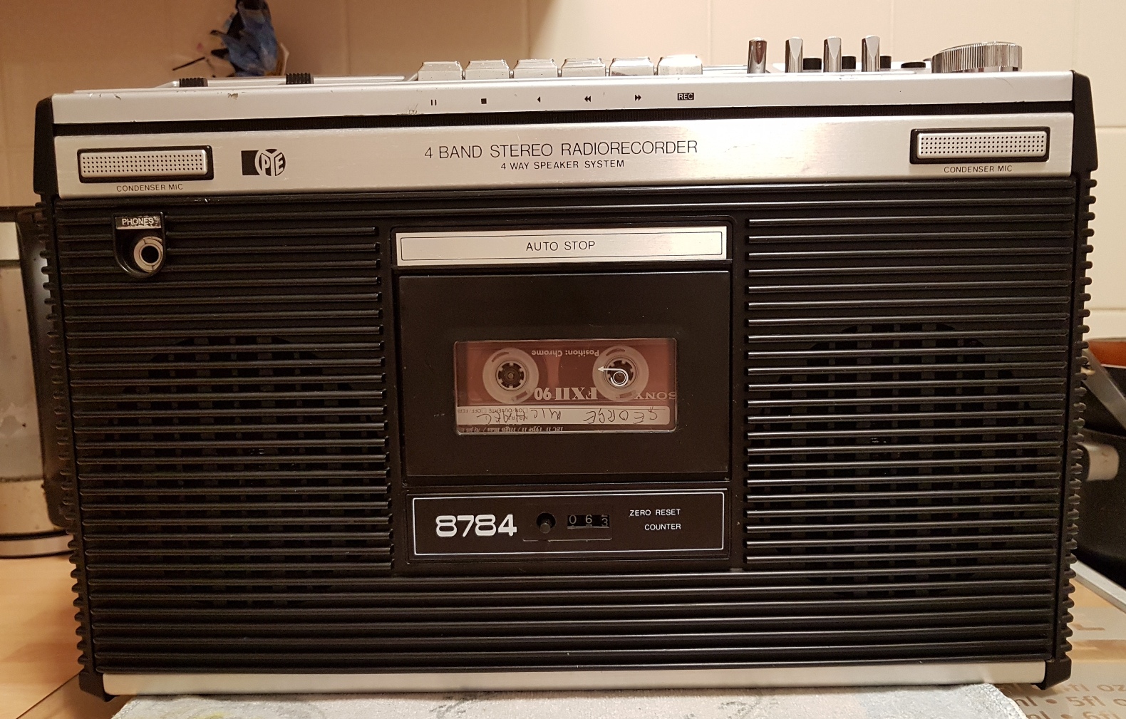

    So people I'm back with a somewhat unusual machine this time.........

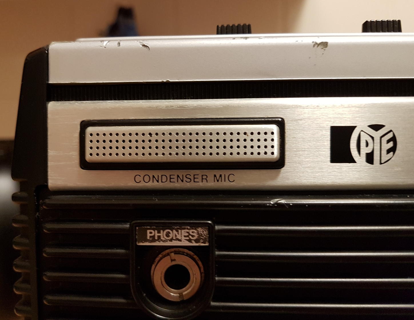

    I have seen what I believe are similar versions or AKA's of this type of machine over the years but never one sporting the Pye or Philips badge until now [​IMG]

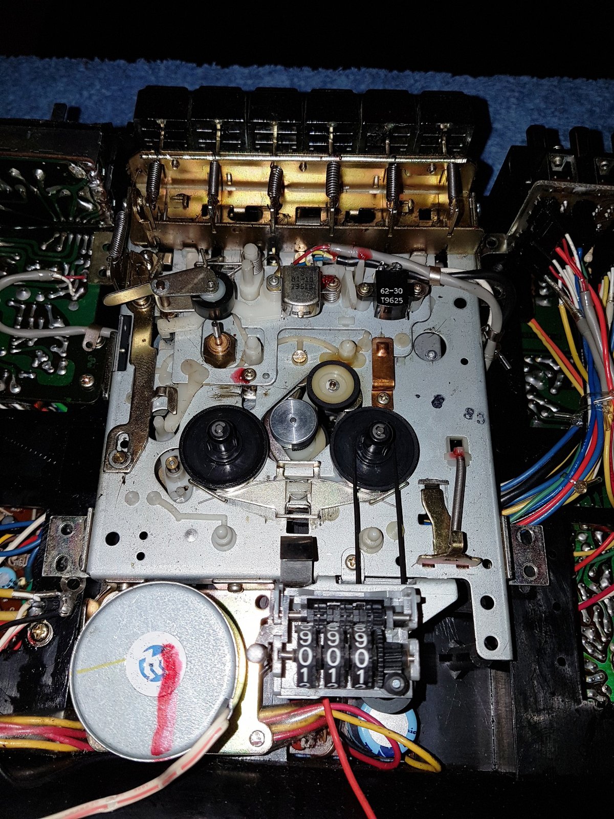

    The princely sum of £17 was accepted by the seller & just a day & a half later, this little guy arrived much to my delight - Reassuringly heavy affirmed my initial thoughts that this is a really solidly built stereo & very nicely finished too!!

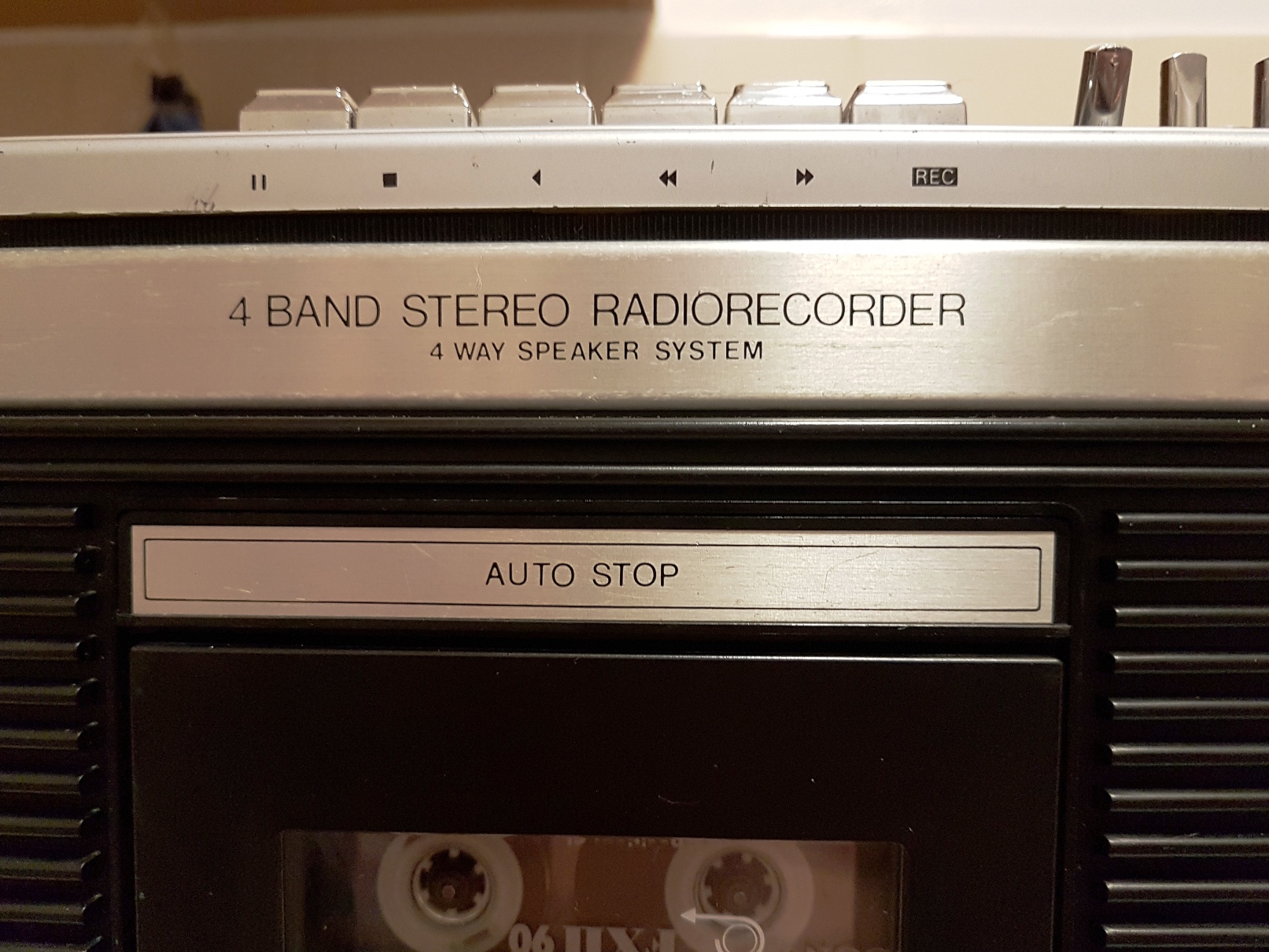

    I would date this baby around 1976, it uses the same cassette mechanism used in the Bush/Arena/Rank Organisation cassette decks of the same era - strong pressed steel chassis with very long lasting components needing belt changes throughout it's life to keep it running reliably!! The mains operated decks in the UK used a synchronous motor locked to the 50Hz mains frequency to maintain accurate speed control - This guise of the same deck uses a much nicer arrangement, a DC motor with a servo & electronic speed adjuster in the motor underside & definitely a better arrangement all round!

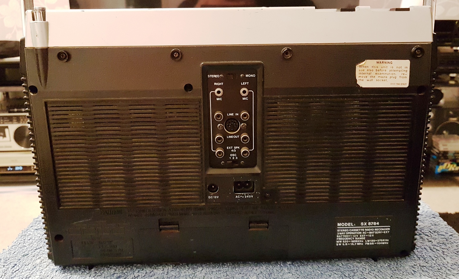

    Now there is nowhere on the stereo proclaiming where it was made but I think we can safely assume Japan or Korea as that was where the Bush/Arena decks originated from & badged for the UK [​IMG]

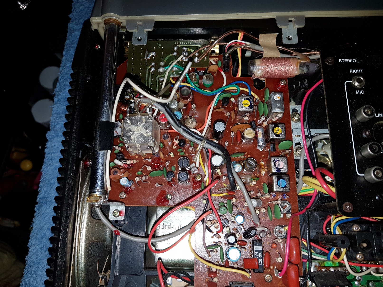

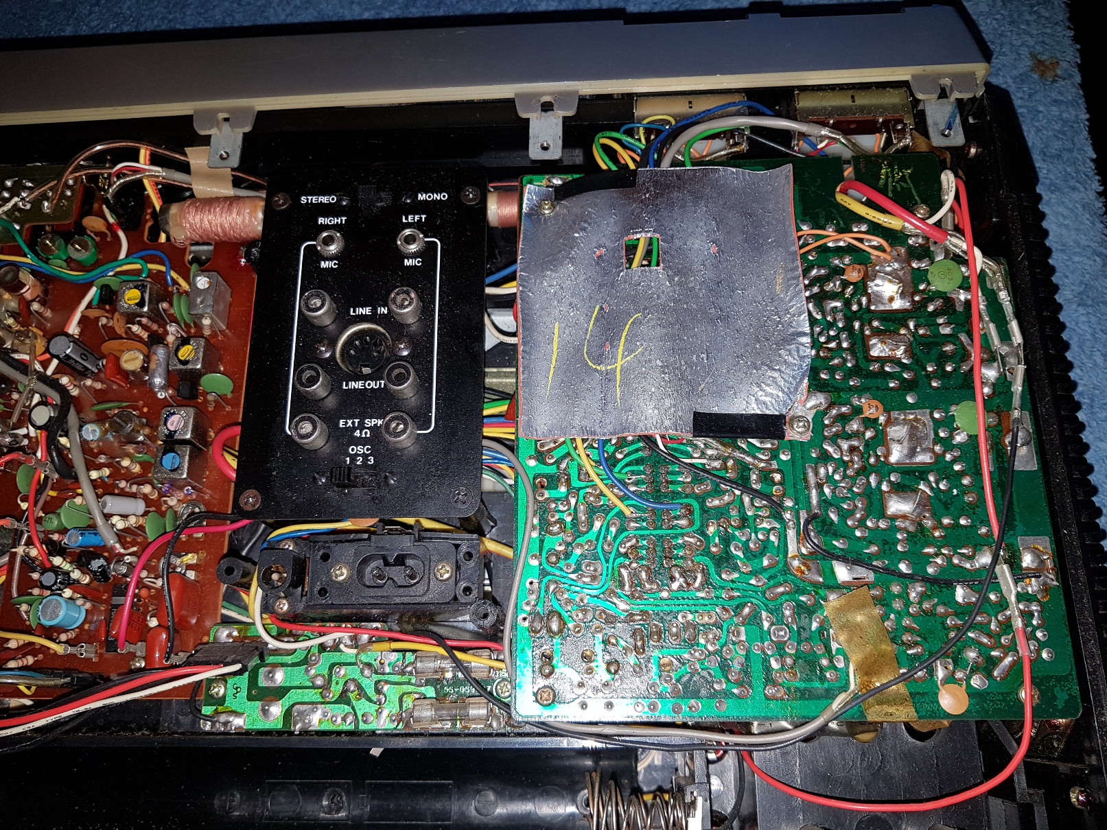

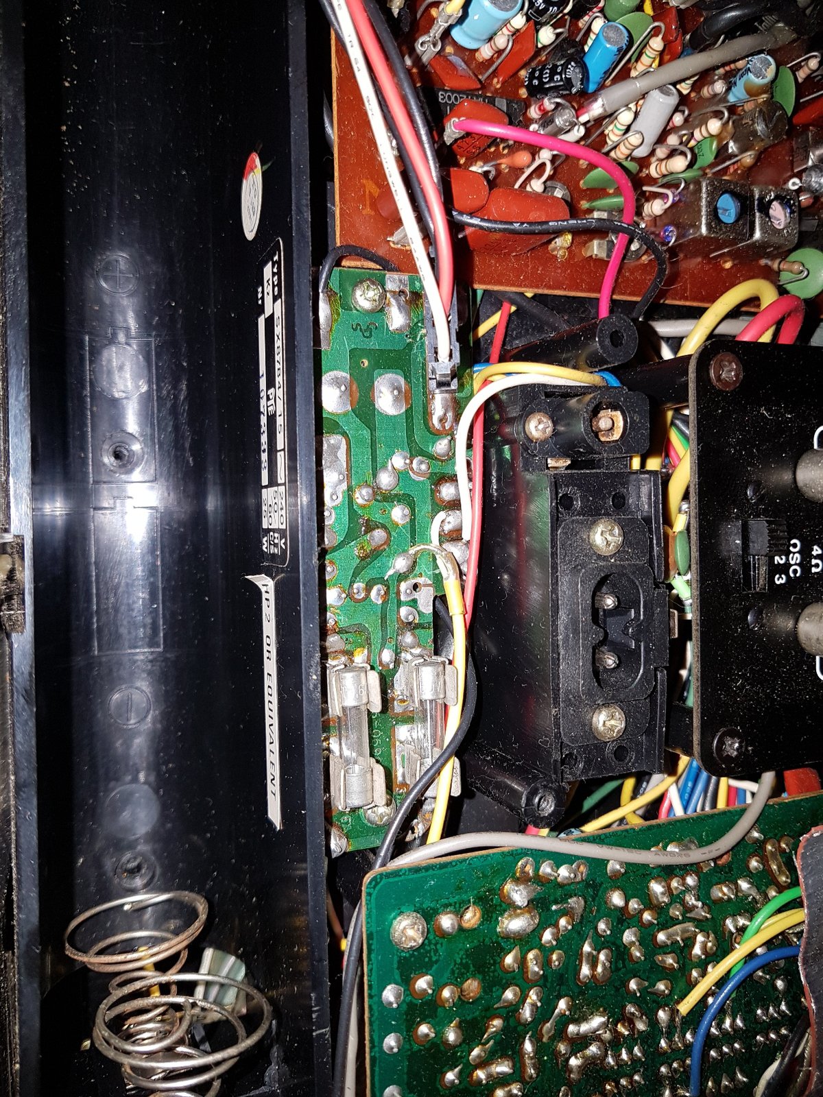

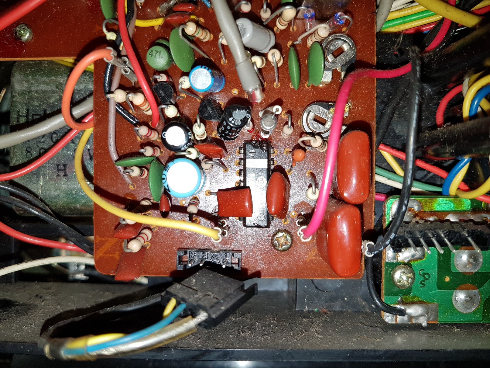

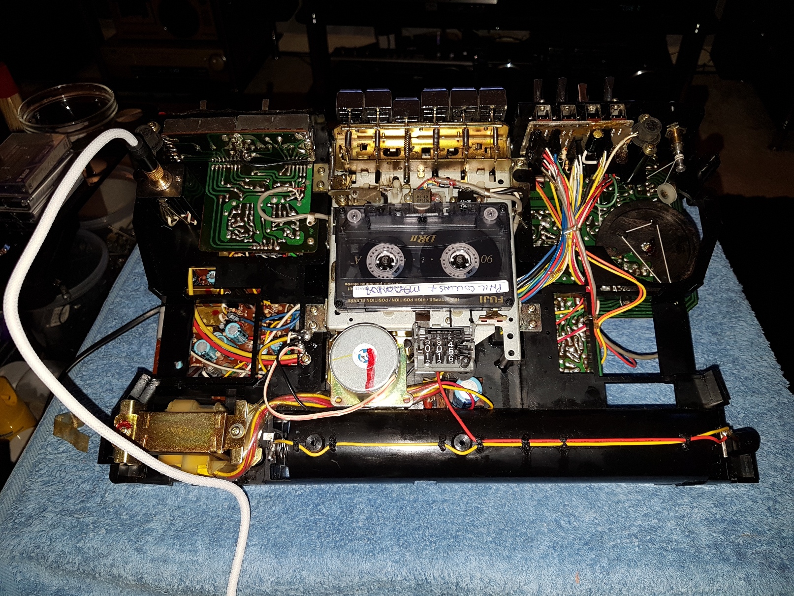

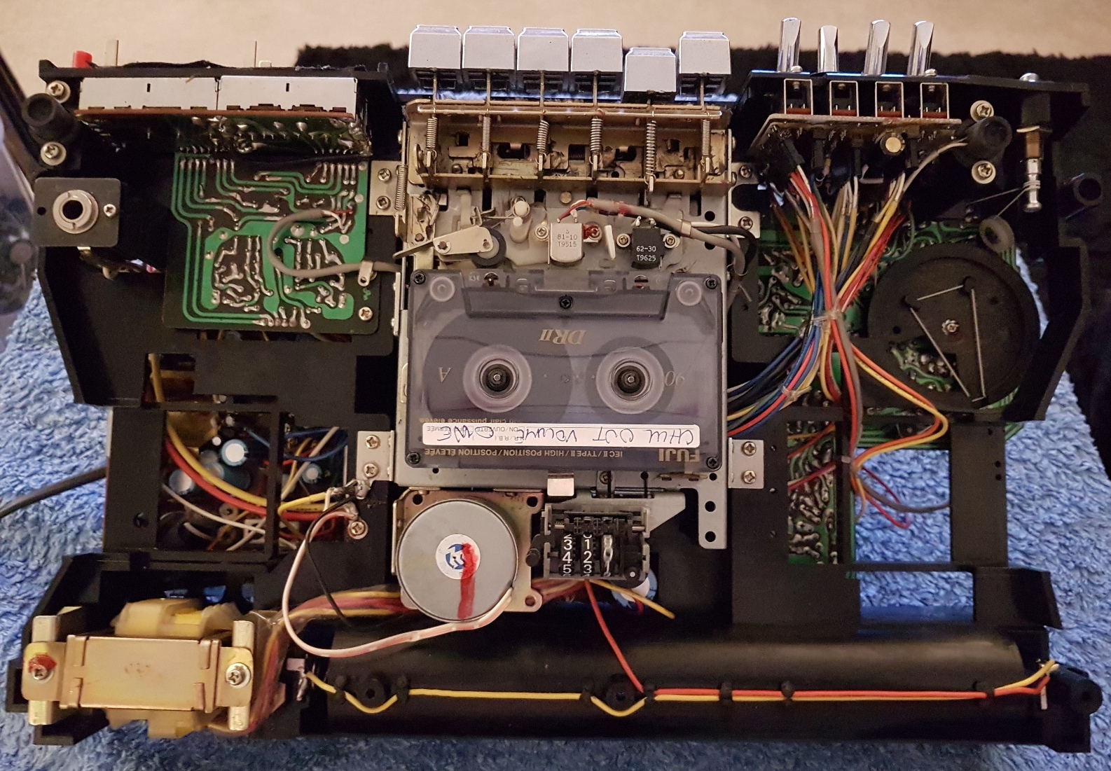

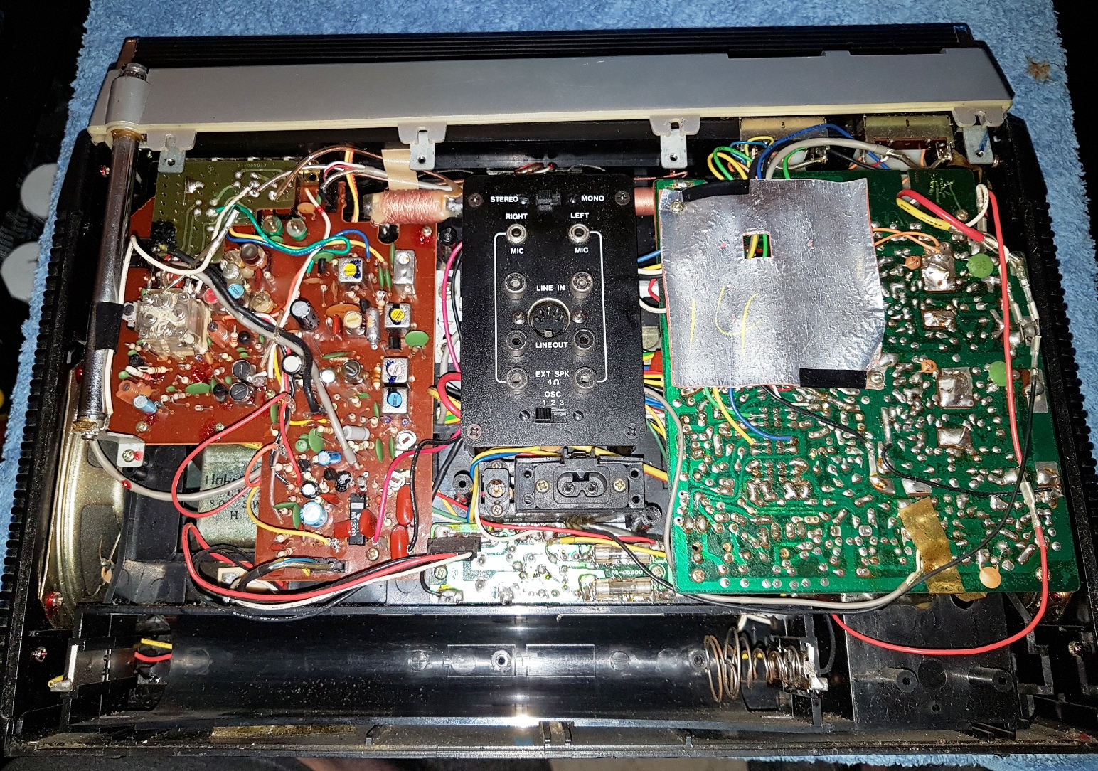

    So what else do we find inside the machine?? Well some unusual but perfectly functional connectors to the main & tuner boards & the first portable stereo I have seen with a fuse protected output stage [​IMG]
    Yep, 2 fuses one for each channel right on the output board feeding the next surprising find..........

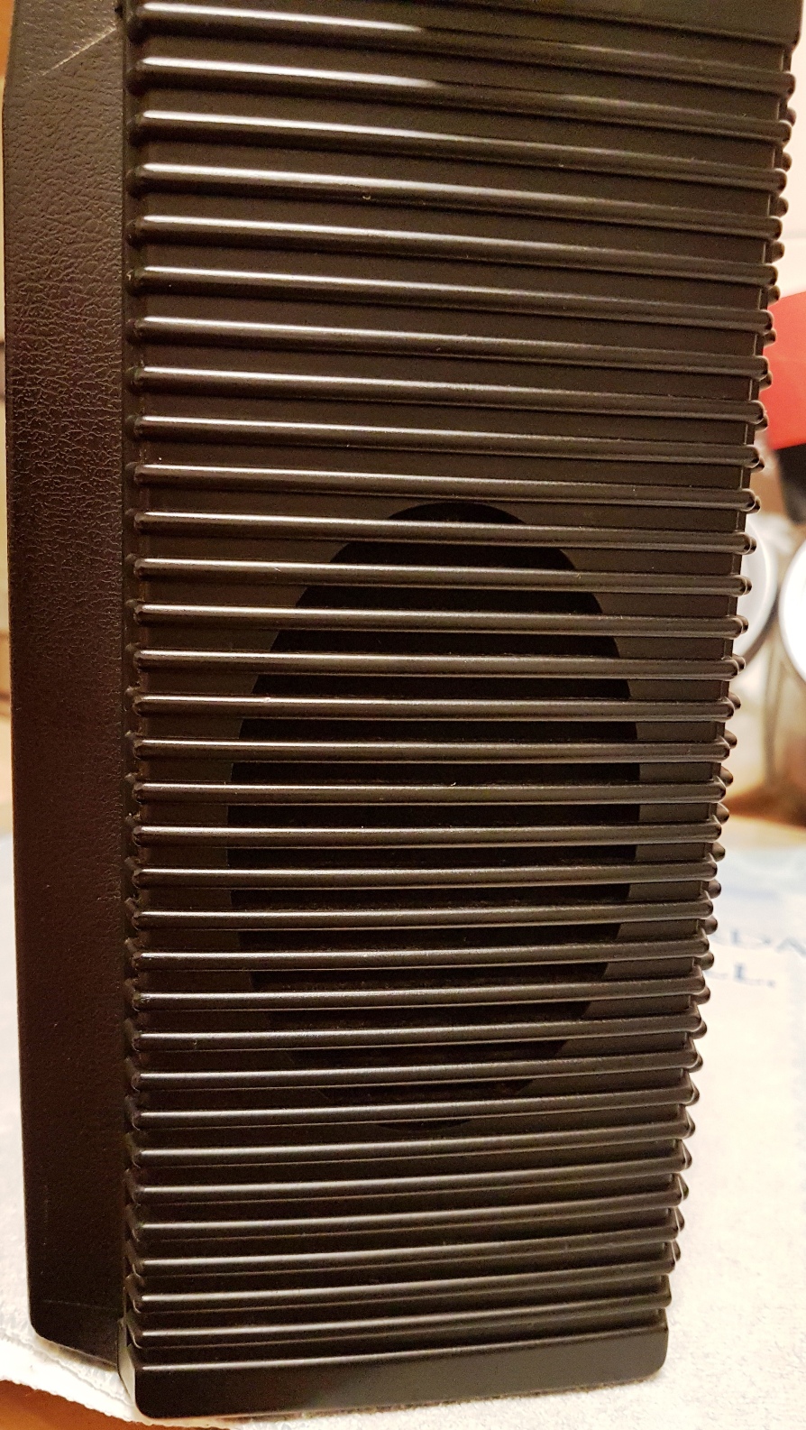

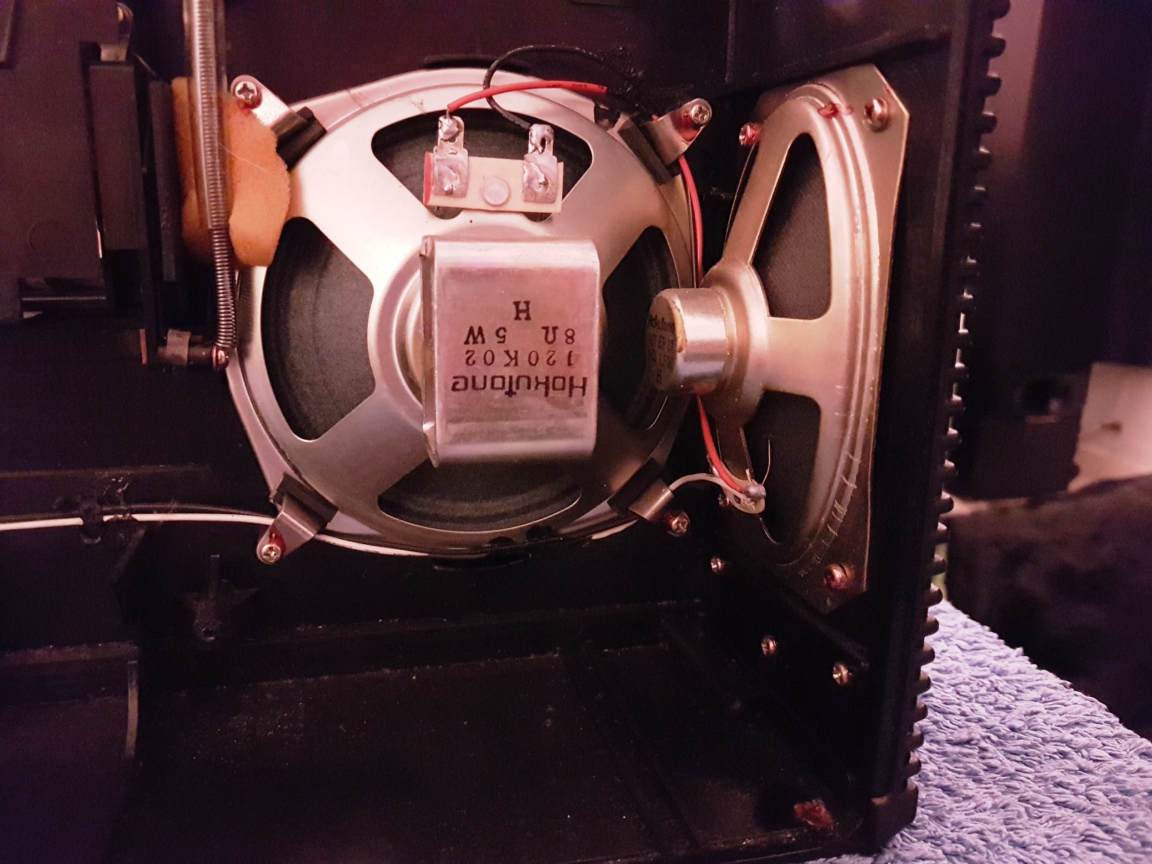

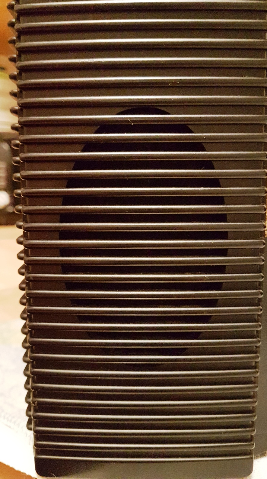

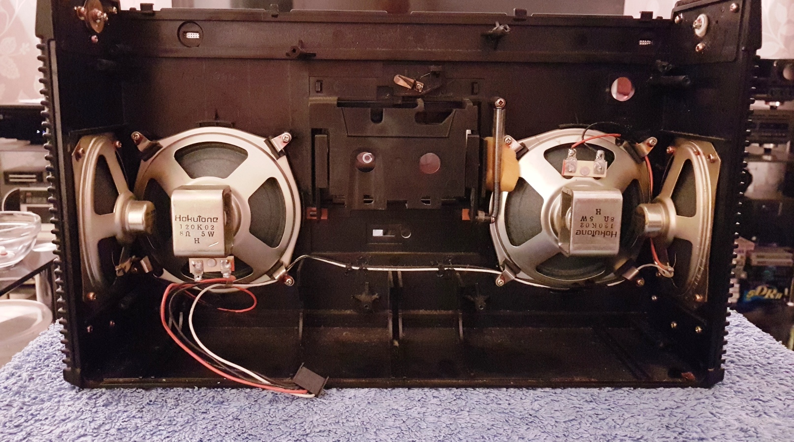

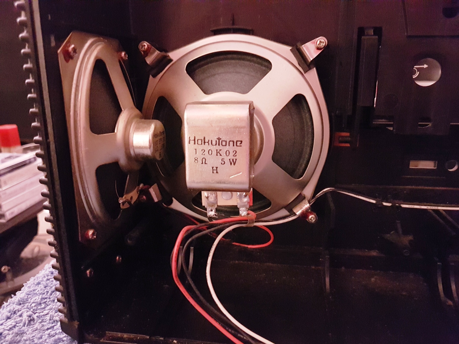

    Two full range speakers for left & right plus two side firing eliptical speakers - Like those mid 70's Sony units that bear some resemblance to this stereo........CF-580 I think they were!

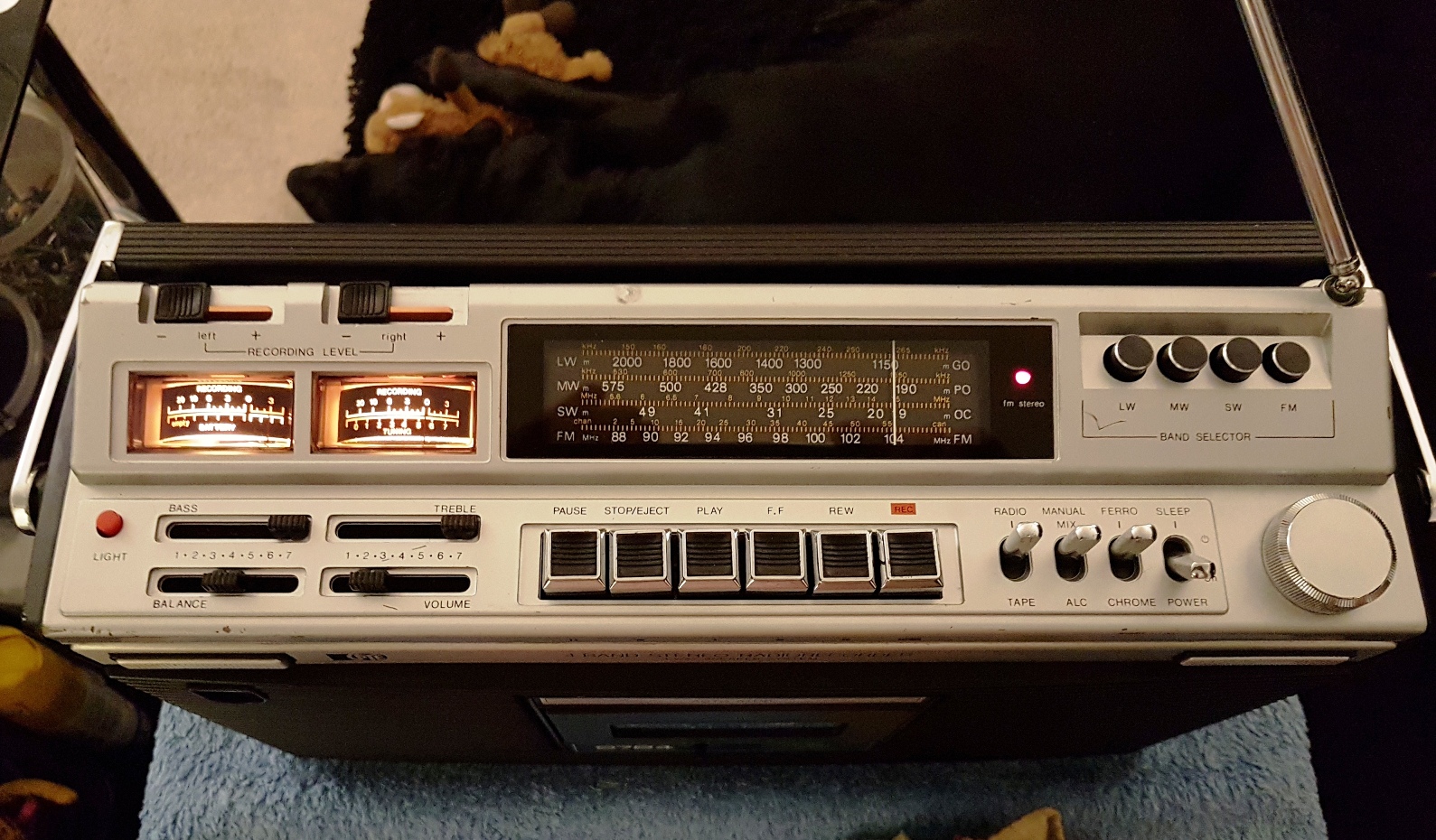

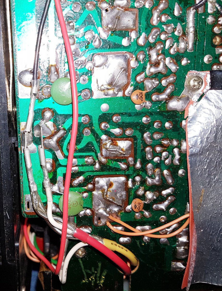

    Anyway, the electronics were of good quality, all switches were filthy & unresponsive & to my horror there was only weak audio seeping from the right channel [​IMG]

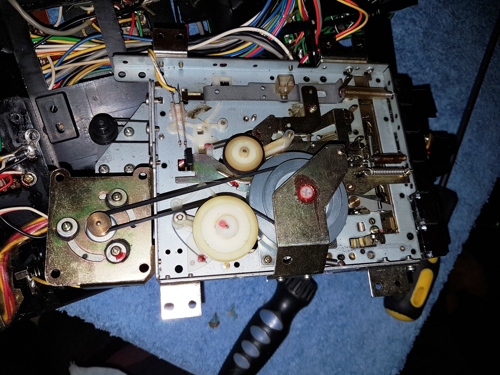

    This turned out to be a red kipper, I thought blown output stage etc despite the protection fuses being intact - To my relief, jammed rec/play switch on the tape deck pre-amp & recording board was the culprit.....unusually it affected radio playback too [​IMG] Never had that before!!
    Tape deck removed very easily & it's single square section belt replaced - This deck was very fussy about having the right size & tension beltwise! Rewind refused to work properly until I tried a third belt just a tiny bit tighter than the previous two I tried [​IMG]
    So now we have good torque in all modes it is time to clean the many switches that adorn this little guy & it took quite a while to completely free up all the switches & get them working again..............
    So far seems to be going well so plug in headphones & test cassette deck! We now have both channels working but terrible sound due to the azimuth adjust screw had worked it's way loose over the years - A adjustment of almost three full turns restored nice stereo sound so screw locked with a dab of locking paint & speed adjusted to the correct setting as it was slow as fuck [​IMG]

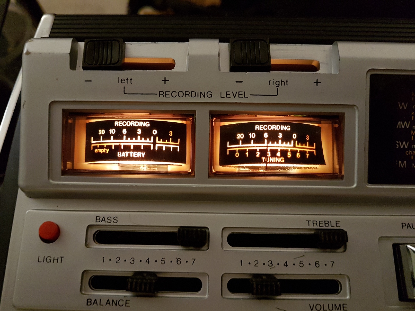

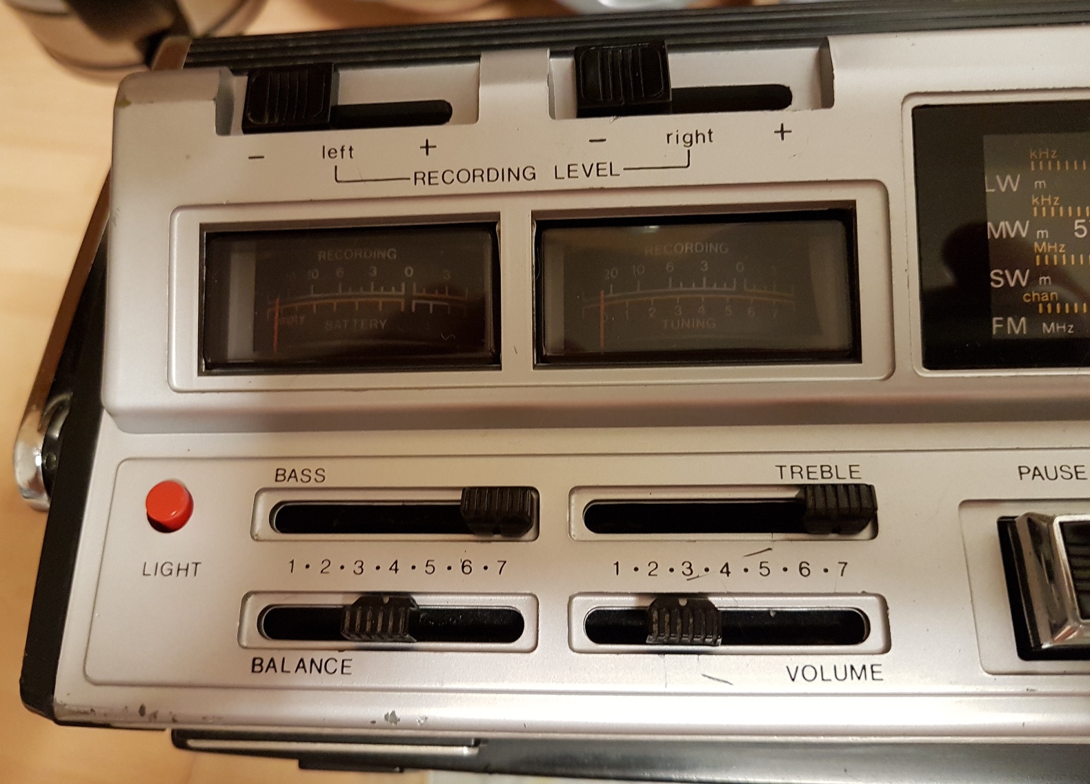

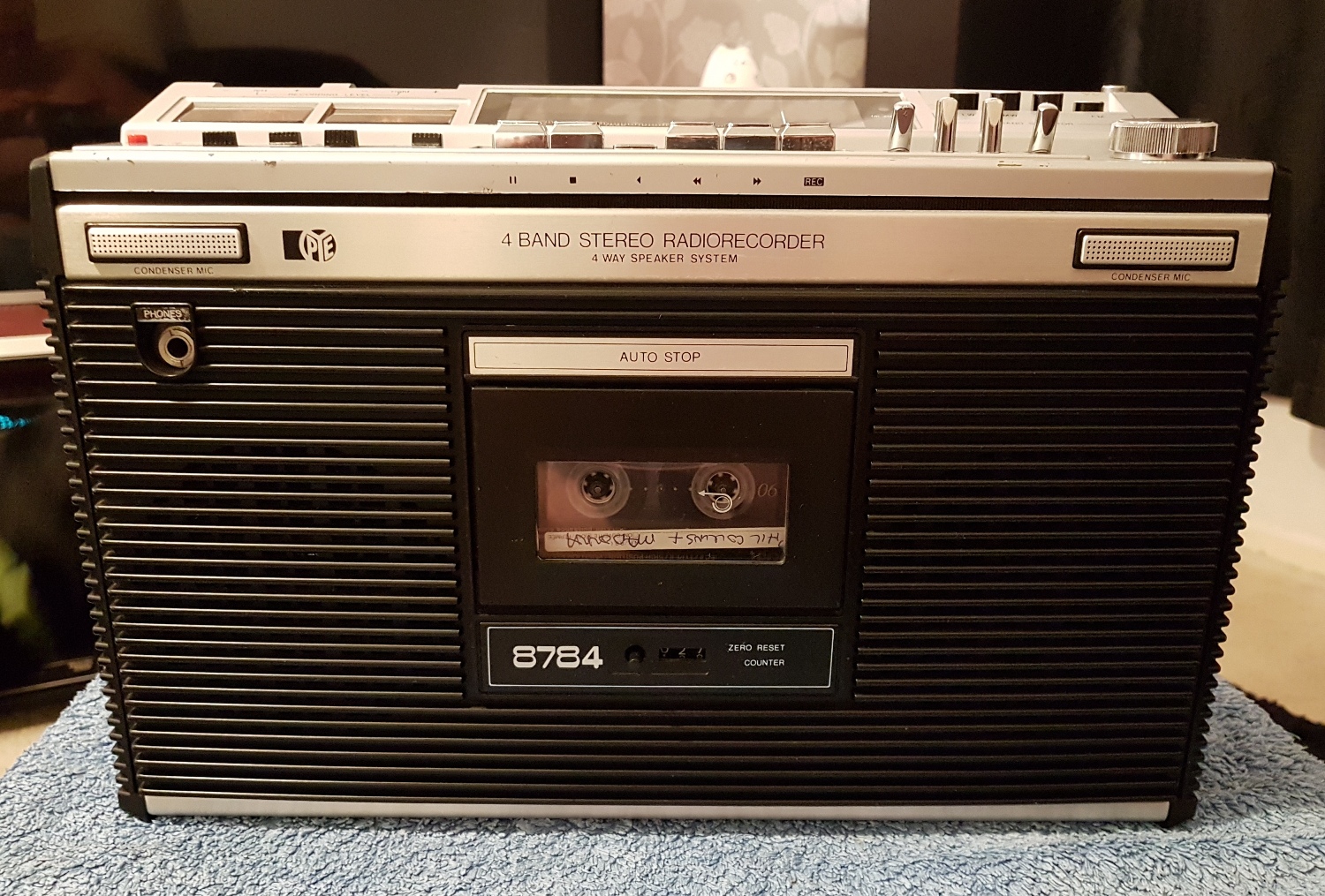

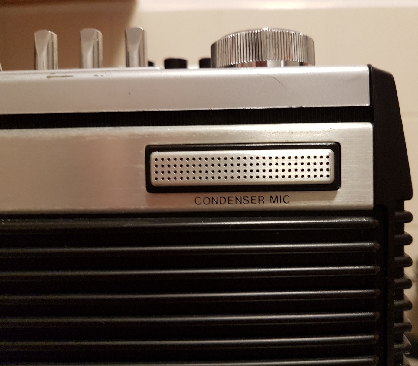

    I was surprised to find bass & treble controls on a portable of this vintage & even more unusual is the choice of manual or auto level recording [​IMG] This little stero has it though & this added to my liking of this little machine & I could almost see the even keels in front of me by now! [​IMG] [​IMG] [​IMG]

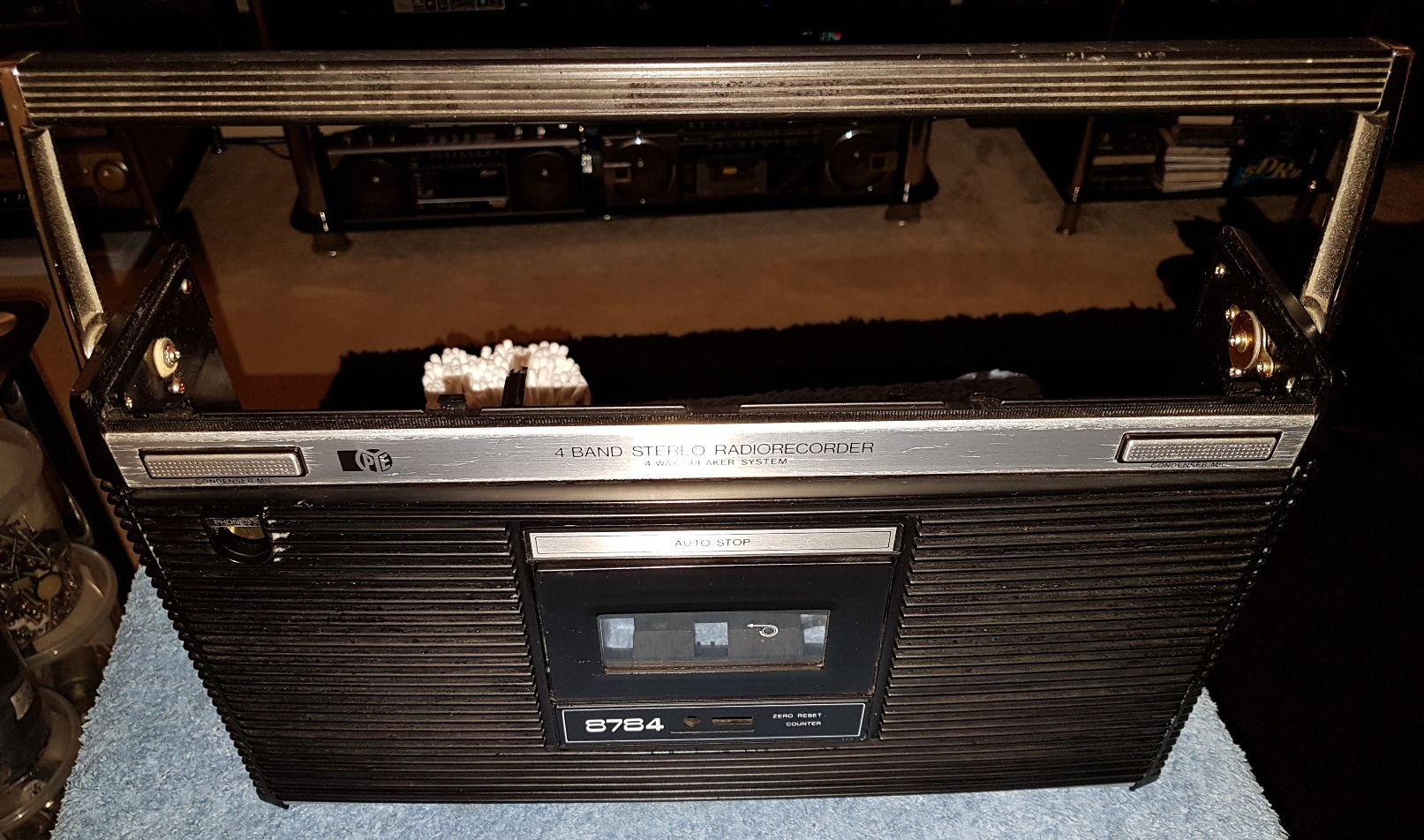

    All that remained was to clean clean clean the casing, control panel & knobs - The slatted design of the speakers means this takes some time to get a good result, around two & a half hours in fact [​IMG] but worth it of course!!
    Reassembly time & this was easy enough being careful not to snap any of the slightly brittle posts that screw the case together, I just pinch up the screws not too much but enough & it was successfully back in one piece......
    The little Pye sounds far better than it has right to! This little stero produces a sound that belies it's size & spec! Lovely sound & gorgeous backlit VU meters on the top work flawlessly too!
    We had by now completely caught up with the even keels & it was time to load a nice chrome cassette recorded on the Technics RS-BX727 3 header & just enjoy the music - The simple design using just a square belt is very good indeed mainly thanks to a nice biggish flywheel & I didn't expect sound quality like this like a humble pie!!
    So that's my story of this little Pye/Philips
    Japanese built stereo radio cassette, I hope you enjoyed reading about it........

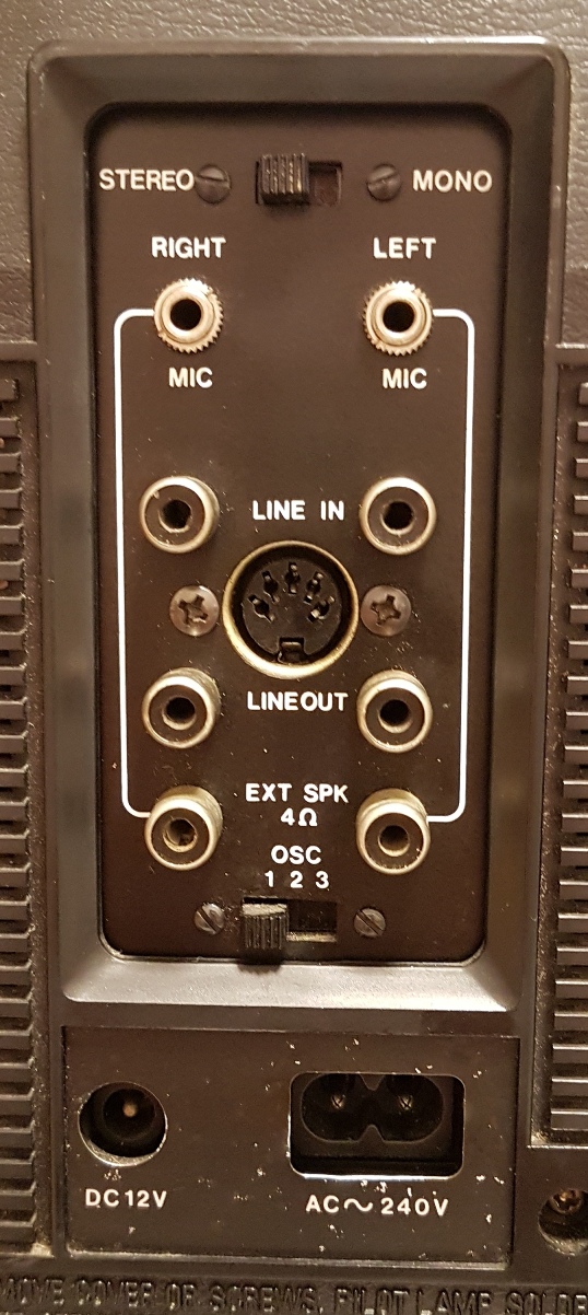

    Got to admit: I seldom see a 'box with a DIN-5 port on it. My only guess is it's slated for high-end external equipment, such as a linear-tracking turntable I once spotted at a resale warehouse.
  15. Longman
    3,789
    Its a European standard so far more common over here. I have seen boxes where the European version has a DIN socket and the USA version has Phono sockets.
