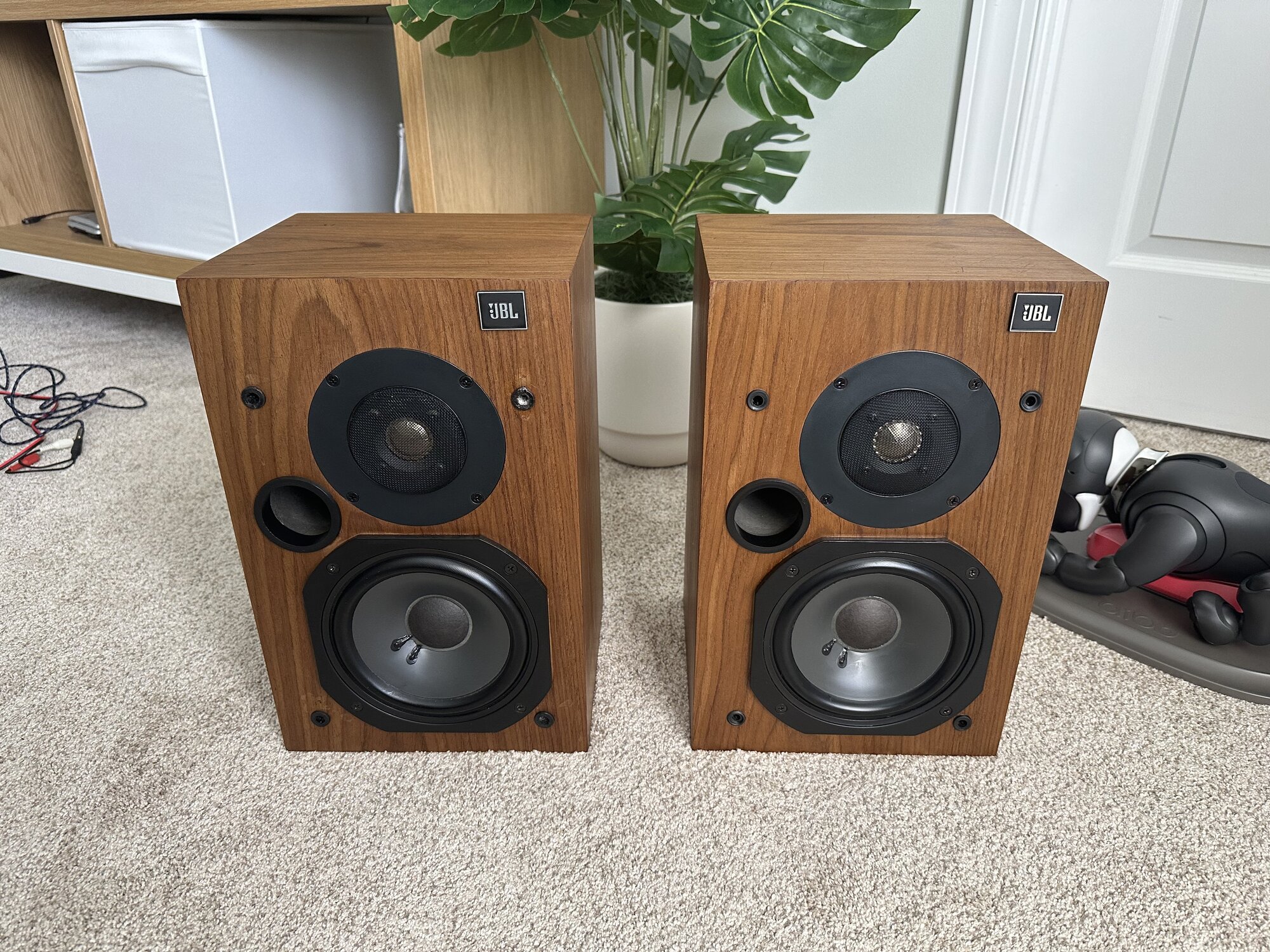

    I actually had some really good luck last week! I was out in my city coming back from a dinner, and I decided to stop in at a Goodwill I used to frequent. This Goodwill is in a metro area near uptown, and the houses nearby are older/matured, so a lot of the donations (even tech) is also older as a result. Here's what I saw:
    These are JBL L-20t speakers! The baby brothers to the L-100t... like majorly baby sized comparatively speaking, but still incredibly well regarded and high end. They had a lot of paint on them, and little scratches, but amazingly, the veneer was not hit on any corners and the drivers looked undamaged too. They even had the OG grills present. The worst problems cosmetically were definitely the veneer being very sun bleached and also all of the white paint on the veneer too. It looked like white oak veneer when I first got them. Goodwill was asking $45 for the pair, so they definitely had done some internet research to determine that these were the real deal. Typically, bookshelf speakers never sell for over $20 at any of my local stores, so $45 was a stretch for them.
    Now, these speakers did look really rough when I got them. I cannot find the photos of the before, but they looked like the veneer was basically unfinished and had been in a room where some serious paint had been done. The veneer JBL used back then was super thin, so I didn't want to sand the wood or completely strip it, so I decided to use 70% isopropyl alcohol on a cotton cloth with some moderate agitation. People say you shouldn't use rubbing alcohol on wood, but I use it if the wood has a lot of paint marks on it, as isopropyl does a great job at removing latex paint from wood. I also only use it if the current finish is faded/not savable, as I have found that it cleans the wood and raises the grain... 70% raises the grain more than 91%

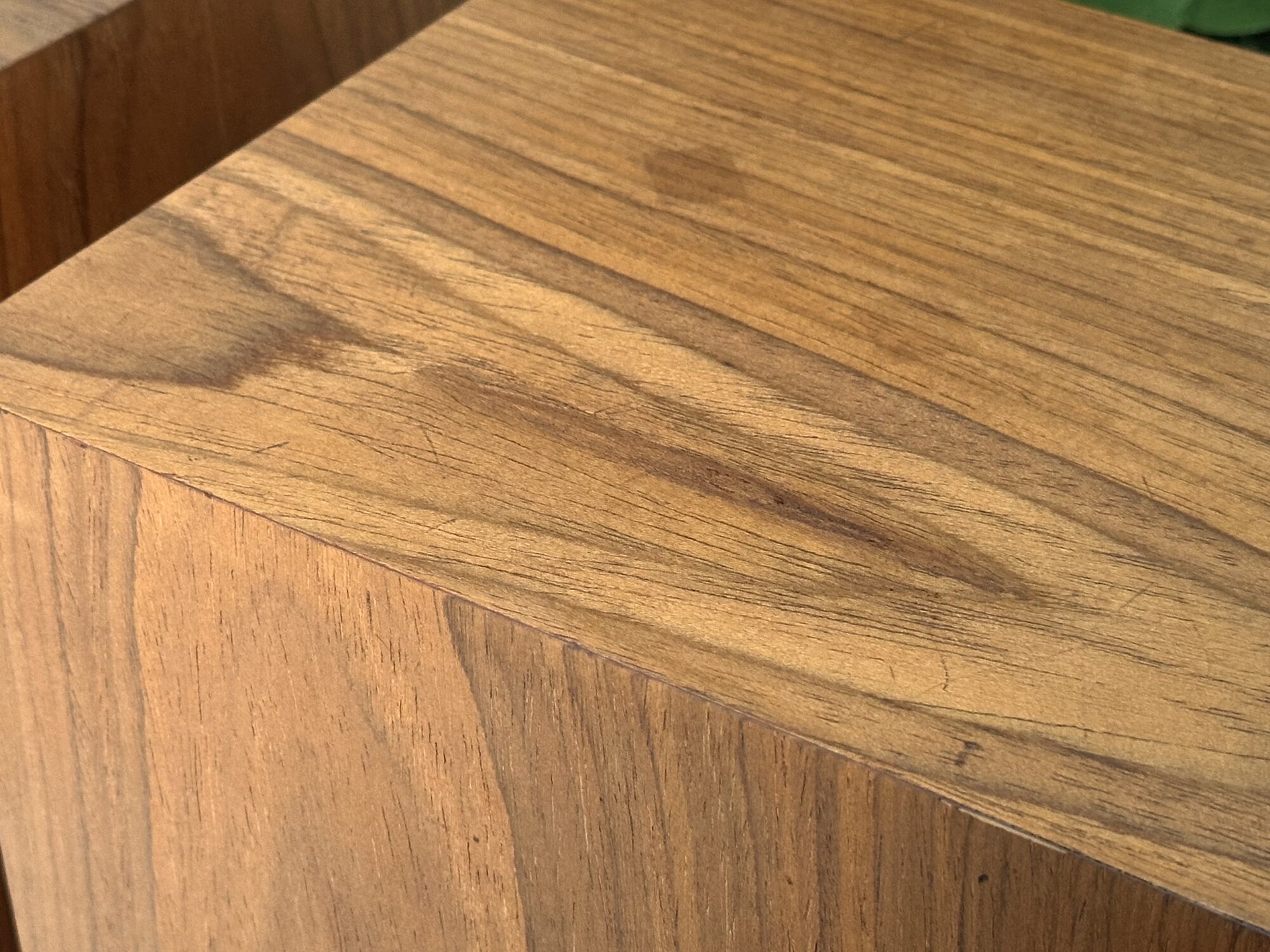

    This is what the original finish looked like in '85. It's a very light colored walnut... almost sunbleached slightly. I'd say JBL used a very neutral teak oil, or another non-dyed oil to just enhance the original veneer. I think this style was in-date in '85, but not so much now. In other catalogs, the L-T series looked so light, that it appeared to be the color of a light oak, but JBL was still calling it walnut.

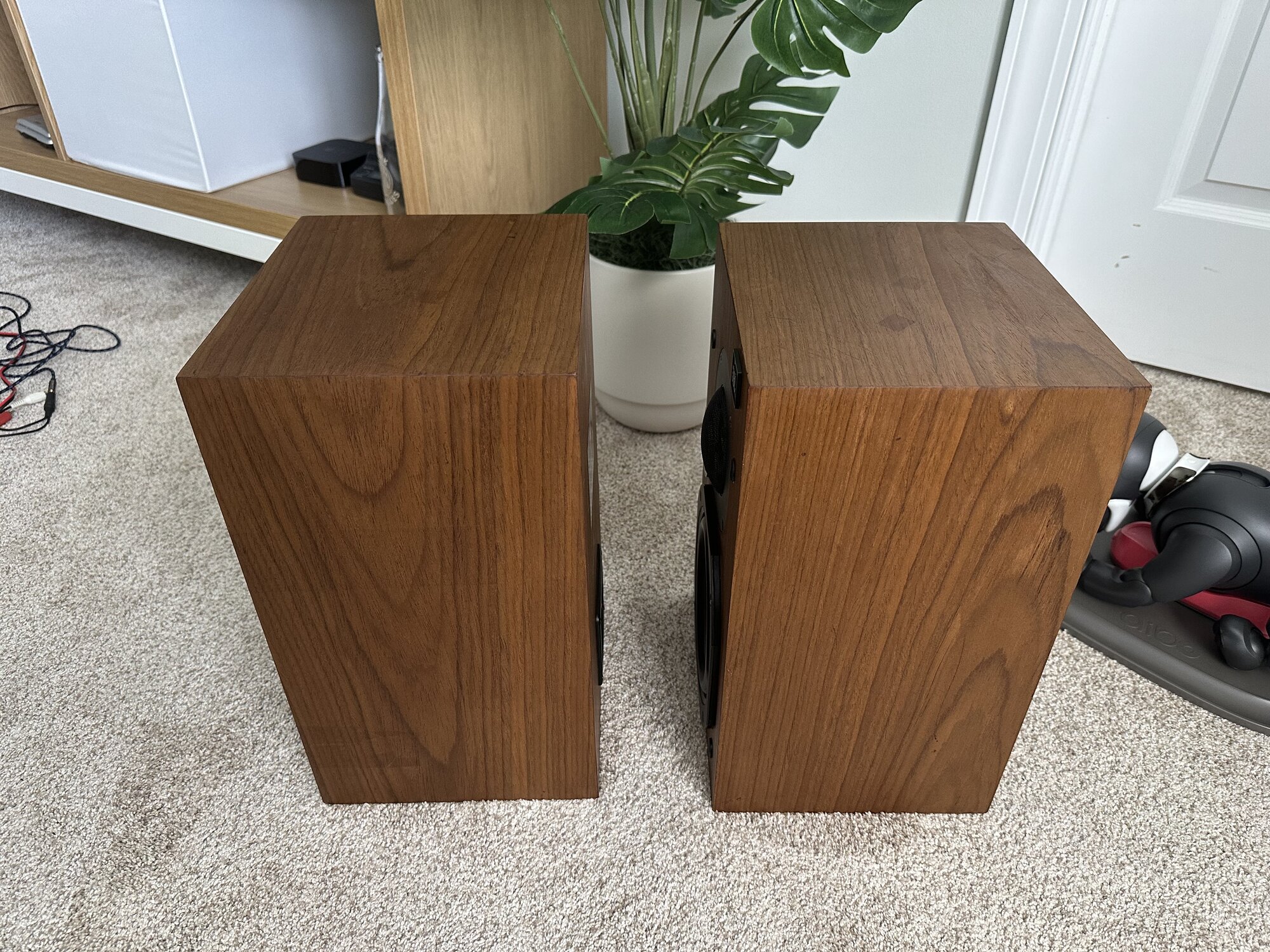

    It's a beautiful warm golden brown finish, even all over, and leaving the scratches in (instead of taking them out with steel-wool or sandpaper) has created a really nice vintage patina that doesn't scream 'beat up wood', but rather 'Vintage Americana'. Thankfully, the isopropyl helped to take out noticeable scratches...
    Here's the finished product:
    Definitely darker than JBL originally intended, and more inline with the later T3s, but it fits with what I think a vintage walnut speaker should look like. I couldn't get rid of the weird square stains on the top... those were moving stickers that were left on there for a long time to sink into the grain... :(
    I will say though, finding these without any chips is practically impossible these days, and this one is chip free! Those annoying areas where the veneer is completely gone and only the MDF is shown... yeah you won't find any on these!
    All-in-all, I'm very happy with these, and I think $45 with an afternoon's worth of work, that's a great deal! Sound demo to follow soon!
