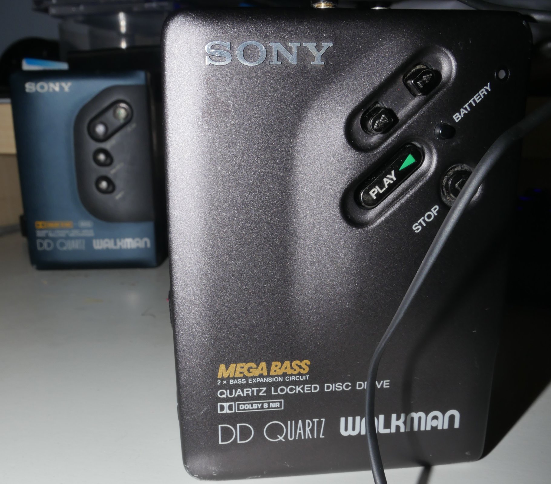

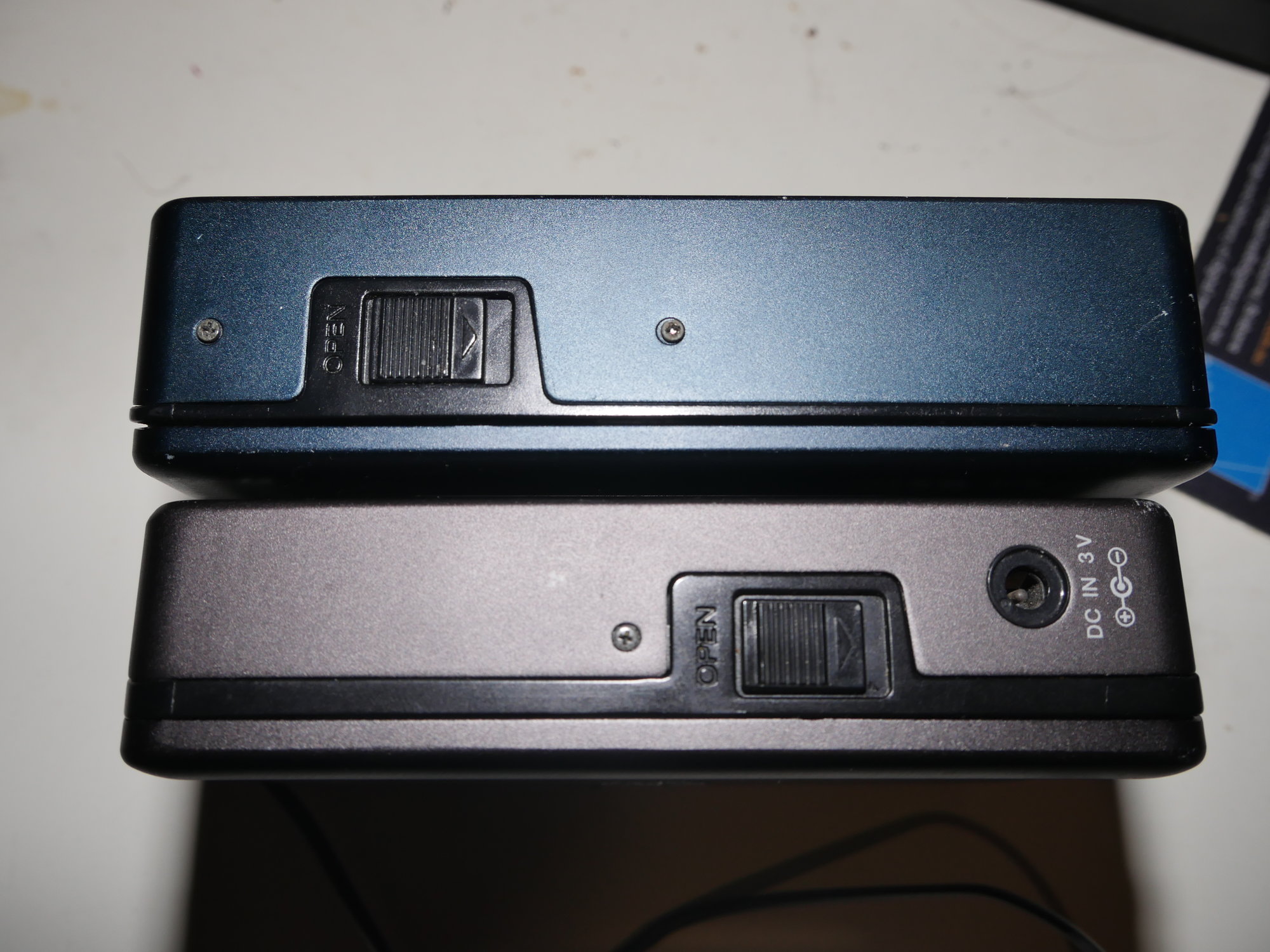

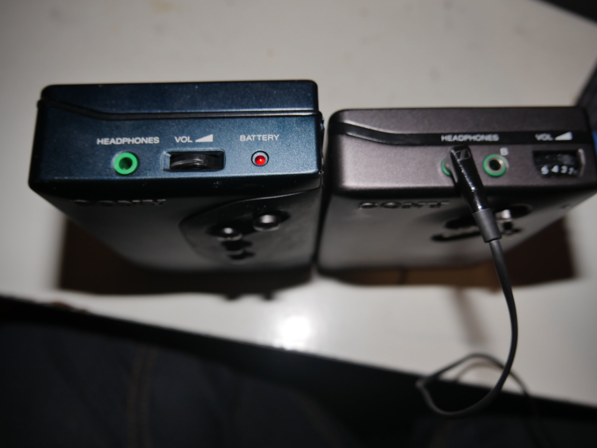

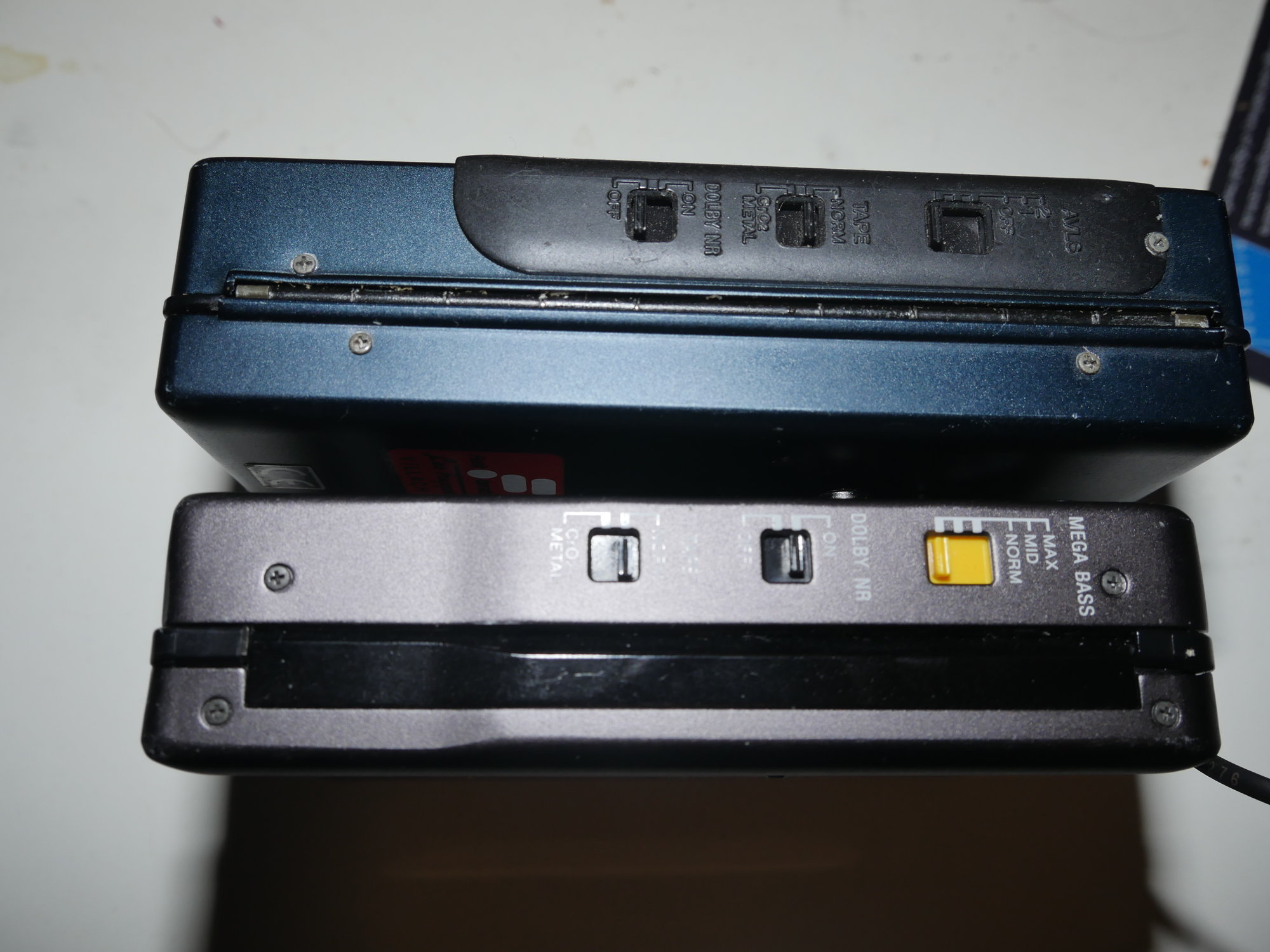

    Hi guys,
    About 6 years I ordered a WM-DD22 from ebay due because I noticed the DD was praised by a few youtube and I wanted something more portable than my TC-D5m. However when I received it, as soon as I put a tape in I sawley disappointed. It it barely sounded better than a microcassette. But wait, what was the point of this thing if it sounded like crap, so I kept fiddling with the head alignment, but I was never able to get it sound any good and I mean any good. So I thought; "oh well I suppose people just accepted that back in 1989 or whenever it was made".
    A few years later I decided to buy an EX505 to play about with, I when I played back a tape a I make a few years earlier, I was surprise at how good it sounded, but it wasn't all good, the music would occasionally sound wobbly, as in the wow & flutter was all over the place (I haven't fixed it, I suspect the mechanism needs cleaning). So I thought if that's what walkmans were meant to sound like, perhaps I should look into the DD walkmans again, it they're meant to pretty solid when it comes to tape speed. But this time I wasn't going to make the mistake of getting the bottom on the line model. After doing some research the WM-DD33 seem to be the best value for money.
    It arrived to today, my first thoughts were,I hope it doesn't sound awful. and to my surprise It Didn't! I was pleasantly surprised at the sound, this was exactly what I was expecting 6 years ago. I also noticed it was a bit shorter, but the build quality was much better. I'll admit it's not as good as the TC-D5m, but it's pretty good.
    I assume the DD22 and the other DDs with round 'play' buttons were cheaper models, they don't have the clicking gear issue, but the sound and build are much worse. If anyone has more info behind the cheap DDs, please let me know. I've posted some comparison shots below:
