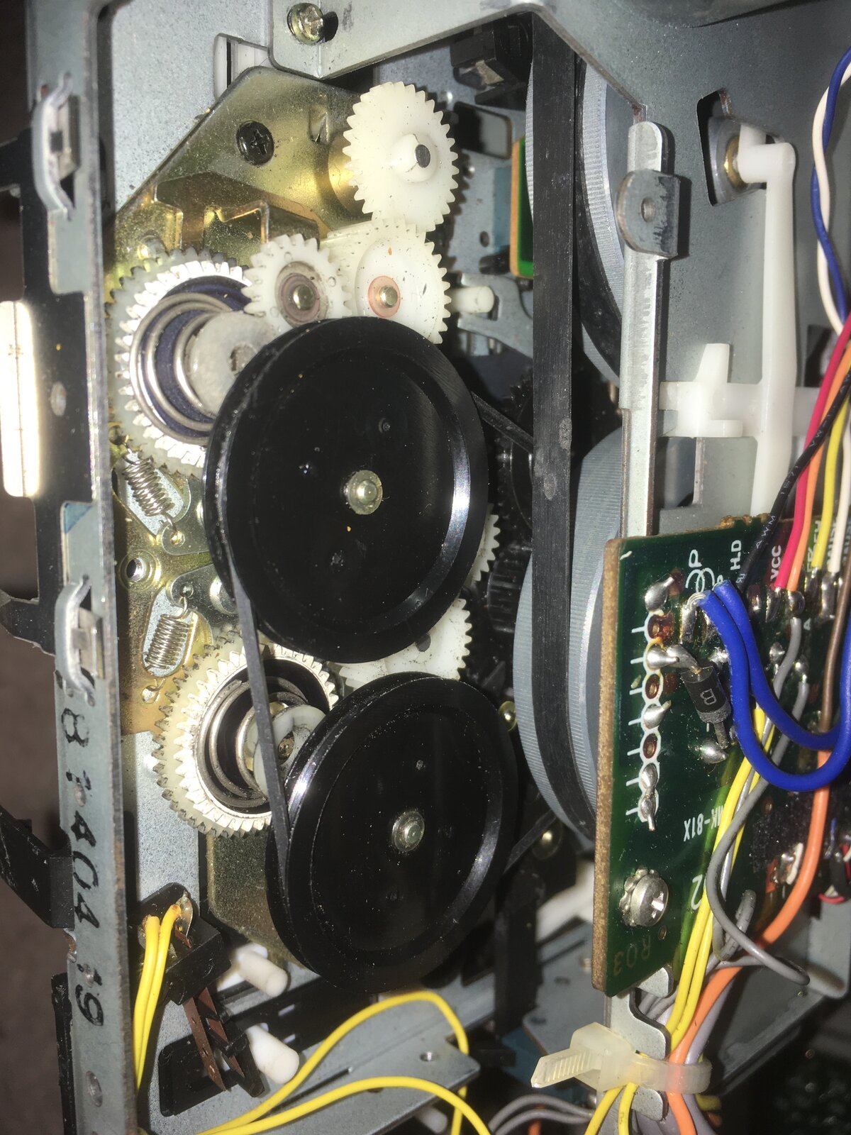

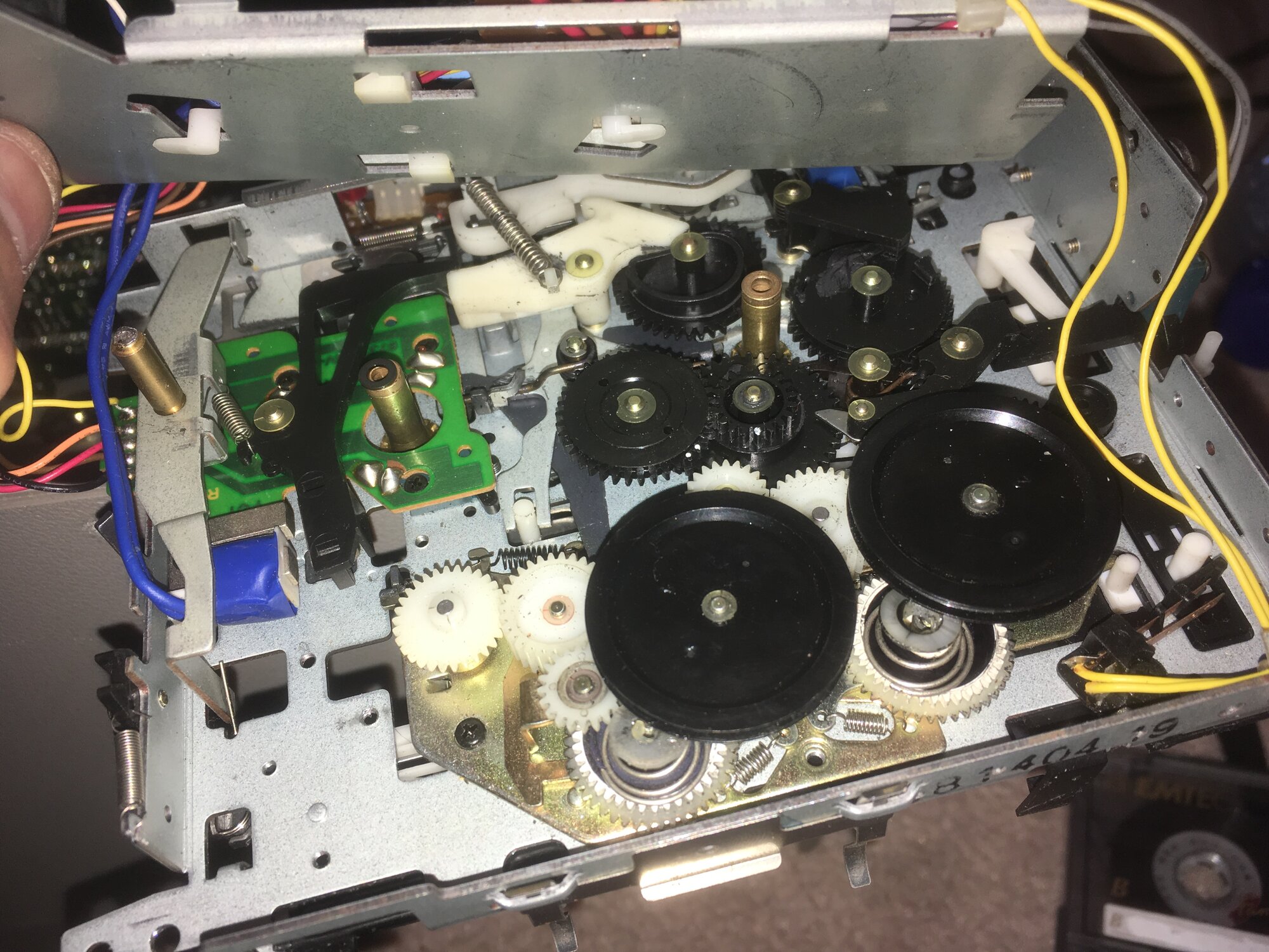

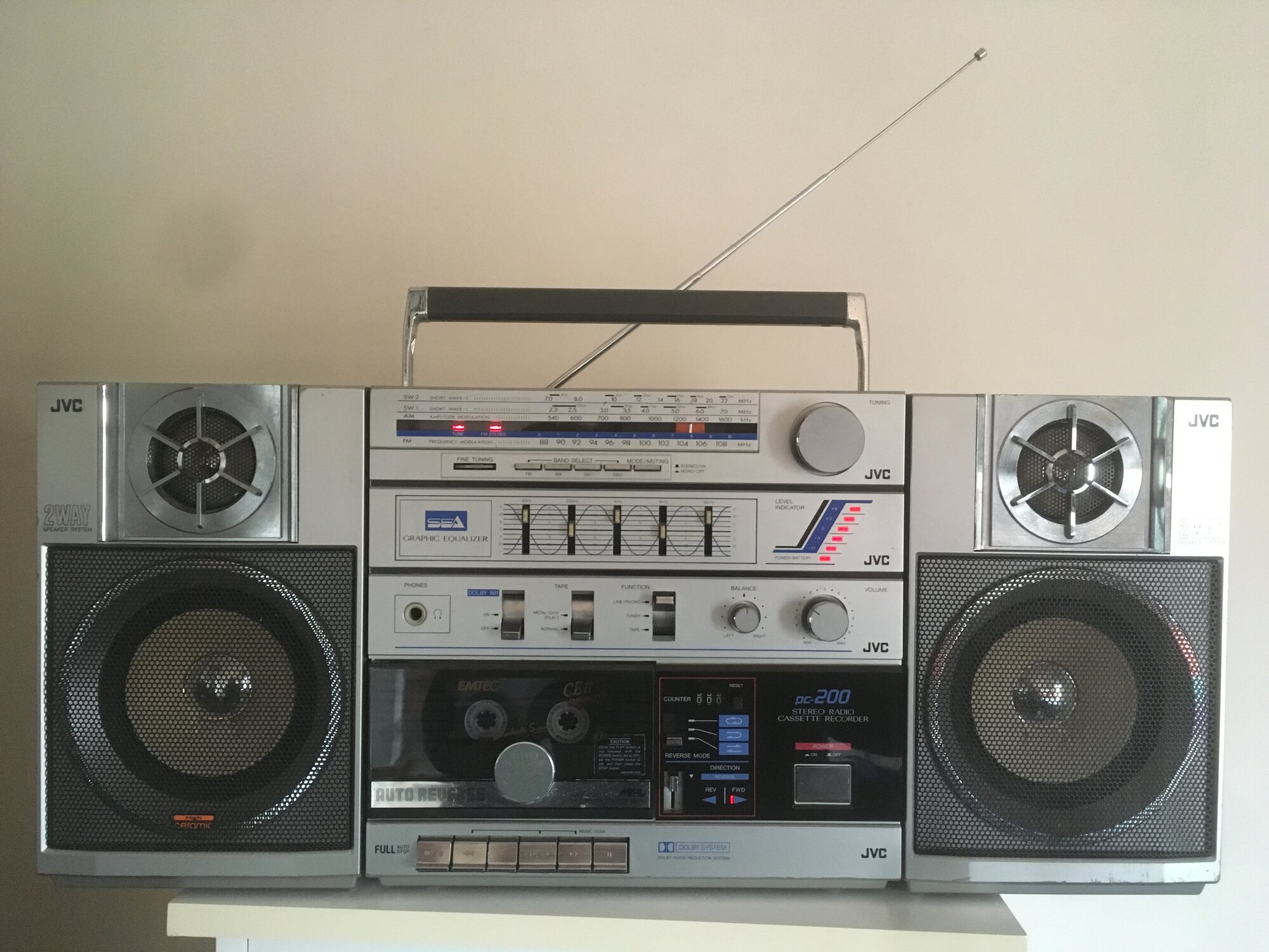

    345AB795-77CF-4A00-9715-244471417FE8.jpeg BC9B33B5-EF8B-478D-8DC9-7528DDBD6A14.jpeg 1F3A12A1-AAEB-4853-AD0E-FEDC87335513.jpeg Hey everyone, I have a JVC PC-200 auto reverse boombox. I have replaced the belts and it plays and fast forwards fine but rewind and playing in reverse does not work.
    Anyone seen this issue on this or similar model?

    The tape head rotates fine. It plays for a a few seconds in reverse with the cassette tape getting a little loose inside the shell and flicks over to forward again. The player doesn’t spin at all on the left side.
  6. Jorge
    1,754
    I think you found the problem:
    ...plays and fast forwards fine but rewind and playing in reverse does not work...
    ...plays for a a few seconds in reverse with the cassette tape getting a little loose inside the shell and...
    Pick-up Reel in reverse play, which is also a Rewind reel, is loose and slips instead of picking up (or rewinding) the tape. This would immediately stop Reverse play
    Take another look at this reel: either rubber tire needs rejuvenation, if it is gears maybe something cracked... or hub is too loose on the spindle
