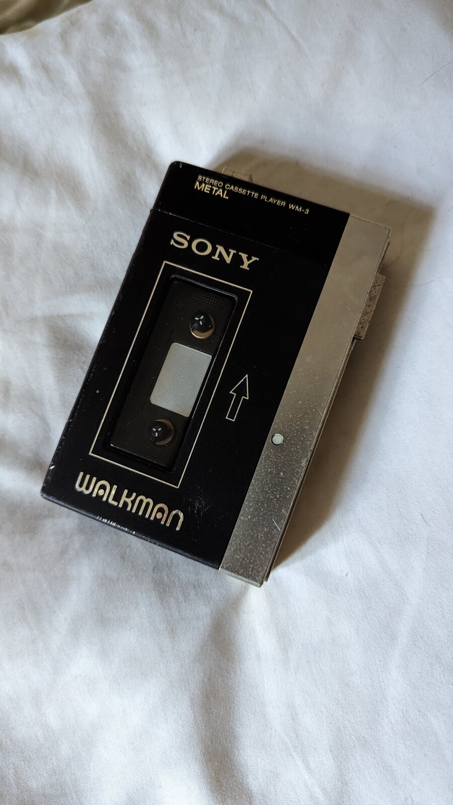

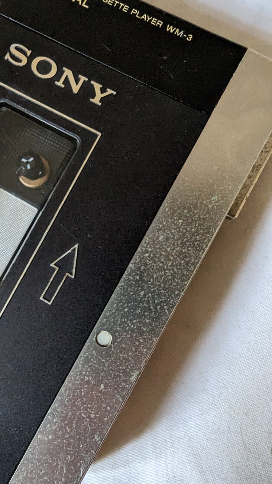

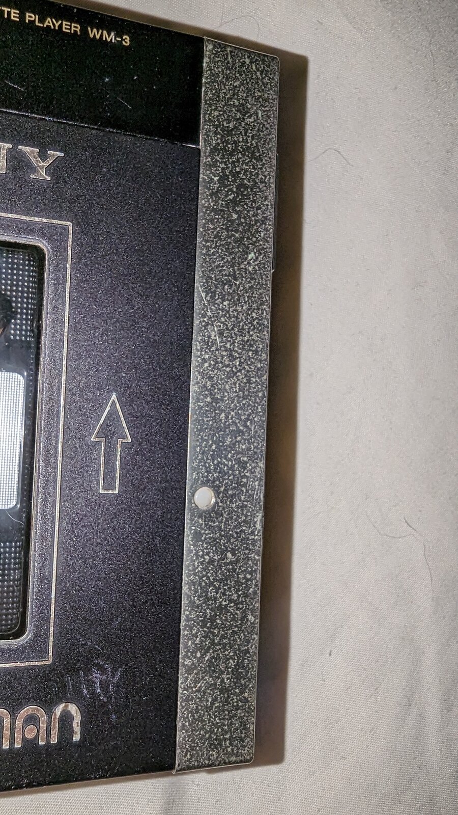

    I recently acquired a Wm-3 off eBay. While the condition of it is by no means awful it does have a bit of a cosmetic issue. I was wondering if anyone could advice me on potential repairing the damage to the goldish metallic side piece. My one appears to have some kind of pitting? On it.
    I was wondering firstly how is it finished as it's a plastic piece made to look metallic. Is it electro plated?
    Secondly is it even possible to repair?
    Any advice would be a great help!

    You could try some Novus #2 plastic polish, or any kind of clear coat polish designed to eliminate swirl marks. But use it carefully, as that imitation metallic coating is very soft and fragile

    Electroplating plastic used to be a common way to make plastic look like metal, feel like metal, but still maintain the lightweight properties of plastic. The process of electroplating plastic is very different from electroplating metal, as you cannot bathe the bare plastic in a solution to do the electroplating as you would with a metal material. You need to apply a conductive paint to the plastic or use a solution to increase the bonding properties of the plastic. Here’s a web blurb about it:
    https://incertec.com/services/special/plastic-composite/
    According to the linked site, those pores you are seeing are part of the early stages of the process, they are the ‘channels’ that are created in solution to make the plastic more receptive and adhesive to the bonding material. Cool stuff. Electroplating plastic is still used today in the automotive industry mostly.
