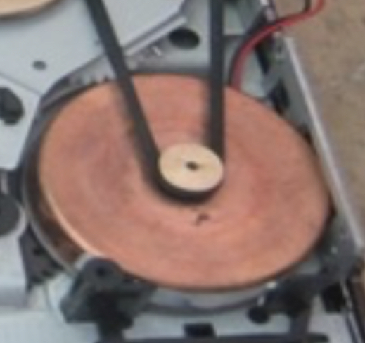

    Hello everyone,
    Long story short- seller “repaired”, but done it wrong way… he filled up all motor via two small holes in the back with some oil and i think because motor is full of oil it drifts a lot. For example after 20min of playing it suddenly starts to speed up more and more. (All capacitors changed)
    Maybe someone have aiwa hs px510 dc motor and would like to sell it?
    As i understand that dc motor is quite common on aiwa hs px and p series. Attached picture.
    thanks

    Hi, i got px310 as a donor (for parts) and used motor from it to repair my px510.
    cheers

    Thanks for letting us know. Is it safe to conclude the PX310-PX410-PX510 all use the same motors?
  5. Nokeshas
    Nokeshas New Member
    12
    LT
    Yes mate, you can use even p202 series motors i think, not tested but they look the same.
