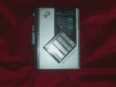

    Hi all, I've got an Aiwa HS-G35 in silver but the case is extremely scratched with lost of paint missing. My intention is to respray it so it resembles the red model, since it's too far gone to save anyway.
    I was wondering if any of you have had success with decals or stickers which you print yourselves when it comes to lettering. I need to somehow repro the auto reverse and EQ lettering. I think I would need to spray the sticker with laquer to stop the ink running (I have an inkjet printer)
    Can you give me any advice on font, favoured application etc? I've attached a reference image.

    Thanks, I wonder if I should just paint it and forego the lettering, here's a picture so you can see how bad it is. Will know more when it arrives!

    It might not be so bad after a good clean up. I've owned one of these since new and the paint is a bit worn through in places but it looks period correct. The chrome still looks shiny on yours. It's a good player even if it lacks Dolby, but these things just look so 80's and cool with the 45 degree graphic equaliser controls in the door.

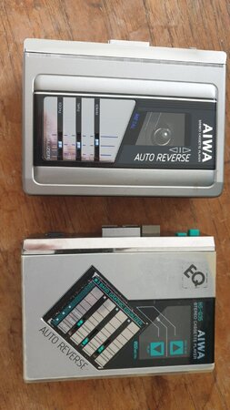

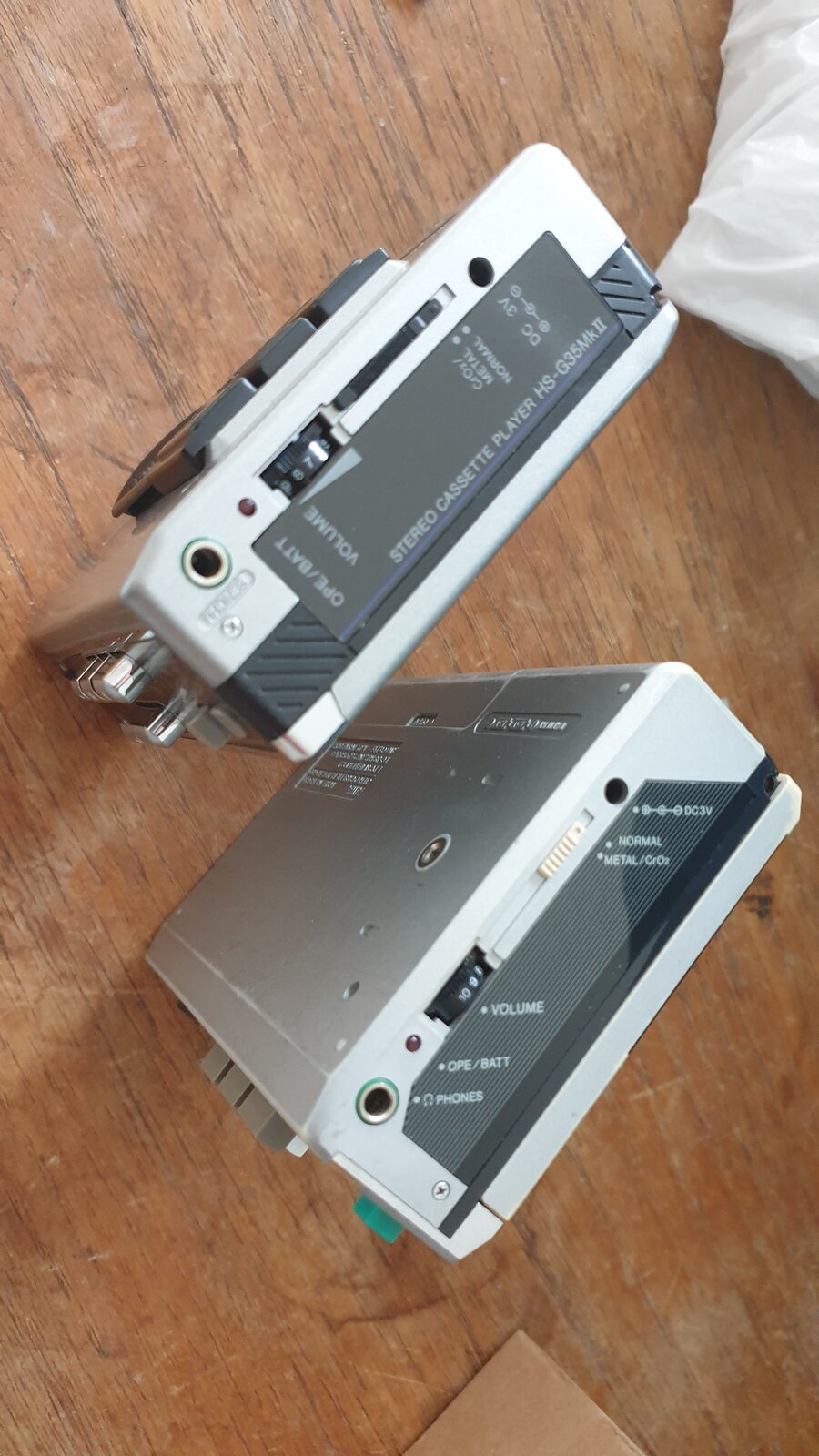

    Well it arrived and here it is with it's younger brother. I'm in two minds about painting it now, given that the equaliser panel is probably not fixable, so even if I made the main body look nice, the equaliser would let it down. I'll think on it though. It sounds great actually, but will look to change the belt anyway.
