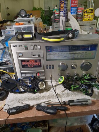

    These are magical tools. I use them on every radio I take apart. 17208903566913950231752444747265.jpg
    Little magnet pickups extendable I have like six of them here on the work table and a few more out in my toolbox in the garage.
    More magical tools you can never have. A enough enough headlights and JIS That stands for Japanese industrial standard, screws drivers and I have a number 2 vessel brand screwdriver which is a impact number two and a variety of sizes of number one and even smaller. And I didn't show a picture of jeweler screwdrivers but I have a lot of those as well. Mostly in Phillips but also flat tip, but that's rare to be using a flat tip and a side of these things, but they're also handy on occasion.
    But most of all, document what you do from the very beginning and take more pictures than you think is necessary because you'll come to a point where you'll be looking for something and if you don't have taken that picture beforehand then you'll know where the item went to. So I've even taken to shooting video when taking something apart but that's rare for me to do and normally it's just easier to take pictures as I go so having a good camera is nice. In general, I've taken between 40 to 60 pictures taking apart anything boombox related because I've never been inside of one of these models before and I don't know what to expect. So if I have a history of pictures of what happened when I took it apart then when something shoots out of it and goes flying off to who knows where. At least I know what it was before it left the scene.

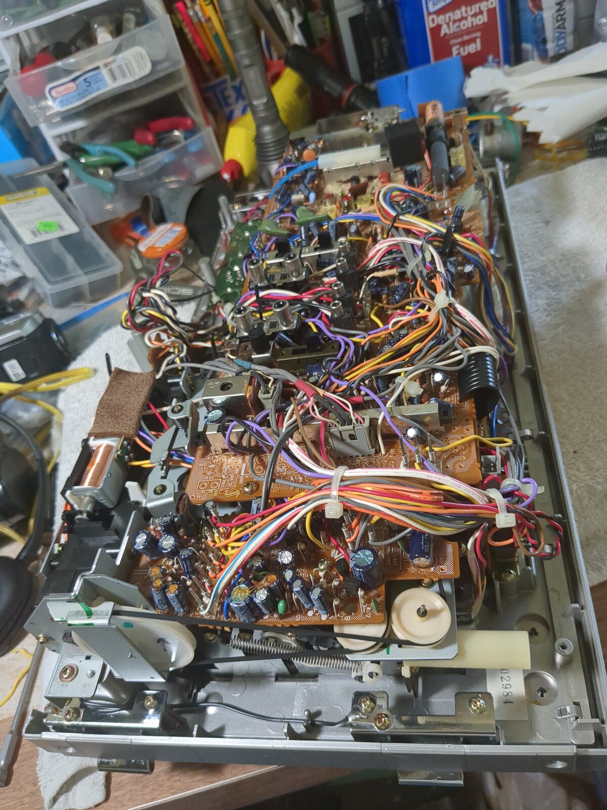

    Well, I don't think I'm going to try to repair the belts in this Sony cfs- 88s as it is way too difficult and I'm not necessarily in love with this machine while it works a bit and The cassette plays. This is too daunting to get to the belts. Let me give you one picture.
    I will be cleaning the potentiometers for the various controls running deoxit through them and working the controls and then I'll be buttoning this back up. If anyone's interested in it send me an email decentman4you2007@gmail.com

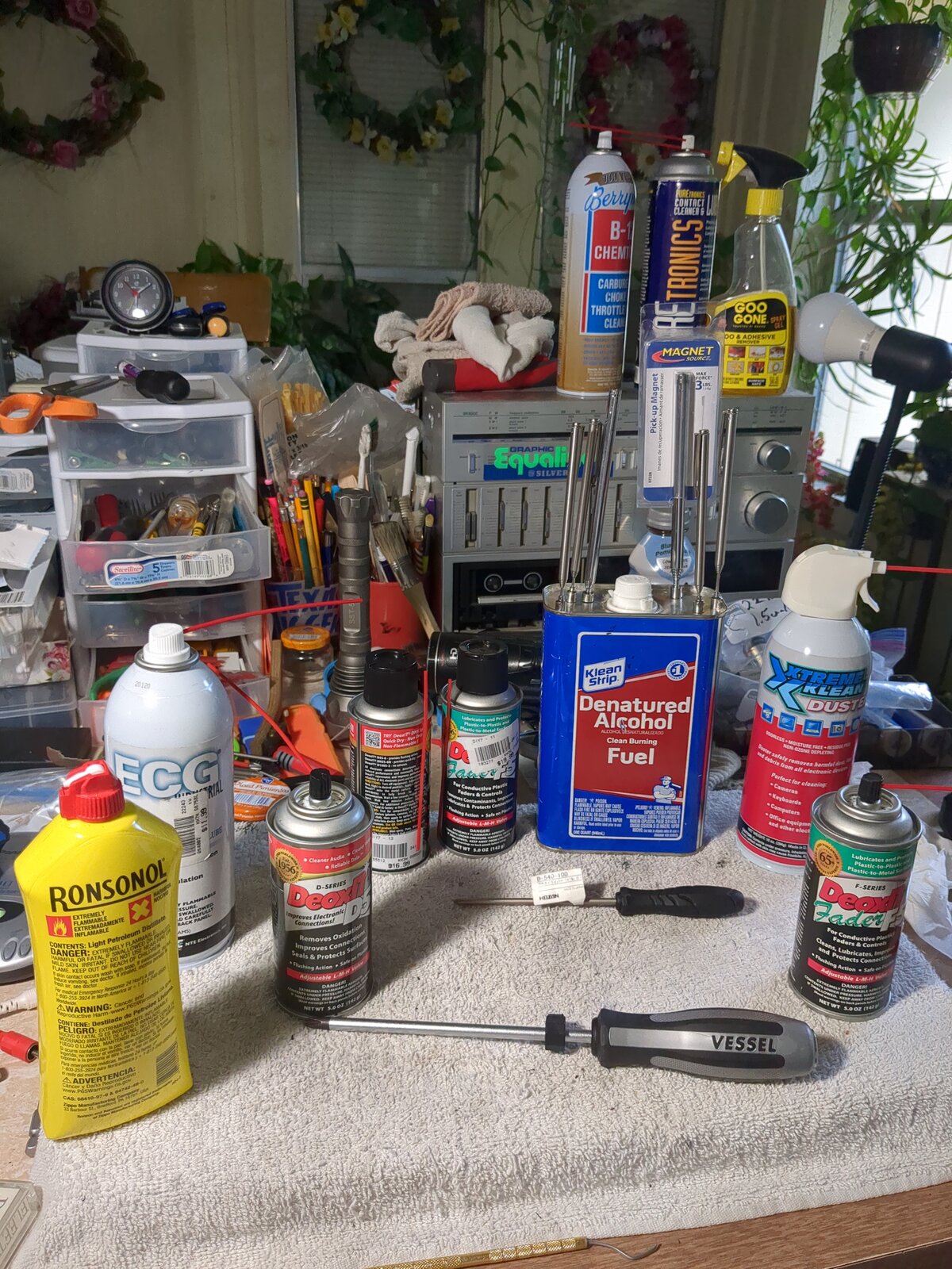

    Yeah you can't go wrong with the vessel brand. Here are the chemicals that I use.
    Jam_On_It likes this.

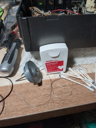

    Now you didn't forget about getting the unwaxed dental floss did you? As this is very helpful in getting the black tar stuff out of the pulleys like I just did in my latest repair that I'm doing now.
    See the black stuff on the floss that I got out of this. Pulley?

    And now you got to be sure that you get the unwaxed because if you get the waxed and that simply compounds the issue of not slipping
