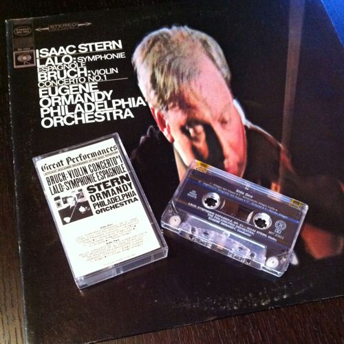

    Try lowering Rec level so that even at Peak it never reaches Zero. See what happens.
    I had the same problem with definitely not pop re-recording this old cassette from vinyl:
