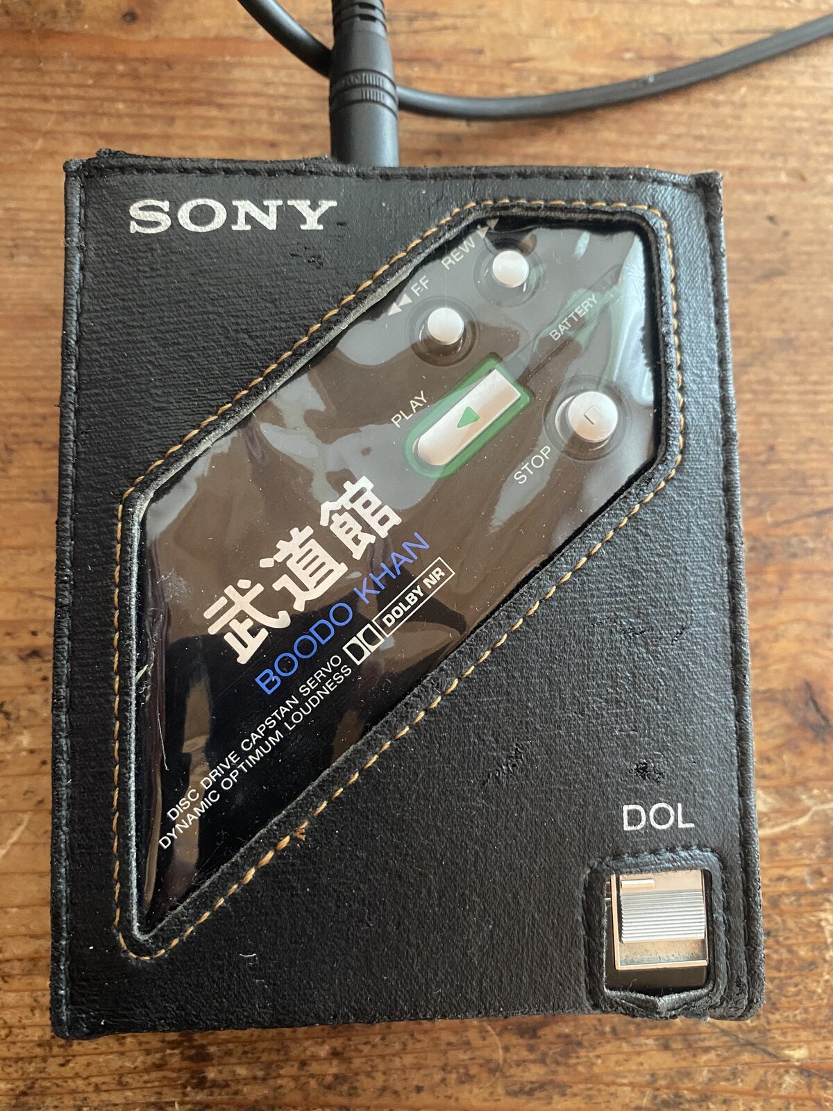

    ...i was thinking of selling my Boodo Khan a while ago but it had issues.
    - the usual centre-gear
    - quite yawly
    - headphones one capsule defect
    - headphones cushions crumbled
    - leatherette window self-recycled (dissolved)
    well, centre-gear and pinch-roller is replaced, also the rubber-ring of the flywheel, head demagnetized and pot cleaned - no clicks, smooth transport and excellent sound
    as for the leatherette i cutted out the window-rests and replaced the window with transparent plastic from a - yes - t-shirt sales-pack...

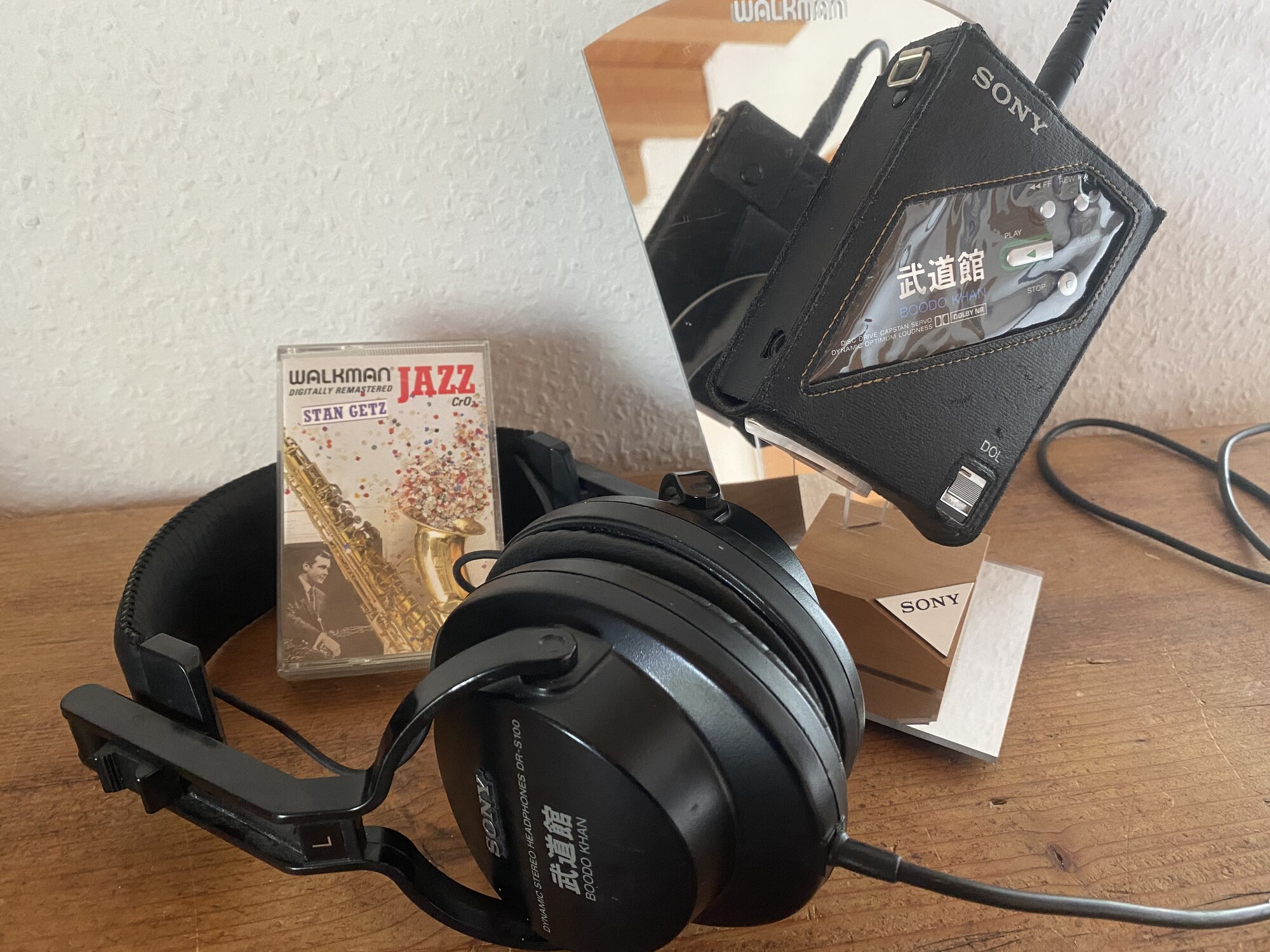

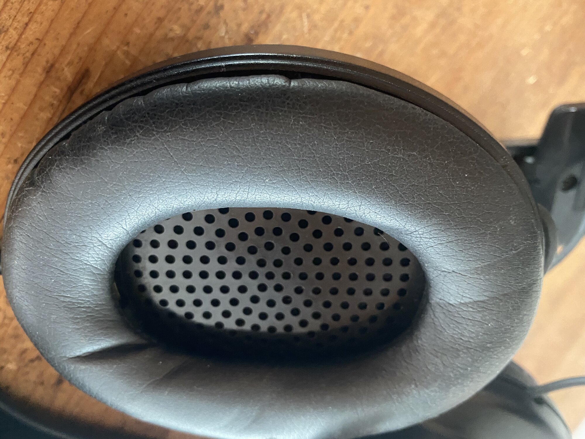

    as for the headphones i bought a 2nd hand pair of the much better DR-S7, used both capsules and made my own crossover (the DR-S7 have pots for sound). another advantage is a part towards your ear with a smooth plate, no dissolving filth and the cussions from DR-S7 also do not crumble.
    now i do have a fully perfect working DD-100 Boodo Khan in great shape with an upgraded and much better sounding pair of headphones.
    final decision: this is a keeper. i have it now for so many years - i rather keep it :yahoo
