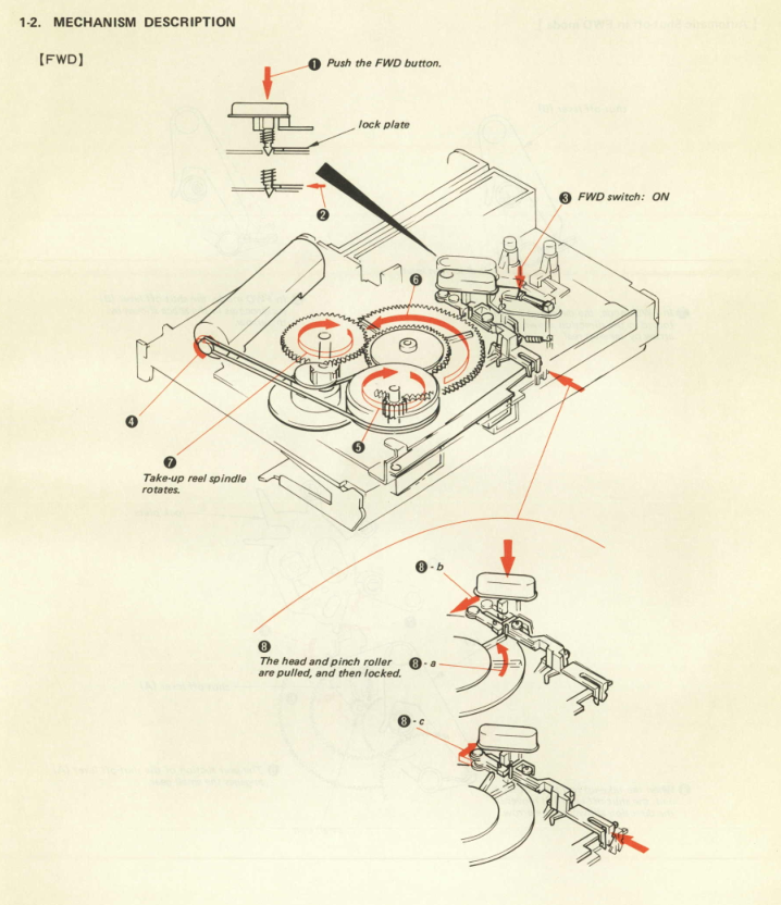

    Another test you can do to confirm there's no other issue is this: with cover removed, batteries removed, press play and rotate the flywheel by hand (clockwise).
    You should be able to make the plastic slider pull the head bridge into position and latch the mechanism into PLAY mode.
    See picture attached for a visual description of what you should see happening. It's from WM-2 service manual, which uses a same, but belt driven mechanism.
    You will feel increased resistance when the slider starts pulling the bridge into position, that's normal.
    The slippage also explains why FF and REW do not work under load (with a cassette in). There's just not enough friction between motor spindle and rubber ring.
    As a sidenote, pinch roller will not cause the mechanism to not engage, but if it's glazed it should be replaced anyway.

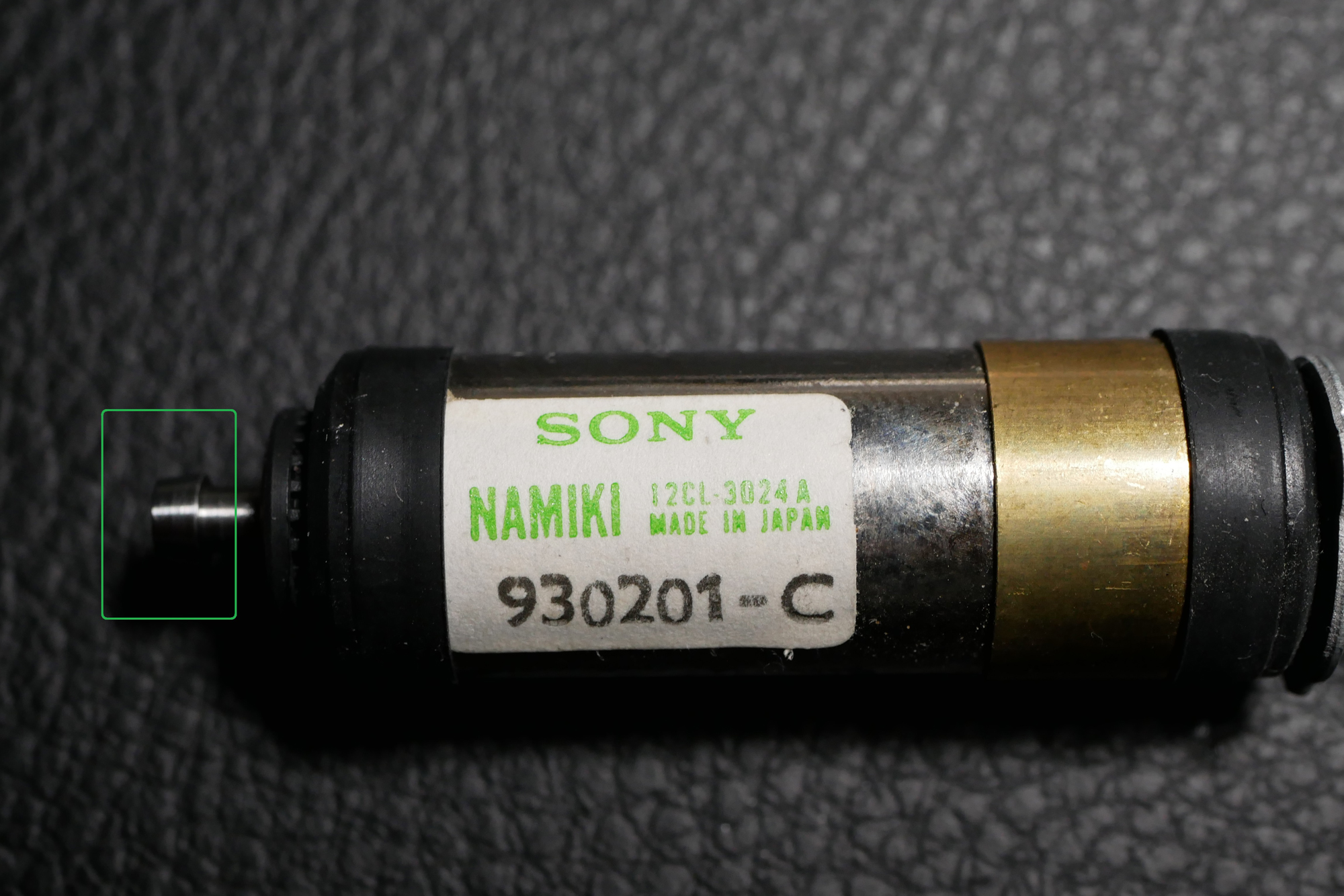

    Thanks for the info! Which one is the motor spindle? I guess it wouldn't hurt to clean both the parts just to be safe. Should I add new grease or something after I clean it or will it be fine without it?
  4. Valentin
    1,549
    I attach a picture with motor spindle. Clean both, there's nothing to grease both parts should be clean even from fingerprints.
