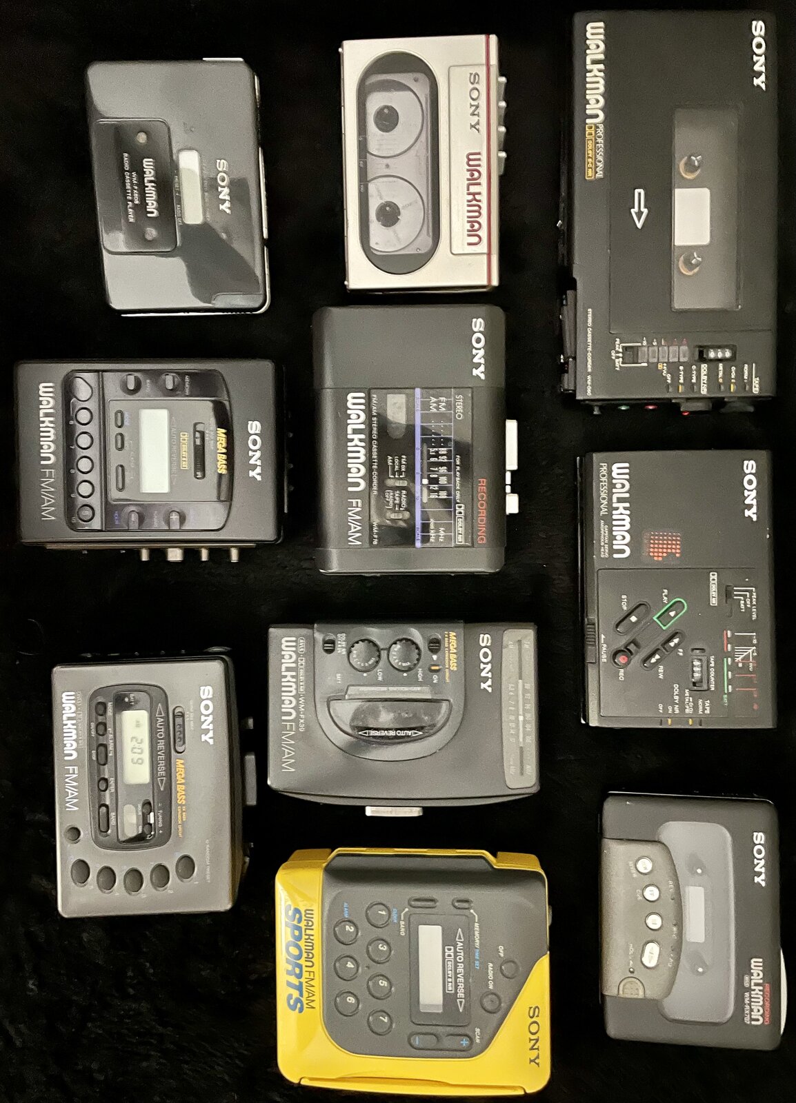

    4EC3C7BD-3D86-4EA8-91F7-963B0E2EA088.jpeg Here are some of the units in my collection I’ve got up and running in the last year. Some were very easy fixes, some downright ugly. I’m sure by looking at the pic, you can guess which Walkman was the culprit of needing complete disassembly…lol
    The WM-D6C has been with me for over 20 years and the RX707, while nothing particularly special about it, has a special place in my heart for ‘reasons’ and is my daily Walkman.
    Still working on restoring my Toshibas and Panasonic units. The Sonys were the priority as each one of those Sony Walkmans in the pic has a story attached to it.
    Still working on a couple of Sonys, a WM-FX43 and a WM-701C.

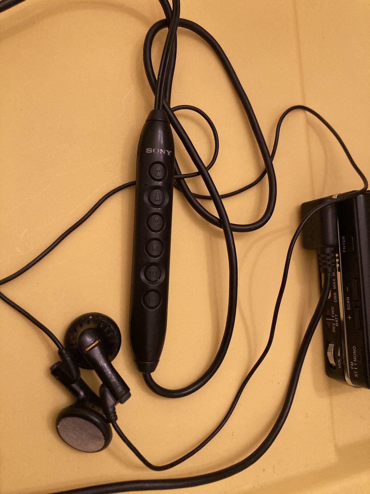

    Also, do you have the original remote? Mine only seems to power up with a remote connected, but it's one from a different model so the functions don't match.

    I have the original remote (with permanent ear buds) for the F701C. There’s 2 additional buttons for band and channels.
    Both units, 701C and F701C, power on without anything connected to the 9 pin connector.
    You can find a 9 pin adapter to mini plug on eBay as well.

    Ok. Thanks! Good to know. I have a couple of those adapters. So...it seems that my troubleshooting just got more complex. Cause this thing only shows signs of life with the/a remote connected. The adapter, nada.

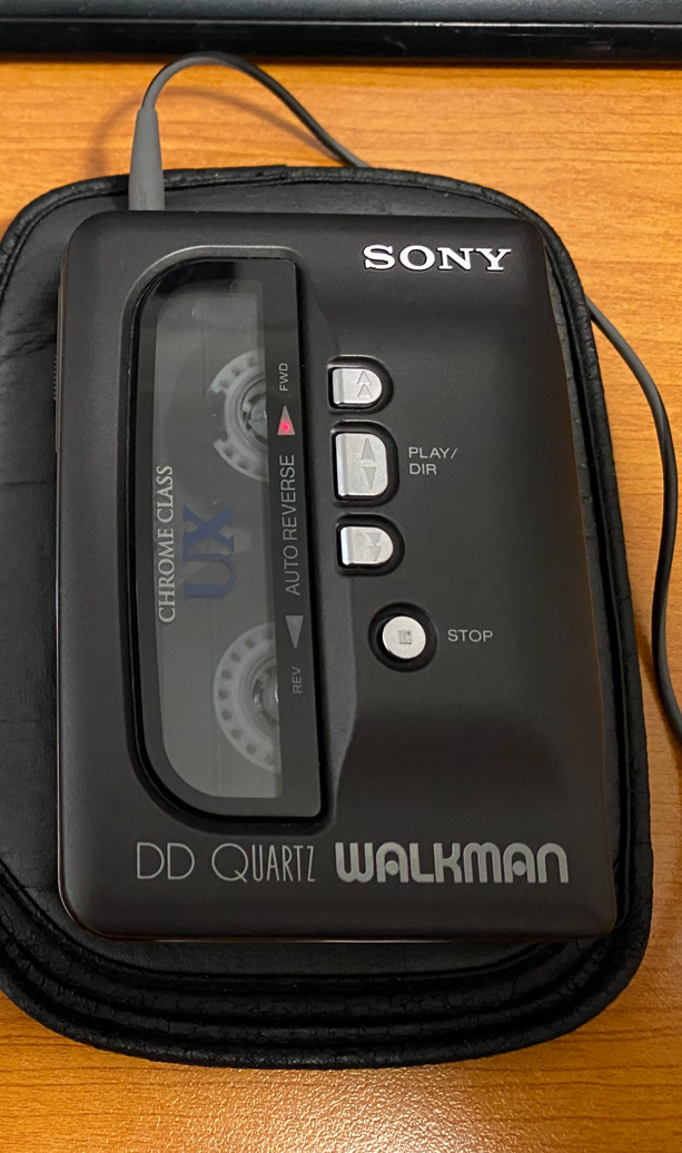

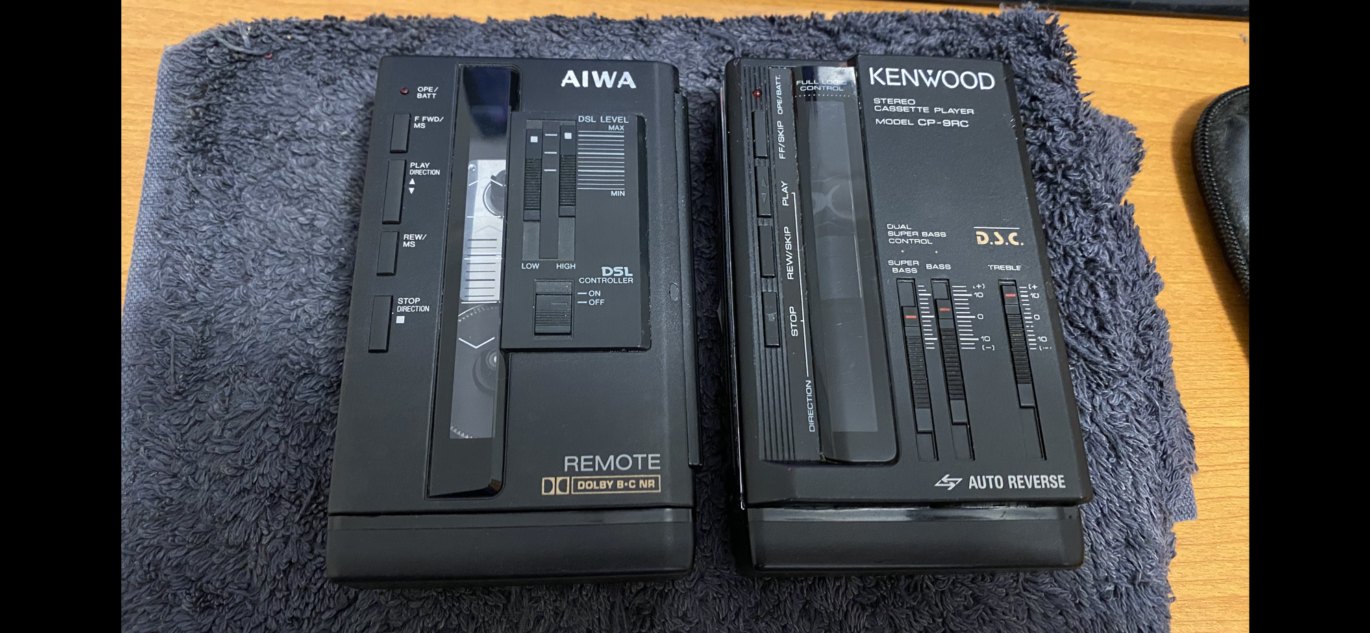

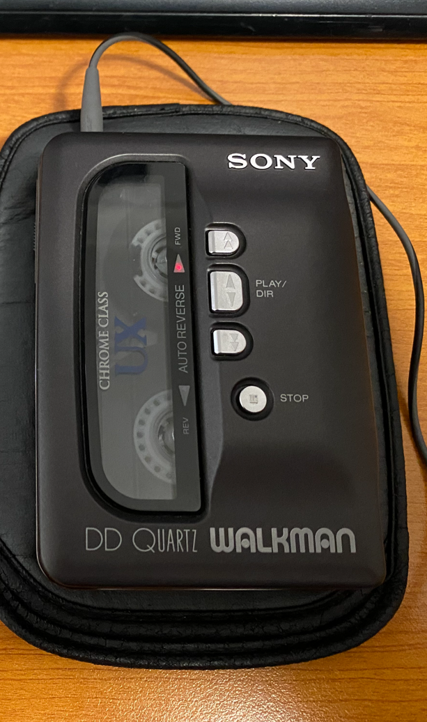

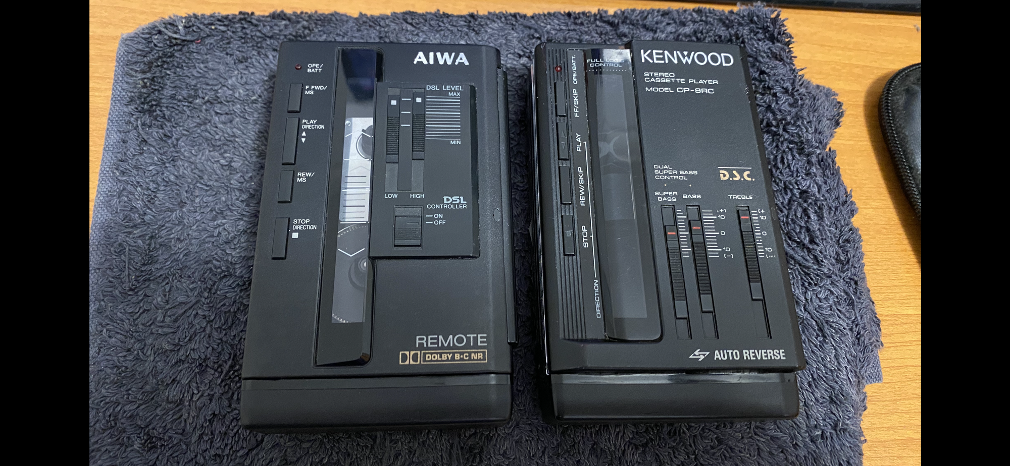

    I had around 55 walkmans I had restored over the last 4 years and scaled that back to just these 3 :)

    You'd have to sell off your collection just to pay for that DD Walkman!
    But, seriously, I love all three of those. Thanks for sharing!

    No I just had too many and they would never get used which is the worst thing for a walkman
    Thanks yes the DD9 is amazing and handles my TDK SAX90 chrome tapes fantastic.
    No wow or flutter
    Both AIWA's play all my other tapes great but the TDK SAX 90 chrome they struggle with wow flutter but only certain tracks like Bohemian Rhapsody :)

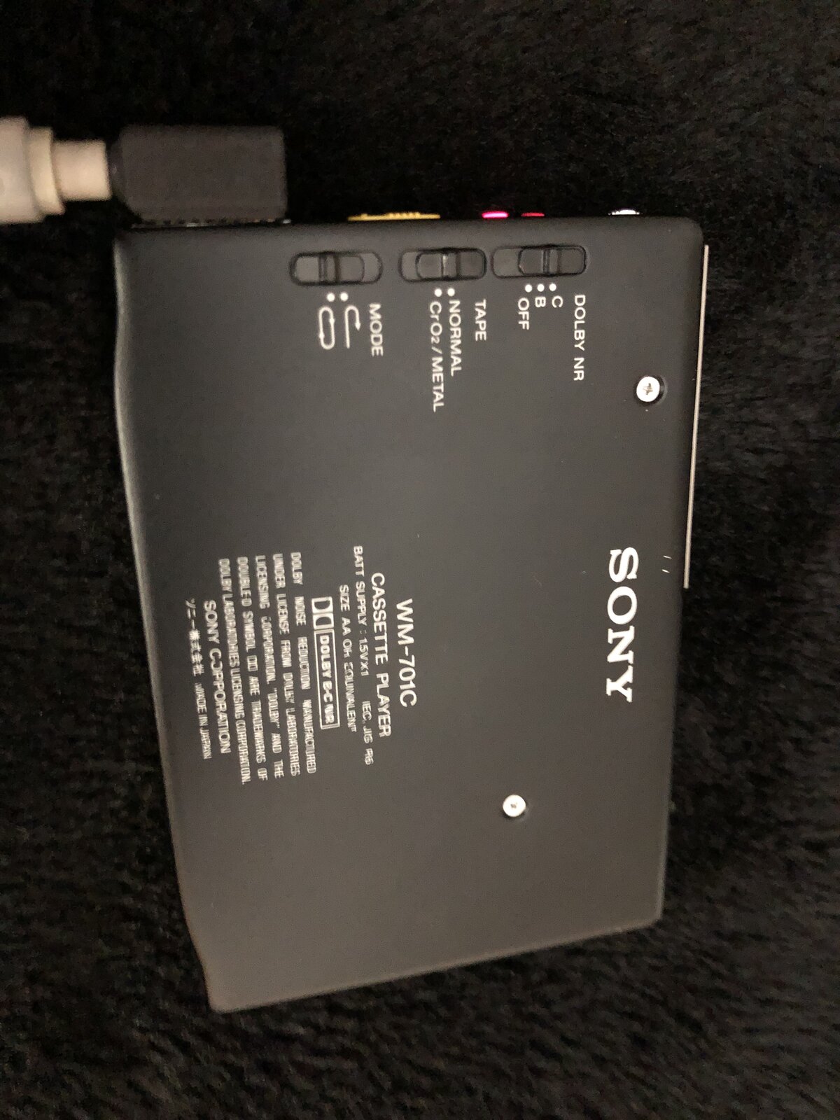

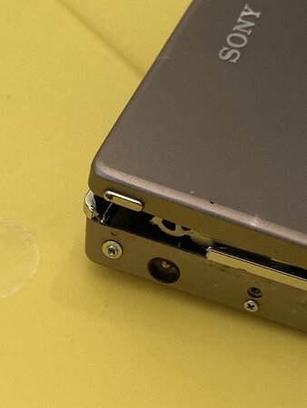

    Well, finally… 65C2B0D4-1696-441B-903F-504F1A25D5E9.jpeg I now have Dolby C in my back pocket. Sure glad to get it running. Came from Japan as Junk. It’s anything but imo.

    Thanks! It sure does sound pretty decent. Got new pinch rollers and main drive belt. It came as a non working unit that wouldn't power up. The unit itself is in excellent condition so I'm glad I was able to save it from staying in a junk pile.
    It's also nice to finally be able to play back my tapes using the correct Dolby C they're encoded with. I always record in Dolby C, but portablely without my WM-D6C, I've always just settled with playing my Dolby C tapes using Dolby B with somewhat satisfactory results but far from ideal. :)
