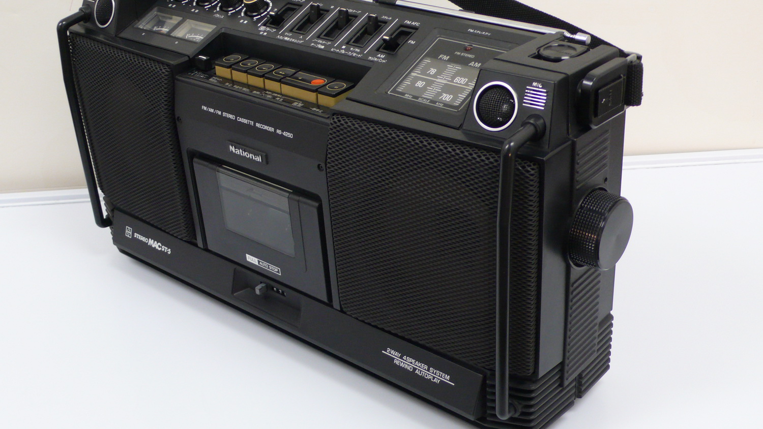

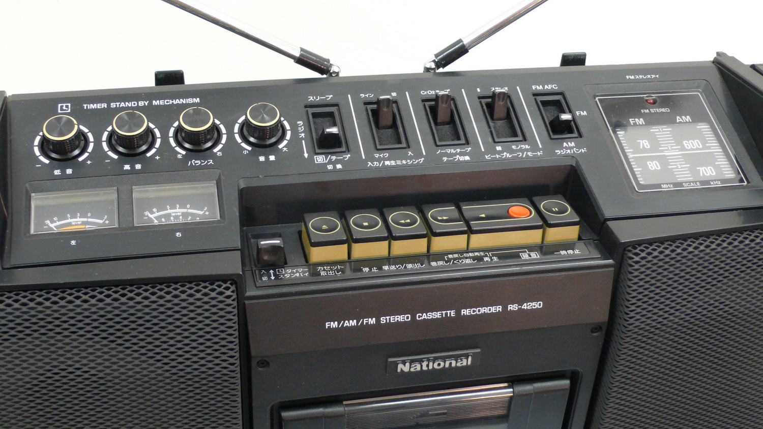

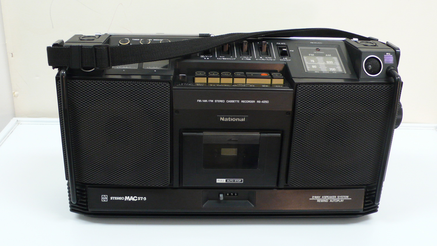

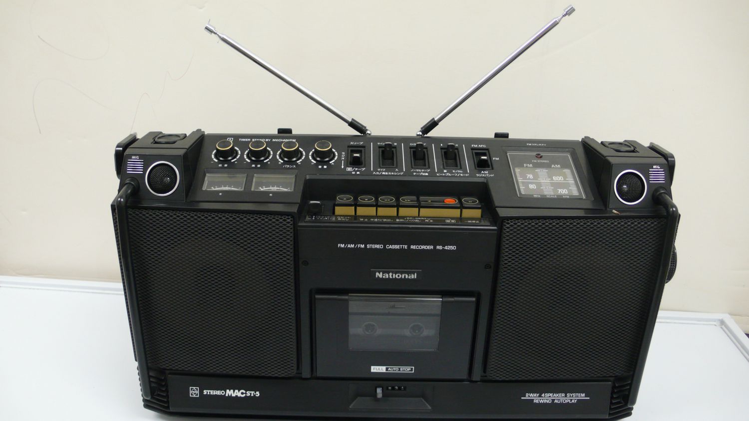

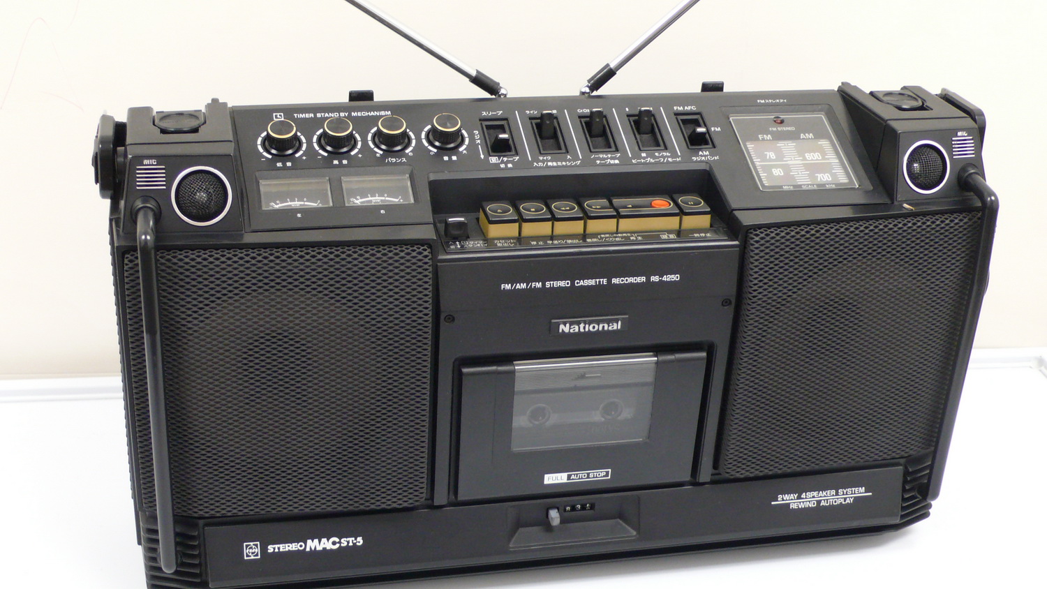

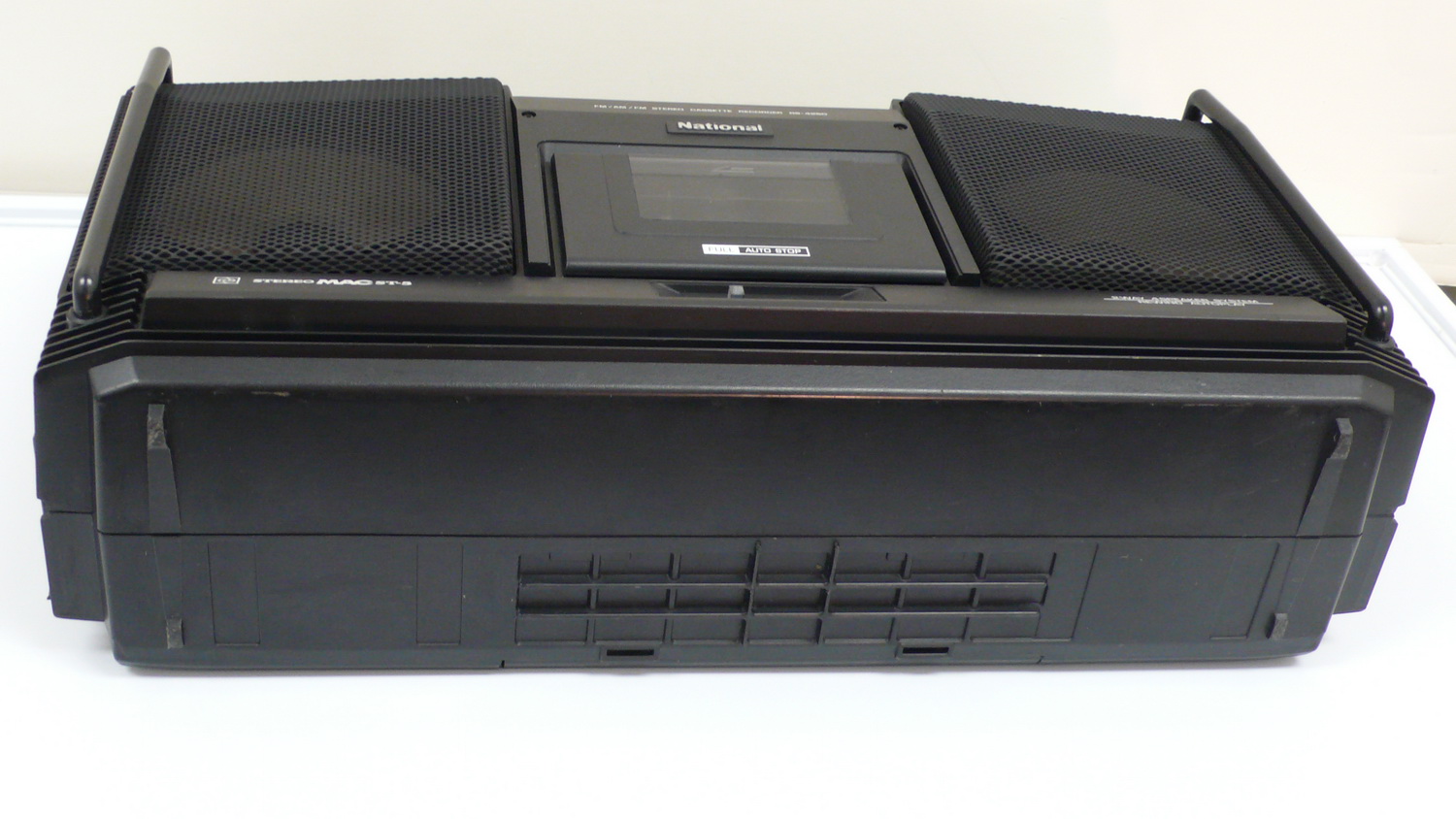

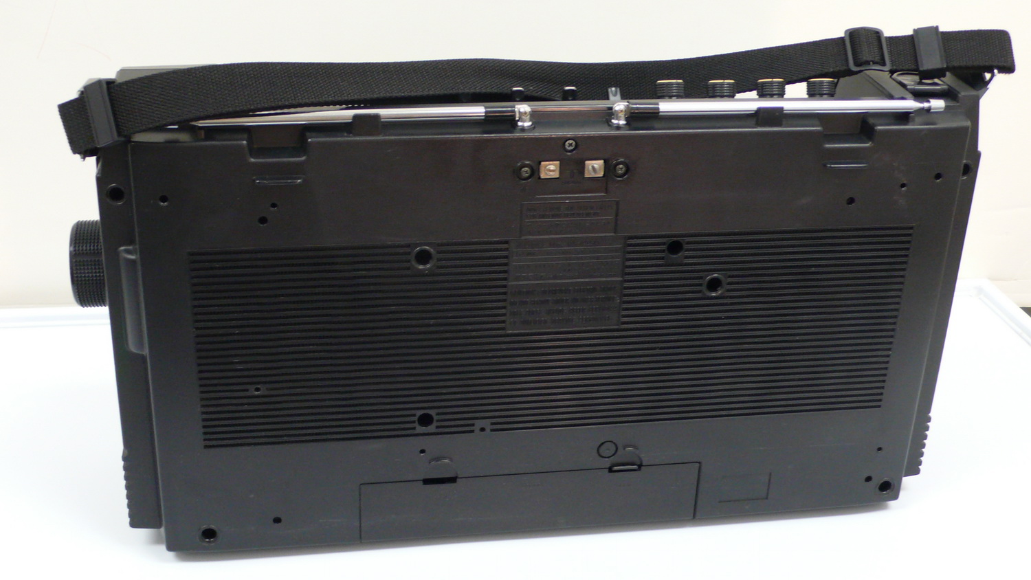

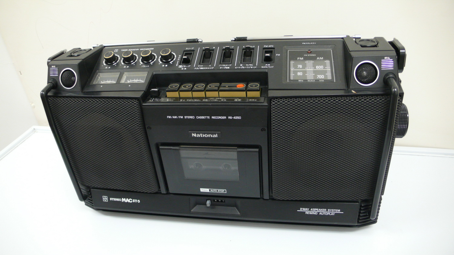

    Japan-only model from Panasonic, RS-4250 is truly beautiful:

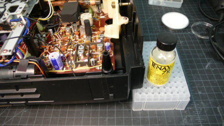

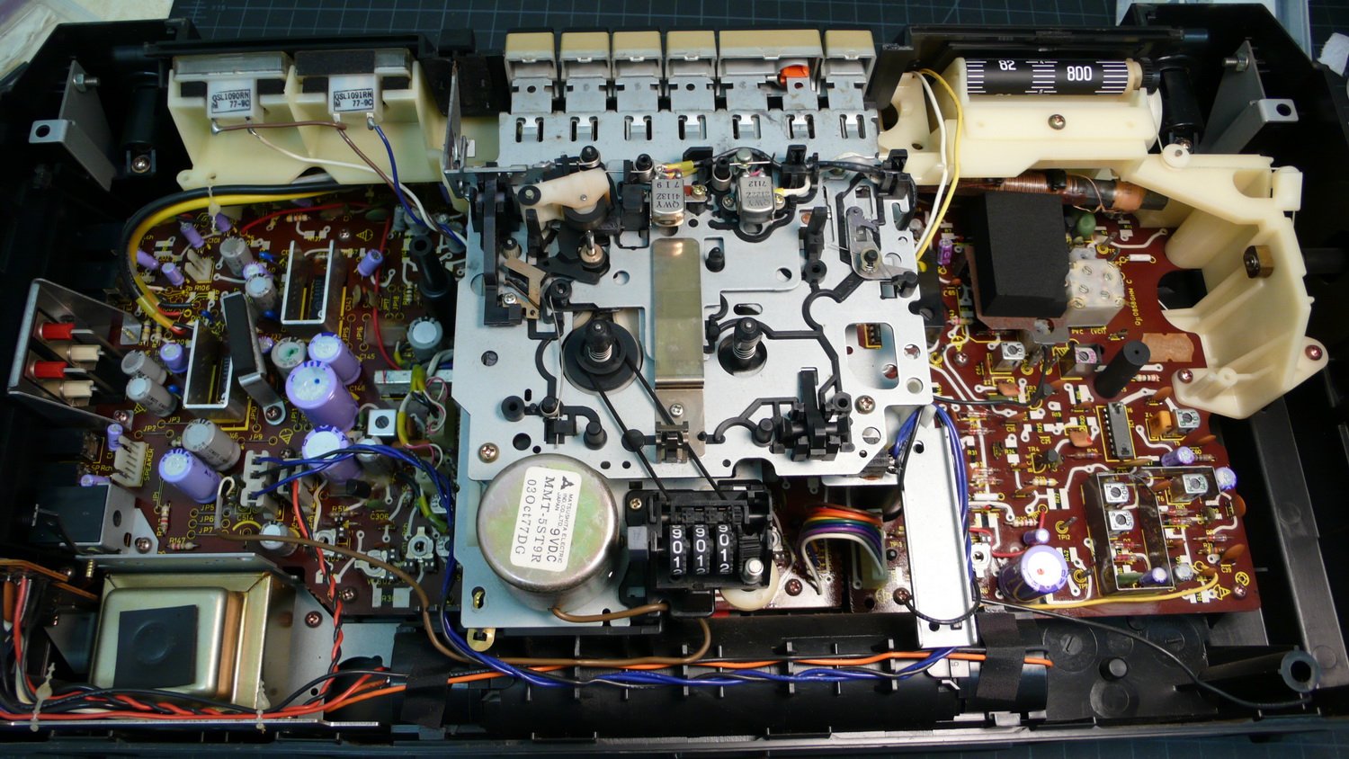

    As received, Black Beauty had one broken antenna "fixed" by SuperGlue, and with cassette mech frozen.

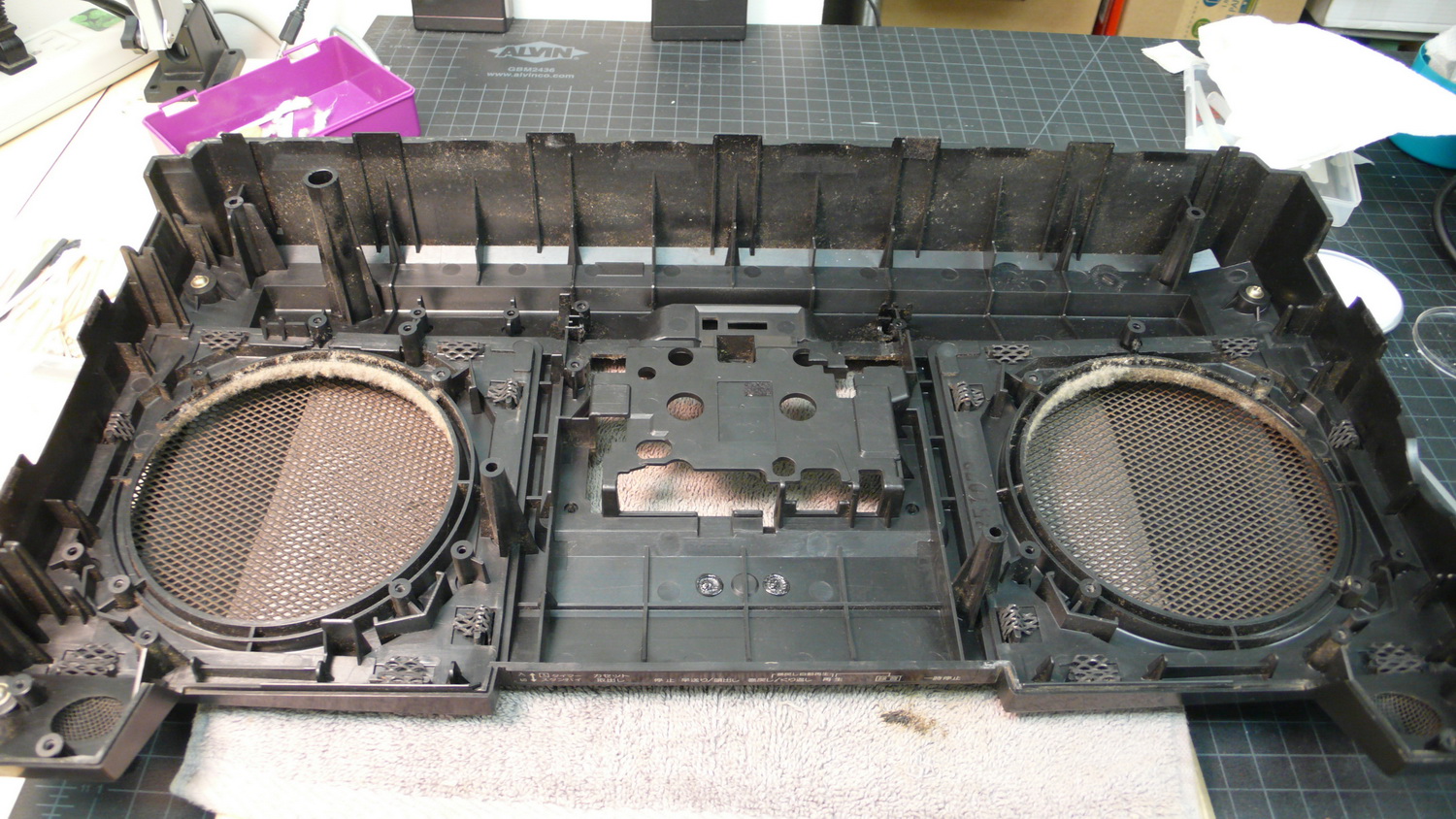

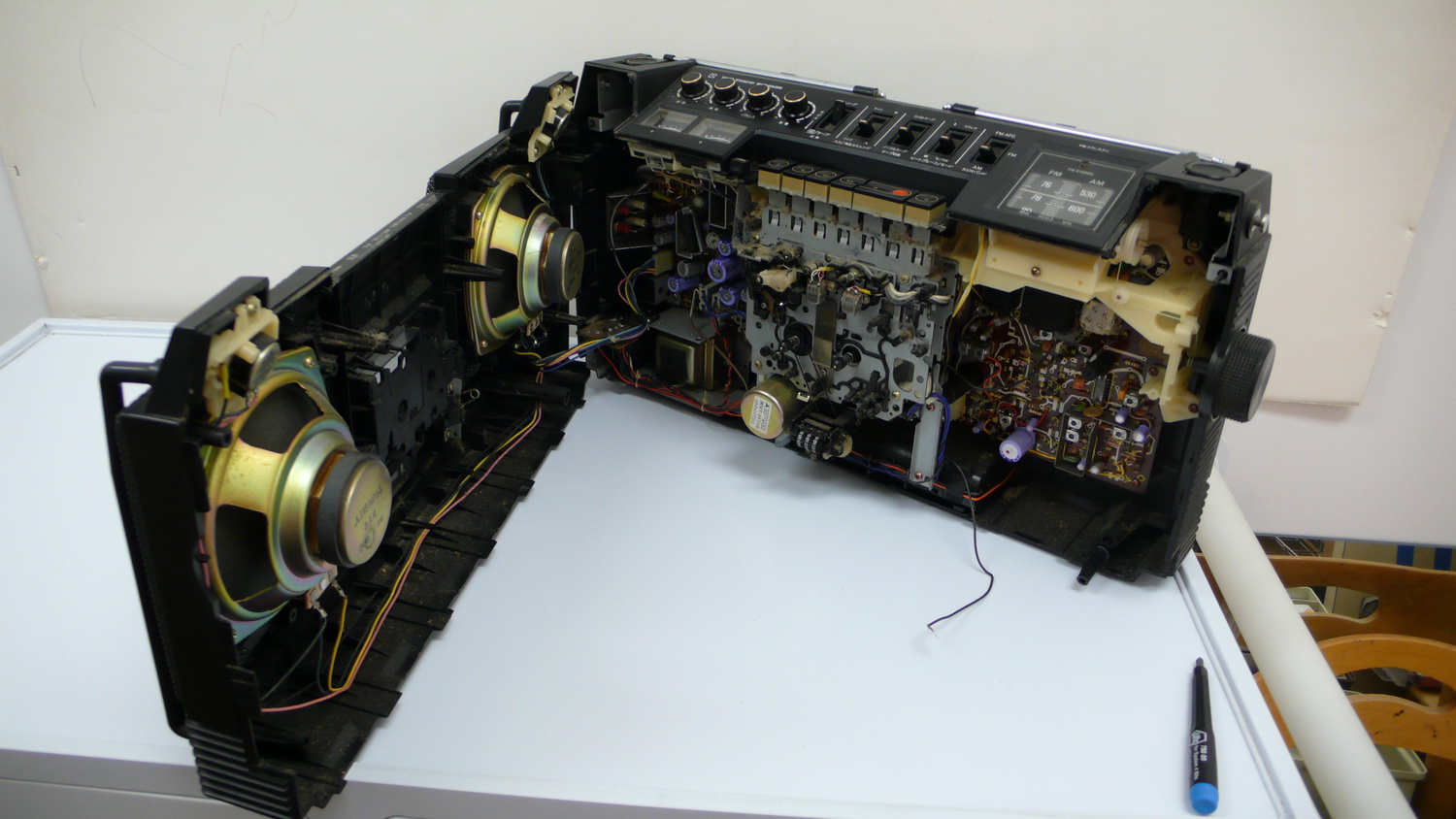

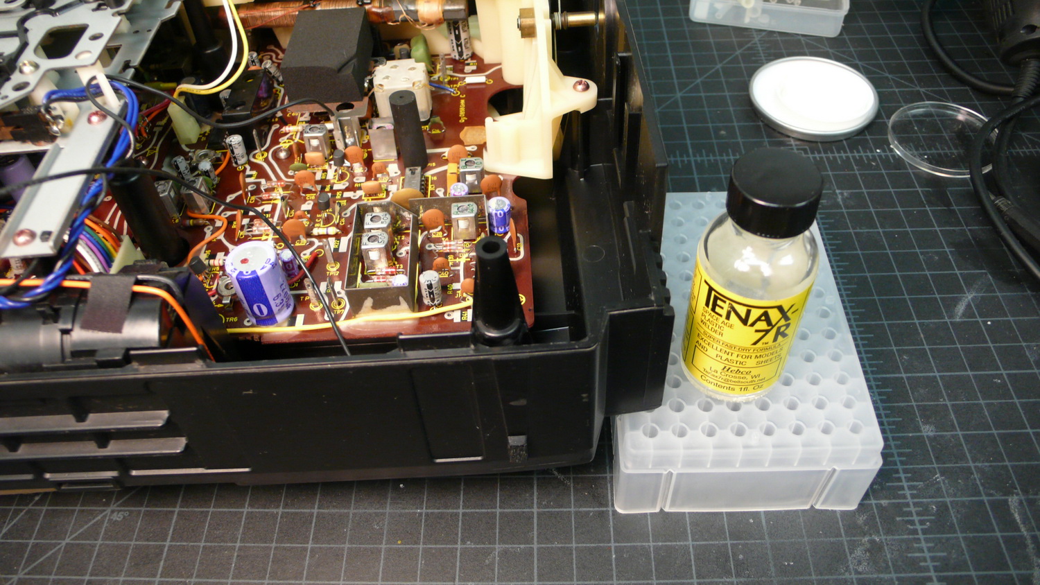

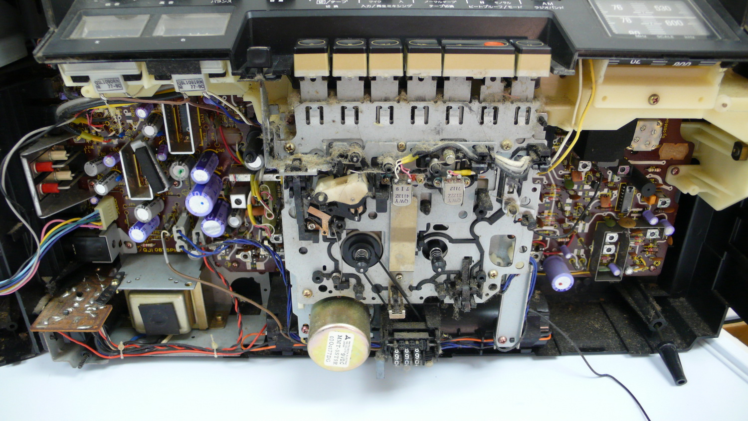

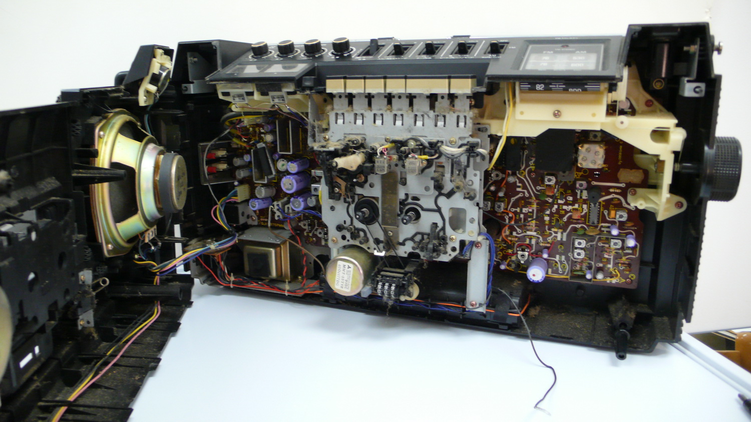

    Very easy do disassemble:

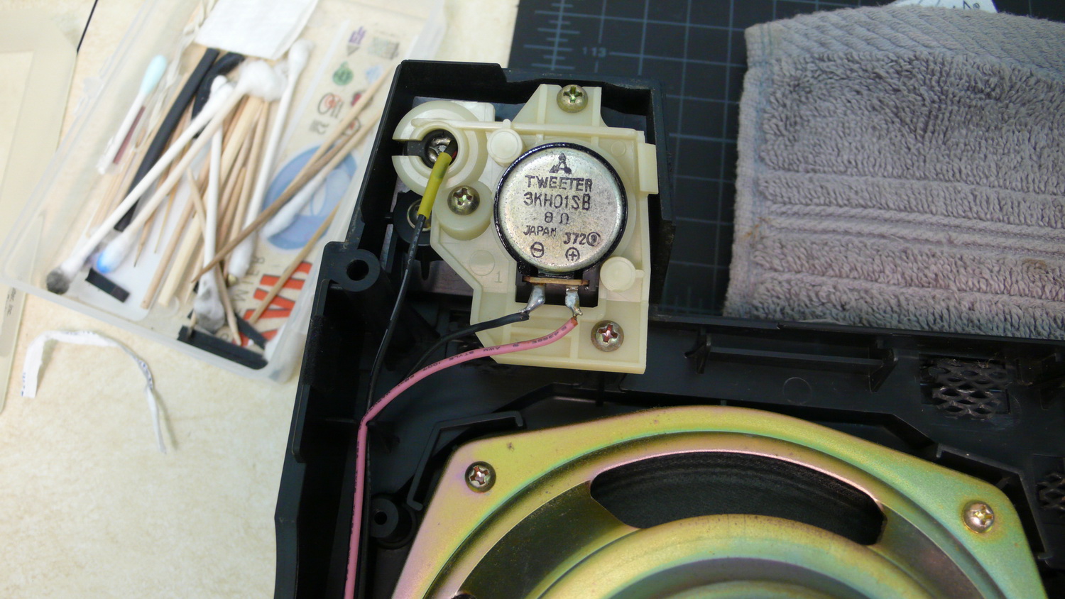

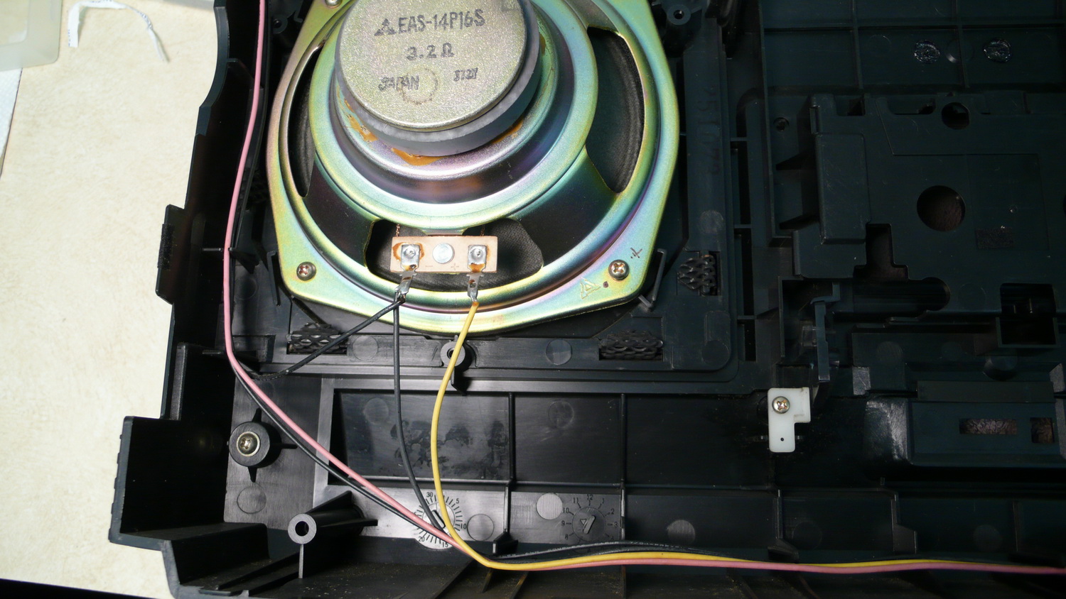

    Foam pads sticking from the back into the woofer magnets give that extra bit of Sound Quality:

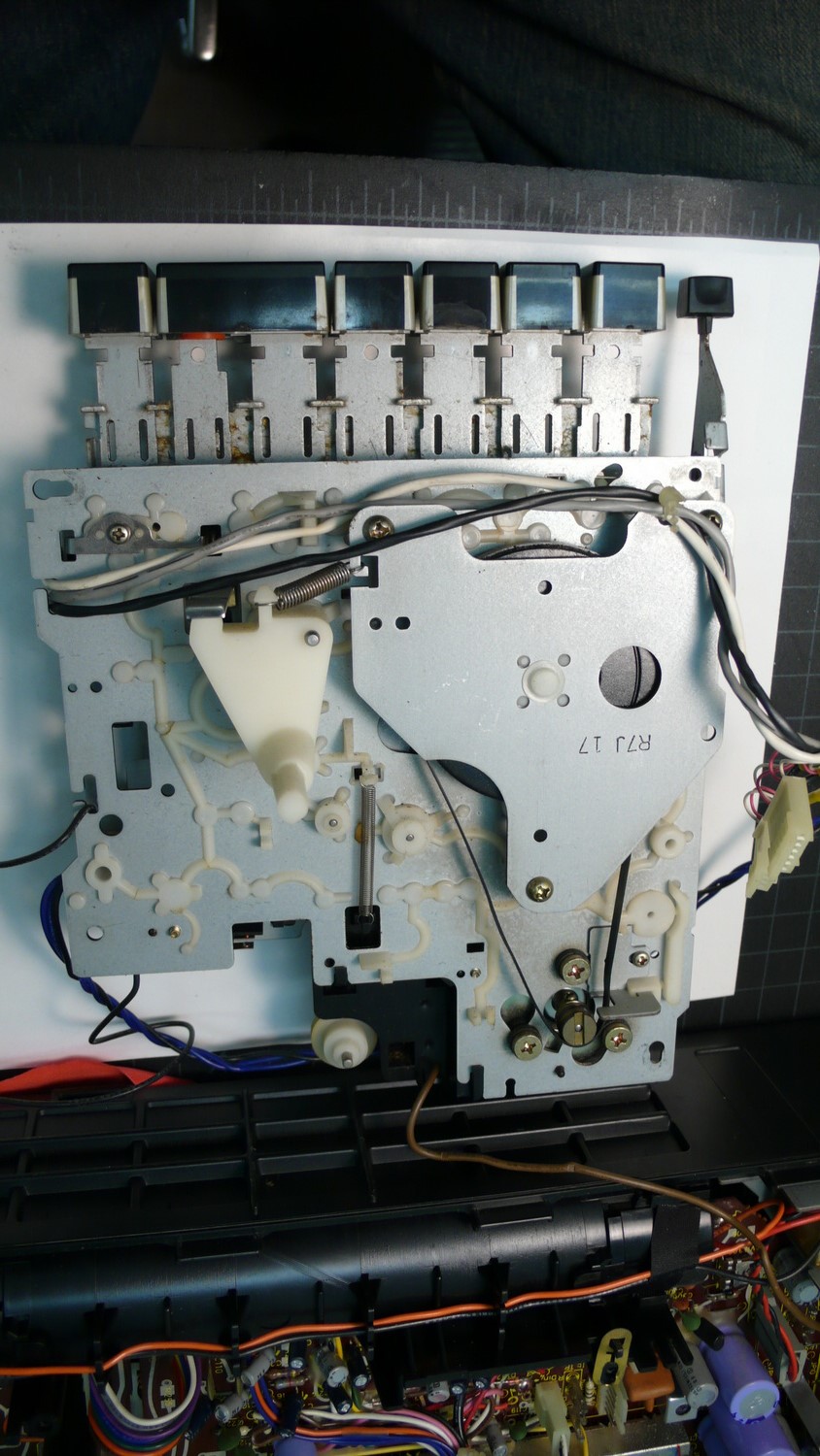

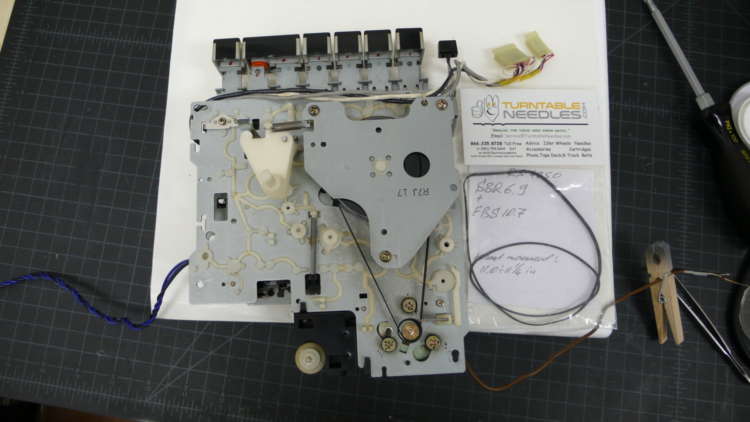

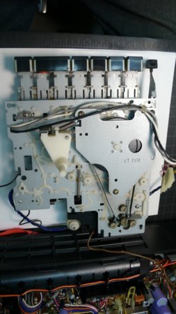

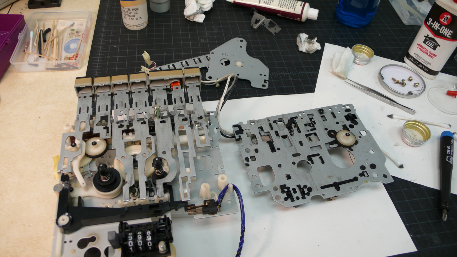

    Cassette mechanism is simple and solid:

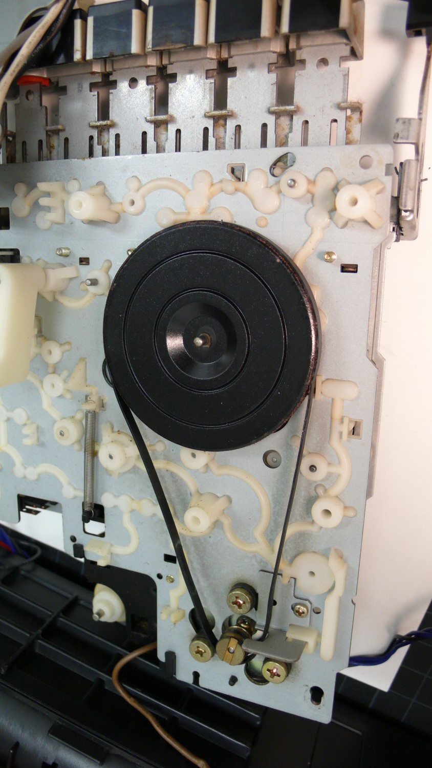

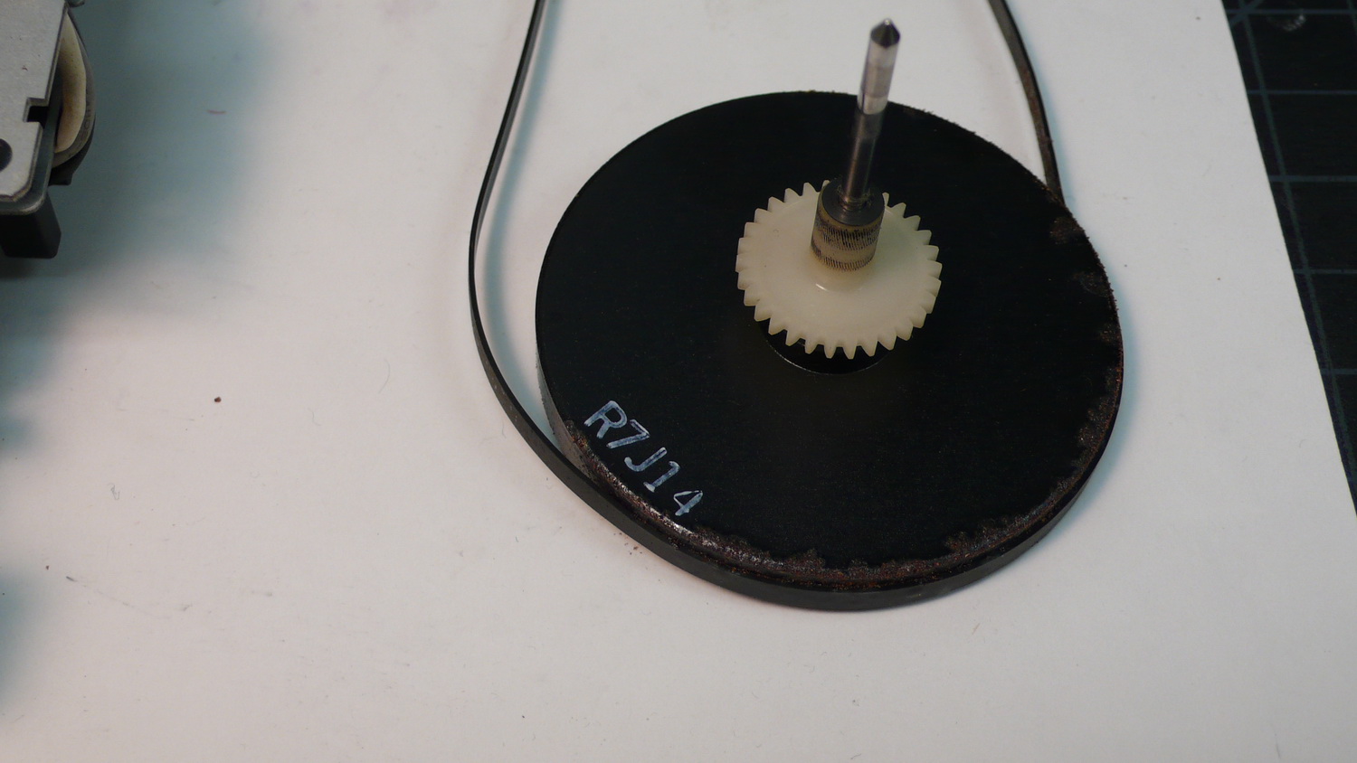

    Belt got rock-hard and fused with a flywheel:

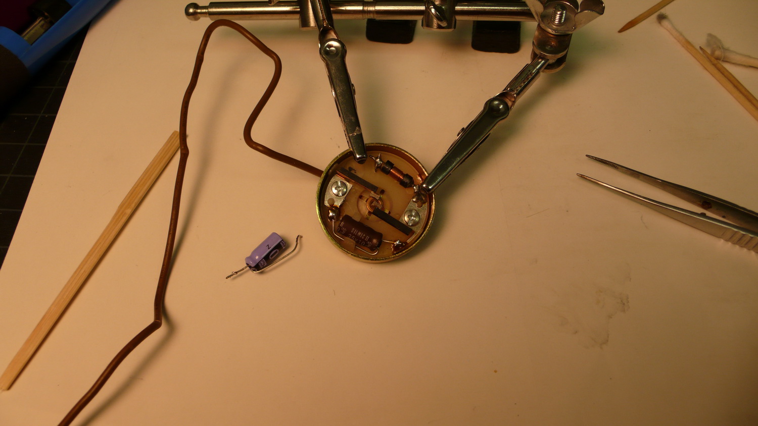

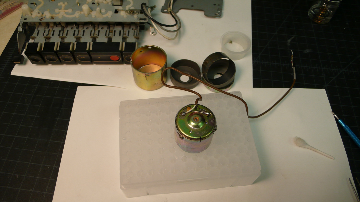

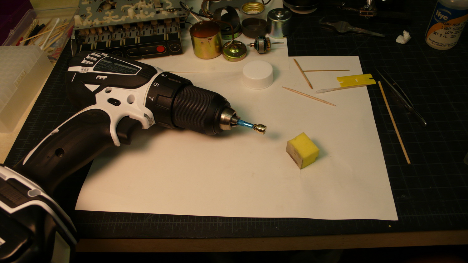

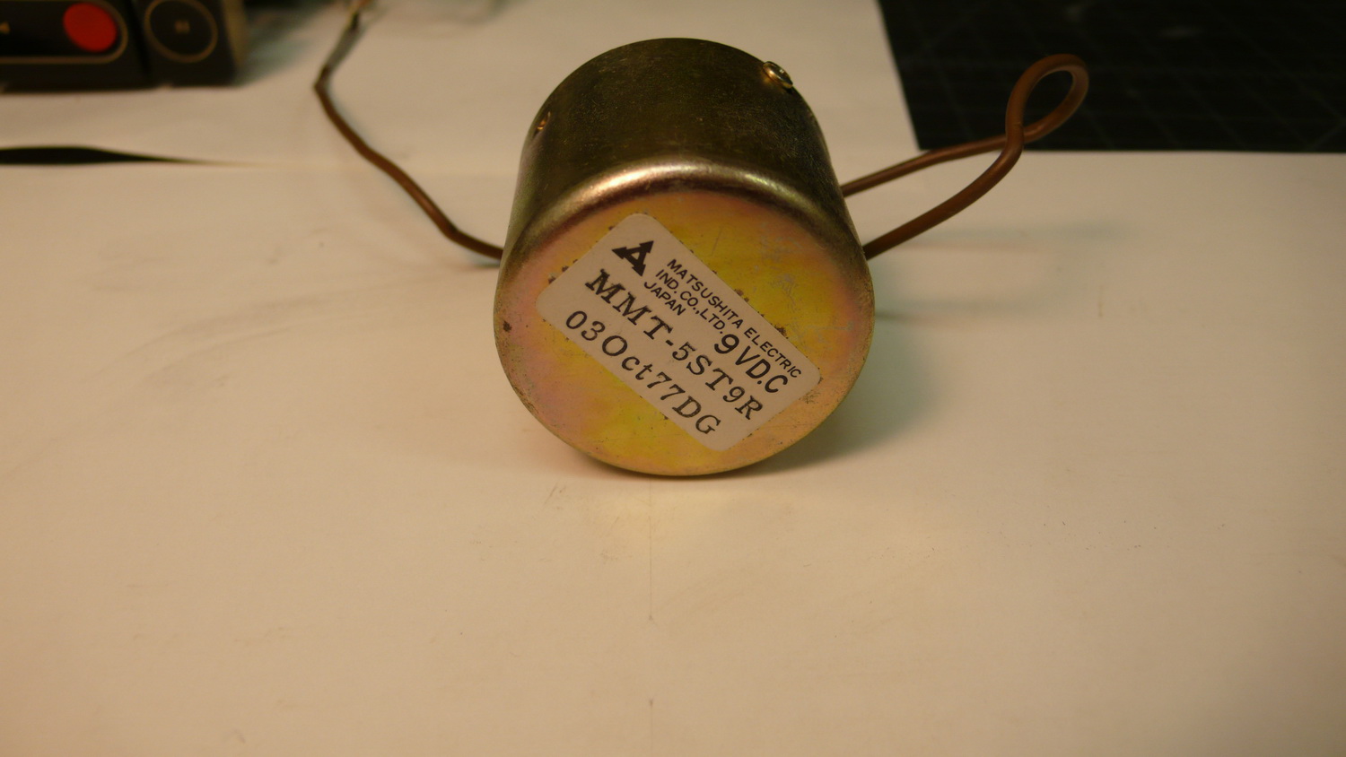

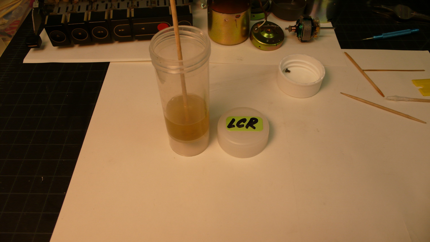

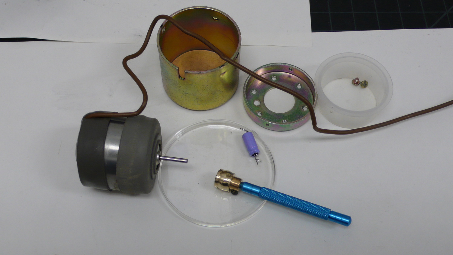

    Motor was disassembled, re-lubed, re-capped:

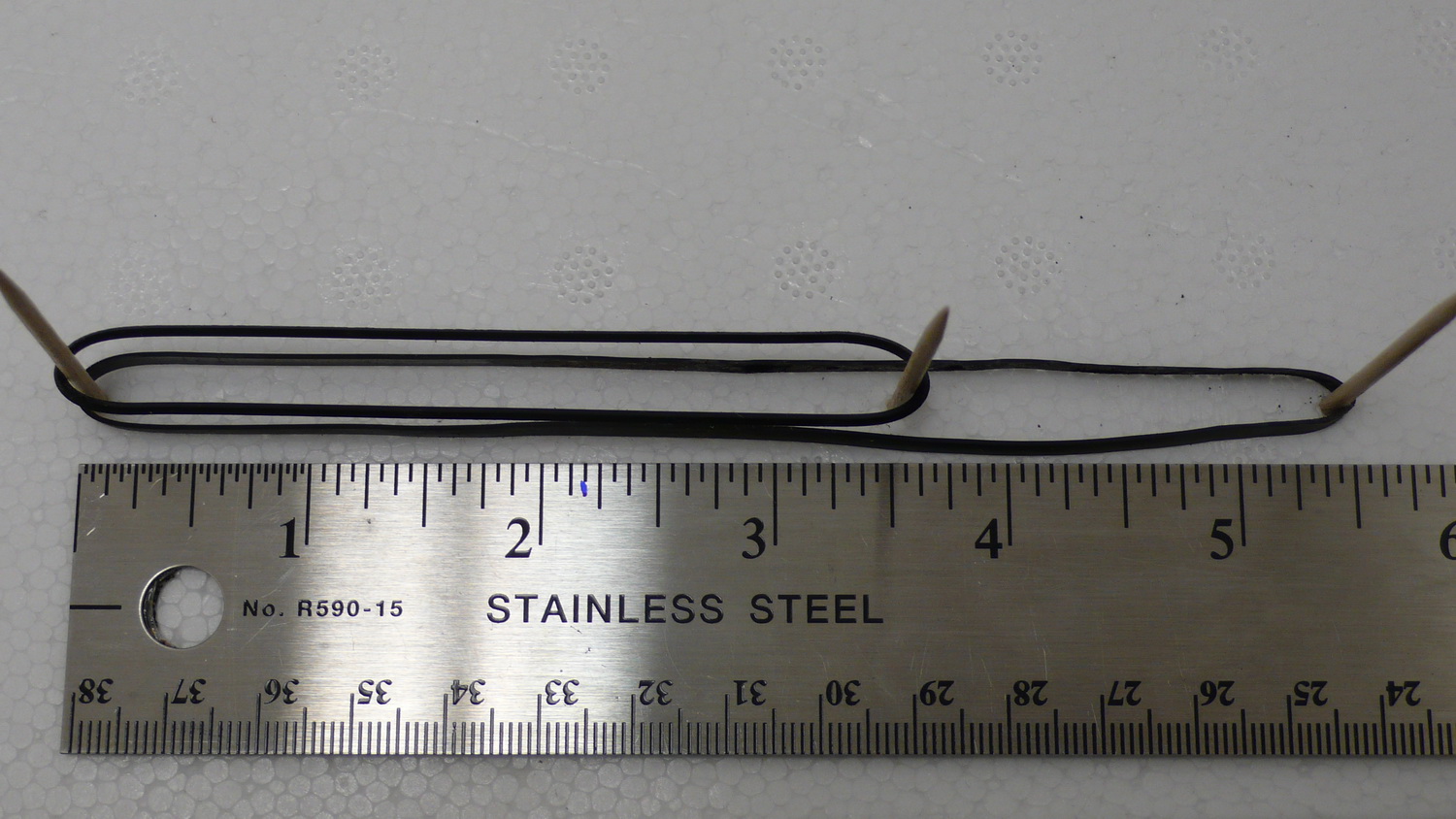

    SBR 6.9 and FBS 10.7 fit nicely:

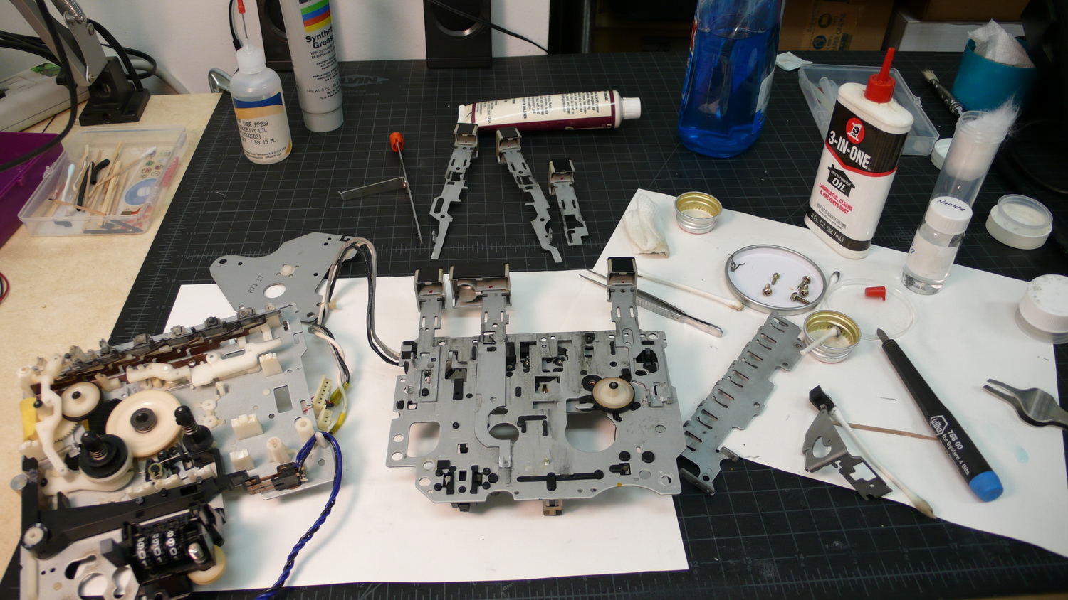

    This once, I decided to go through complete disassembly of its cassette mechanism. Unless absolutely necessary, I will never do this again!
    Polishing, then fixing broken post:
    drivers:

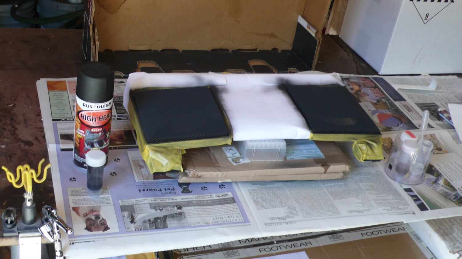

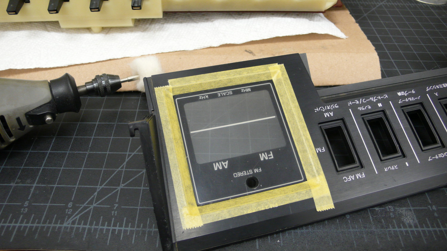

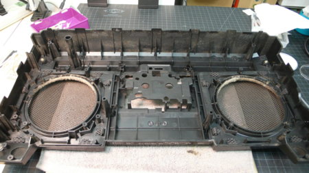

    getting rid of dust bunnies and repainting the grills:

    Amazing restoration. Thanks for sharing these pictures.
    Did you paint the speaker grills?? (as I can guess from last picture)
  3. Jorge
    1,754
    Thank you! And yes, High-Heat and Engine Enamels with Ceramic are the toughest paints on this side of epoxy: siphoned from the can and sprayed with Iwata airbrush. Always a good idea to spray just a Lacquer Thinner first, to "soften" an old paint so that new layer will get a better "bite" onto surface :)
