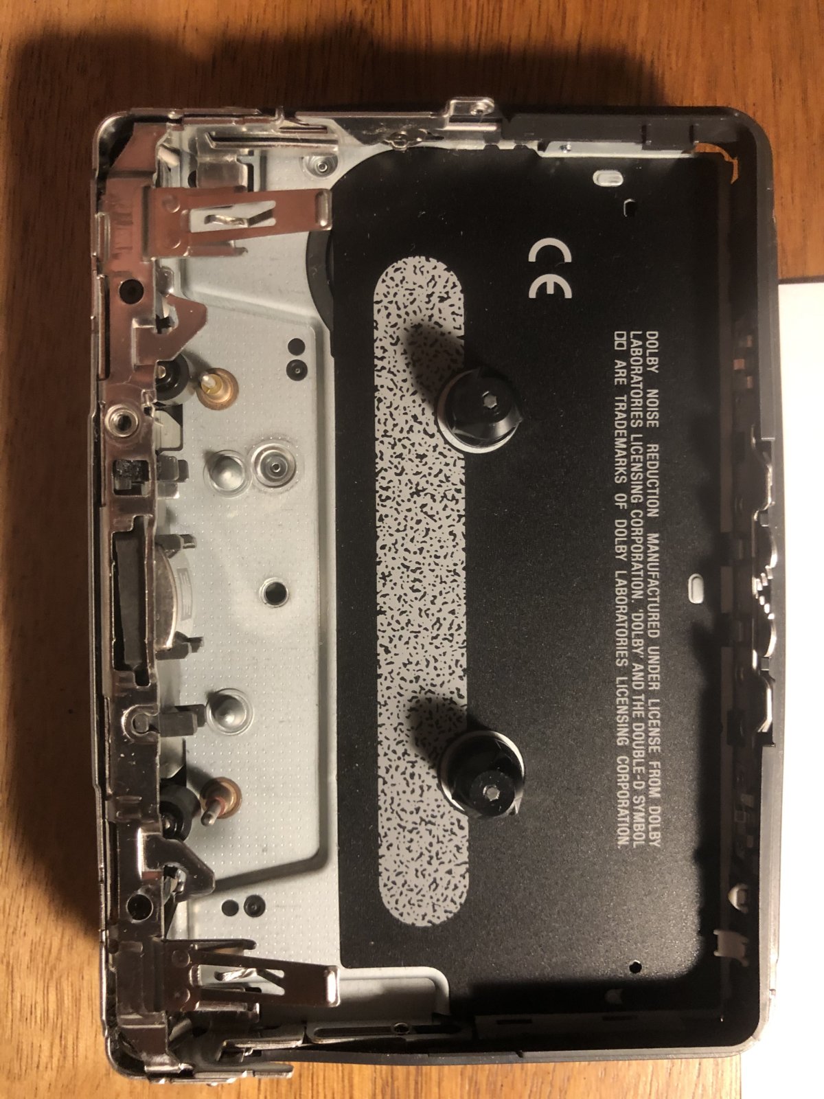

    Thanks for your help guys. Sorry for not replying sooner as I was busy and couldn't get to it at the time. Today I decided to take a crack at it and I found Some interesting stuff. My belt seems to be completely fine but I've already ordered a replacement just to make sure it lasts. Anyways first thing I noticed while snooping around is that the head looks a bit crooked, I'm not sure how to fix it though or if it even needs fixing and that's just how it is. Second is the rattling I heard seems to be from the right pinch roller and it seems to have come loose a bit and I'm not sure how to fix that either. Lastly I still don't know why the cassette isn't sticking with the door but I suspect it has something to do with the pinch roller being loose. If you guys have any tips please let me know I'm desperate to get this fixed before the holidays is in full effect. I will Include pictures and a video file below. Thanks Again!
