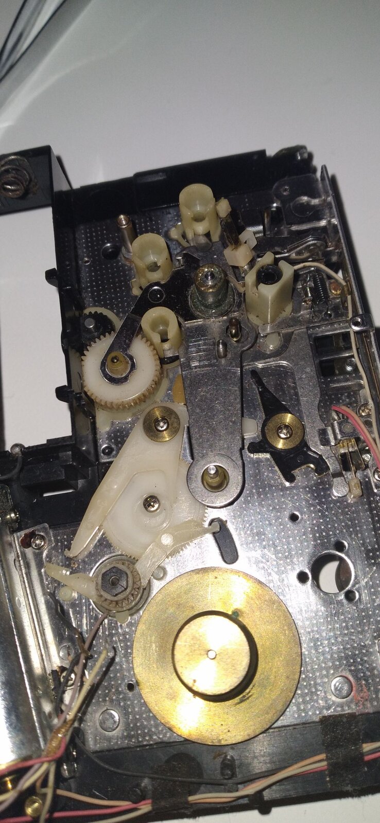

    Thanks for the advice. As of now I'm attempting to remove most of everything just to get to the button mechanisms to try to fix them. Though, I've came across a little hurdle. The gear arm just wont come off, and I'm unsure why. Every other video I've seen featuring similar models (WM-2, WM-DD Series) shows them removing the washer, and the arm coming up with no problem. Yet mine seems to not even budge. Am I doing something wrong?

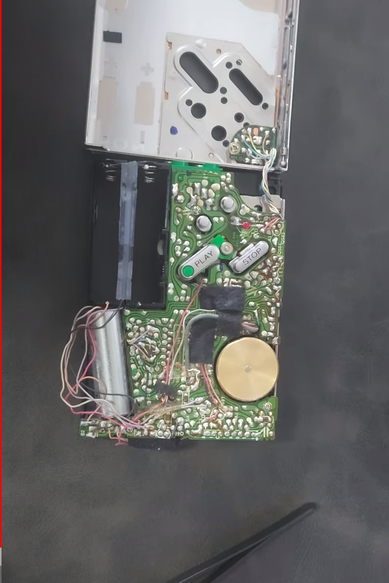

    Update. Now a new problem has arisen. After desoldering the wires on the audio board to get to the mechanisms, upon resoldering them to test the mechanisms with power, I've been unable to get any power. Does anyone have a WM-5 I can reference the wire positions and such on?

    In regard to the electronics, among others check the capacitors: if they're CE brand they are probably leaky. You board seems clean though, so I presume they're a different brand.
    If caps are not CE brand you can leave them alone. Will check to see if I have a picture with where the wires go.
    Do pay close attention to the polarity, as you're likely to burn the motor servo if you solder the wires in the reverse polarity.

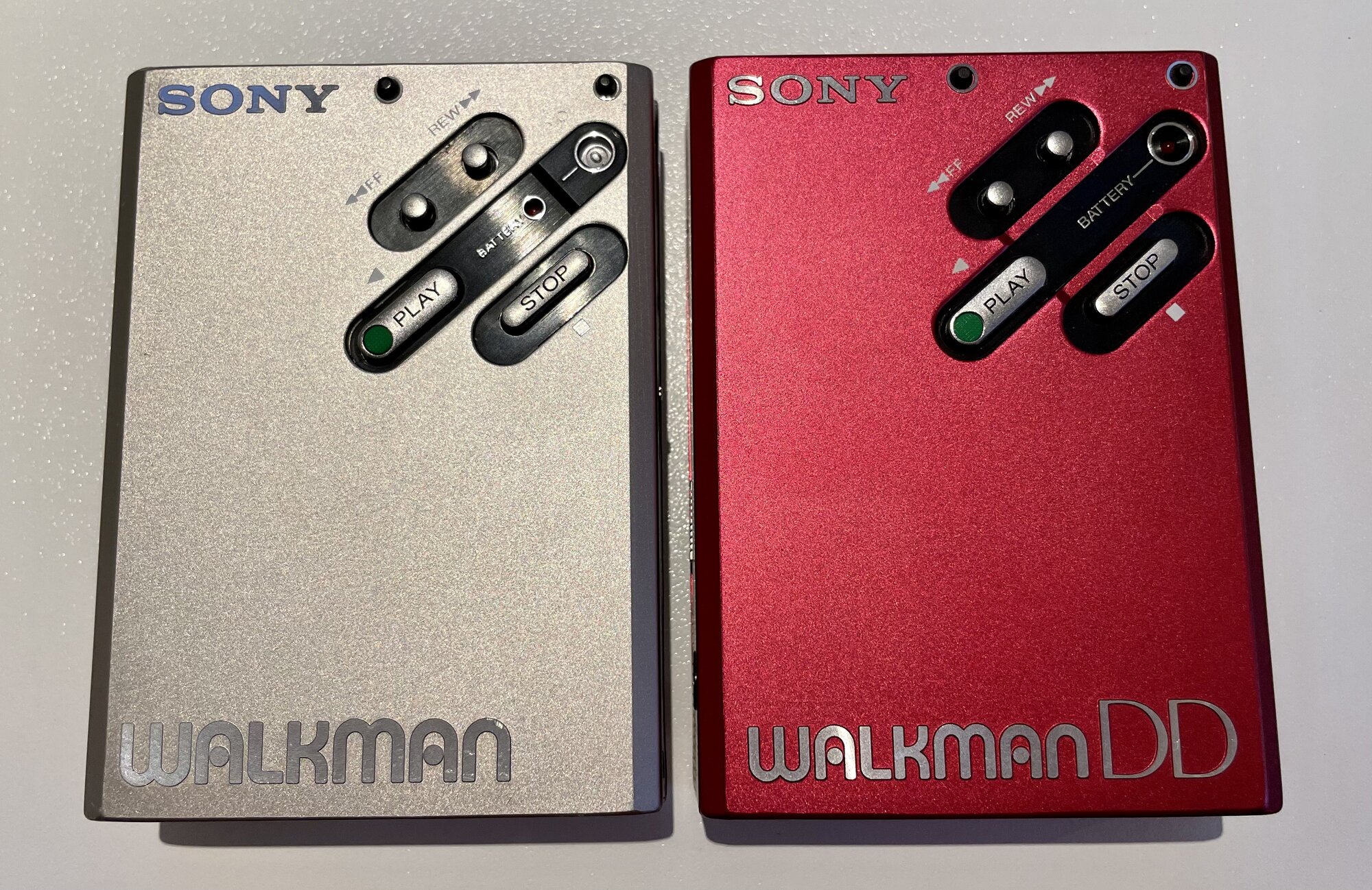

    Here is the WM-5 next to the DD, brothers from the same mother. The dimensions are slightly different though, WM-5 a bit smaller overall.
    Button layout is clearly the same.
    Unfortunately Sony removed the lens for the volume reading while introducing the DD.

    Once you remove the clear plastic washer, it should come out. There is coil/ sprint under the central gear axle. If you push it down you can see that it is easily going up and down. There shouldn't be any resistance removing it.

    regarding the lose wires, Place some pictures of lose wires and members can tell you where they belong to.
