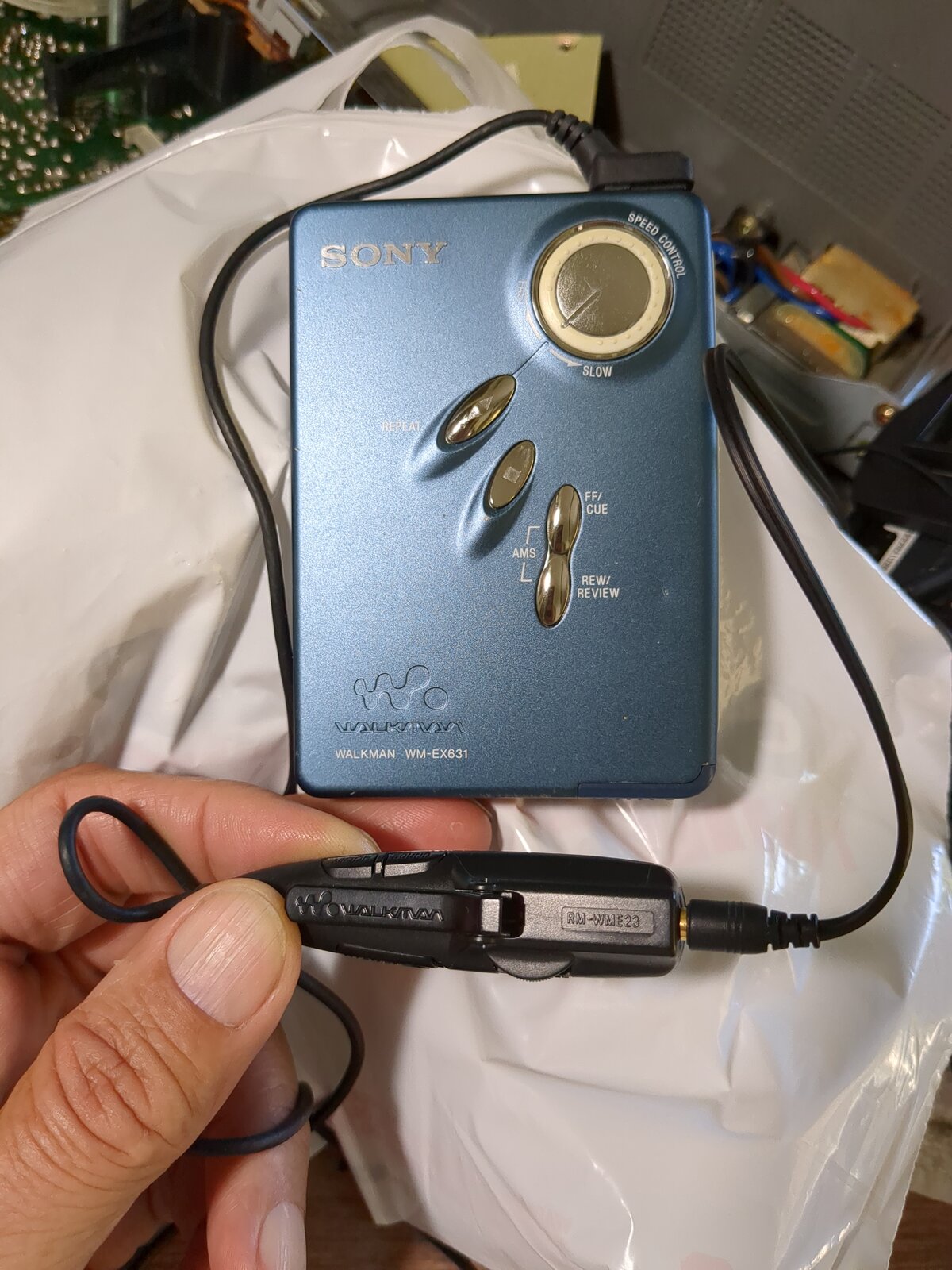

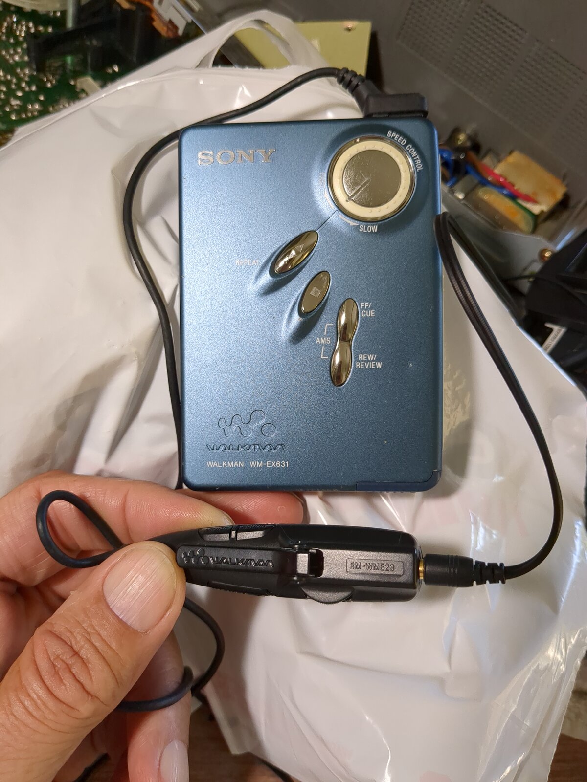

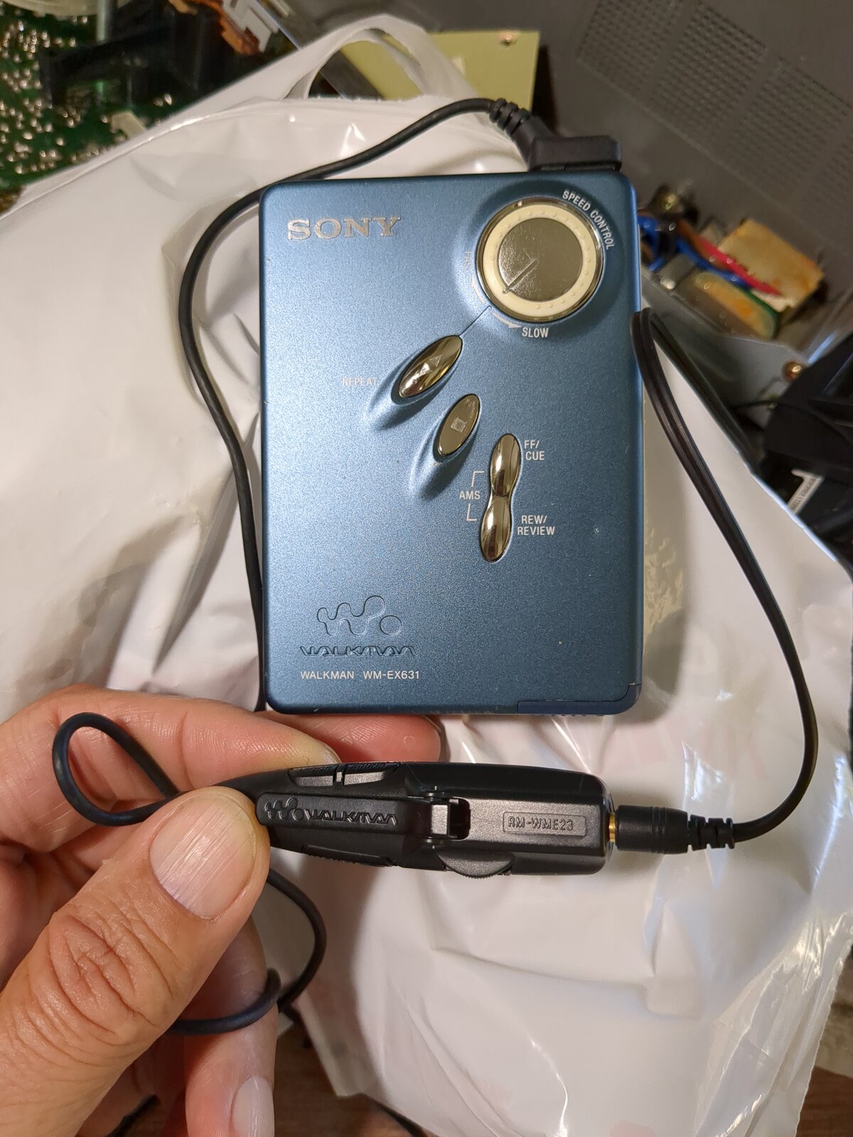

    Me I'm a visual person. I just can't stand reading about numbers and letters in a posting somewhere without actually seeing the actual item. Because then I have to go and search the internet and find out just what in the world we're talking about and sometimes people don't even know what they're talking about because they'll have a inaccurate item or texting and it won't be about the actual item at all. So to clarify, here's a picture of the actual item talked about in this thread. 17248622969292371202606226293559.jpg
    Walkman wm-ex631 and I'm showing hopefully the model number of the remote that came with mine. Although I'm not exactly sure if it is exactly correct model remote for this unit and so that's all I know

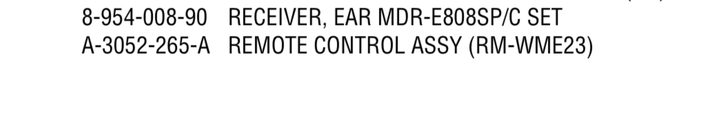

  11. Emiel
    1,050
    That is the right remote according to the service manual:
    Cassette2go likes this.
