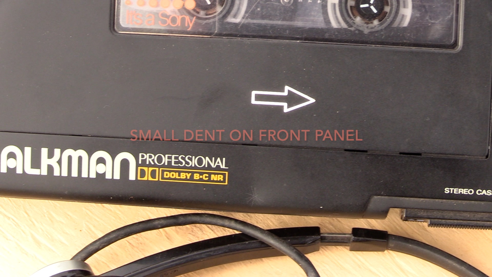

    Sorry to be slow getting back. I have been learning a bit more by doing research through YouTube videos. I had a look at taking the panels off the d6c to look at the internals of the headphone jack. Frankly, the screws are so tiny they scared me to death. (I am used to agricultural tractors and Land Rovers and they are a bit bigger). But from videos it doesn't look too bad. And the screws are not screwed down with force either, so I think they will undo so will give this a try. I am now waiting for magnifiers to arrive. My next problem is a small dent on the lower front panel just to the right of the Professional label. It looks like a grey smudge. I did think to try a silver smith or jeweller to flatten it (not many of either in the Scottish Highlands!), but I see there seems to be a thriving second hand market in D6C parts. I should be easy to unscrew the panel and replace from a donor machine. I am amazed at the prices for 'accessories'. £50 for a manual, £150 for a shoulder strap, £400 for headphones, etc. Is there a parts manual online?
