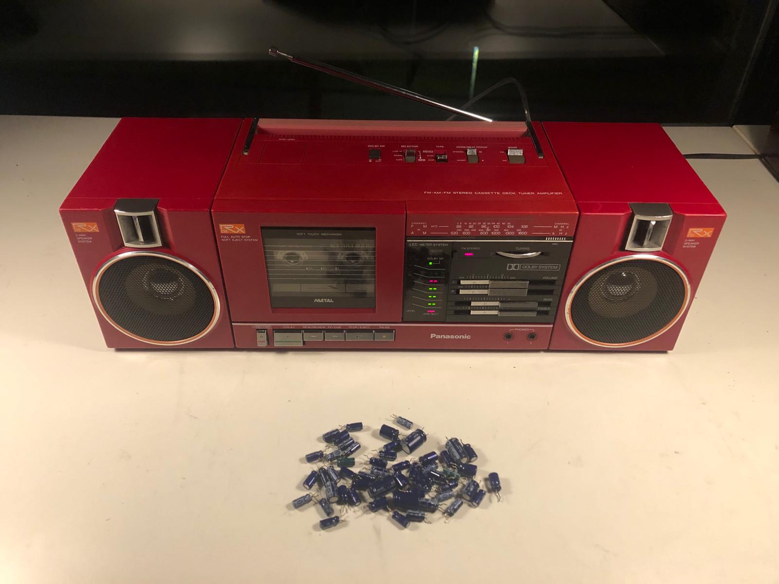

    I have four Panasonic RX-C50 boxes. Only one was operating normally. So I decided to check the inside. I have never seen it so bad, but almost every capacitor has corrosion and green legs. Even the one that still works has the same problem. I replaced the capacitors in the working one. Tried to fix a non-functional one and came to the conclusion that the rotten caps also destroyed the poweramp. Ordered a new IC, so hope this was the only damage.

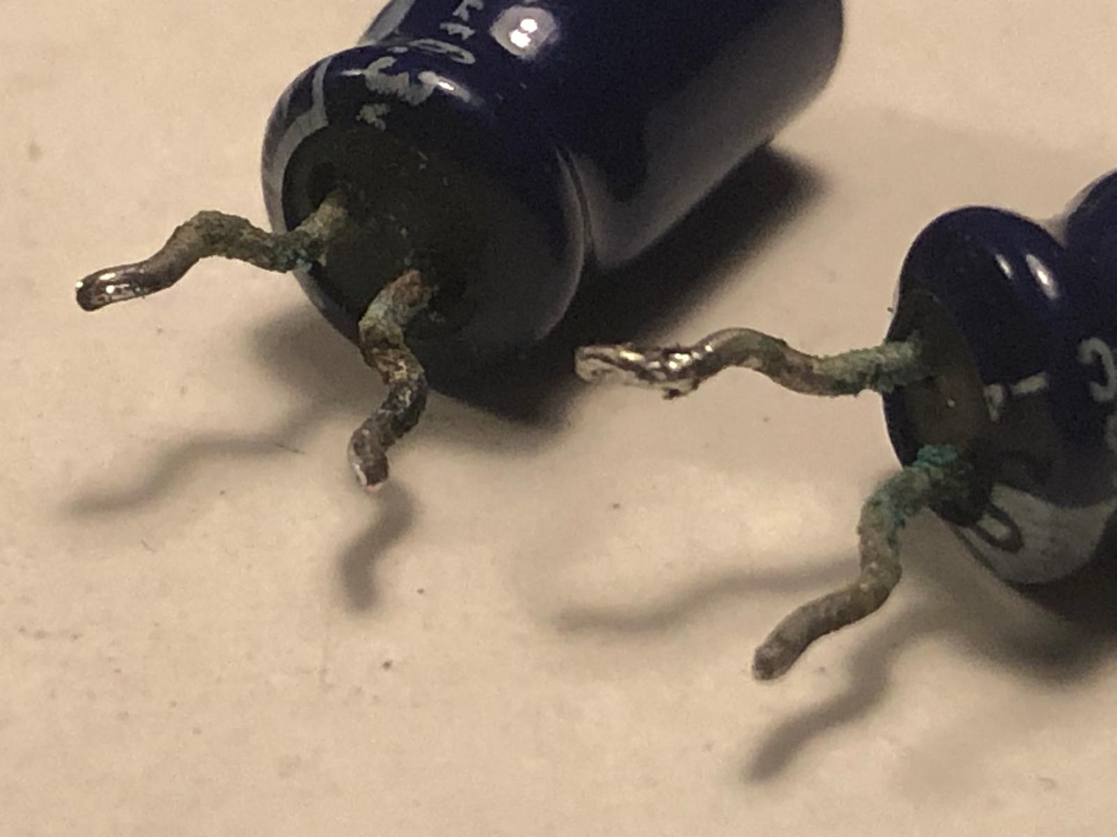

    Panny RX-C50 is a nice collectable boombox. Its small, they take not much room, they are stackable, there are six or seven colors, and they are the most powerfull mini's I've ever heard :)
    The caps problem is strange. I've got quite a few boxes and I hardly have to replace capacitors. I guess 99,99 of all caps are still original and the boxes are playing just fine. The RX-C50 seems to be different. Almost all caps look like this:

    And an overview of the box with all the caps I replaced....

    And what does it say on the capacitor itself? What brand? Curious that's all. It has to be an off brand junk, not Nichicon, Elna, Rubycon etc.,
