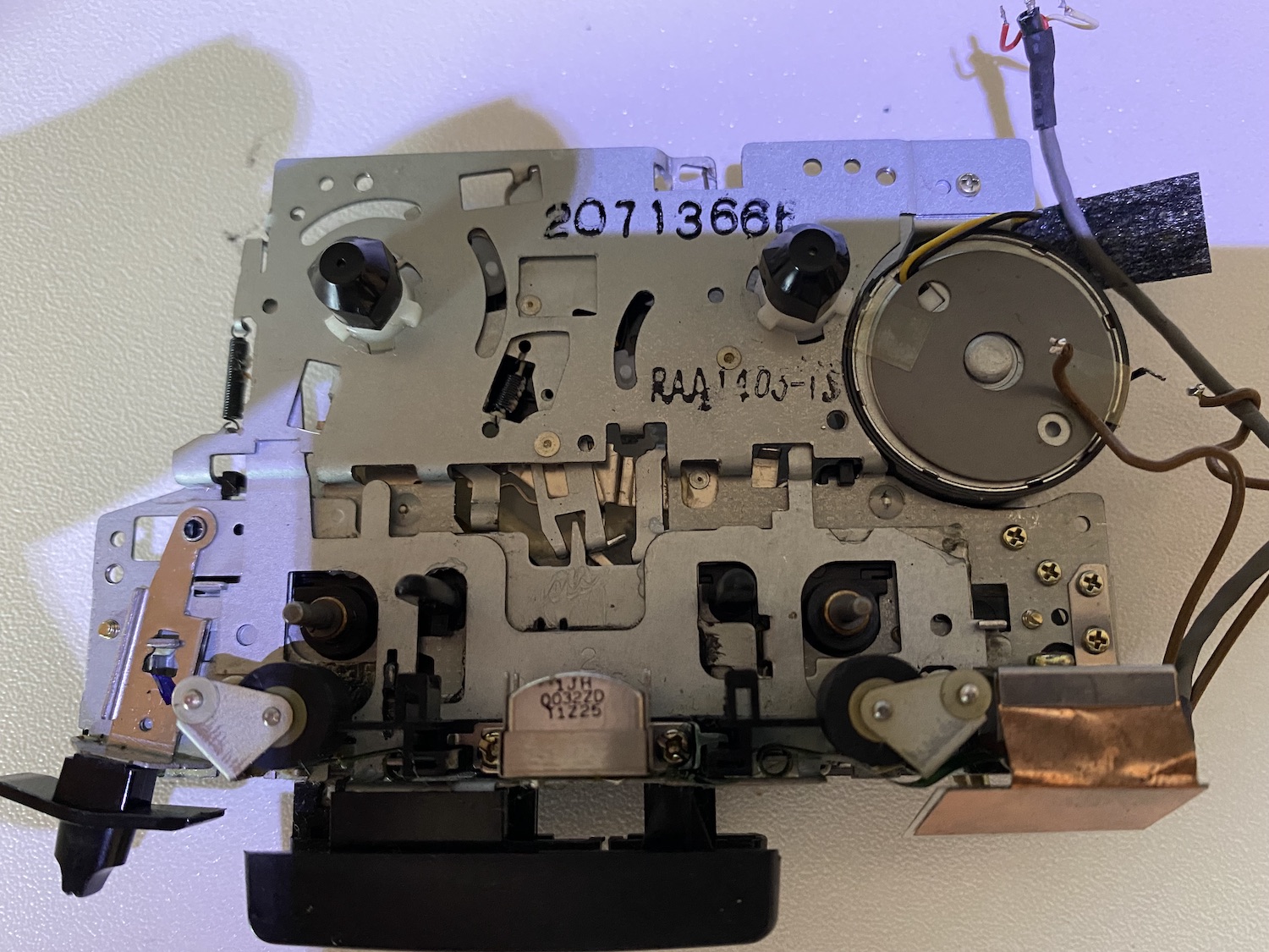

    Before even powering it up I opted to take it apart and inspect it internally in the quite likely possibility that the original belt has turned to goo. And that indeed was the case, but luckily the melted belt pieces came off cleanly with no sticky residue. At first look the interior does not seem to be made with a budget
    Big PCB with a mix of SMD components and through-hole components (components are Matsushita in house production and one IC is from Toshiba). The only available regulation is the tape speed, but that is quite standard. To my surprise, the tape transport is actually of very good quality:
    Two nice and big brass flywheels, all gears made of hard durable plastic, not a single crack, everything still turning smoothly and free, the clutch has not stiffened.
    All parts subjected to friction and stress are made of metal and, with just a bit more grease, the direction change lever works very smoothly. I'm very pleased with the transport quality, though I guess it was a cheap model, that does not look cheaply built.

    Overall a new belt and a quick clean-up it was all it needed to be working once again. One odd feature it has is that when powered on (either turning on the radio or pressing a transport button) there is a 1 second delay before it actually starts-up. Is that a "feature" ?

    I think its normal, anyway it has a good transport as long as the motor runs well, motors start to have issues when stopped for some years, give it a run first when a new belt is installed and then if all good you got yourself an excellent tape player/ FM Stereo radio receiver.
    Matsushita was good back in the day. 5€ was a good price!

    Hi, what kind of belts did you use? (I get ~43 and ~100 half-lengths)
