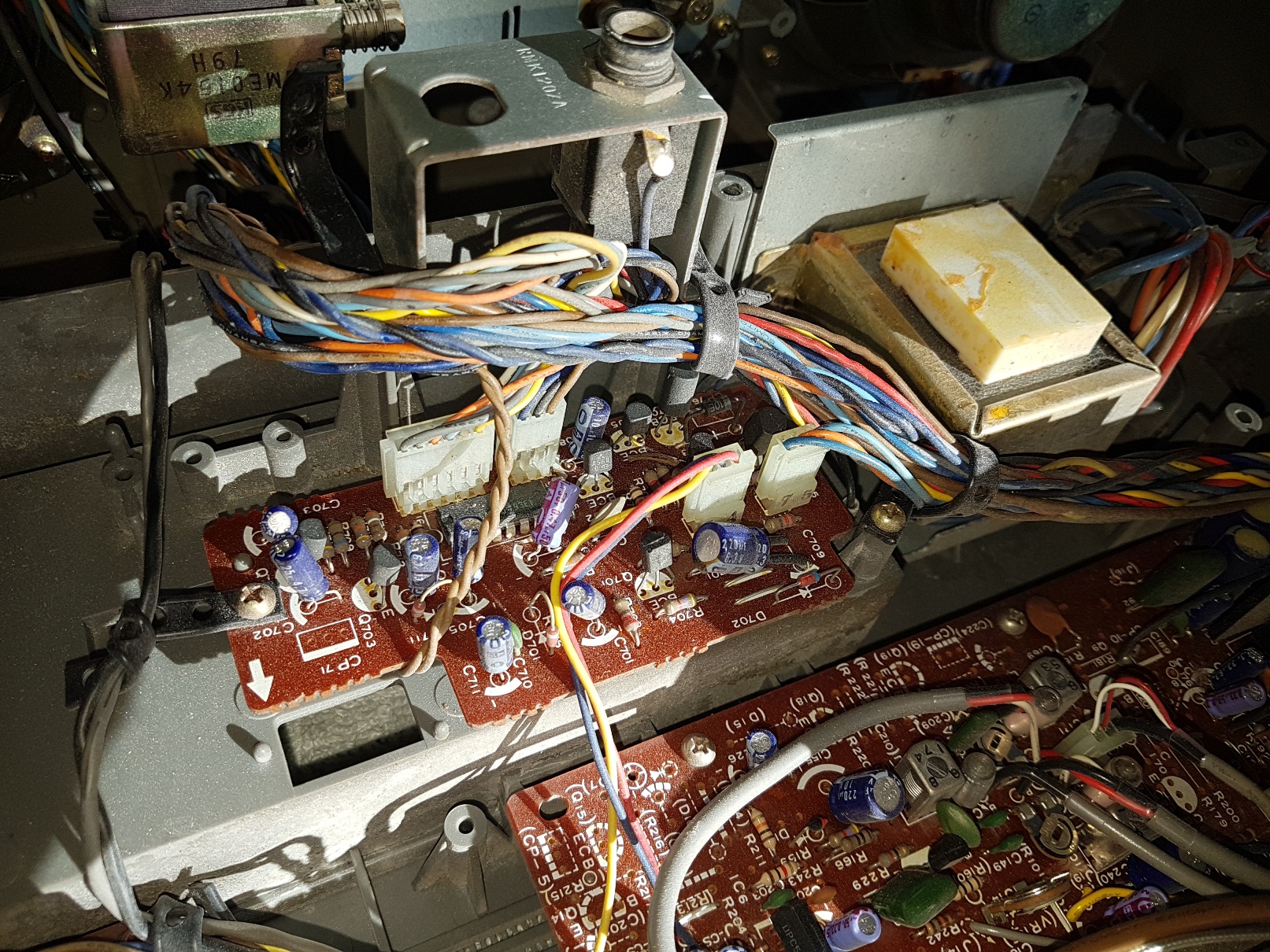

    A tuner that worked in mono & only on FM & a tape mechanism that had at some point completely seized up making any push buttons impossible to move - they were solidly locked where they were & the tape mechanism was, of course half stuck in play mode.........
    All the audio sliders were very poorly & gummed up with an unknown substance making them difficult to slide in either direction........
    It was clear that this wasn't going to be easy sailing at all & in fact, I was looking at a completely different fish in the kettle to what I first anticipated..........
    I decided that the whole shooting game would have to be dismantled & at that point wondered will I ever overtake the even keels with this poor patient!!
    Some time later the same day, I had the complete cassette deck in front of me - & what an amazing engineering feat it is.........
    I was able to determine two "Key" areas that were causing the "Core" problems with this beautiful deck - Dried grease on all of the steel plates that are meant to move sideways with ease & dried to the point of seizure...........
    The second problem was a small copper "Spring" that returns all the plates to their correct positions had just about "Petered Out" & was no longer doing it's job, it wasn't broken though which I thought was a godsend as I couldn't of repaired it!
    Time for the degreaser & surgical spirit treatment (Don't get either of these on the silver cabinet finish - they both strip paint in seconds) By the end of the afternoon, we had a completely clean set of plates ready to re-grease without removing any of them from the mechanism..............Did I say earlier that I love working on this era of Panny?? What was I thinking.......... :D
    I used a fine blade to slip a generous amount of grease between each plate & spread it as best I could! Now it was time to remove that pesky copper return tensioner & gently reform it's shape! Amazing! this component hadn't lost any of it's strengh & a careful few minutes saw this part restored with plenty of tension which was great news..........
    So time to refit the tensioner & test the operation of the transport keys manually - It took a few run throughs of all modes to get the plates moving freely again, but all this trouble was worth it!!
    So we now have a working transport mechanism, just belts & pinch roller to replace & a drop of machine oil on the capstan shaft - A doodle on these decks, one flat belt is all it uses & a counter belt which as so often happens was in perfect shape & a nice brand new pinch roller completed the deck restore! :)
    The rest was pretty mundane & straightforward - clean every switch pot & contact over & over until they all moving with ease - I just hoped & prayed that the sound board sliders were not as worn out as my ex-wife - I wouldn't know until the reassembly process.........
    Now this model is not the easiest to put back together, add to that a ton of wiring & very well made reusable cable clamps that must be in the correct place before you can close the case up fully & of course the selector & mode switches that protrude through the top edge of the case! Add to that the many pluggable connectors that must go in the right place to avoid certain disaster & damage to the stero & it's quite a balacing act to achieve :O

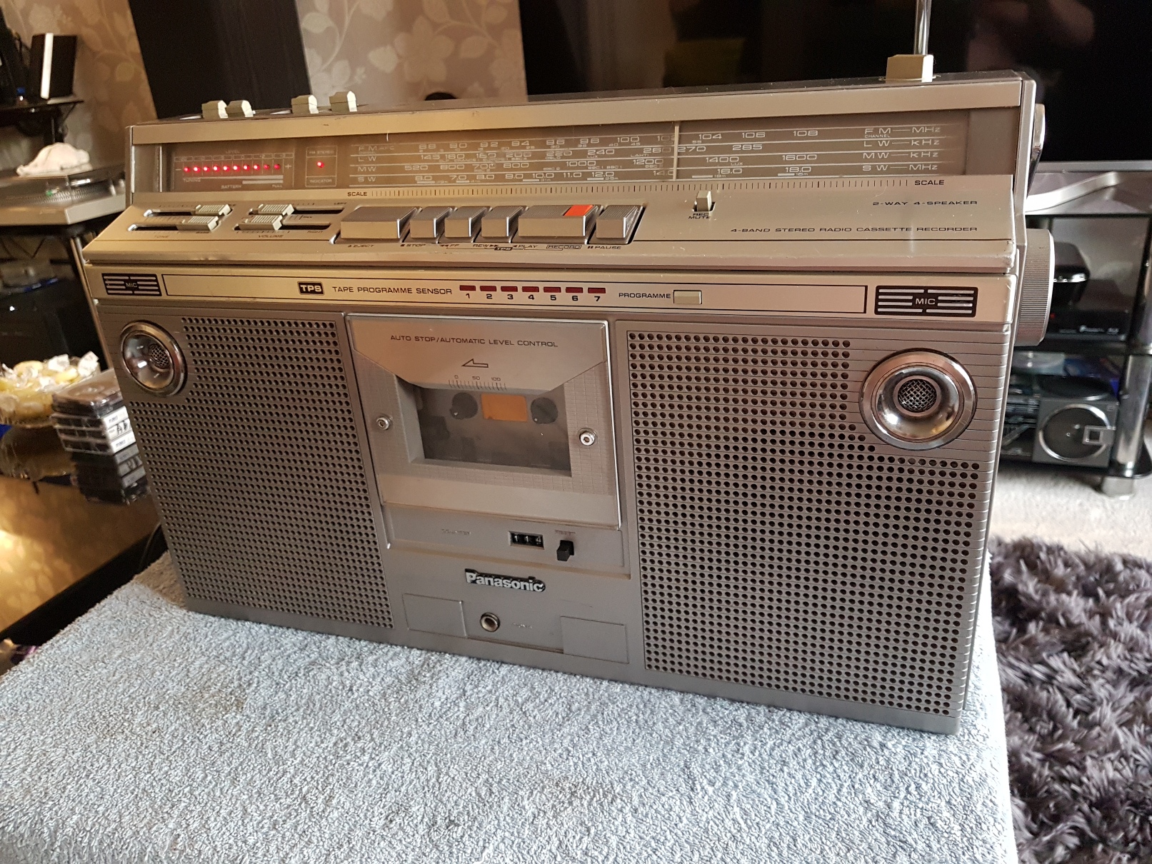

    Cue: "All Gleaming Horns & Trumpets" Everything was spot on with no further adjustments or bits to do - Everything works & it sings once again & every single function works as it should!! :)
    Now I don't know if you're aware of this, but this stereo is LOUD!!!
    Lots of real power on tap & even at low volumes, it's loud!! Look at the two volume sliders to the right of the bass & treble ones - in the three videos, this beast was overloading my 4K camera's A.l.c. circuits & knocking the audio limiter hard!! & it's really in yer face loud! :O :O
    But remember: These Panasonics were really like that in the golden age & thank f**k we had such beasts back then!
    It goes without saying that this goes deafeningly loud should you wish it to!!
    A very happy owner here - An outstandingly stable cassette deck with decent heads feed a rich powerful amplifier & very heavy spokers - Did I mention that the tuner now works on all four bands & in stereo on FM! :)
    My Battle scarred but still very nice to own.........
