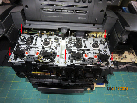

    Remove the 6 screws holding the combo deck. The deck then simply lifts up
    as it has electrical connectors. No wiring to de-solder. The decks come out
    like a cartridge. Very convenient.
    Both deck units are connected with a white plastic bridge.

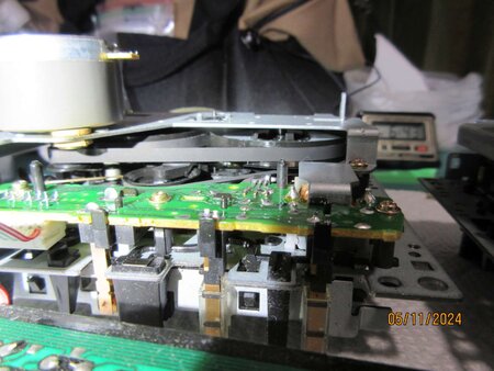

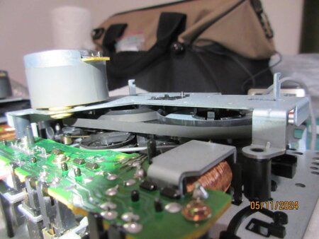

    3 screws hold the top plate with motor. With screws removed this
    plate is still held in place with raised screw post stand off's. Nice.
    Just lift off slowly and the belt will come away too.
    Lift away the top plate with motor and the belt comes away too.

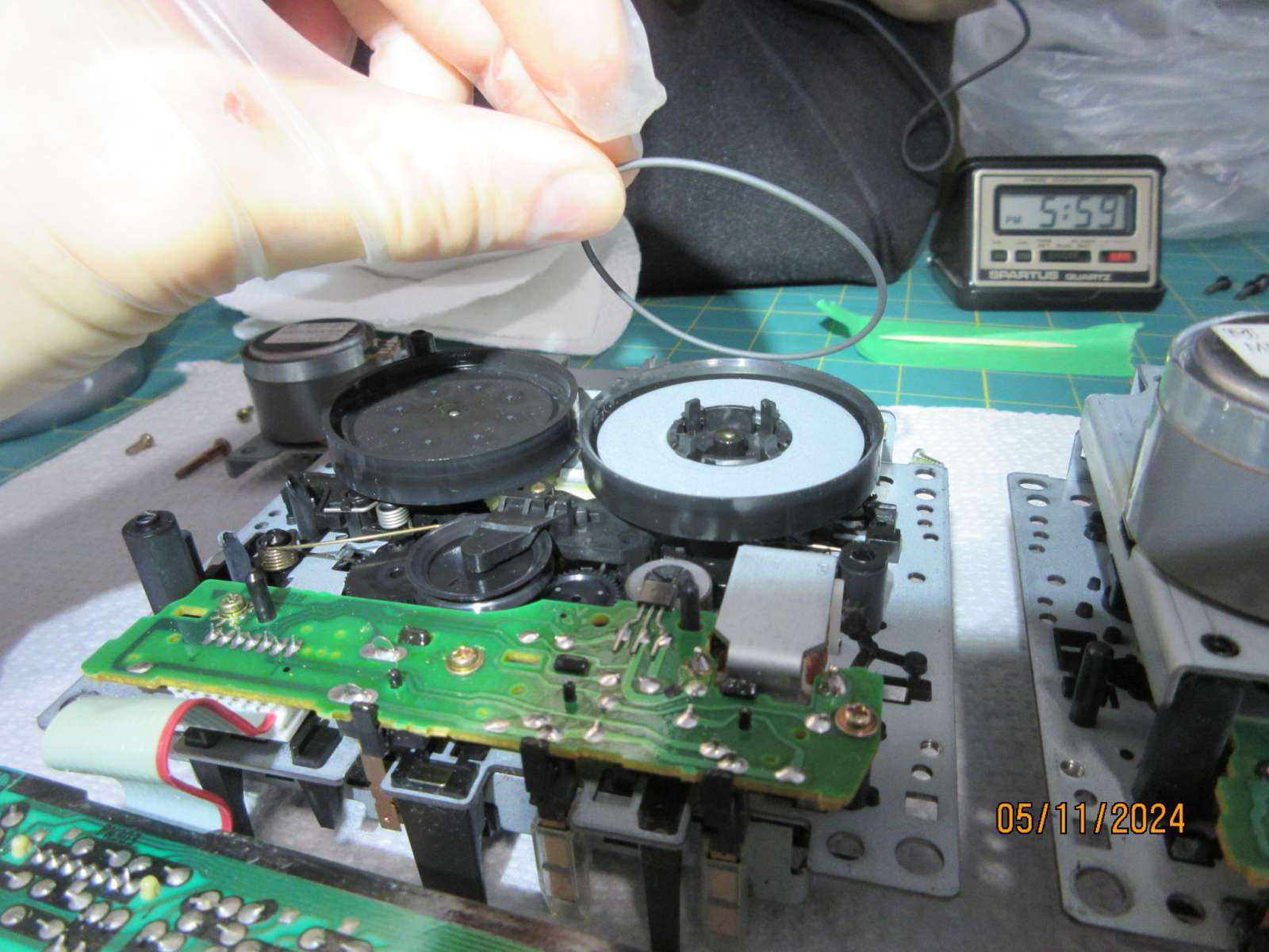

    Removing the old round belt. Other replacement belt packages may
    use a round belt? It should be a round belt not a square belt in my opinion.

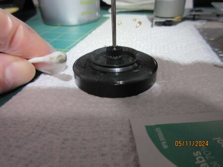

    Intensive cleaning with cotton tip and 70% alcohol of the belt path pulleys.
    Remove all old black rubber residue. Critically important step! Go slow.
    Make sure to clean this pulley too. Carefully. Form cotton swap end with pliers
    then moisten with alcohol. This way the cotton is shaped to fit into the groove.

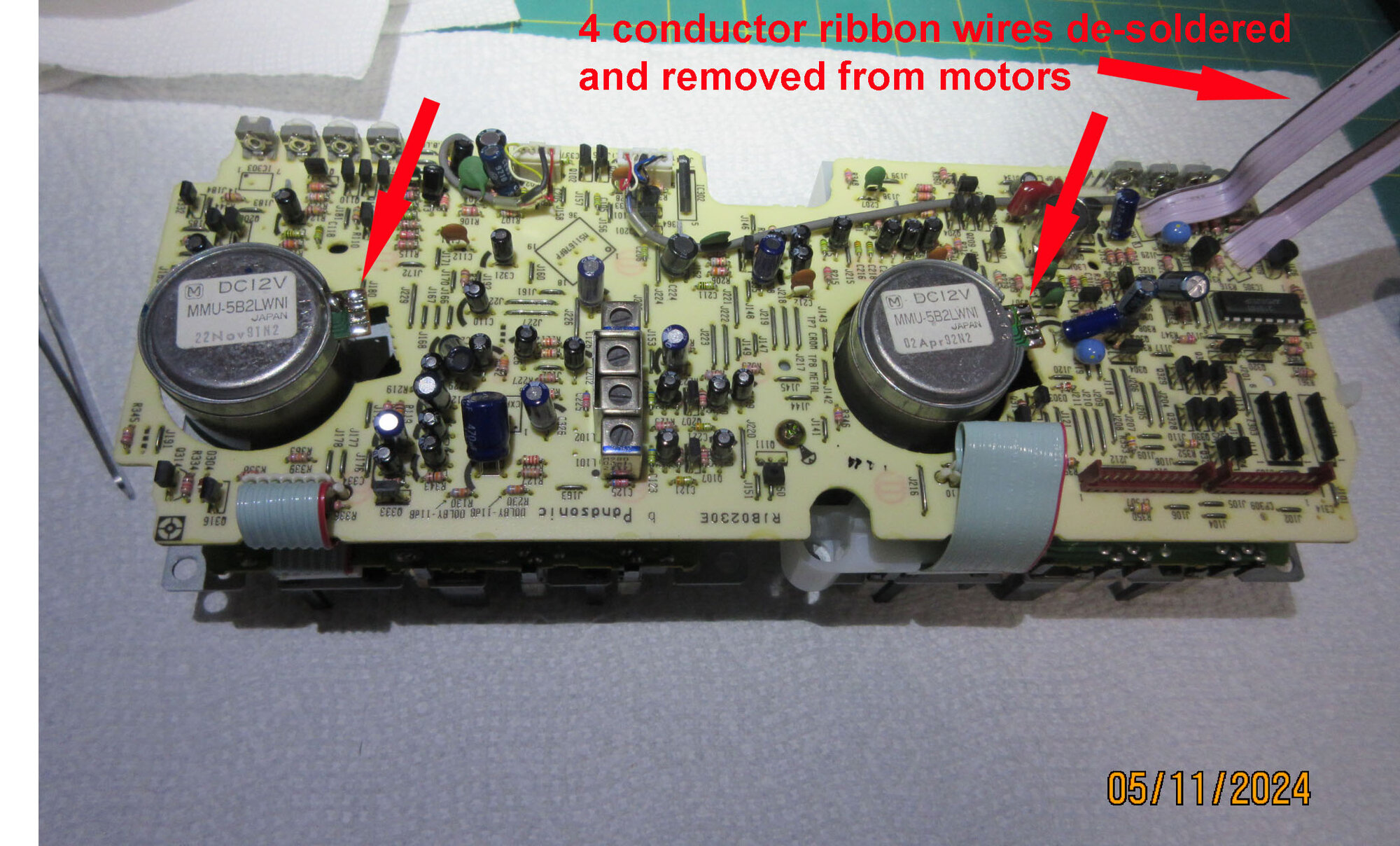

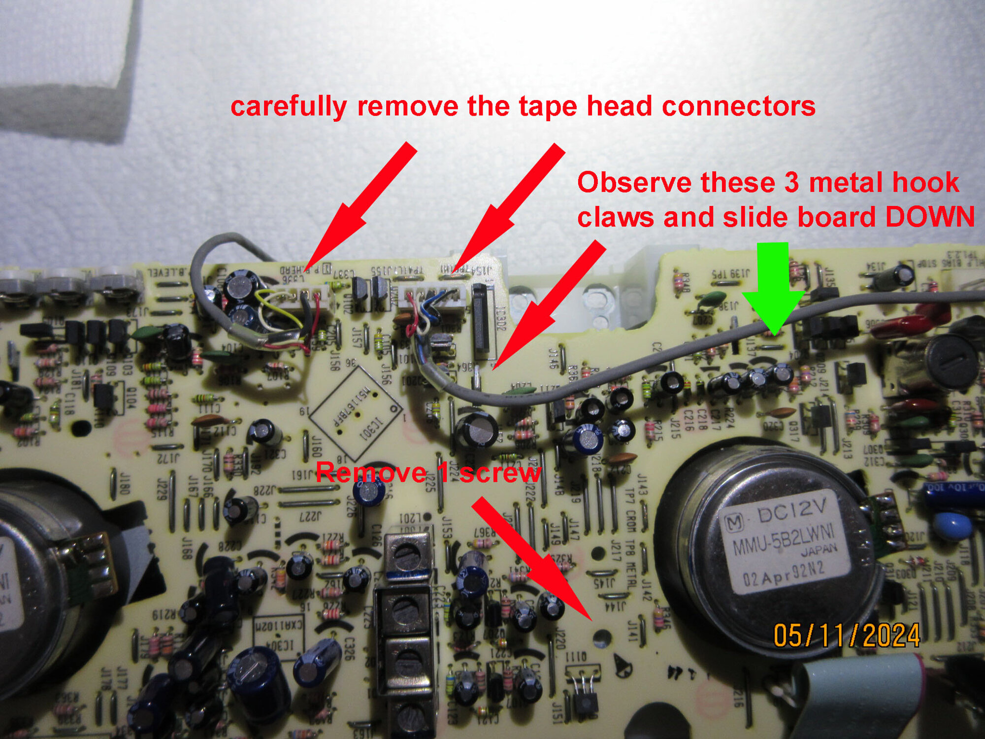

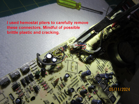

    4 conductor ribbon cable to motors. PCB has hole through. Use solder
    pump to clear holes and clean up pads. Maybe to install a 4-pin
    connector would be a good idea for solder free removal? I would like to
    so that just for the sake of it...

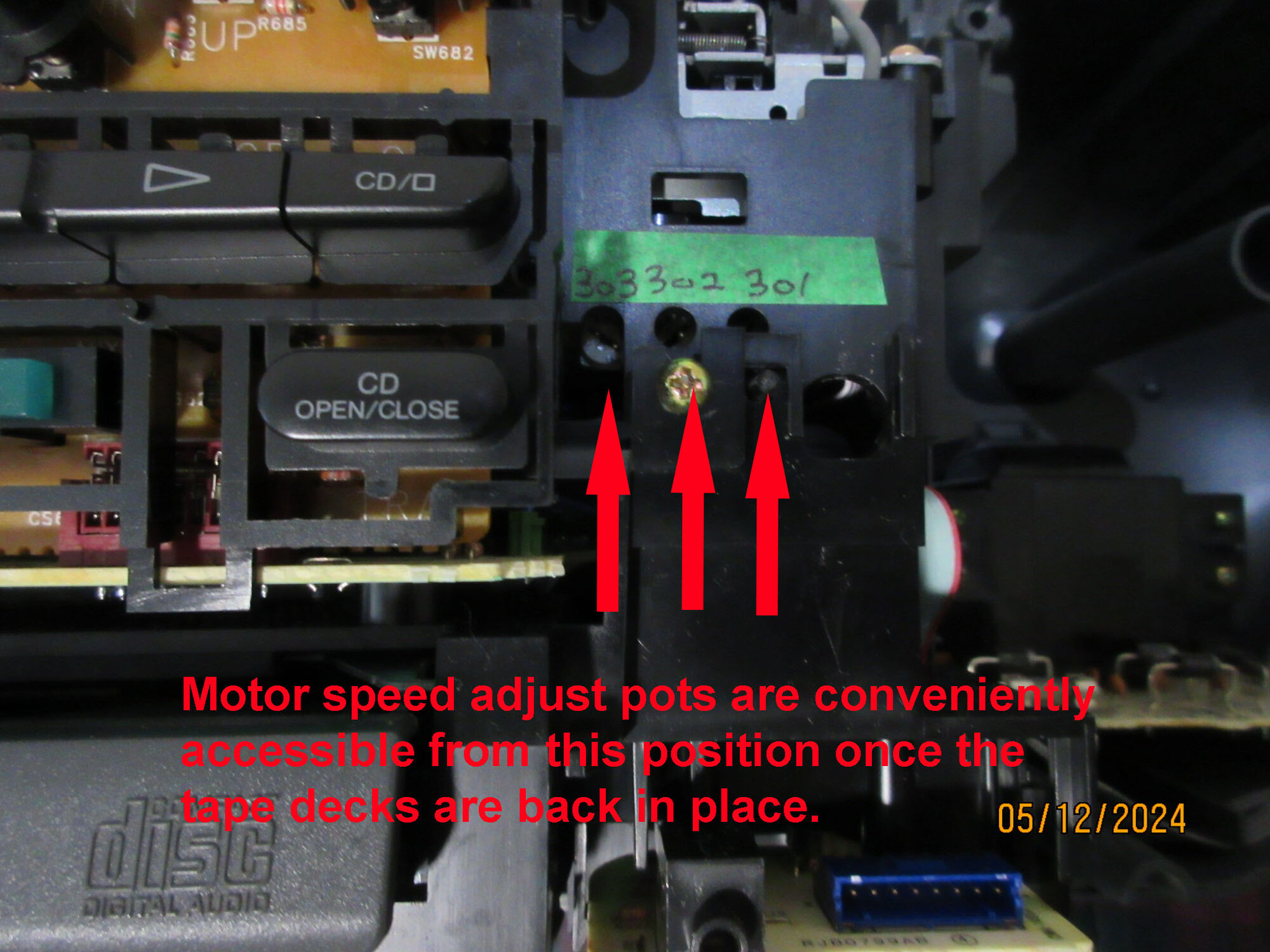

    Motor speed adjustment procedure is detailed in the Service Manual on pages 50 / 51 (Google for service manual which is freely available as a .pdf file). I did a lot of different WFGUI tests and stop / start / rewind etc., and the new belts are still settling in.
