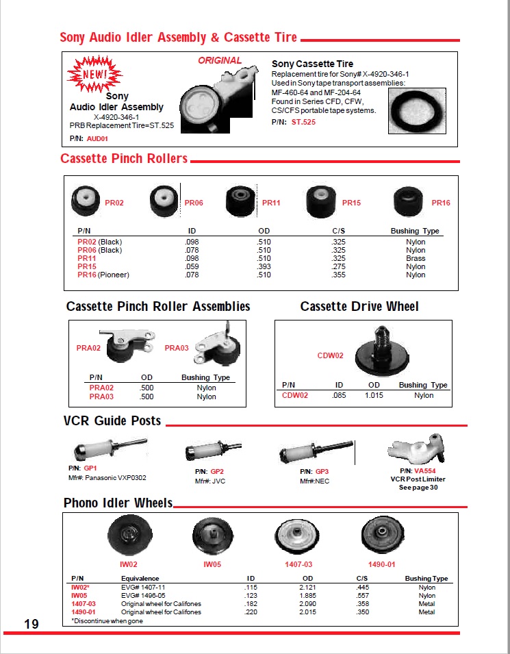

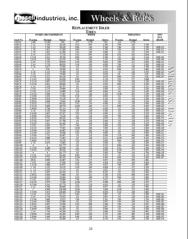

    Here's a page from PBR (Russel Industries USA), I think they're still in business but their website is very old. They used to supply a ton of belts, rollers and other parts for audio visual equipment.
    http://www.russellind.com/prbline/prb.htm
    They have a few catalogs on line but you really have to drill through the menus to find them, maybe searching "pdf site: russellind.com" in google will help.
    Another page with sizes, EVG makes the idler tires or did.
