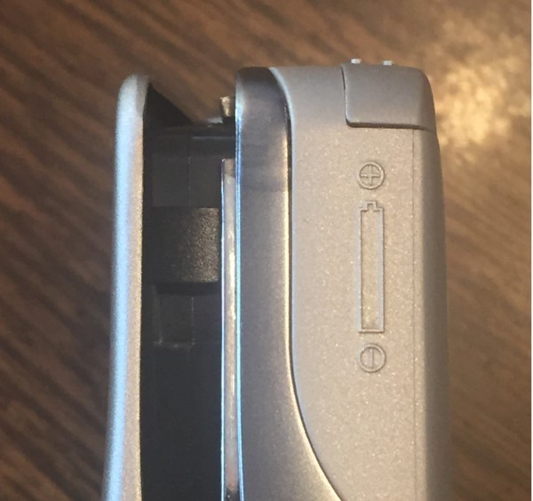

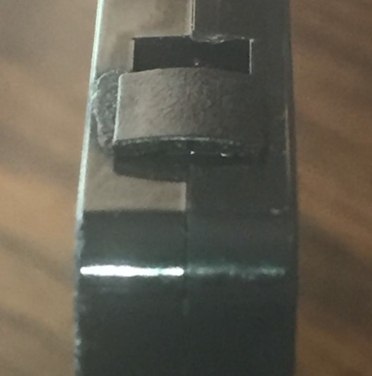

    Initial review of "duplication.ca" recording tab repair plug:
    Fast shipping, nicely packaged, nicely made.
    they fit well in the cassettes, but raise the height of the cassette .04mm shy of 1mm, so say +1mm.
    they fit easily in my Sony TC-K71 and Denon DR-M33
    Sony Walkman : they fit and door closed without forcing in my EX-502, EX-102, EX172
    Panasonic Walkman: RQ-S25, S30, S70, SX1V: Door would not easily close, had to force to close... so Id say it's a NO-GO for Panasonic RQ...

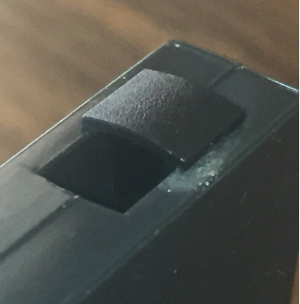

  8. Dfcruiser
    Dfcruiser Active Member
    Columbia SC

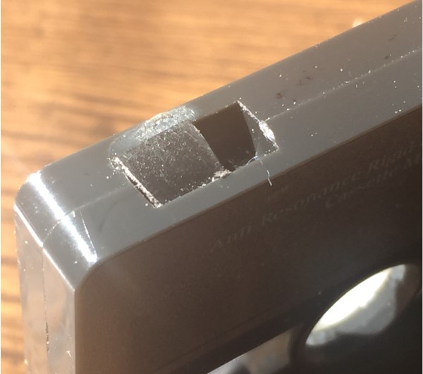

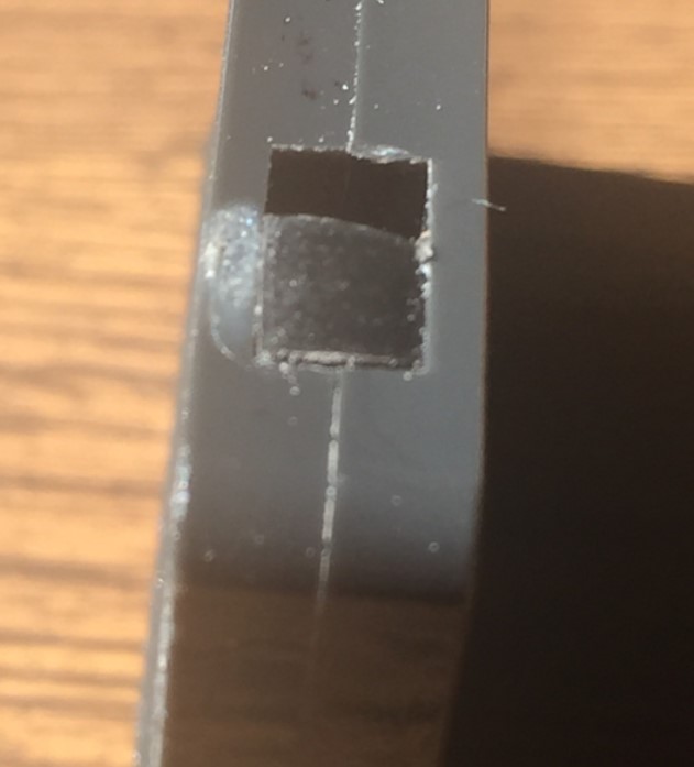

    Ok some good news, but a little more work...
    I sanded 3 sides on 120 grit paper for a few seconds then cleaned up with a file, and the plugs go lower into the opening! So these can work, and I can avoid tape..
    the repair tabs are the right height to push down further and bottom without sanding those retaining tabs...

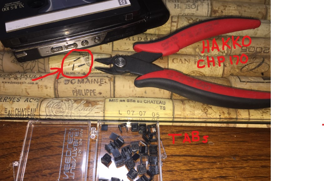

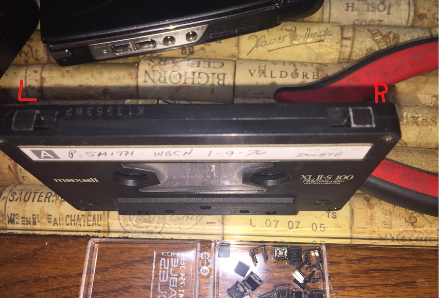

    Cassette Tab Repair simplified!
    Use small Side Cutter tool to snip off extended sides of tab: no additional effort needed!
    Below is everything needed: "Snip Fit" photo below, L-side no sanding! R-side sanded: Recommend don't sand!
    Mister-X, great find, thank you!
