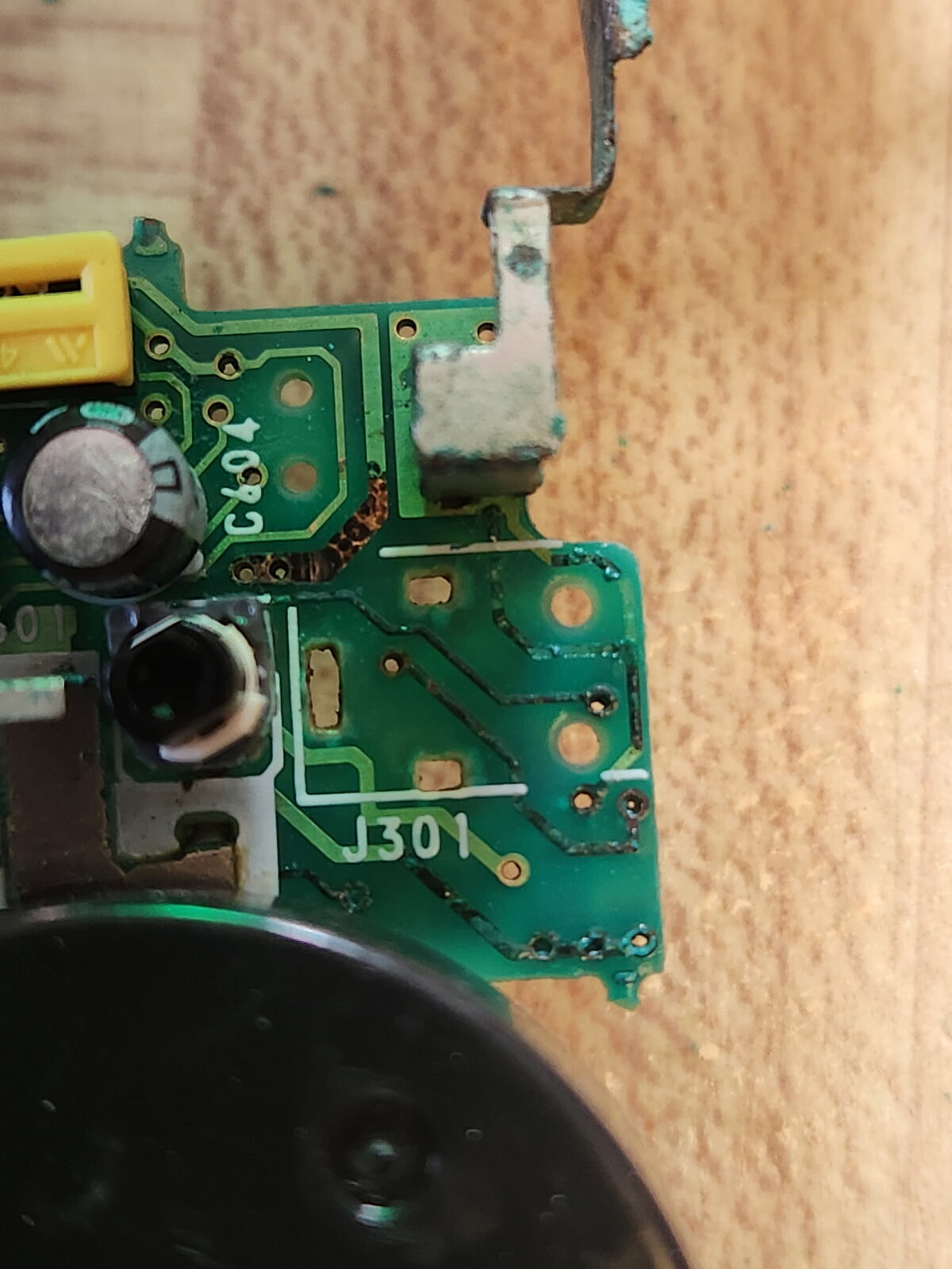

Recently got a WM F-2065 off Ebay that had corrosion damage, trying to restore it
Discussion in 'Tech talk' started by JypseKV2, Mar 11, 2025 at 7:05 AM.
  1. JypseKV2
    JypseKV2 New Member
    4
    Wisconsin

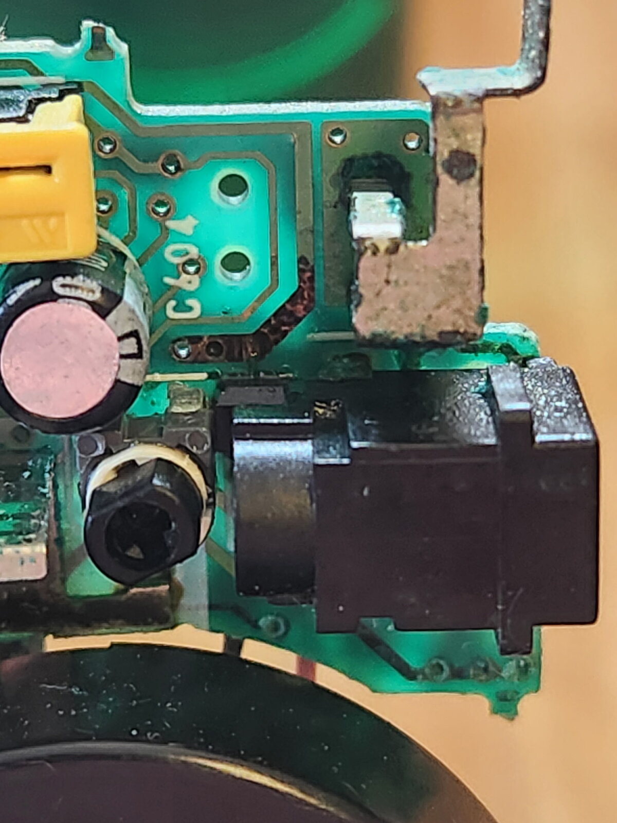

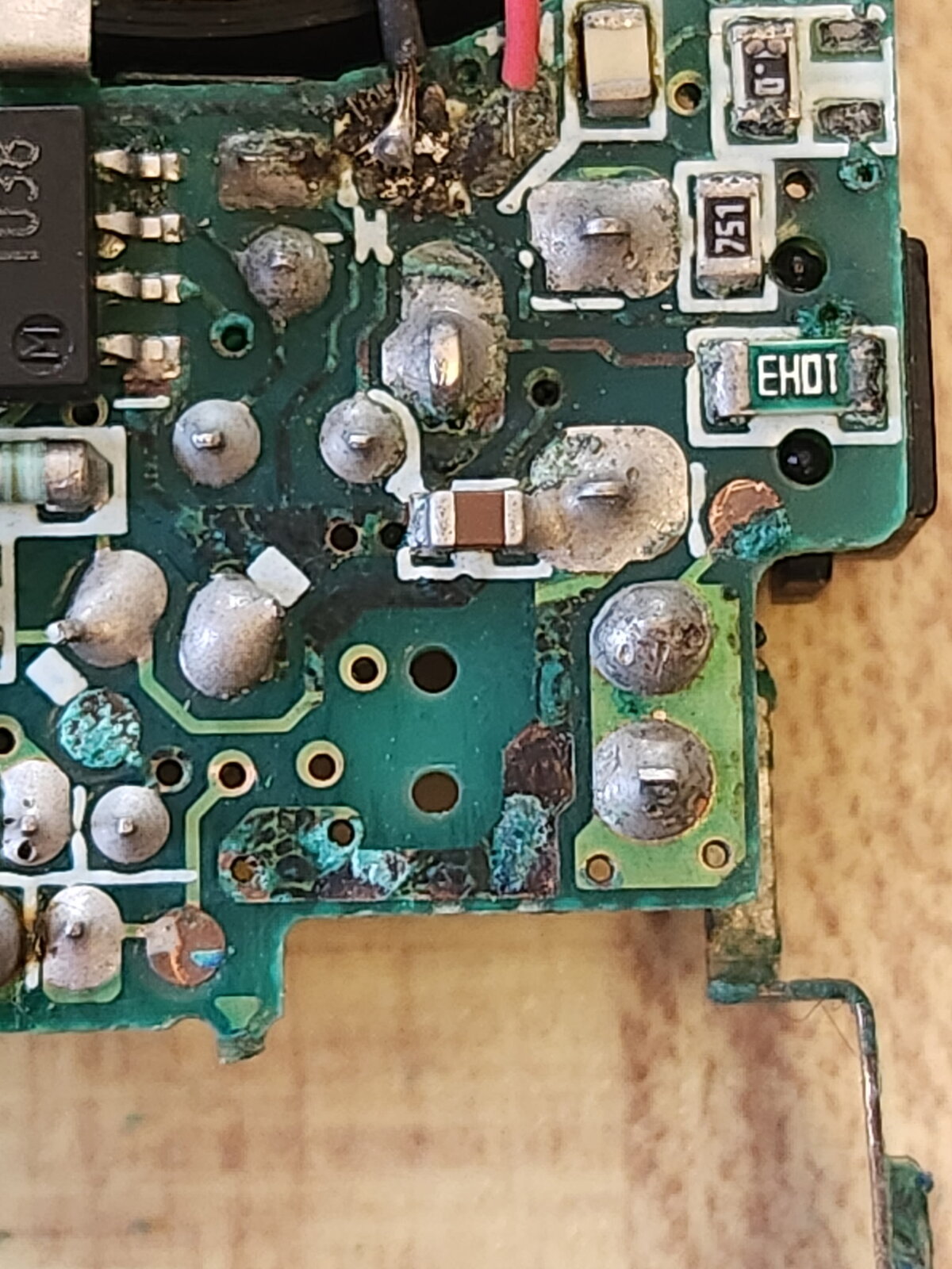

    the damage from corrosion was corrosion on the mother board my Father who has lots of experience with consumer electronics, said it is Cleanable/Fixable, but a motor connection is loose, and Lead from the battery Terminal to the MB, corroded off, specifically the Flat end would Telephone wire work if my Father Soldered it from the battery terminal to the the MB? plus the Belt is perfectly Intact which is nice. (not sure if I can add photo's after posting this
  2. Hyperscope
    354
    Vancouver Canada
    Clean everything first, lots of cotton swabs "Q-tips" and alcohol, sure, copper telephone wire will work.
    Pictures are always good :thumbsup:
  3. JypseKV2
    JypseKV2 New Member
    4
    Wisconsin
    Yeah we have cleaned it with cotton and rubbing alcohol, soon my Father might grab acid brushes to get the corrosion that didn't come off with the Q-tips
