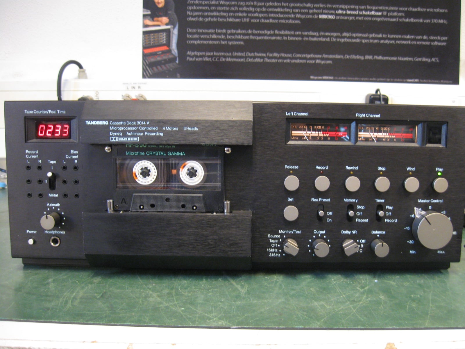

    Great news! The Tandberg TCD-3014A just arrived, more on that later in a separate thread, you are the first to know here ;-)

    I saw your reference to the incoming Tandberg on that other thread :thumbsup: Certainly one of the better decks worth having. Assuming it has been recently fully rebuilt and calibrated by a professional tech of course.

    Whooa! That's a beauty!
