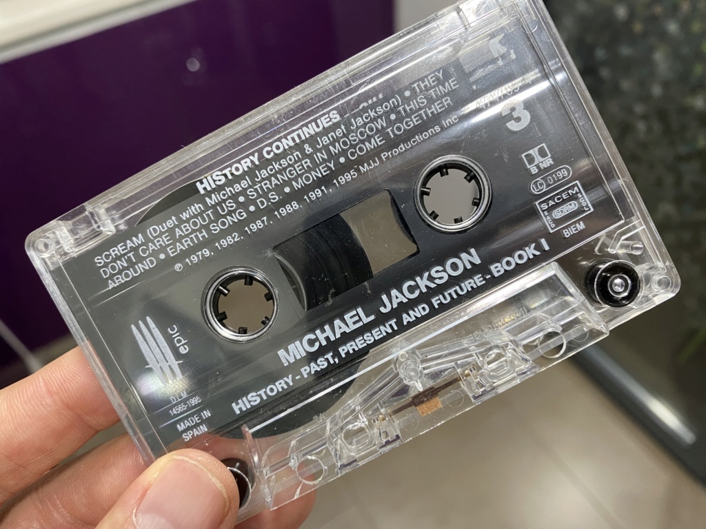

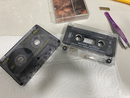

    While talking in a spanish forum, someone gave us an idea on how to restore prerecorded cassettes that have aged badly or simply are worn, broken,...
    What he does is to record the same album in a new type I or II cassette and the he replaces the magnetic tape inside.
    But the interesting thing is that he doesn't open the shell, he just pulls out the tape until the leader tape, cut, paste the new one. Then full rolls it inside until the end, paste the other end to the leader tape and... that's all!
    Here are two photos he posted:
    Curious, huh? Who wants to try?
