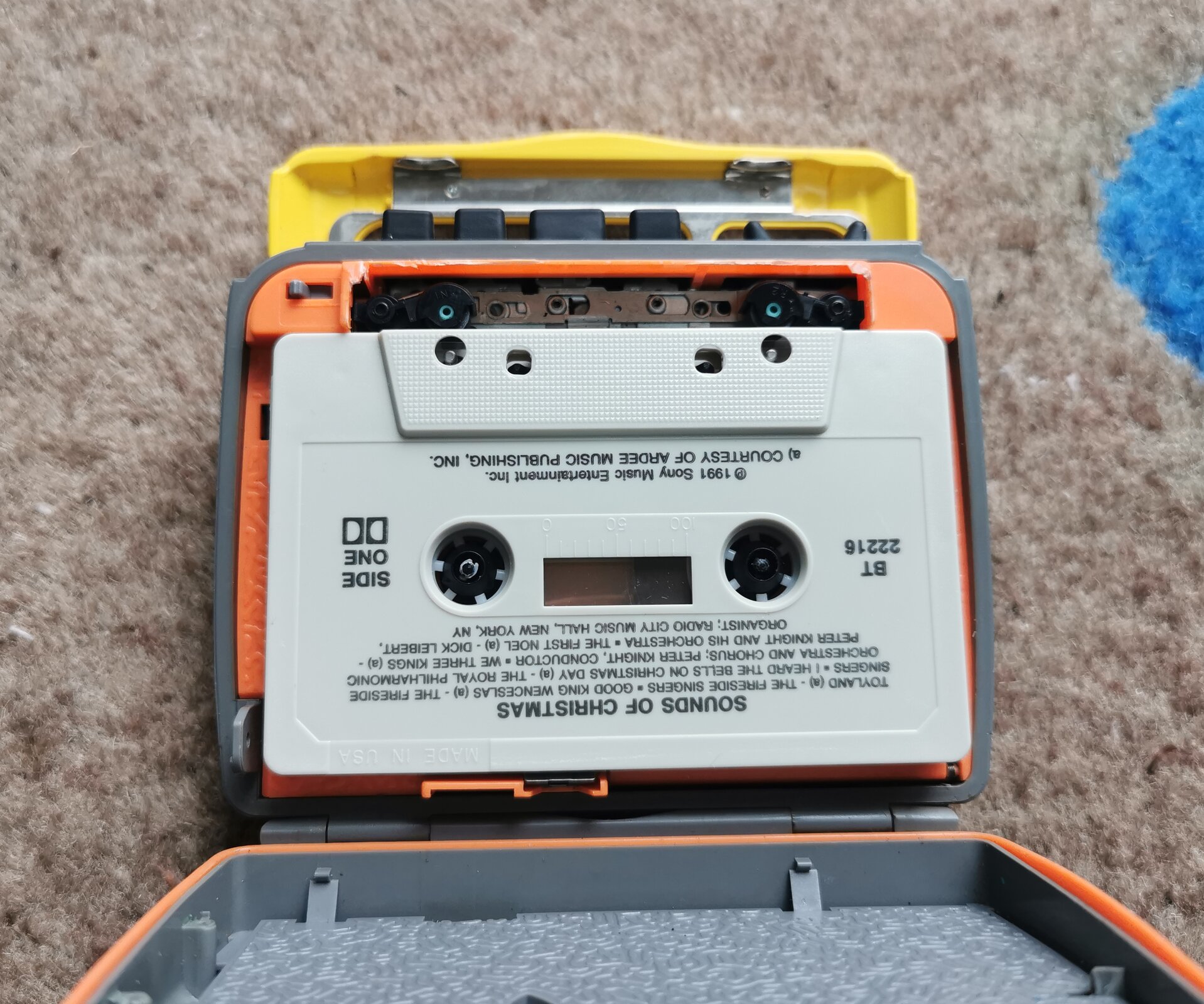

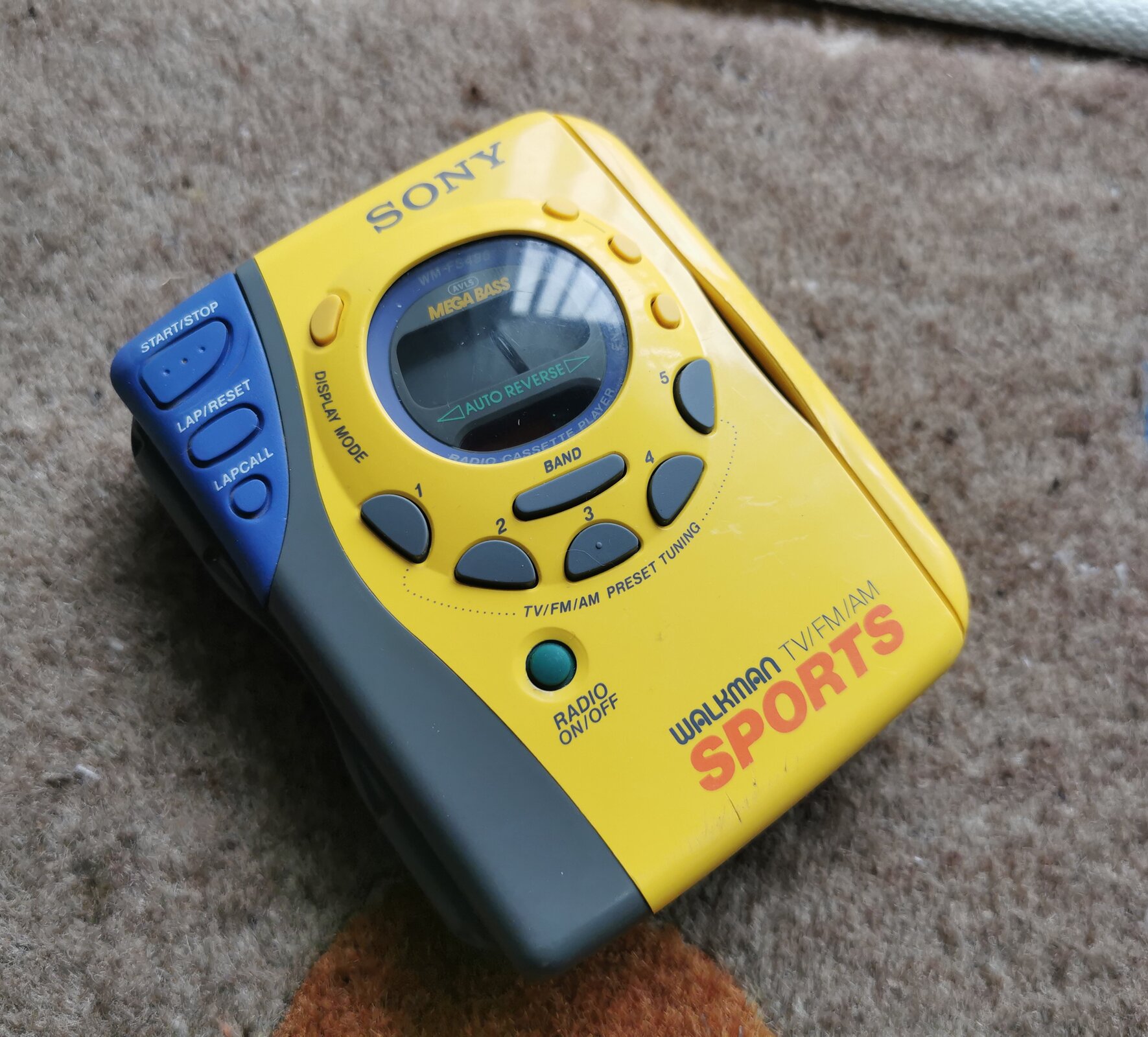

    The story of this Sony WM-FS495. The main board was badly corroded by battery fluid and I don't think it's worth repairing. Fortunately the motor still runs so I turned it into a device that can extend other players' life and save some tapes.
    Basically I removed the top plate covering the head and the head assembly itself. Now with the tape running, I can use a Q-tip dampened with denatured alcohol to remove mold on a tape. It has worked very well for me. I can also use it to fast forward and backward an old tape (to loosen it up) before I play it.
    Unfortunately I can't make it sing anymore, but it can do some tasks nicely in silence. :)

    Some joints disconnected due to heavy corrosion but I fixed those.
