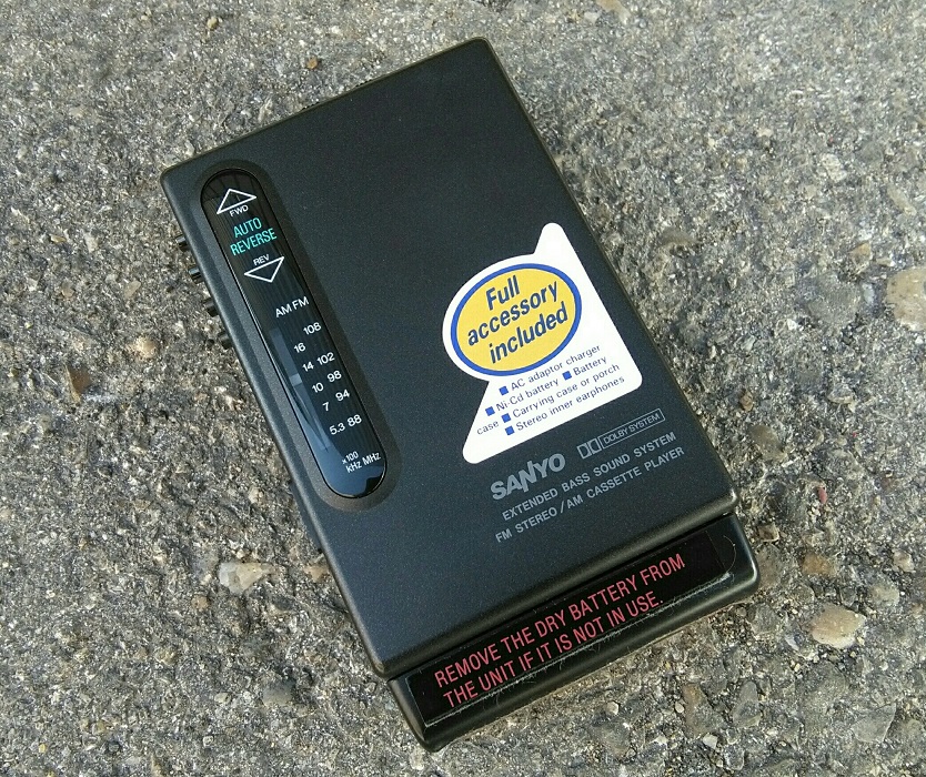

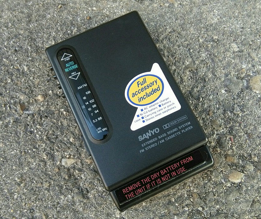

    Hi,
    I want to show this little walkman, a Sanyo JJ-F6 (from the quarter series, maybe the smaller walkmans ever made) it has been used but, fortunately doesn´t have any scratches
    The belts are worn, but the radio section works pretty good and the sound is loud and powerful,
    If anyone has its service manual, or has experience rebelting this unit, please let me know
    rgds

  2. Costa32
    Costa32 Member
    46
    Oporto
    Thats a very rare unit in beautiful condition... even without a service manual i would risk on opening it and see what i could do to replace the belts, unless it has some soldering points to remove from the mainboard in order to get it fully opened.
    i would do everything i could to get it running again for shure.
    Good find!

  4. T-ster
    1,455
    Wow that is immaculate and well worth a repair. Aiwa made some classy units.

  6. Boodokhan
    2,461
    Its a beautiful and hard to find walkman specially with its original box :thumbup:

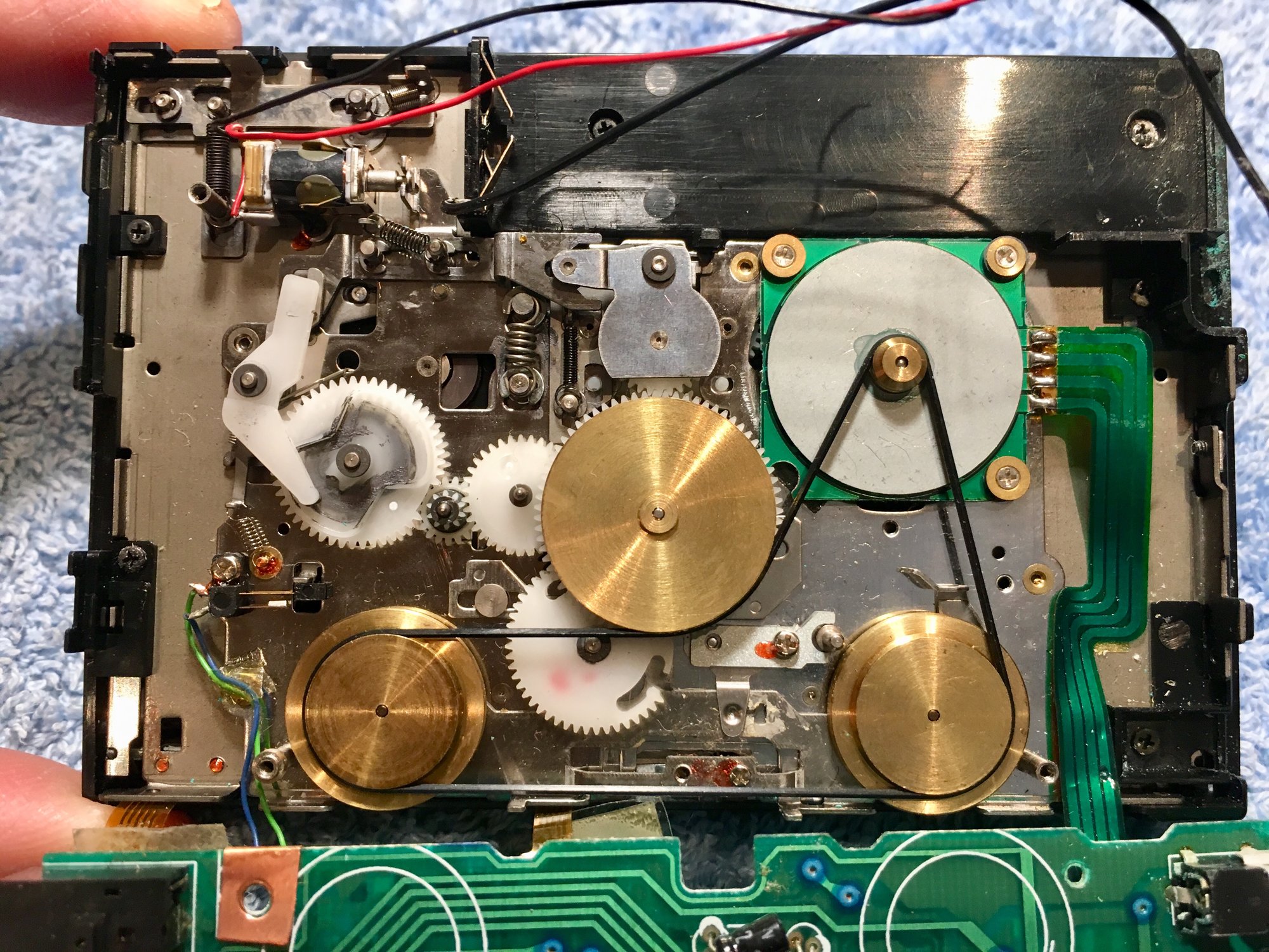

  7. ianthepostie
    ianthepostie Active Member
    150
    kent
    I changed the belt in my Sanyo JJ-P101 without any soldering or service manual. I was able to lift the circuit board up just enough for me to gently hook in a new belt with a pair of tweezers. It was very fiddly though and I nearly gave up a few times! The only bad thing that happened was that I lost a screw!

  10. scottsasonic
    scottsasonic New Member
    21
    Ontario Canada
    This unit is a much different beast.. one has to totally take apart to change belt. No way to do so with 'tweezers'. Keep a magnet or dish around so you don't lose tiny screws.
  11. scottsasonic
    21
    Ontario Canada
    How did you get around the plate that covers the fly wheel ? That has to be removed to install a belt as the circuit board lifts up like on a hinge ... are you sure you're talking about the 101? It appears to be same mechanism as JJ-P6

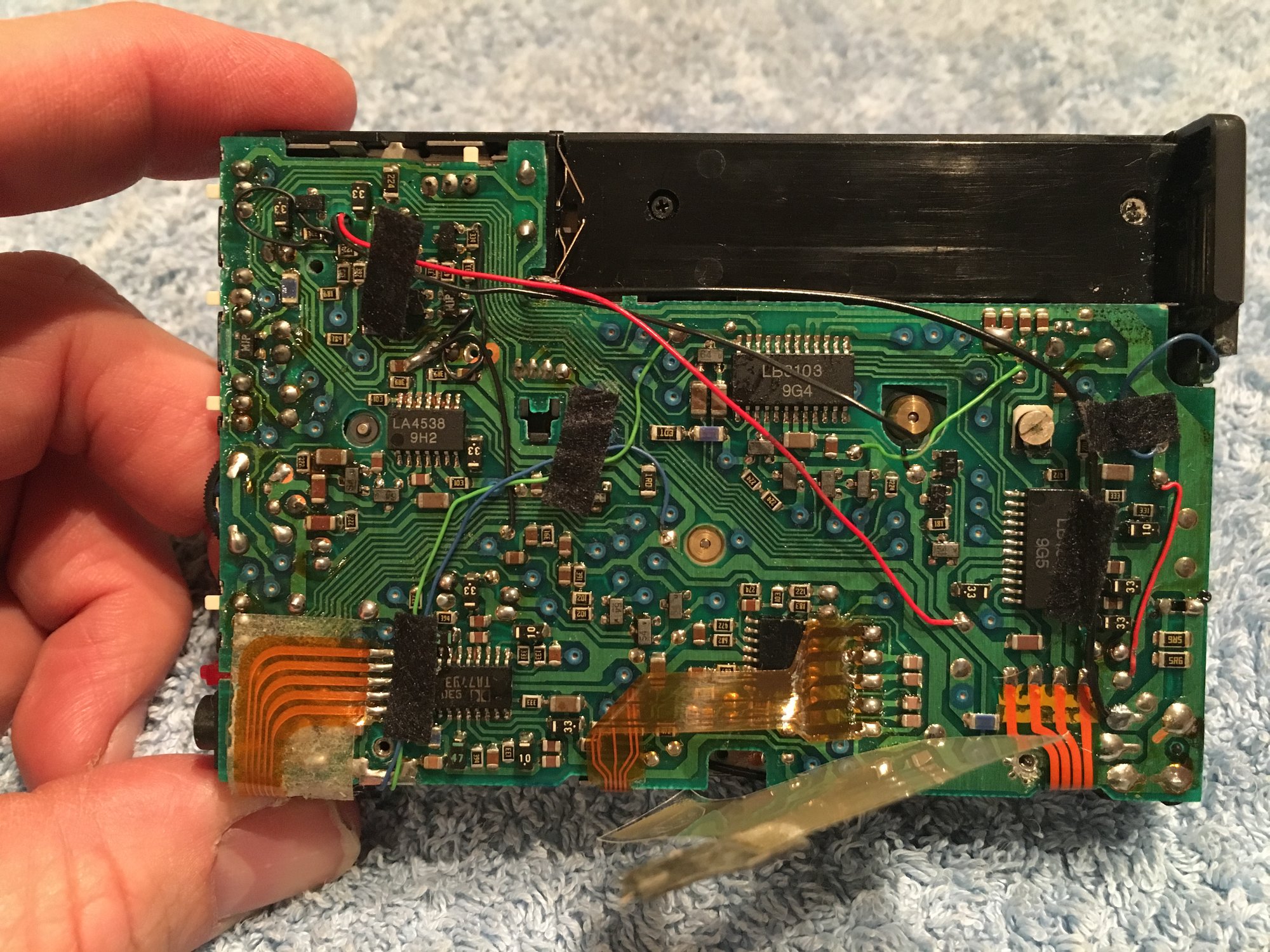

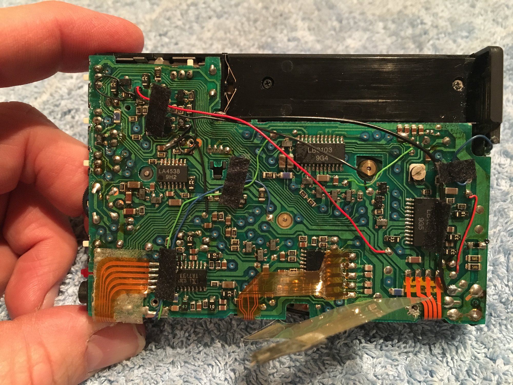

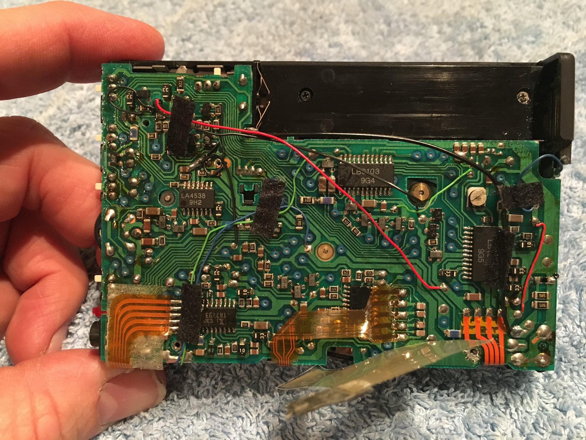

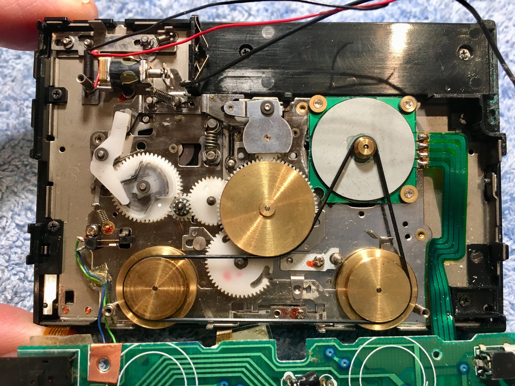

  12. ianthepostie
    150
    kent
    This is the Sanyo JJP 101 with the board removed. I got a belt from Marian which was actually for a JJ P5 IMG_E7170.JPG IMG_7167.JPG but it turned out to fit this one quite well.

  14. scottsasonic
    21
    Ontario Canada
    did you change your comment? cause it is the JJP 101 :)
  15. scottsasonic
    21
    Ontario Canada
    Yes , looks 'similar' to the JJ-F4 - F6 . But there are major differences as well, many circuits are different and alternate components used for similar functions..
    I was amazed to hear you installed the belts with tweezers without removing the circuit board, but I really warn against doing that as you can crack the board and some of the smaller trace circuits as well as the tiny screws holding the board in.
    You figured out how to lift it up, that is the proper way. Some JJ models in the range also have tiny wires on top of the circuit board when you remove the back cover , some need desoldering to remove board.
  16. scottsasonic
    21
    Ontario Canada
    The proper belt is the same for possibly the whole range of JJ's from this era. Some sony's use them as well as micro-cassette recorders.
