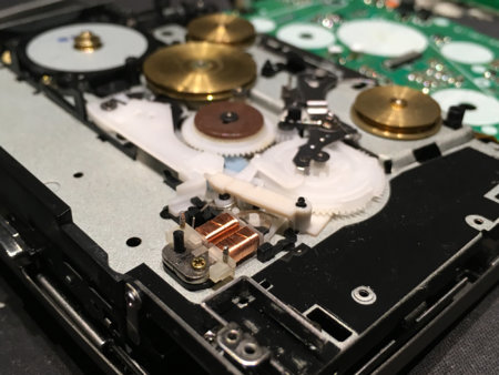

Hello, does someone have the "Service Manual" of an "AIWA HS PX100"? I want to change the belt and see which capacitors I have to change. Maybe I'll be lucky. I thank you.

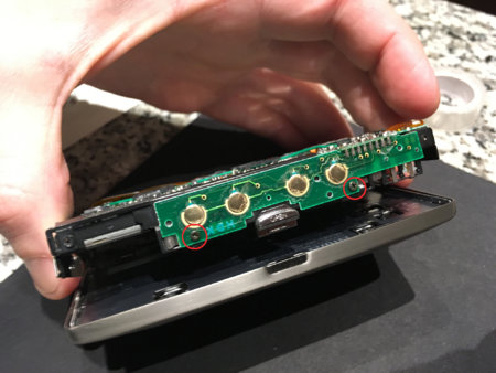

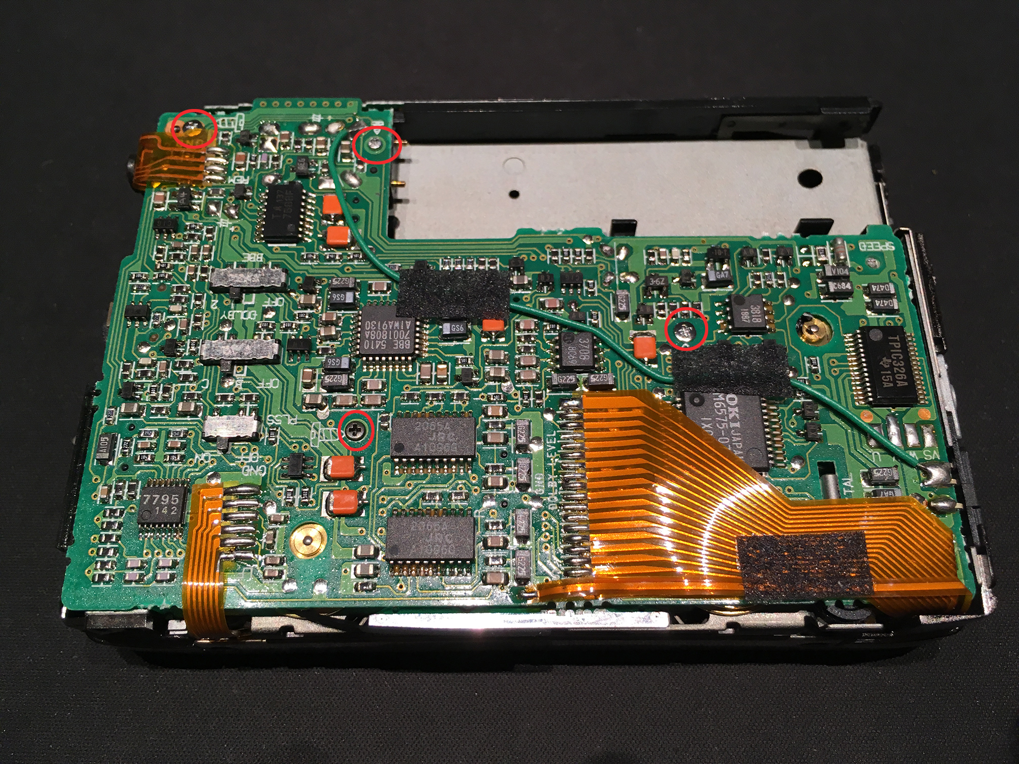

I don't know how to remove the board. Do I have to unsolder something? I have already loosened the screws. Four screws on the board and two on the control after I removed the frame and buttons. What can i do?
I found a manual for an AIWA HS PX707. The board looks very similar but the drawing isn't that accurate. Does anyone know the correct number of pins that have to be unsoldered?

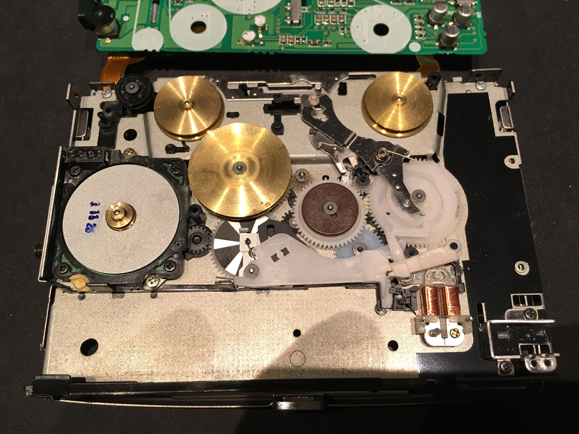

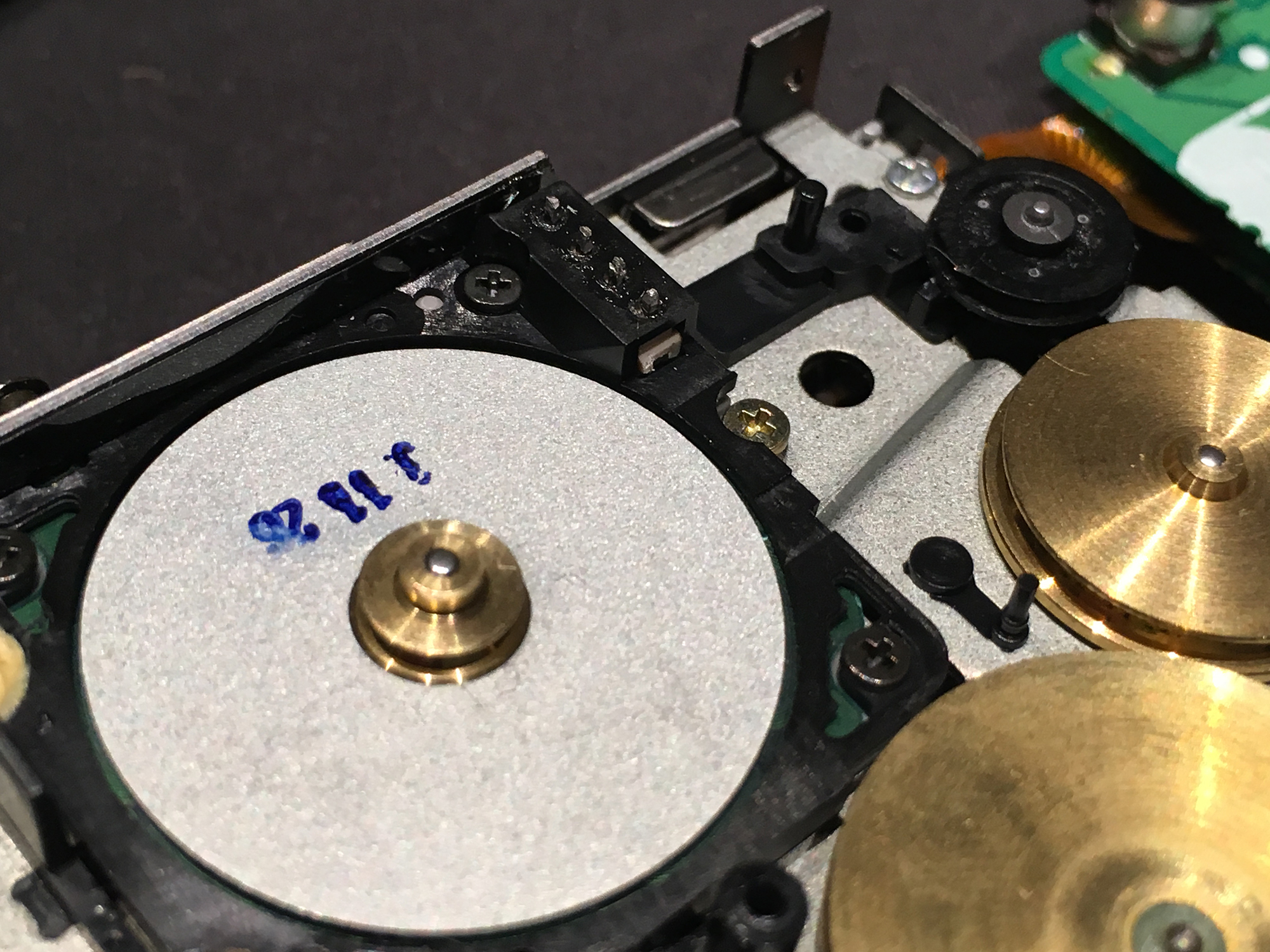

So far so good. I did it with al little bit of help from tpknguyen09. Thank you again. 6 Pins had to be unsolder. Now comes the next challenge. Change capacitors and find the right belt. Does anyone know where I can get the right capacitors? I need 4mm high capacitors. I'll probably get the right belt from Marian.
