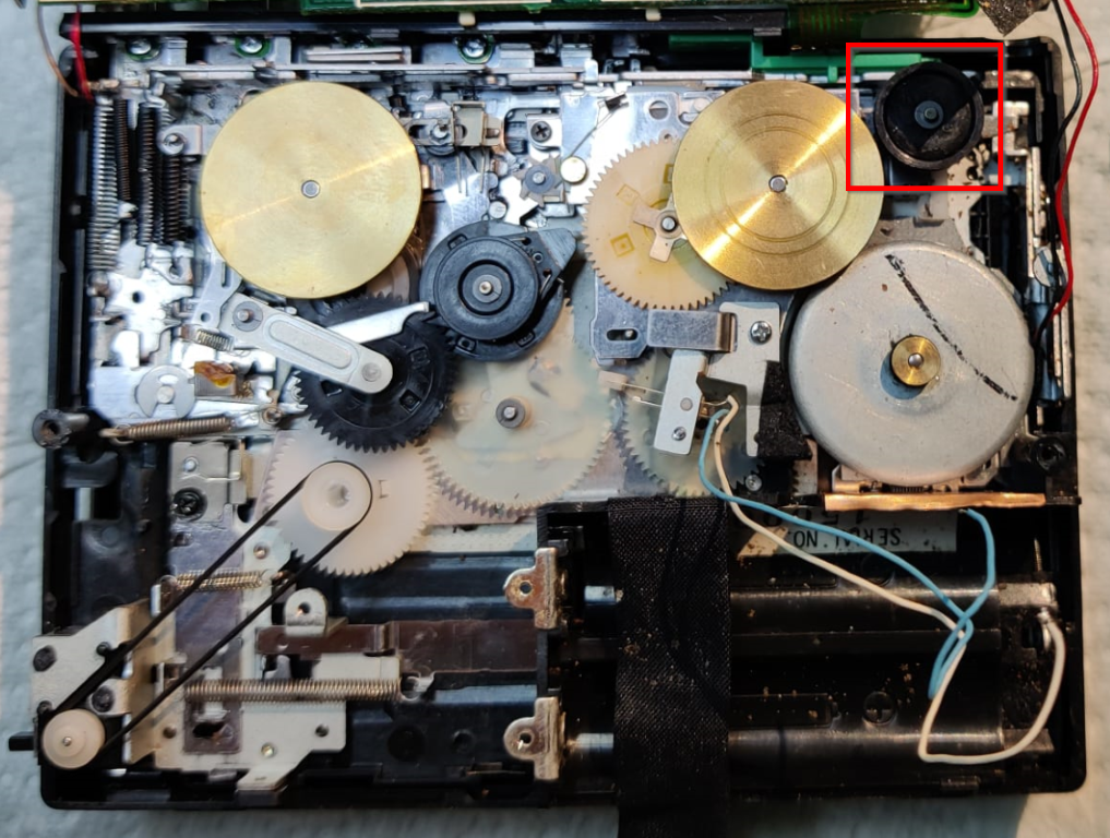

    Goodmorning community,
    A few days ago I received a repair which is a Sony TCM-1000. This models shares the same mechanism as in a TCS-470, WM-R55, WM-F55, WM-55 and maybe more models, i'm not sure.
    It has a missing pulley as shown in the picture, outlined in red. I guess the diameter of the pulley will be around 11-12 mm and the inner diameter for the shaft would be around 1.5 mm.
    Is there someone on this forum that has such a pulley in their spare parts and that is willing to sell this part?
    You would be very helpful!
    Thanks,
    Roland

    Update: i used a pulley from a Sony EX mech and drilled the inner hole to 1.5mm.
    It's not perfect but it fits. Wow&Flutter can be better, so maybe it needs some more room on the shaft.
