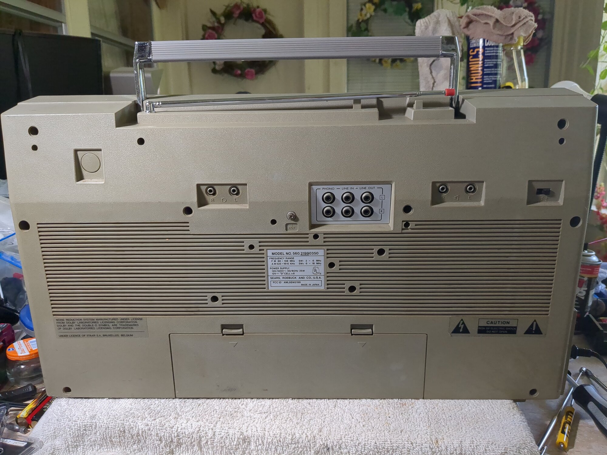

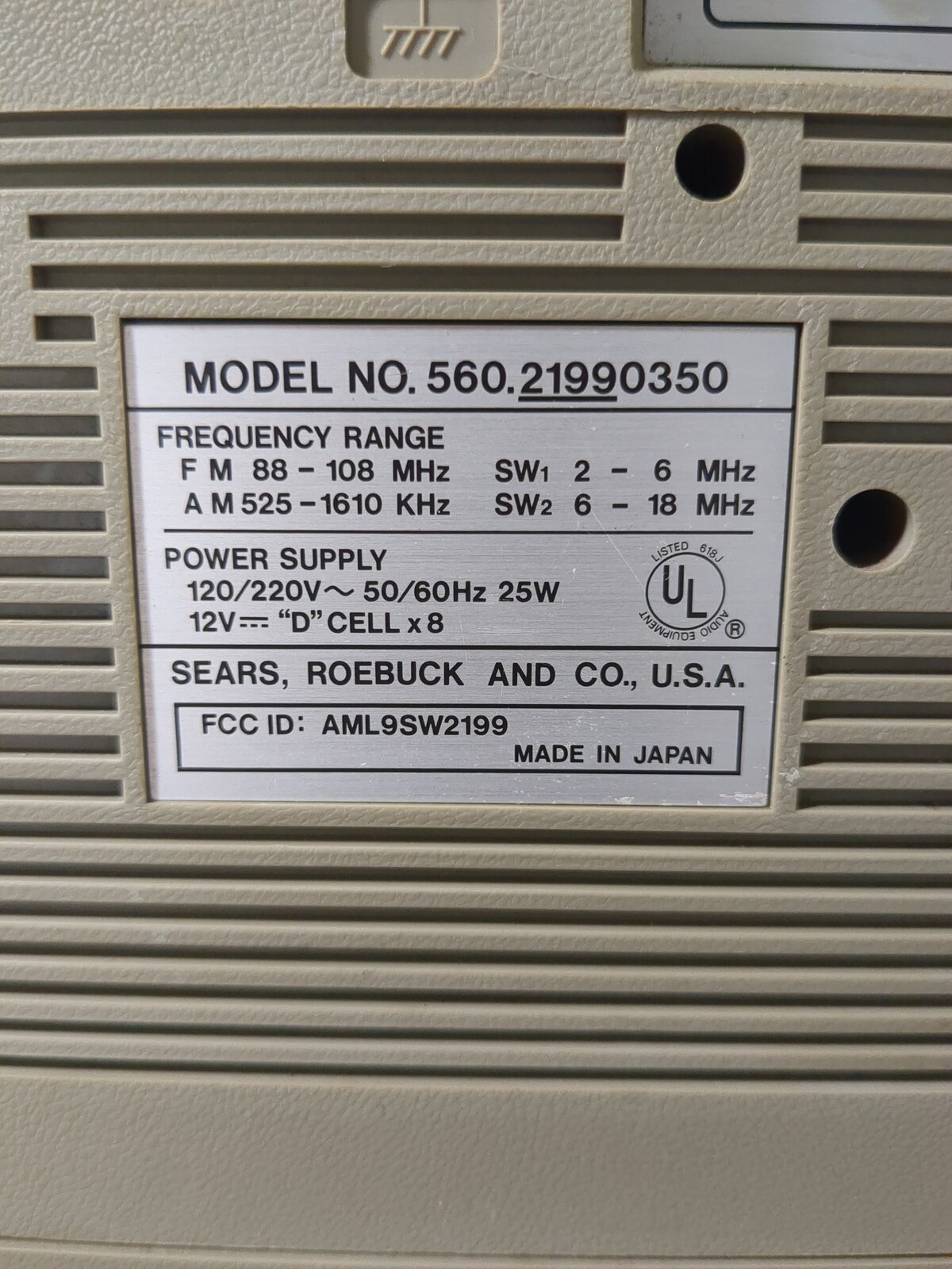

    Just to be sure, this is the model number.
    And this is the entire back.

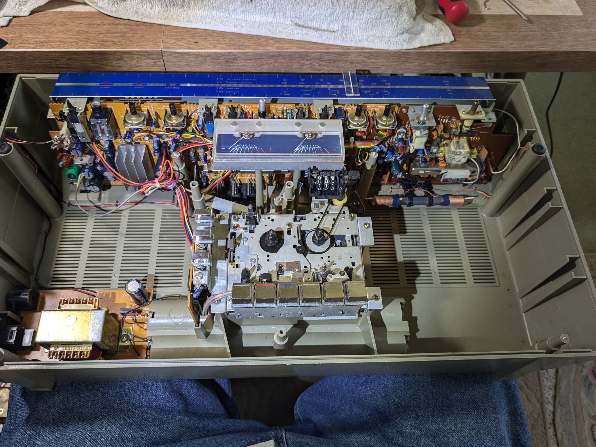

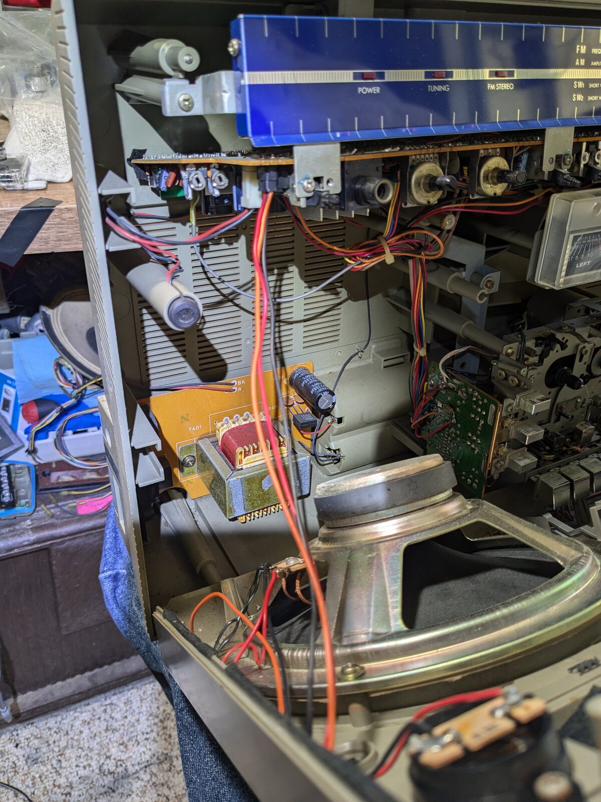

    This group is unassembly and making minor notes. I believe the inside is Toshiba.
    Only one screw came out. The rest of the screws stayed with the chassis but did unscrew from the pylons.
    The speaker wires are the only wires connected to the front of the unit so I got a picture of how the wires plug in.
    Inside the main chassis on the power supply there is no fuse PXL_20240801_210253439.jpg

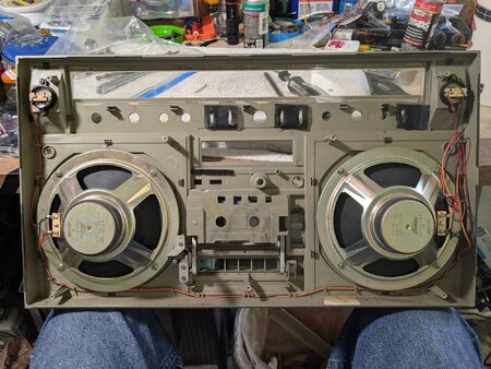

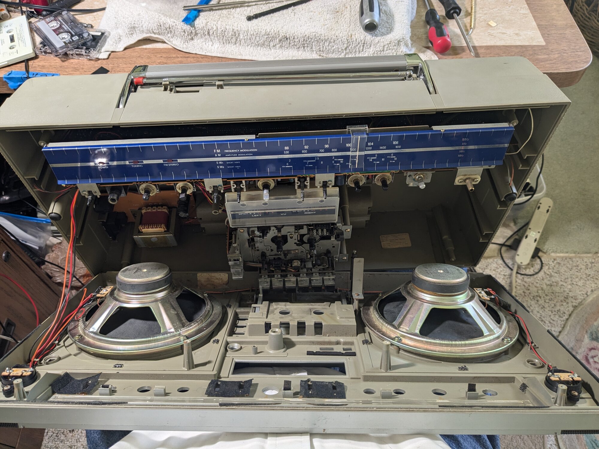

    Inside the front showing the speakers from the back which are Toshiba at least on the woopers. I can't tell on the tweeters.
    Close up of the woofer so you can see the written on the back. Toshiba and.

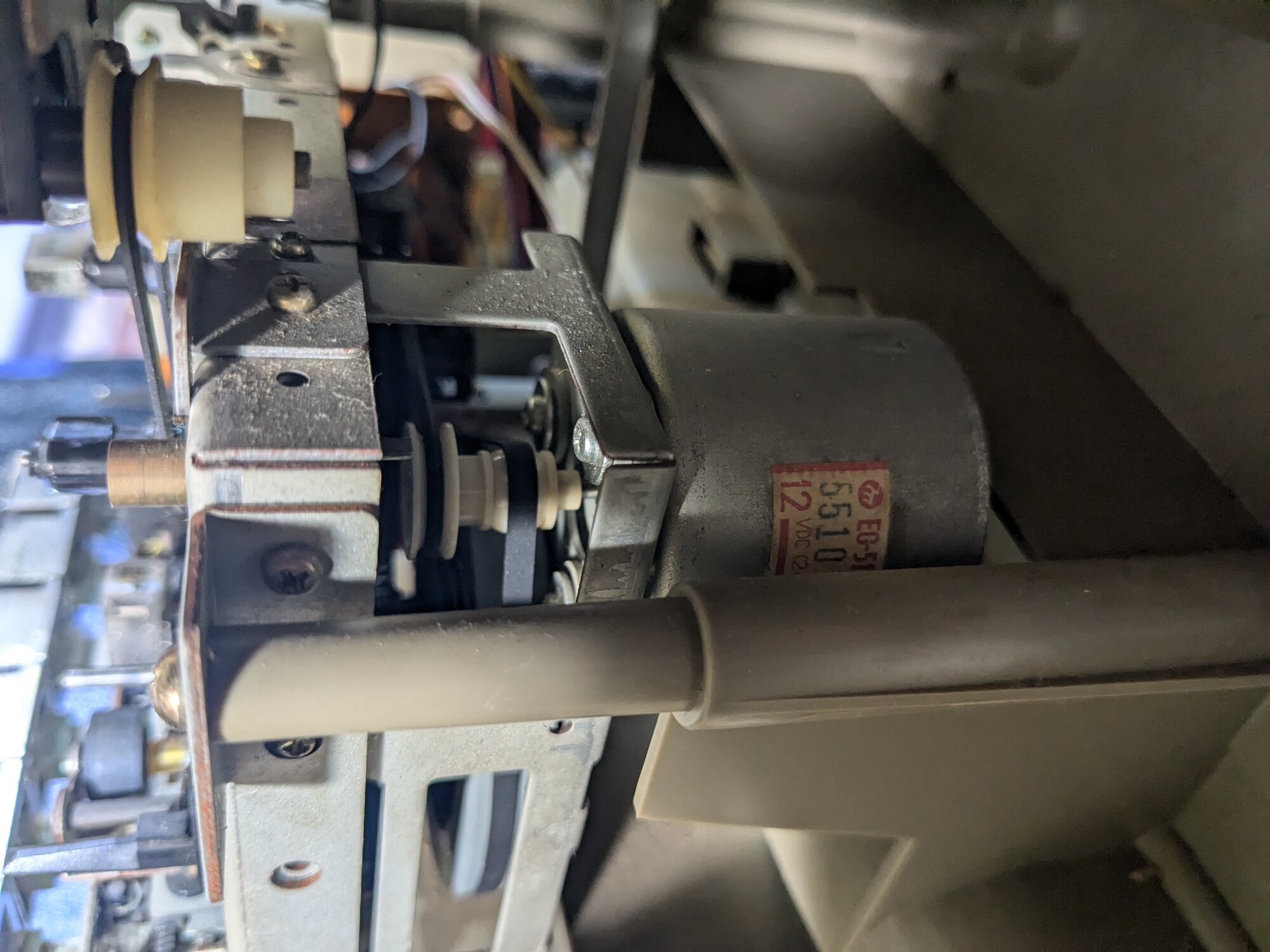

    This got turned sideways but I'm trying to show you is the motor has a flat belt drive for the flywheel but in my opinion the flat belt is too narrow. In other words, it could be wider to last longer.
    Next, I'm going to remove the tape deck cassette player and investigate the belts and their condition. Meanwhile, the counter belt is definitely not worth a dime, so I'll be replacing that asap.

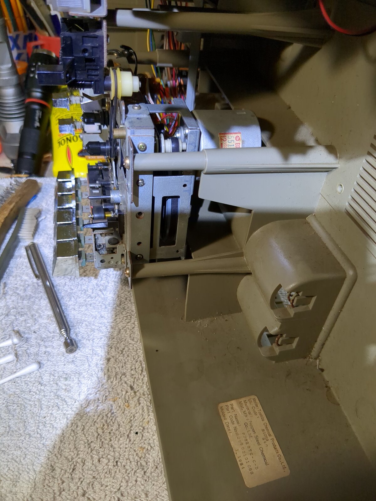

    I changed all three belts. This is how You're just a speed or pitch on the motor by putting your jeweler driver into the center of the little sticker in the rear of the motor. There's a hole there. You can adjust the rotational speed.

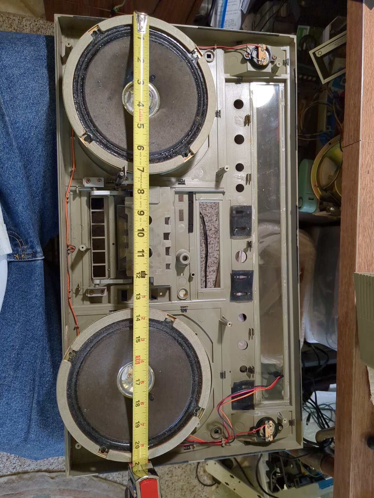

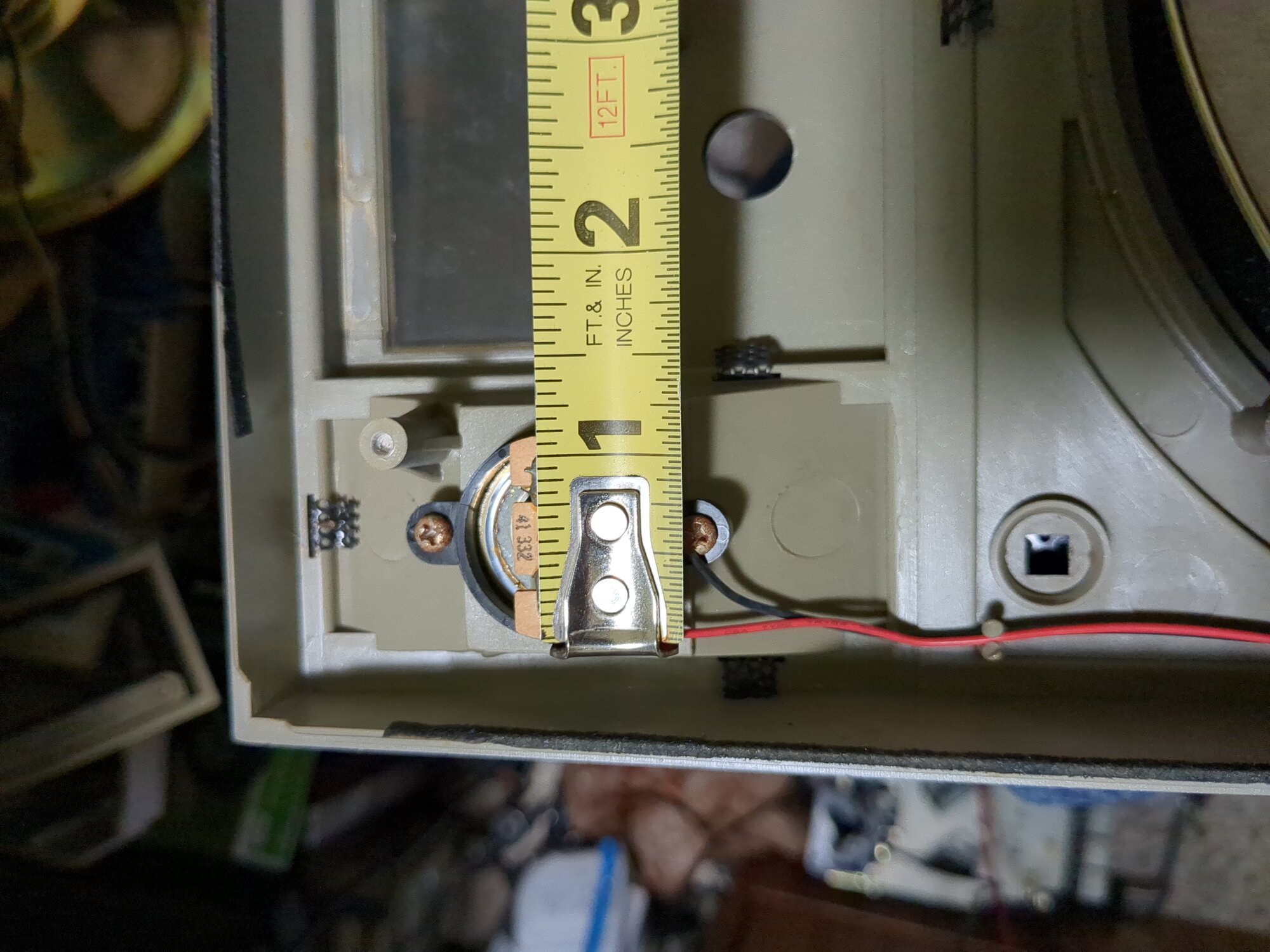

    Okay on the inside the speakers measure 7 in across
    And the tweeters are piezo and really small 17226346304423011787366351188951.jpg
    And since it's sitting right here I did put in a new wider main drive belt 17226347095873812042888952368911.jpg
    Just a bit more tidying up and I'll put it back together

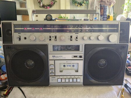

    17226500637353454439890586756082.jpg All back together now
