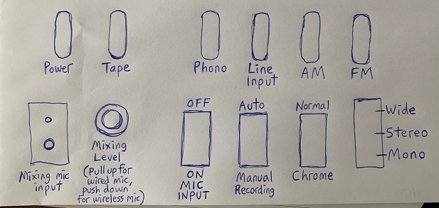

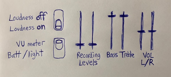

    This is a generic picture from a sharp GF 305 I think and then let me get you the other one
    Again, another generic picture from the sharp gf305 copied from the Wikipedia boomboxes page for that model.
    Reason why I'm posting these here is because it explains what the buttons do.
    Your sharp gf9696 should have the buttons laid out in this manner.
    You need to select the radio FM or am and then the power switch and that will turn on the radio without having to press the buttons on the cassette deck.
    Otherwise, if the power button is not on then the tape deck will operate without the power switch being depressed. Hope you can understand that.

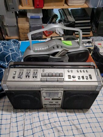

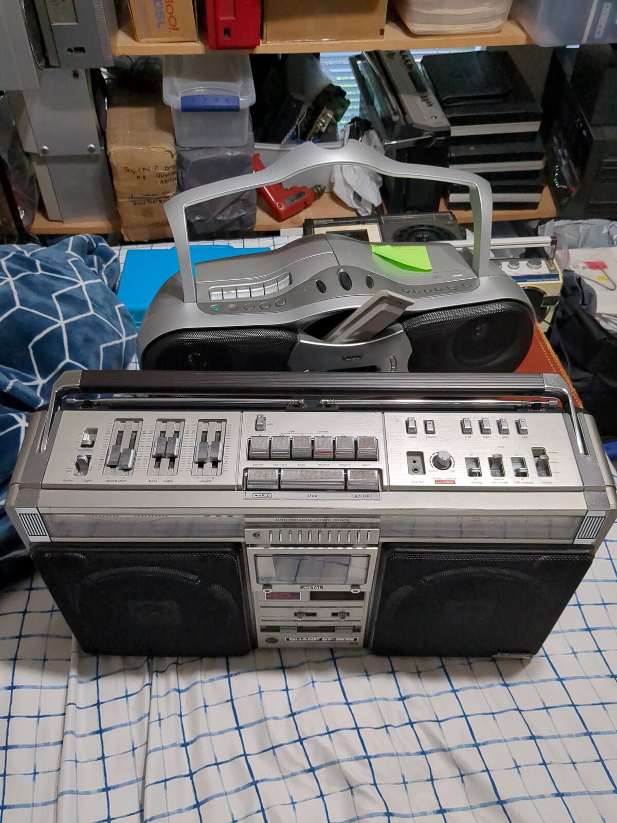

    This is my GF 9696 for reference.
    It works cassette radio everything except for the echo on the front that doesn't do anything.

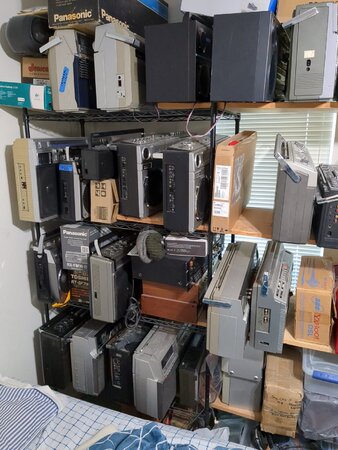

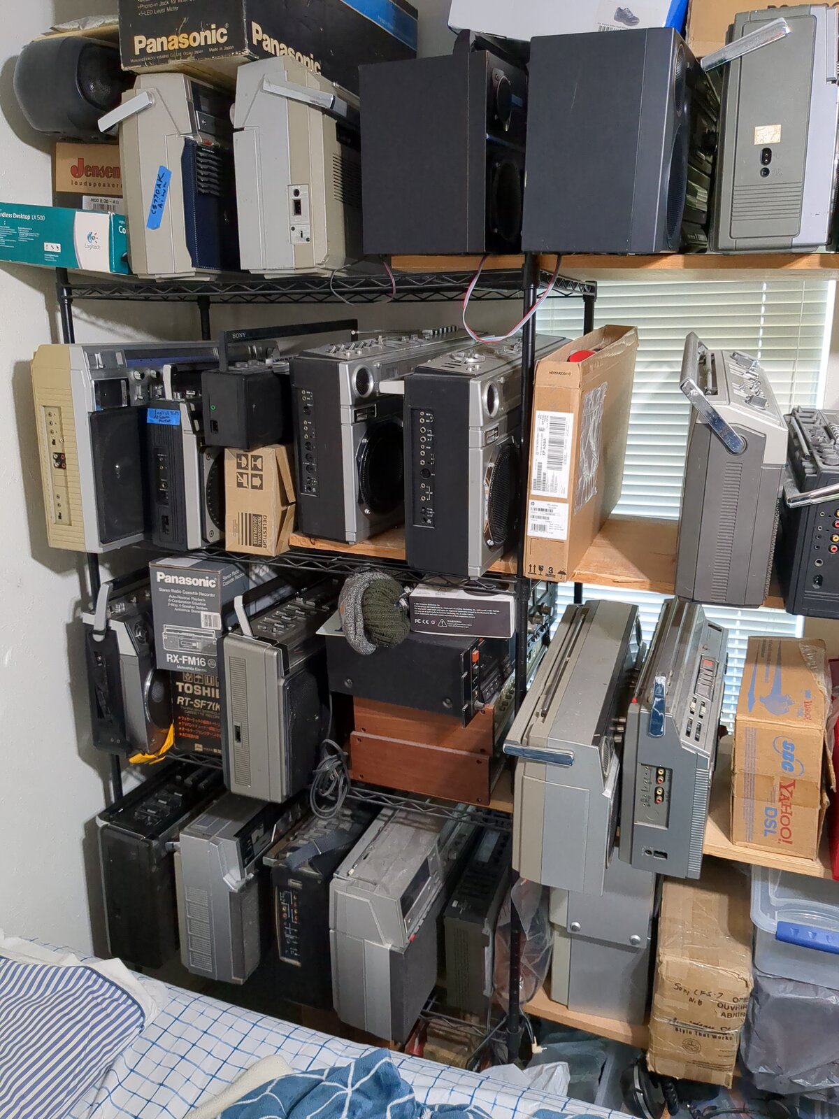

    I just put it back on the shelf. It's slightly sticking out right now along with a few others that you might recognize. 17206270096342576692469876798694.jpg
    Everything has been repaired that you can see on the shelf except for maybe four of them that I might need to go back through. And no, I haven't repaired the tascam yet.
