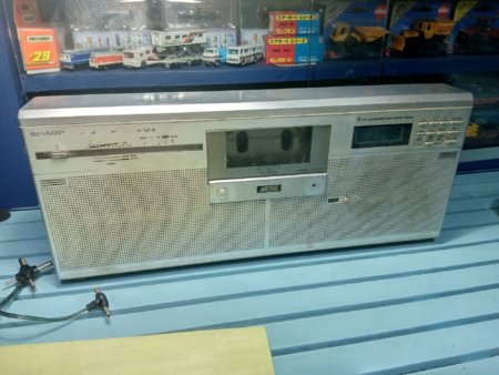

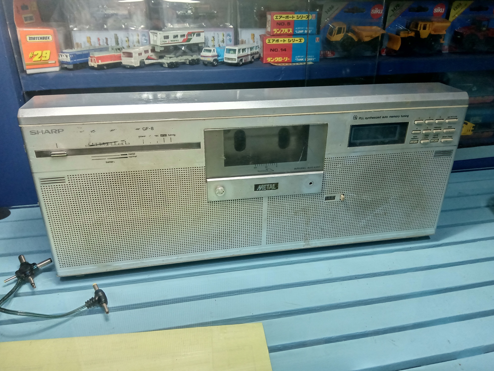

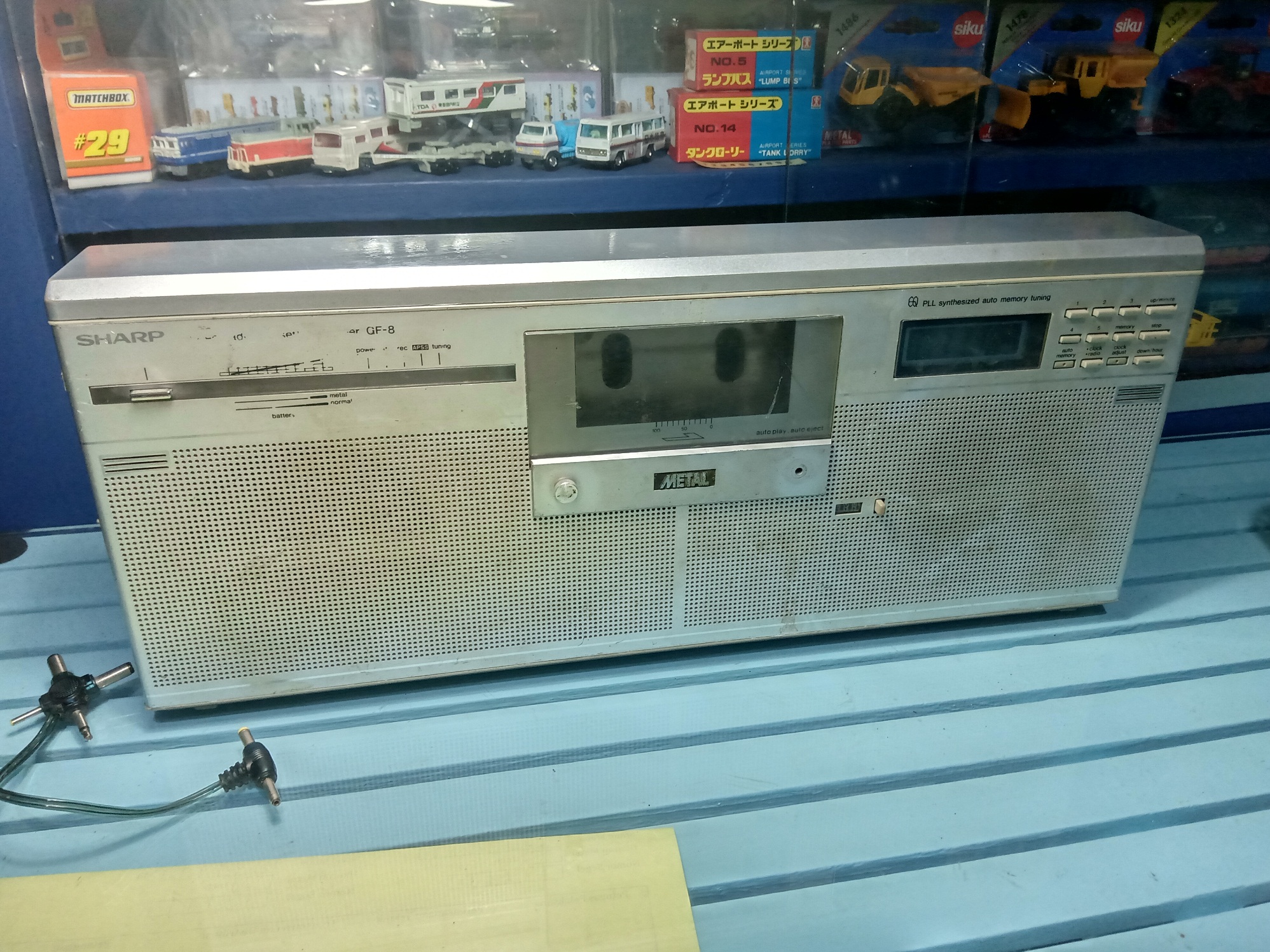

    When I saw this for sale 2 weeks ago, I didn't know of the existence of this model. So I immediately looked it up and instantly decided that I really want it. In addition to the styling which I love very much, this has got a rather unique mechanism for a boombox. It's a top loader!
    The seller says the the unit works well as speaker (line in) but neither the radio nor the tape is working. Though the sound of the motor can be heard. So I'm expecting it to be a simple belt change.

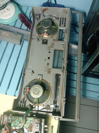

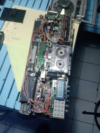

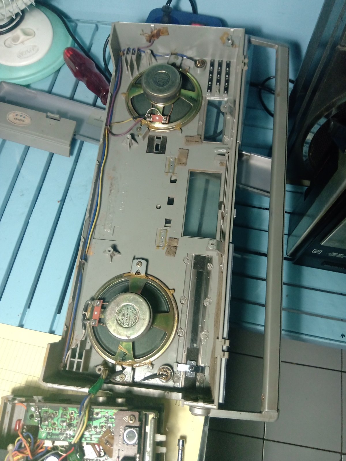

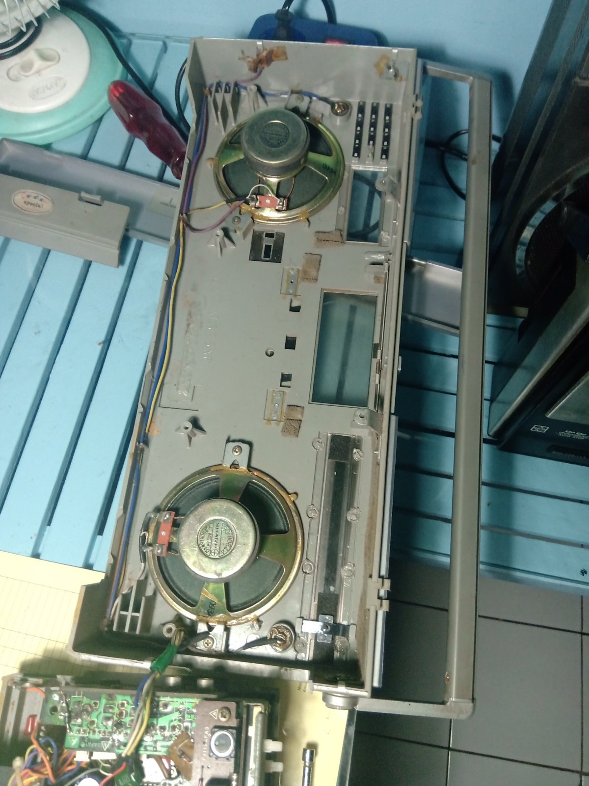

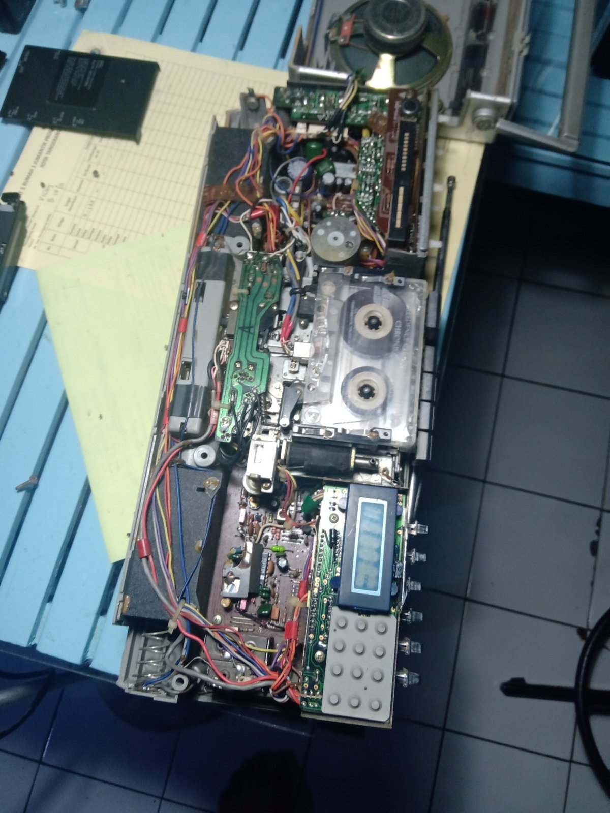

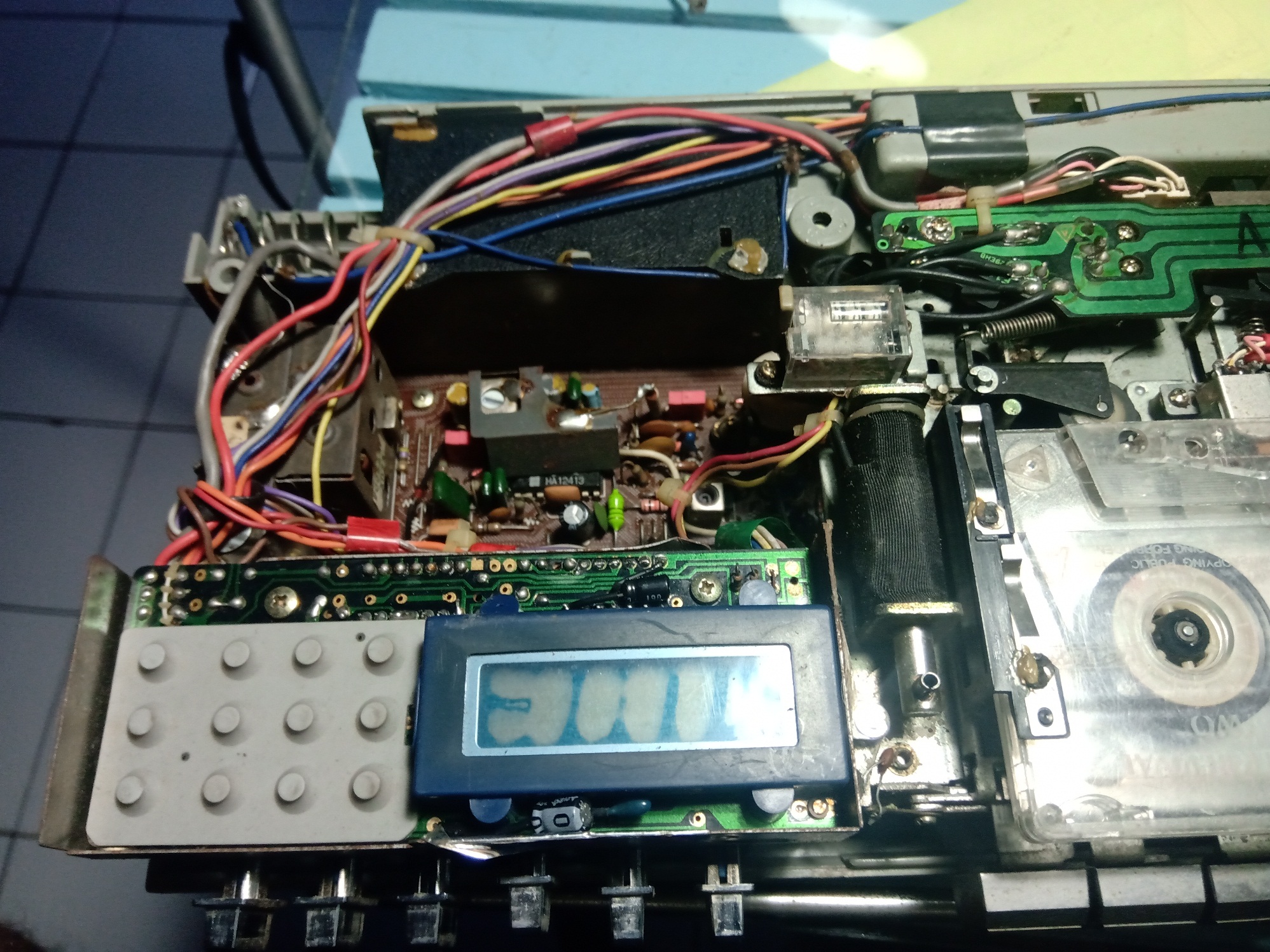

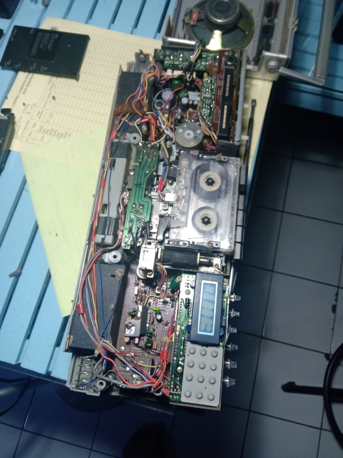

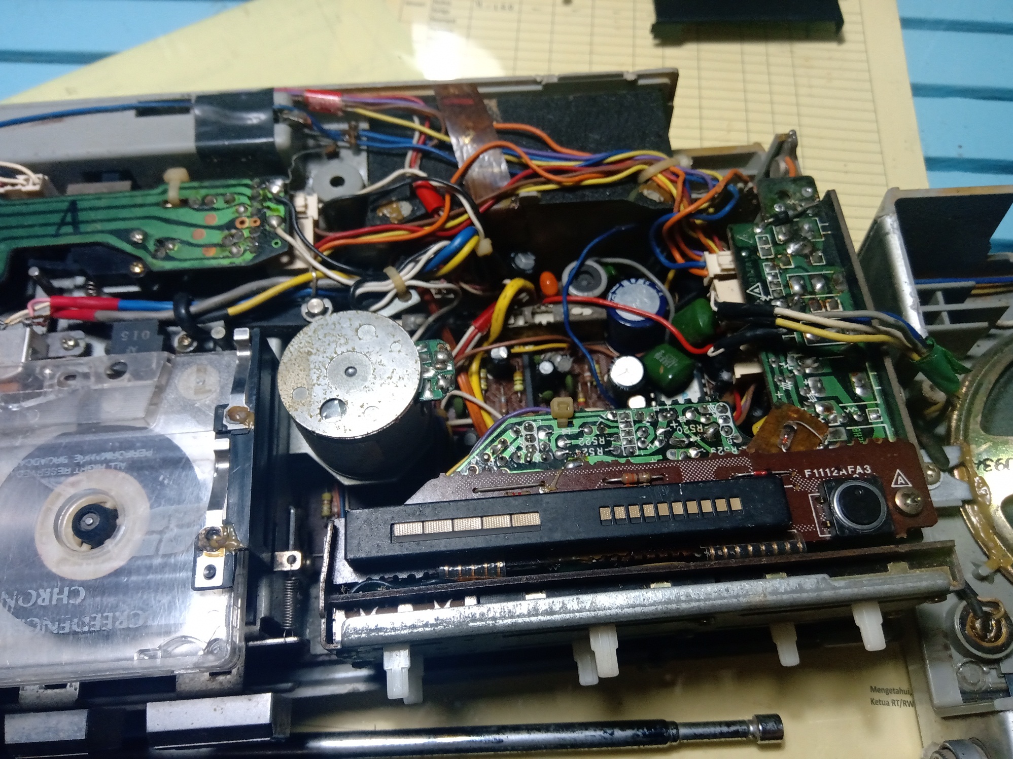

    It arrived as described and quite dirty. I couldn't find any manual online, and thankfully it was very easy to open up. The entire front panel with the speakers swings away cleanly and can be removed by releasing 2 wire connectors.

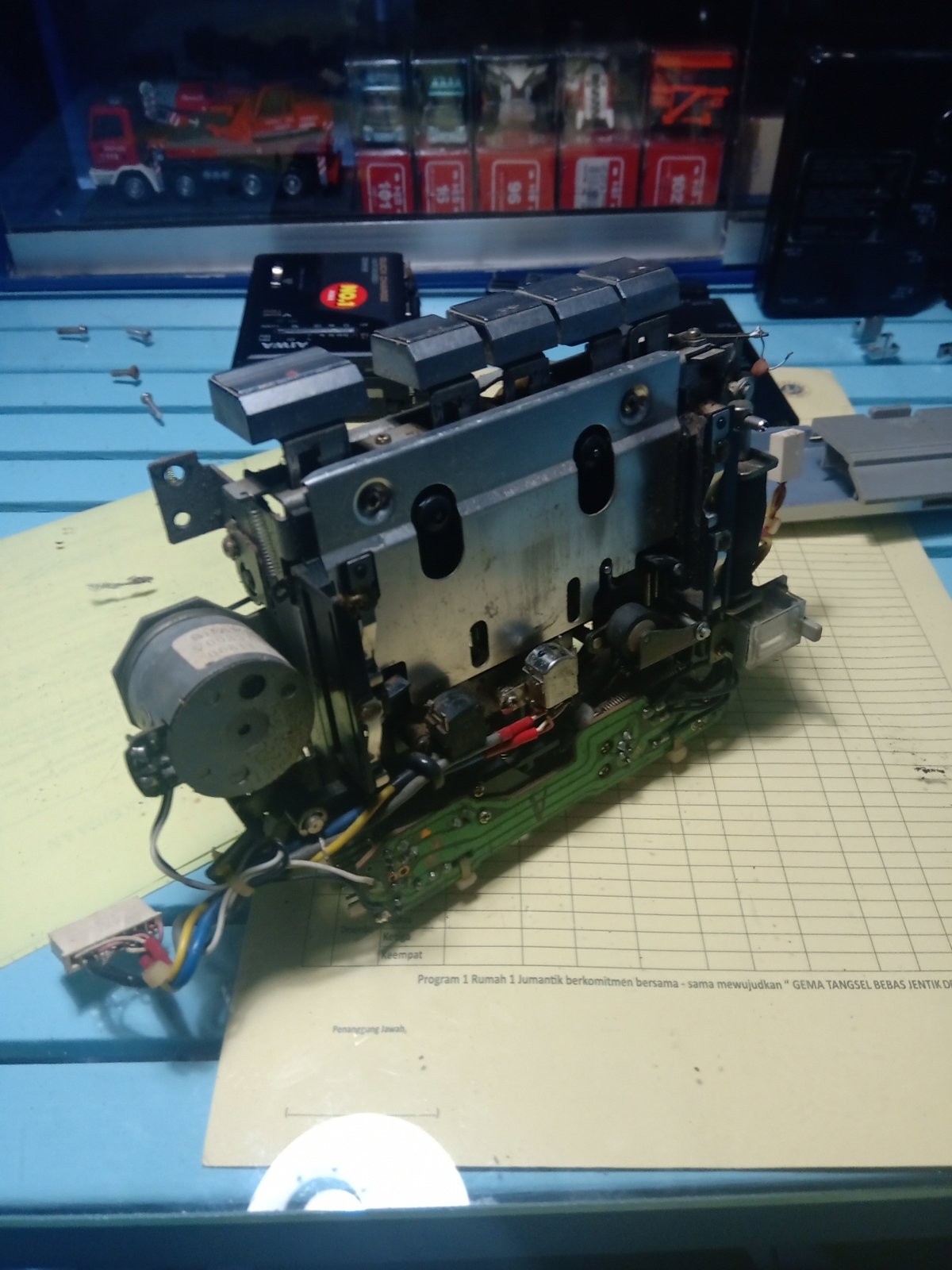

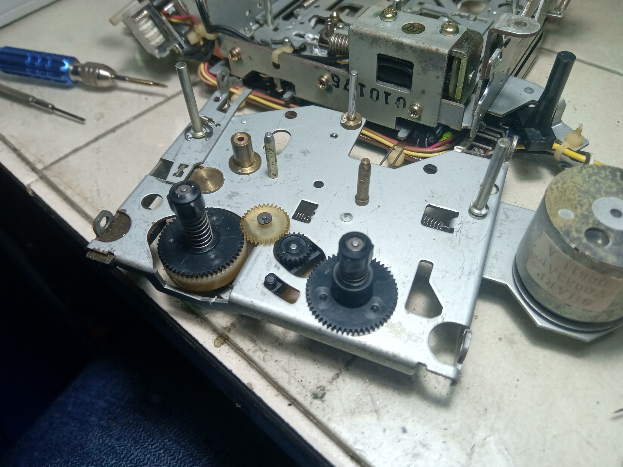

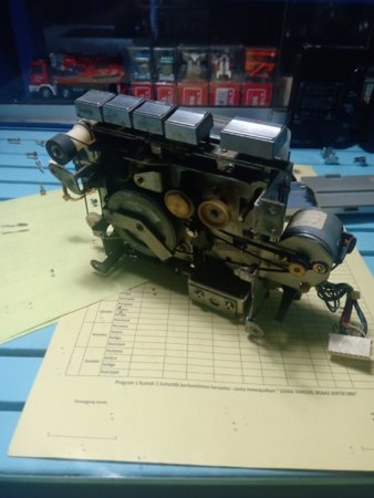

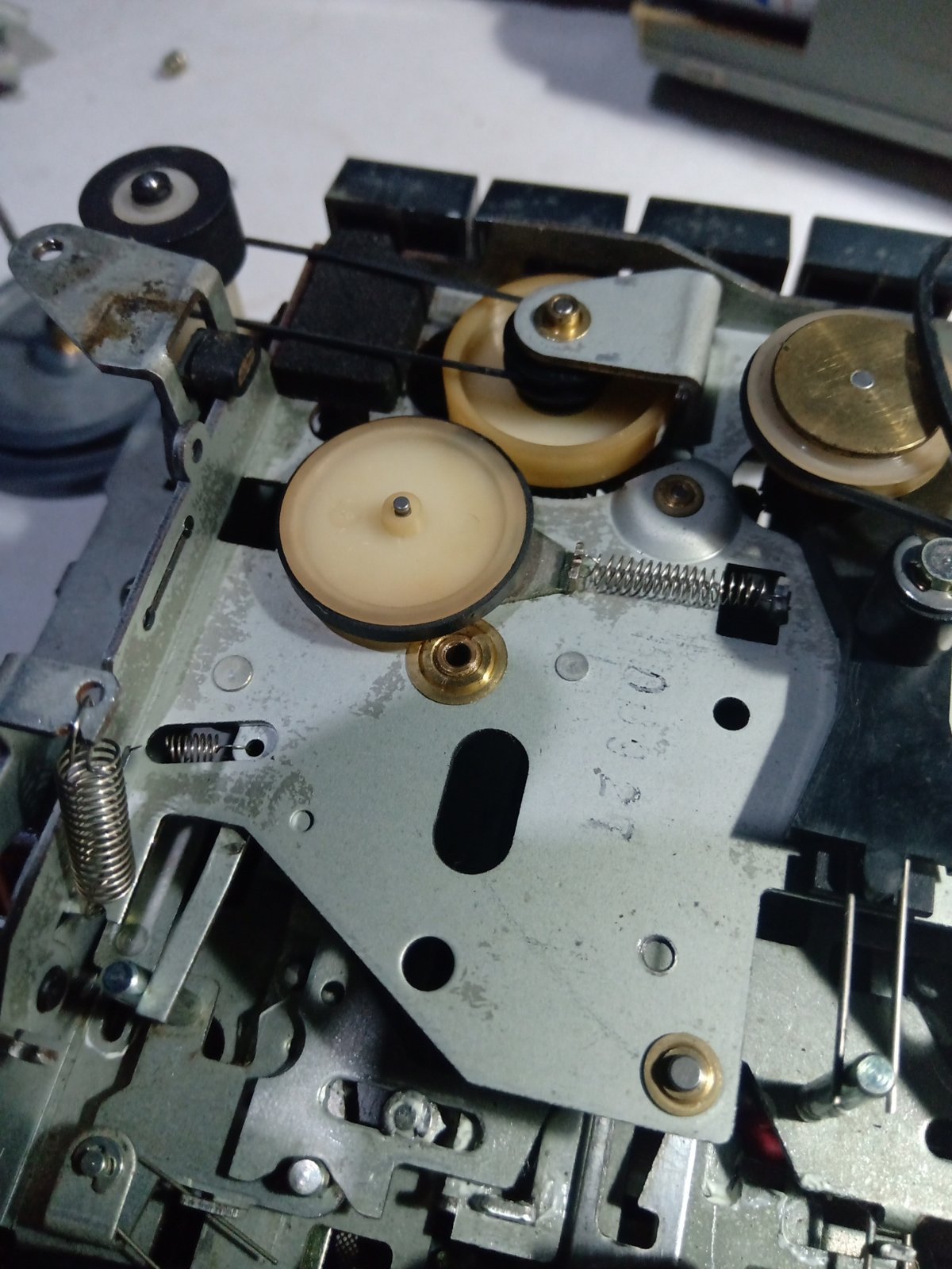

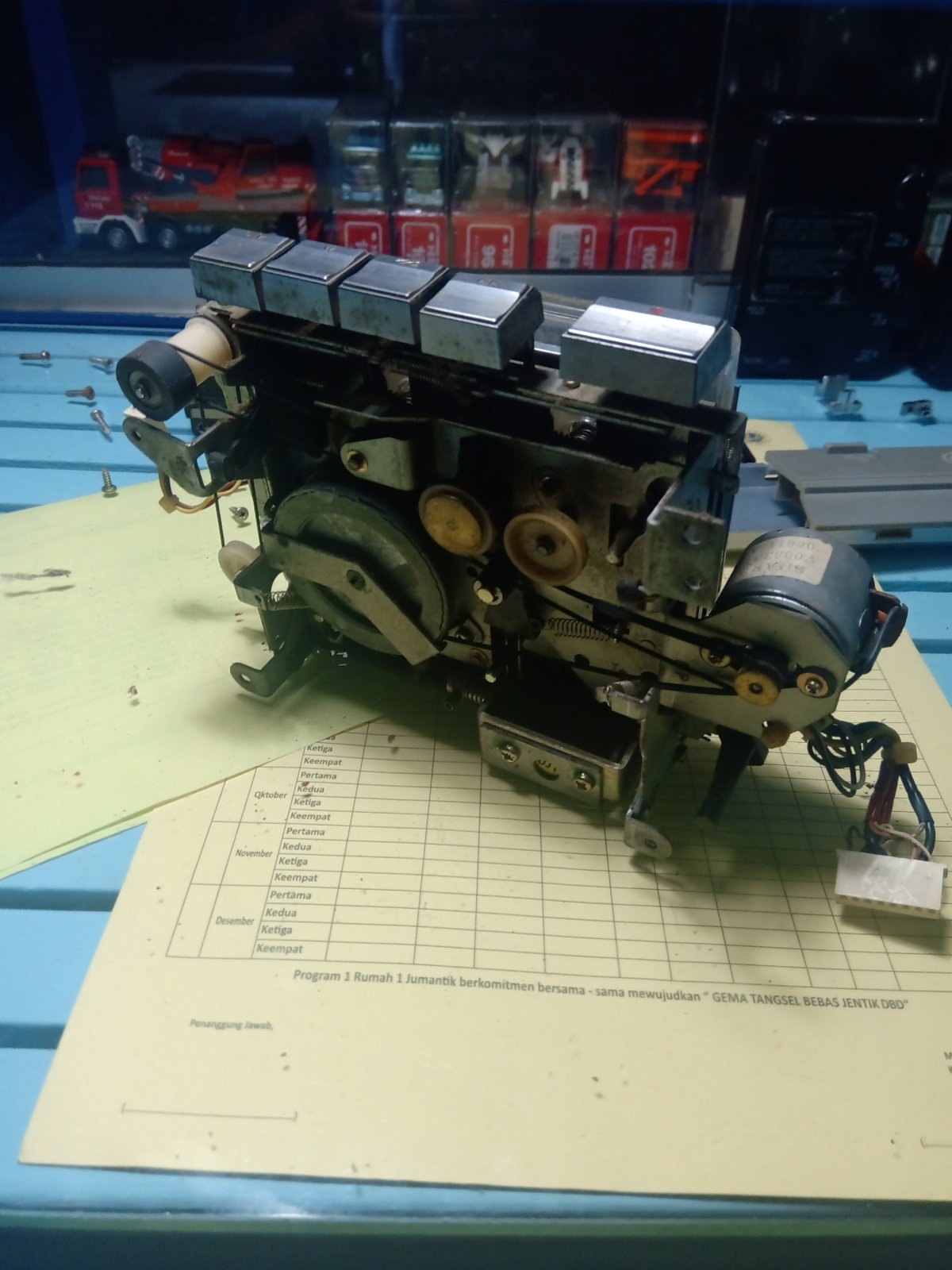

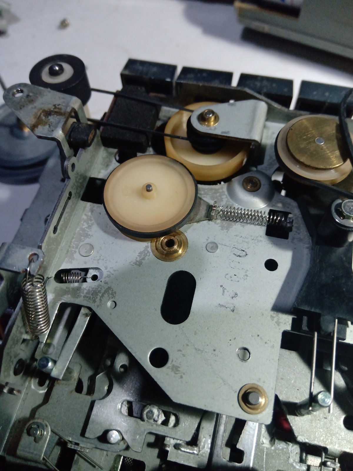

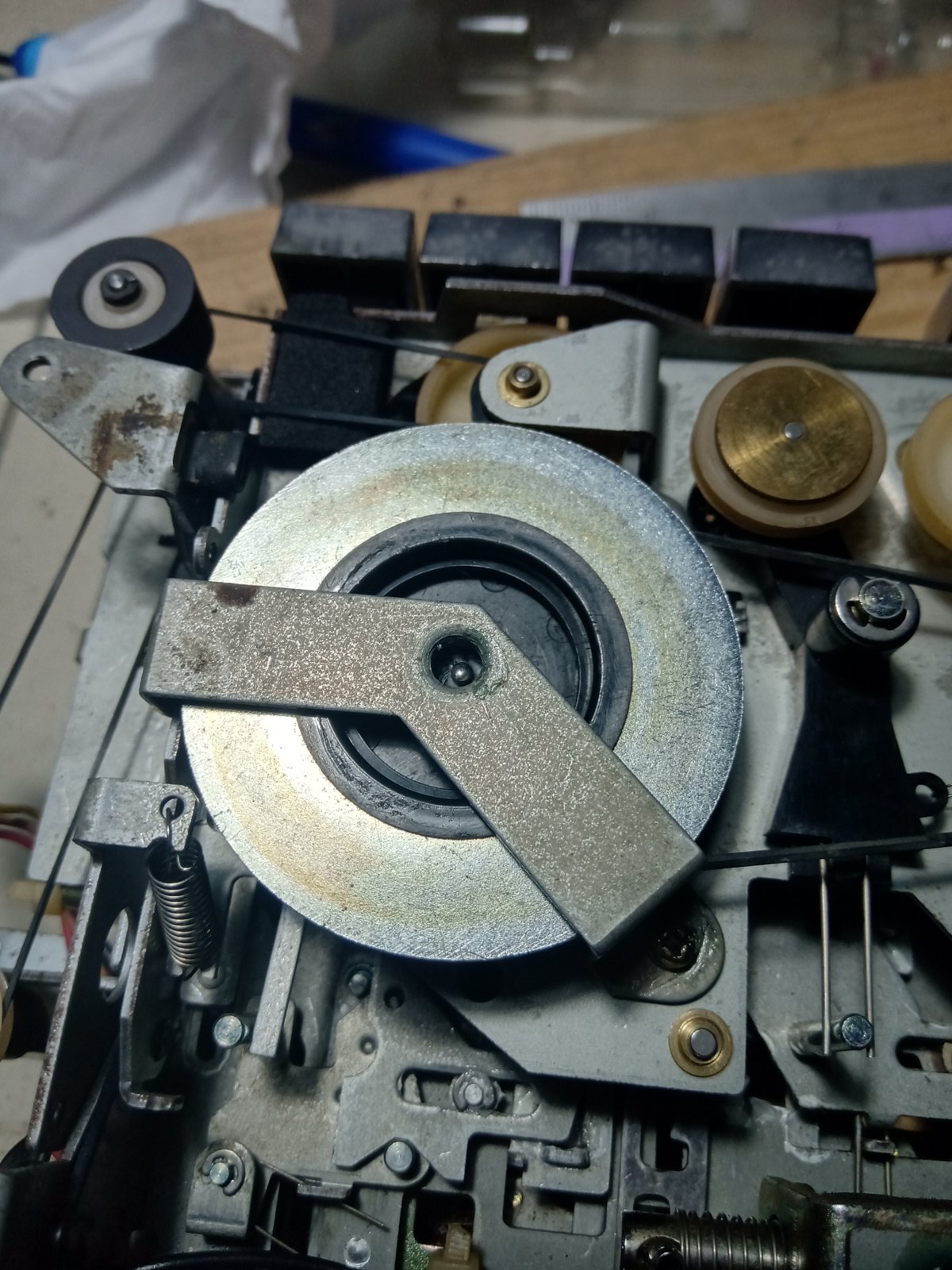

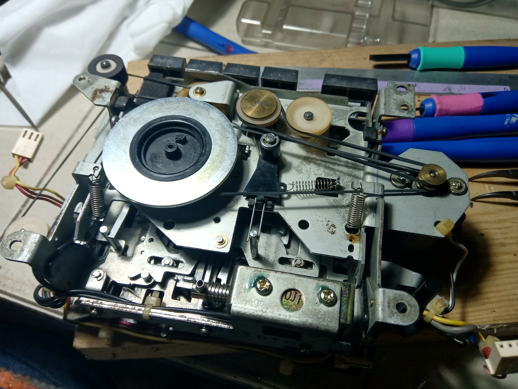

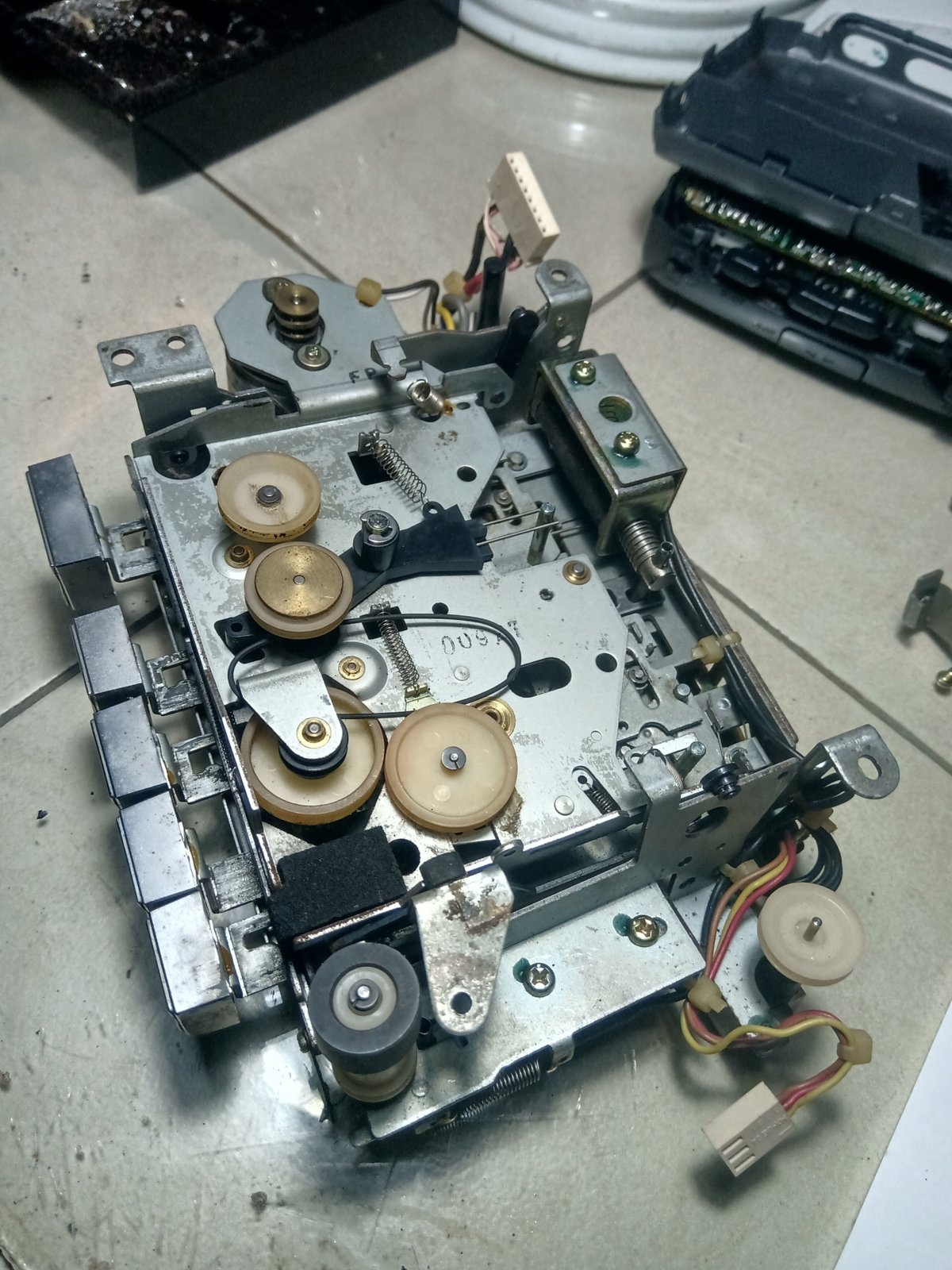

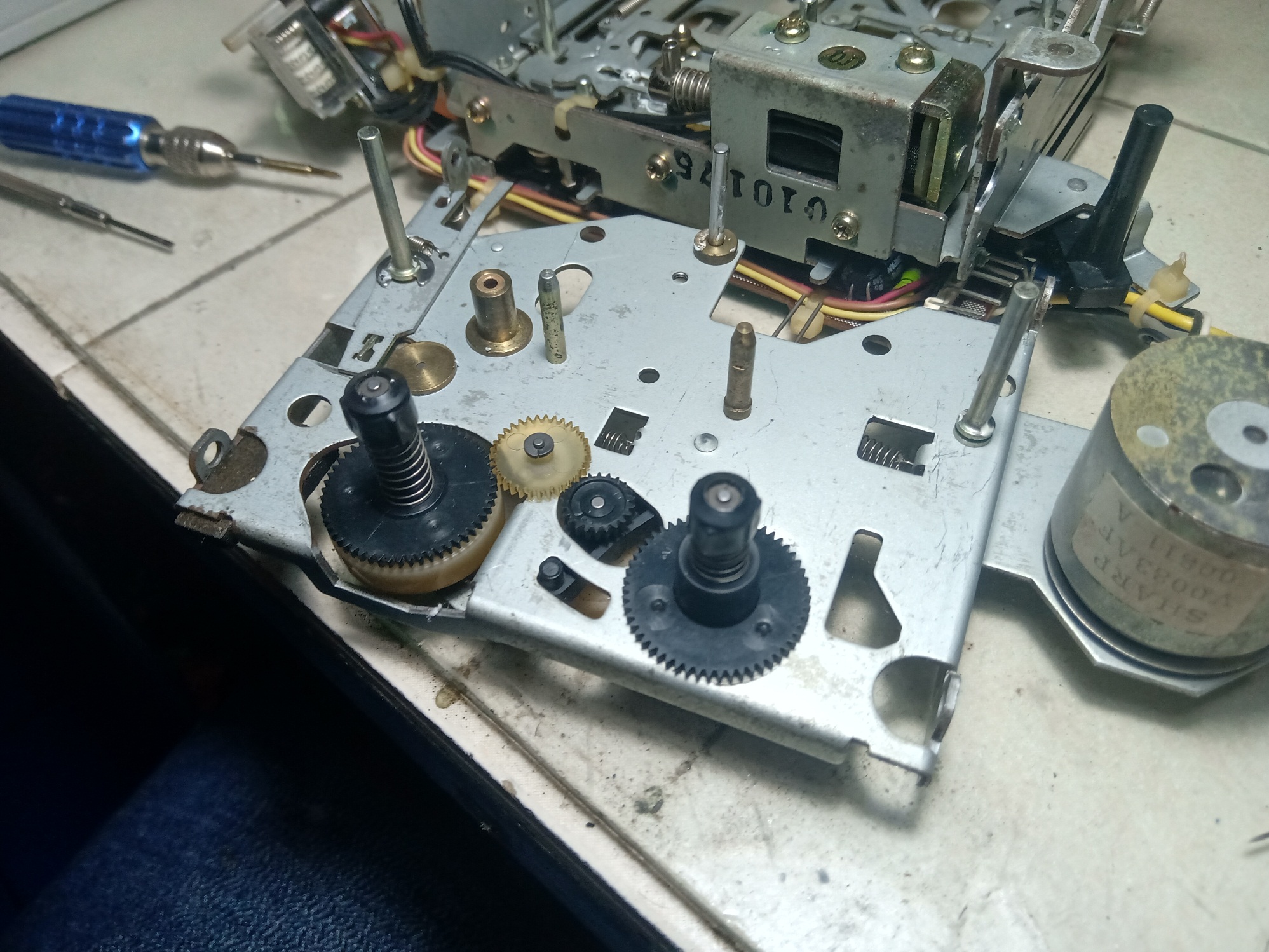

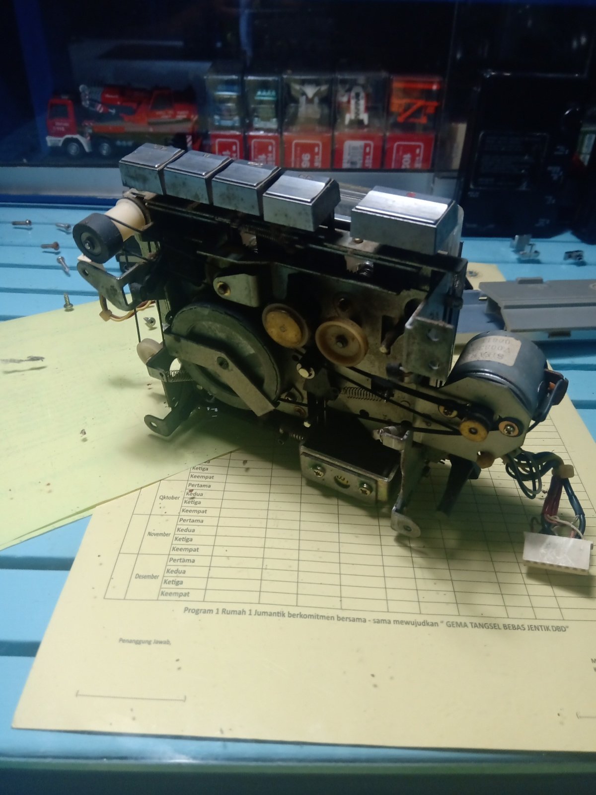

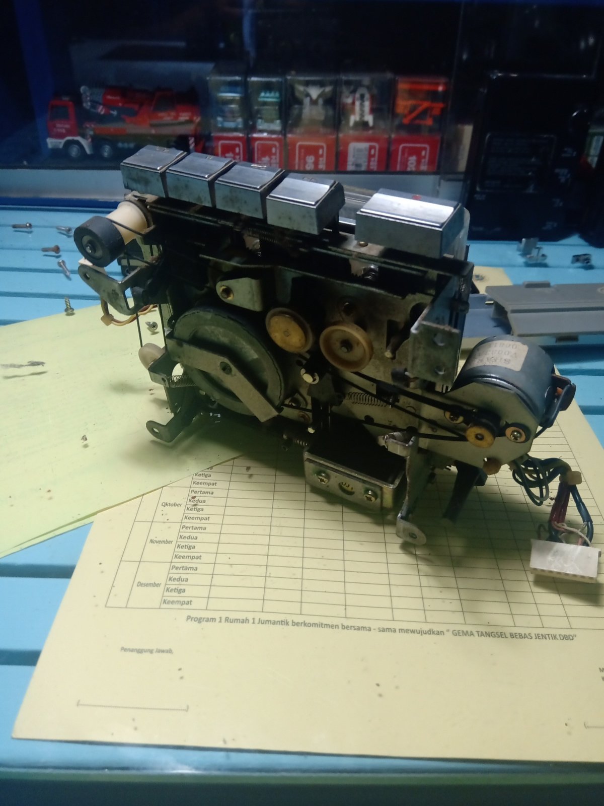

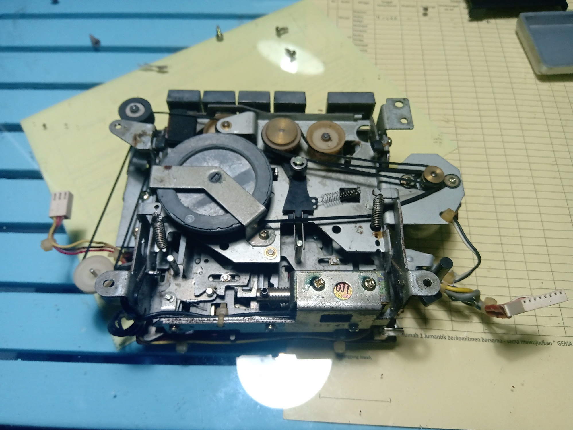

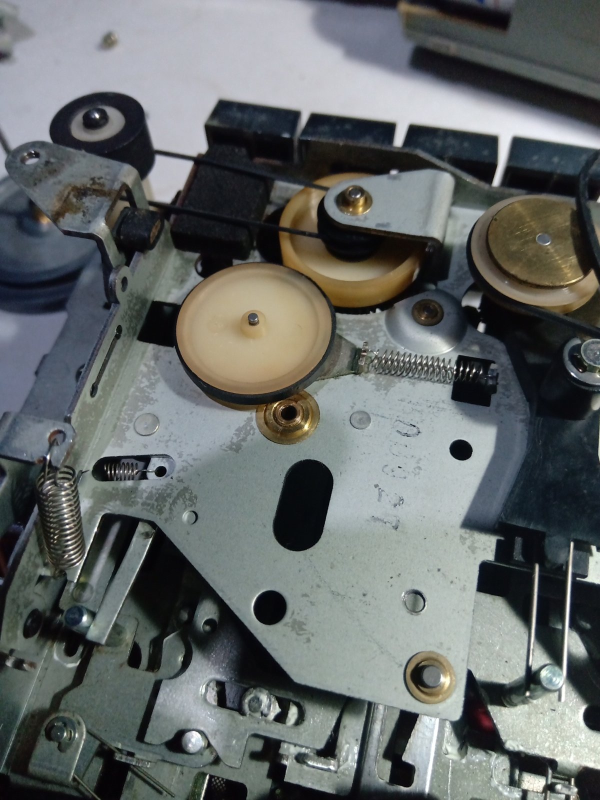

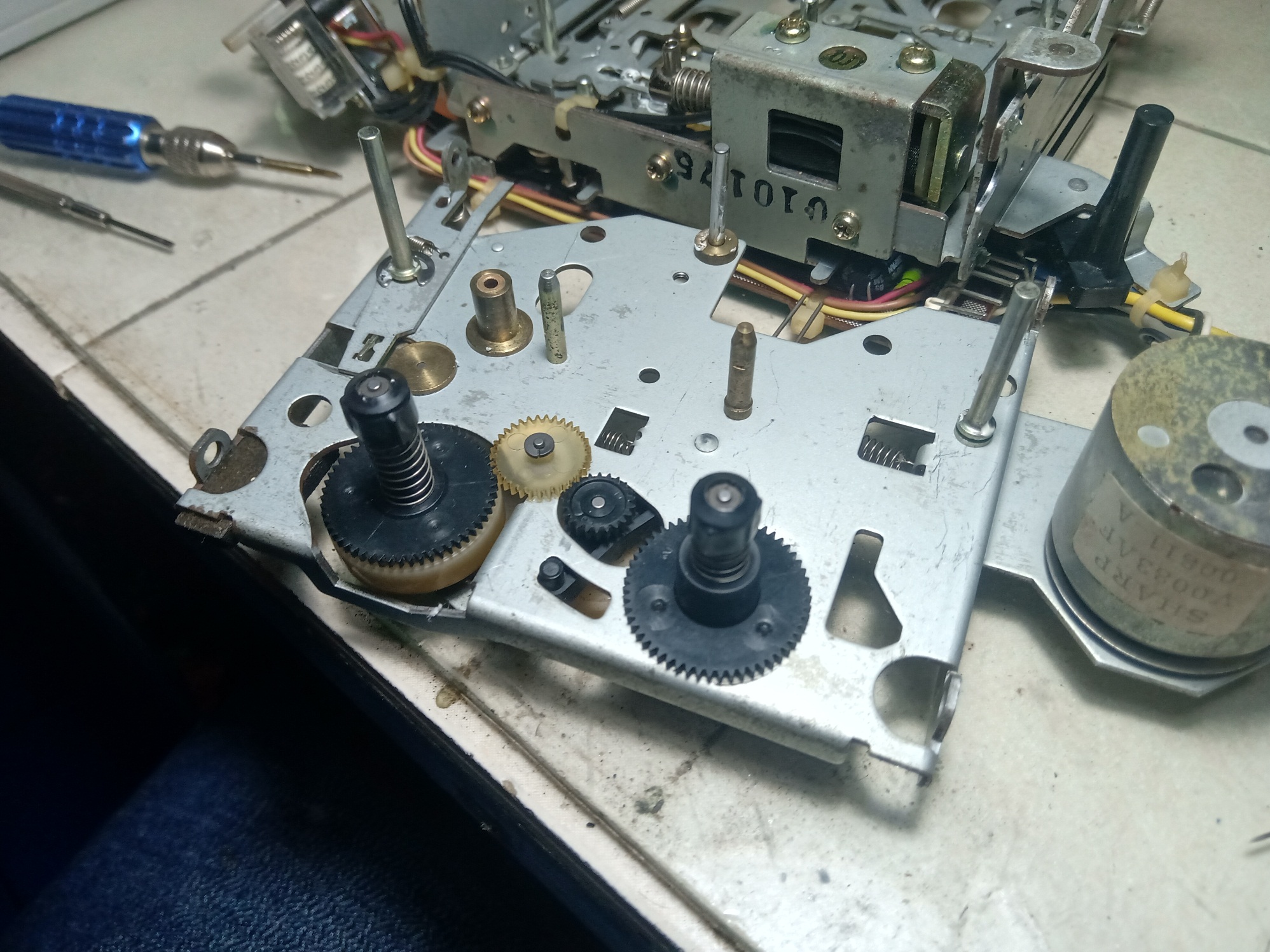

    I was quite surprised at the mechanism, due to the fact that the entire assembly of the capstan, gear and spindles is actually "floating" and swings into place when a cassette is in place. I don't know if this is common with this kind of mechanism where you slide the cassette in, I have only done a few of those, and they all lower the cassette into the spindles instead.

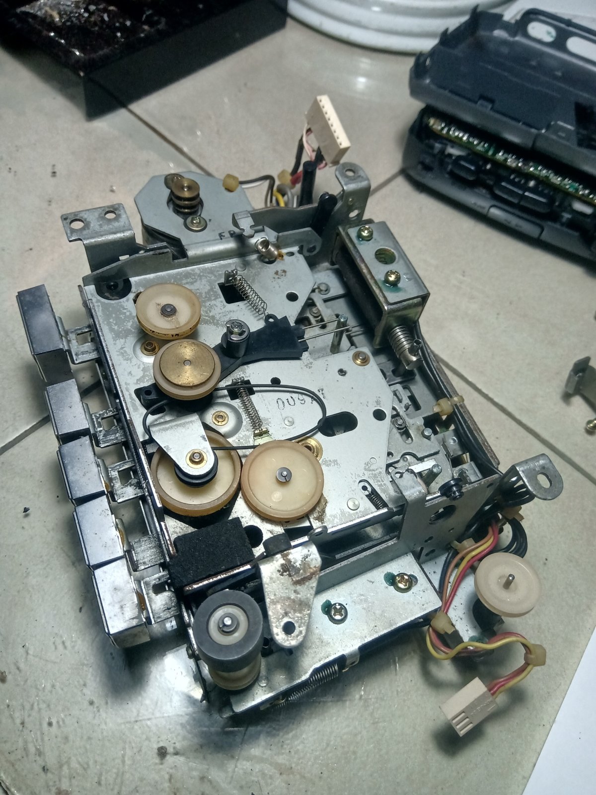

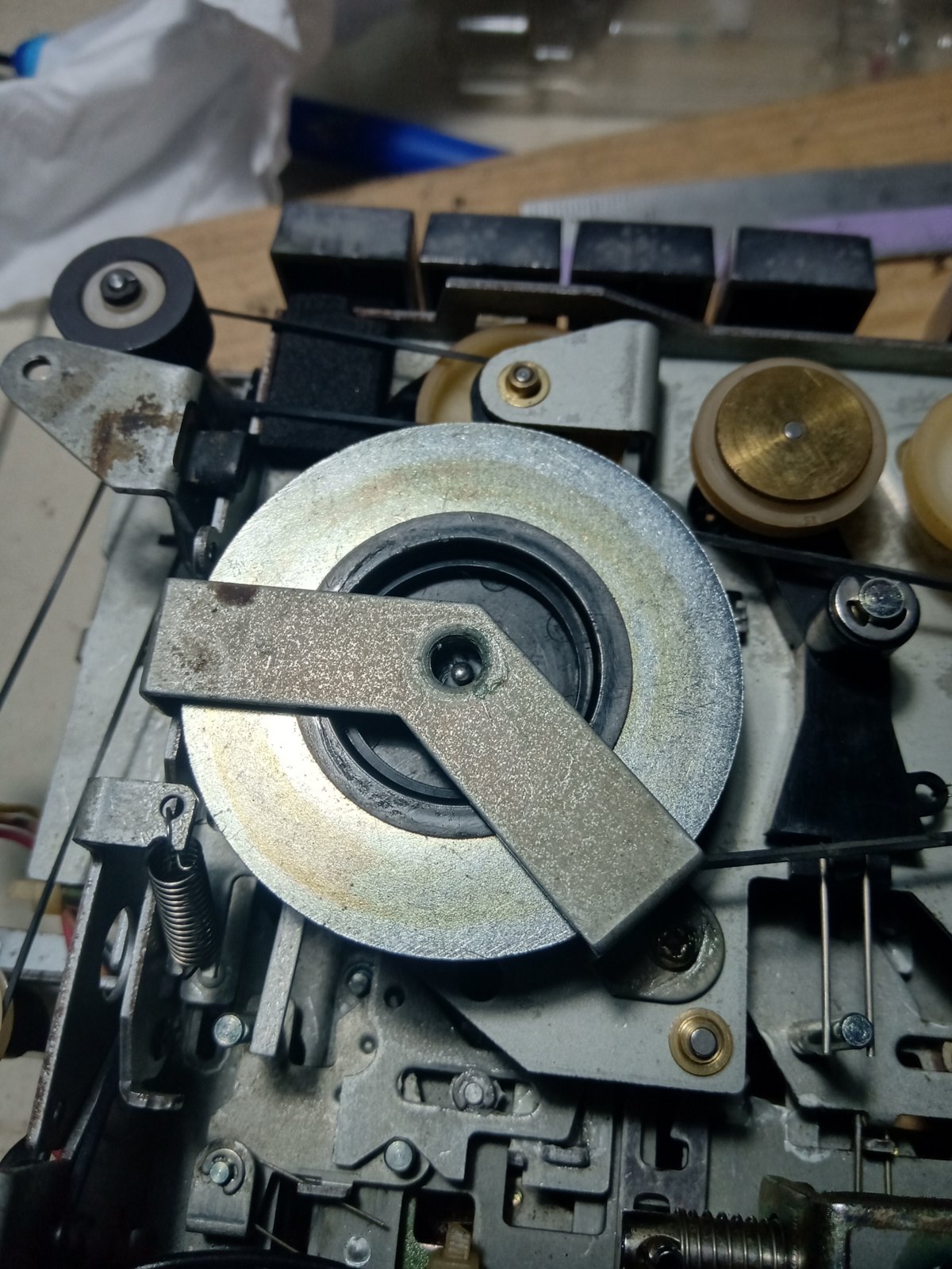

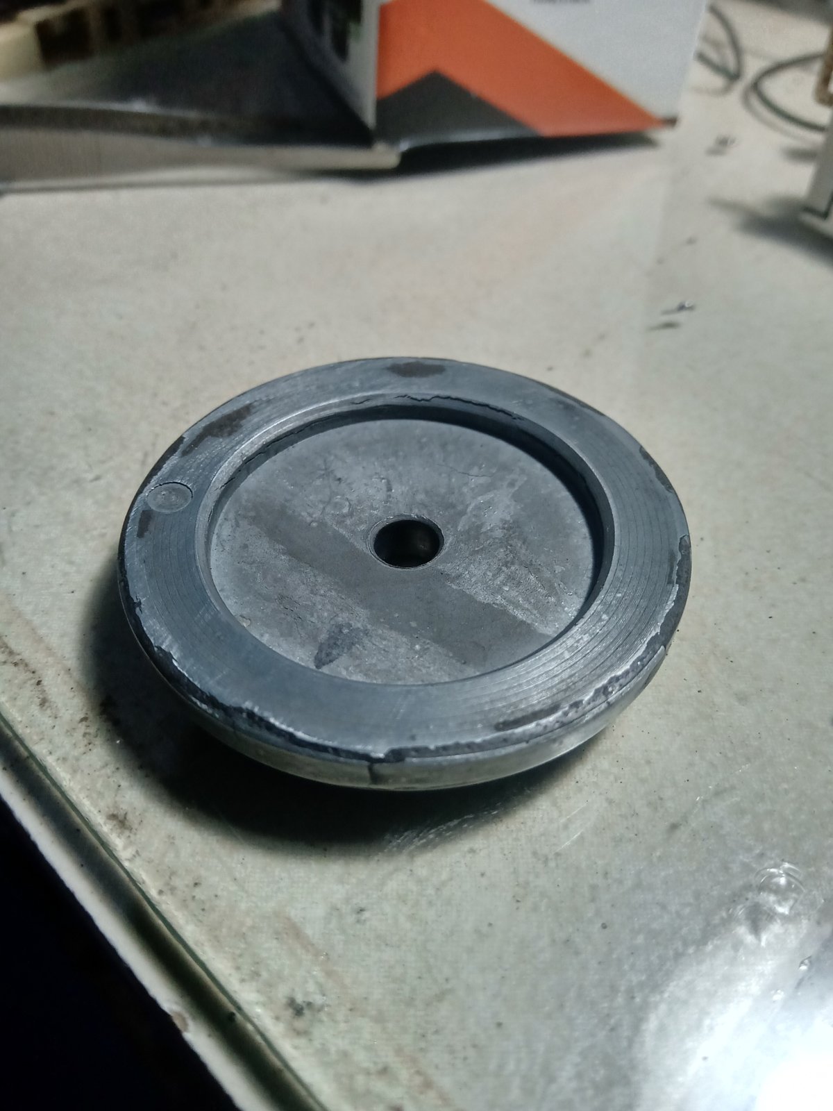

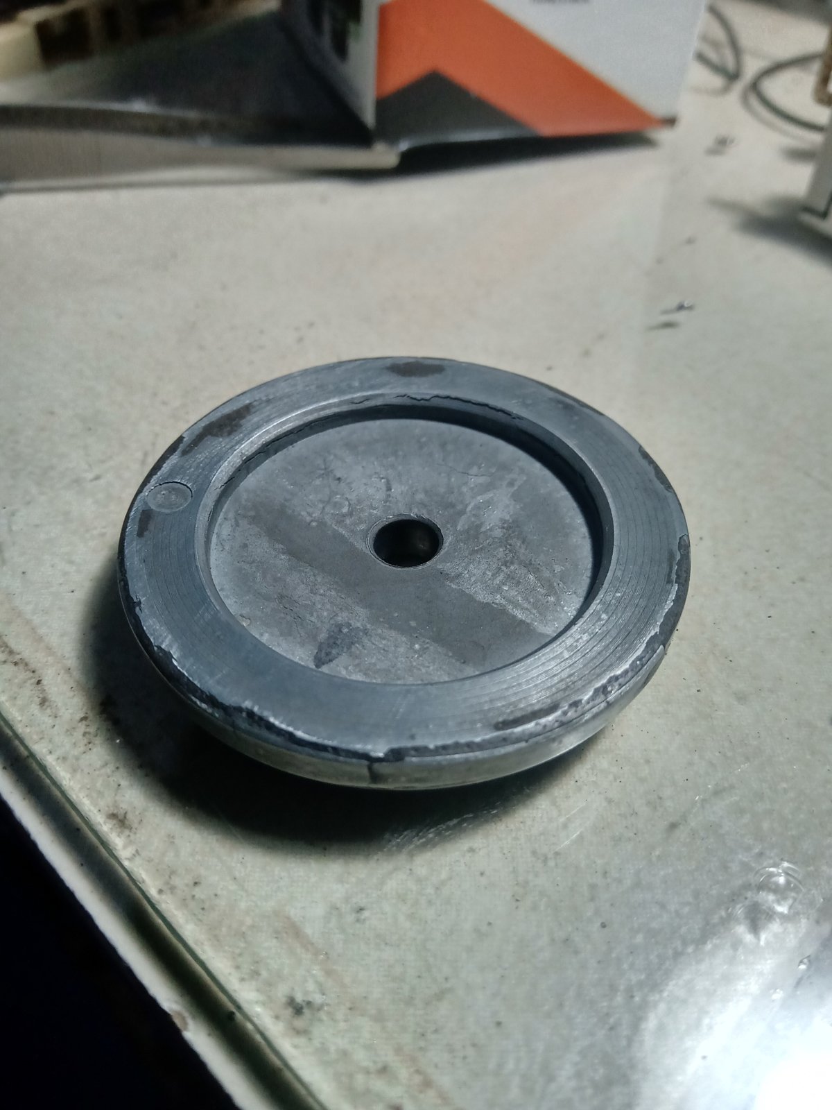

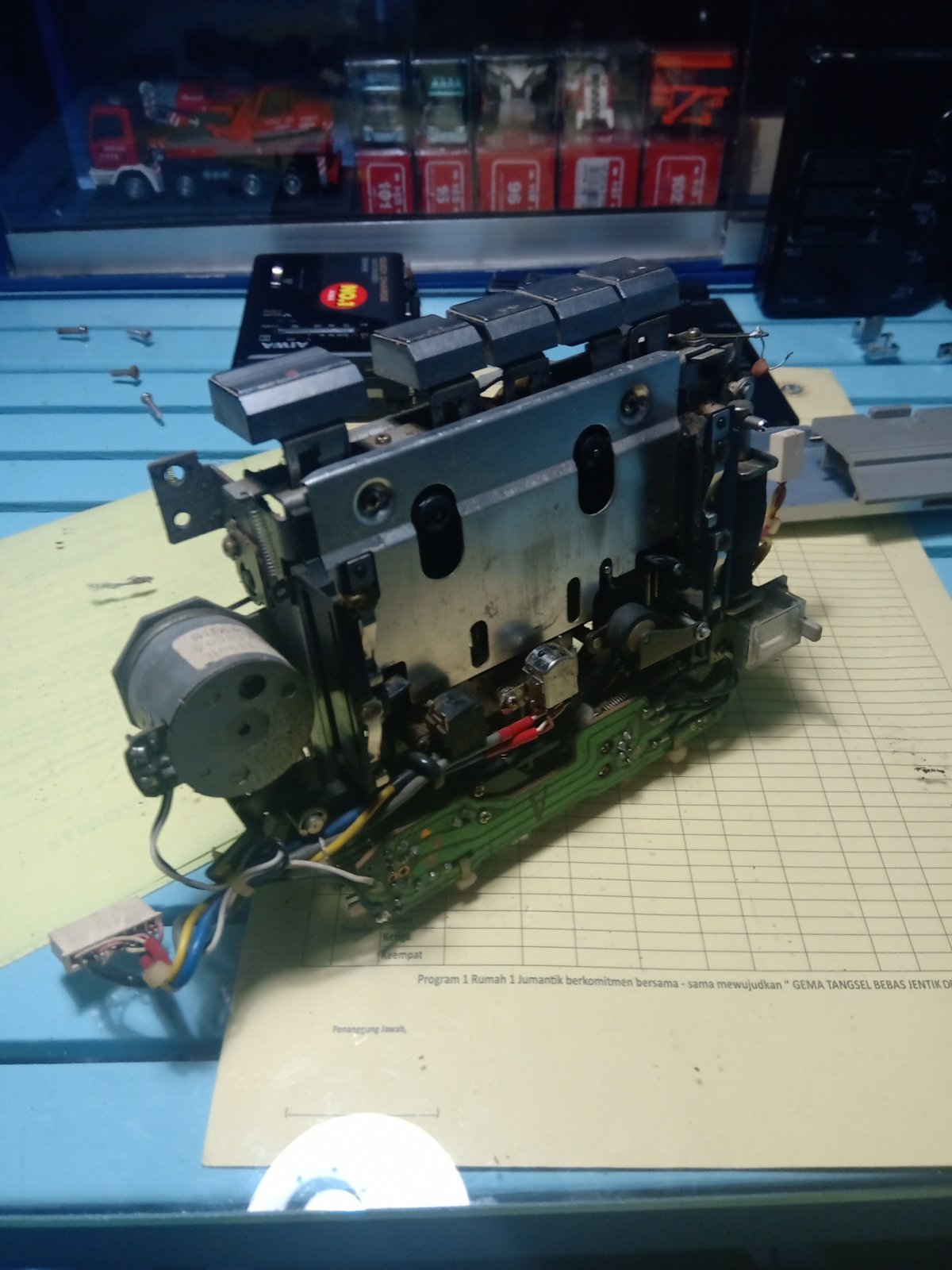

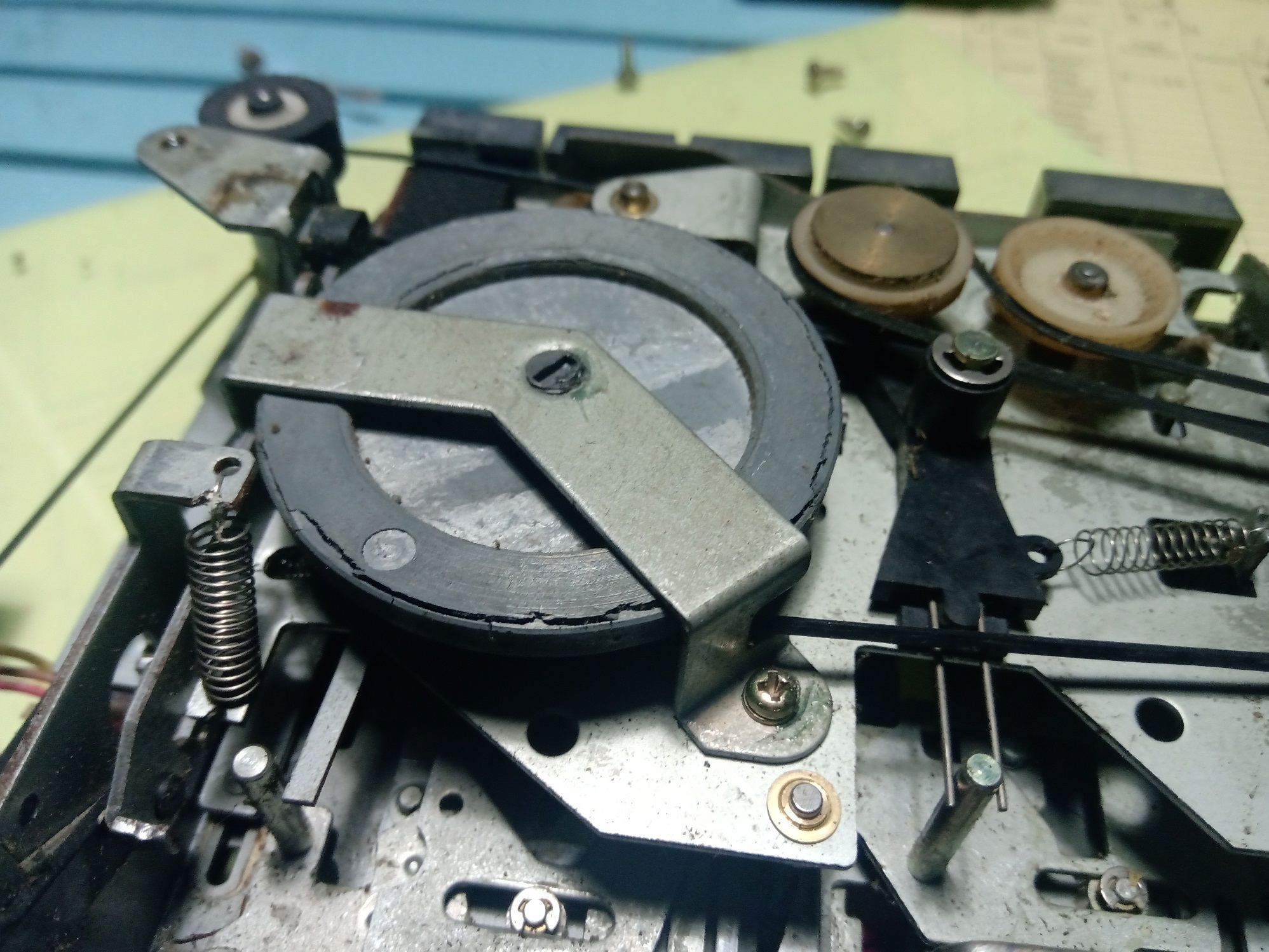

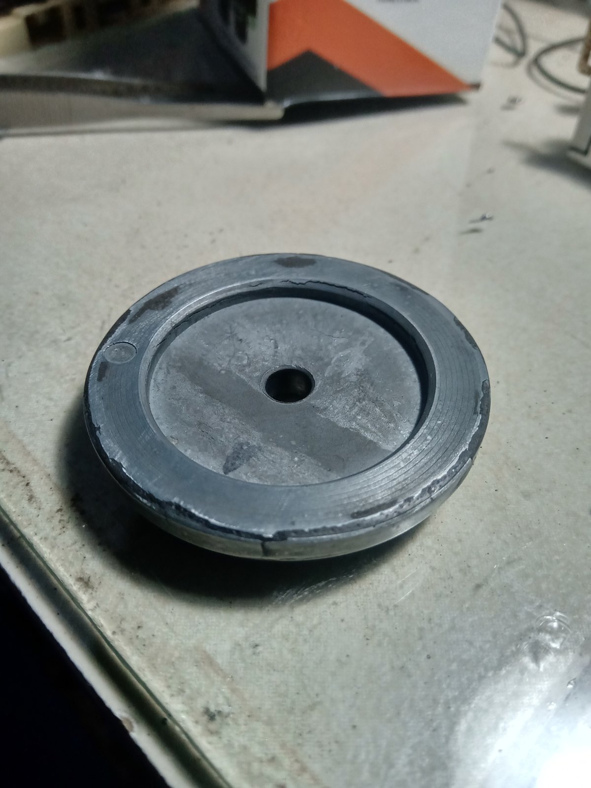

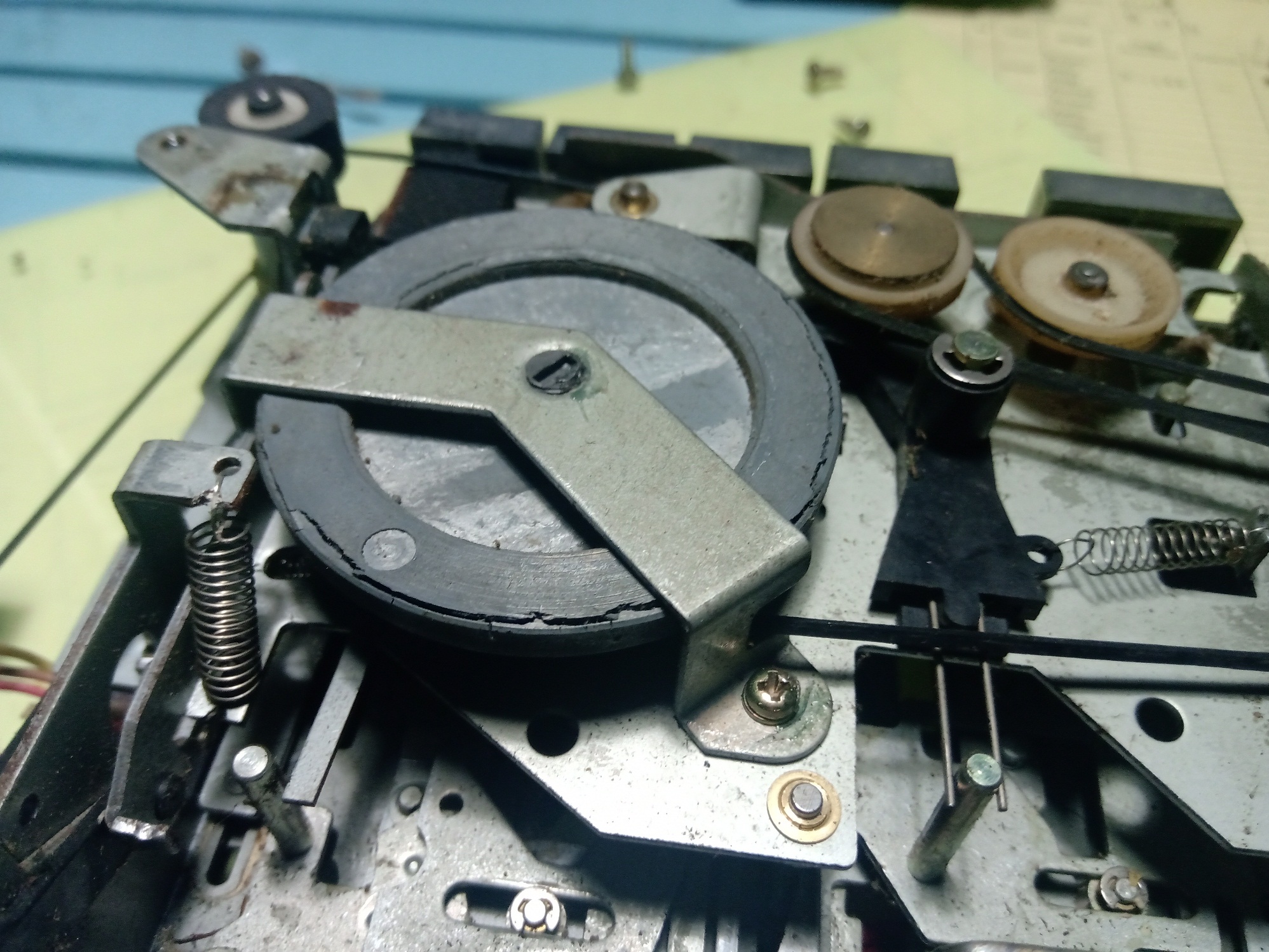

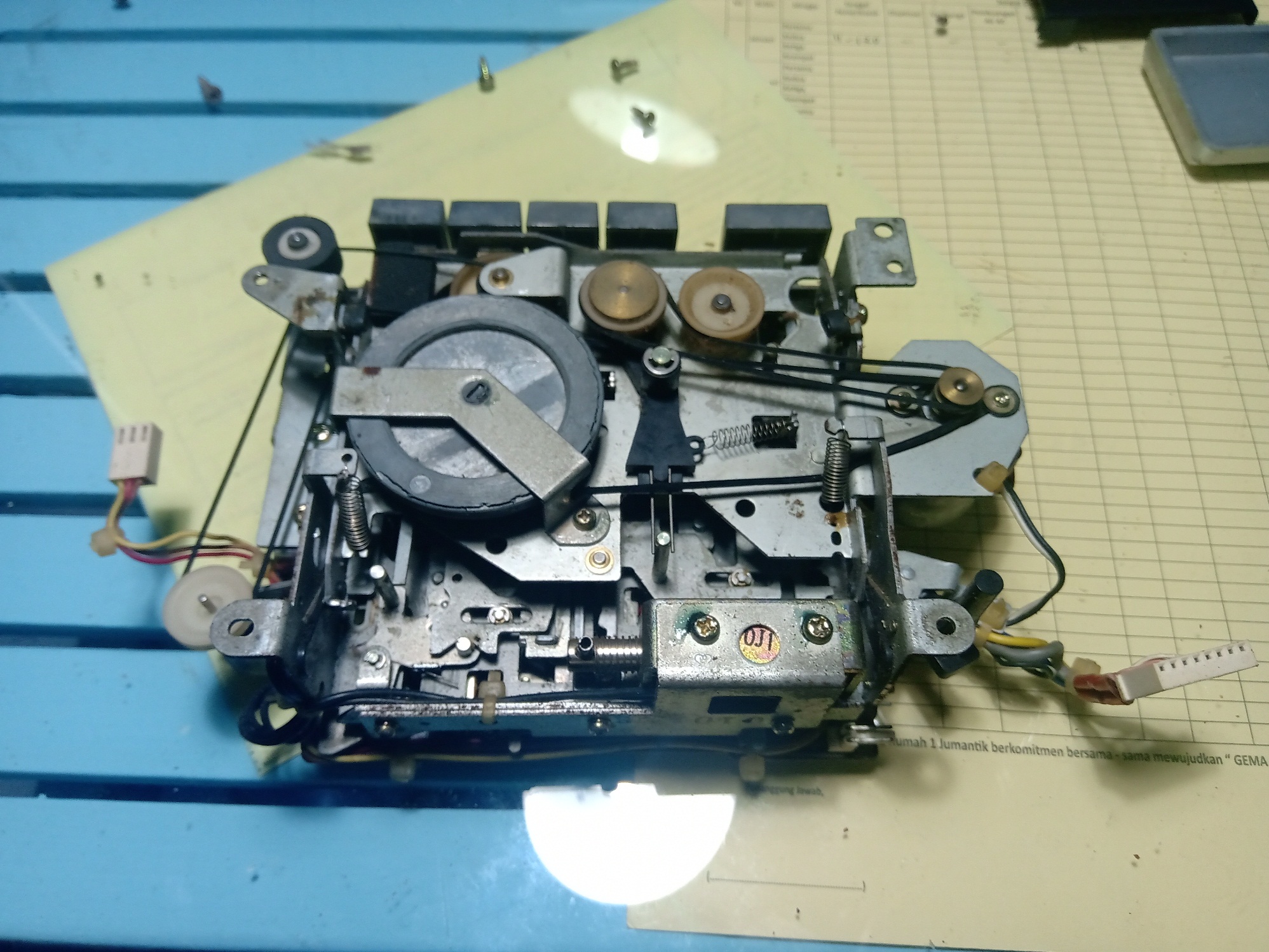

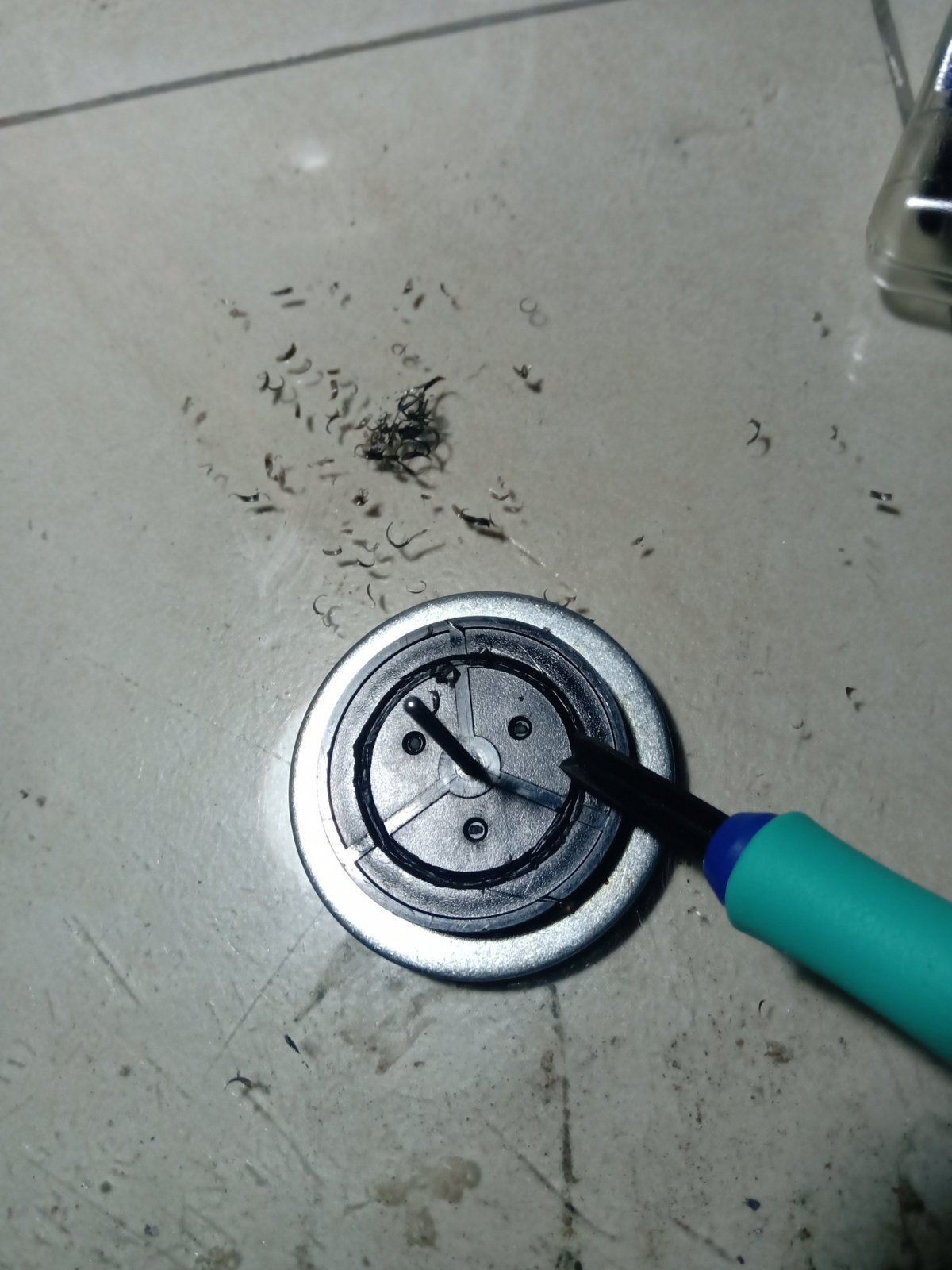

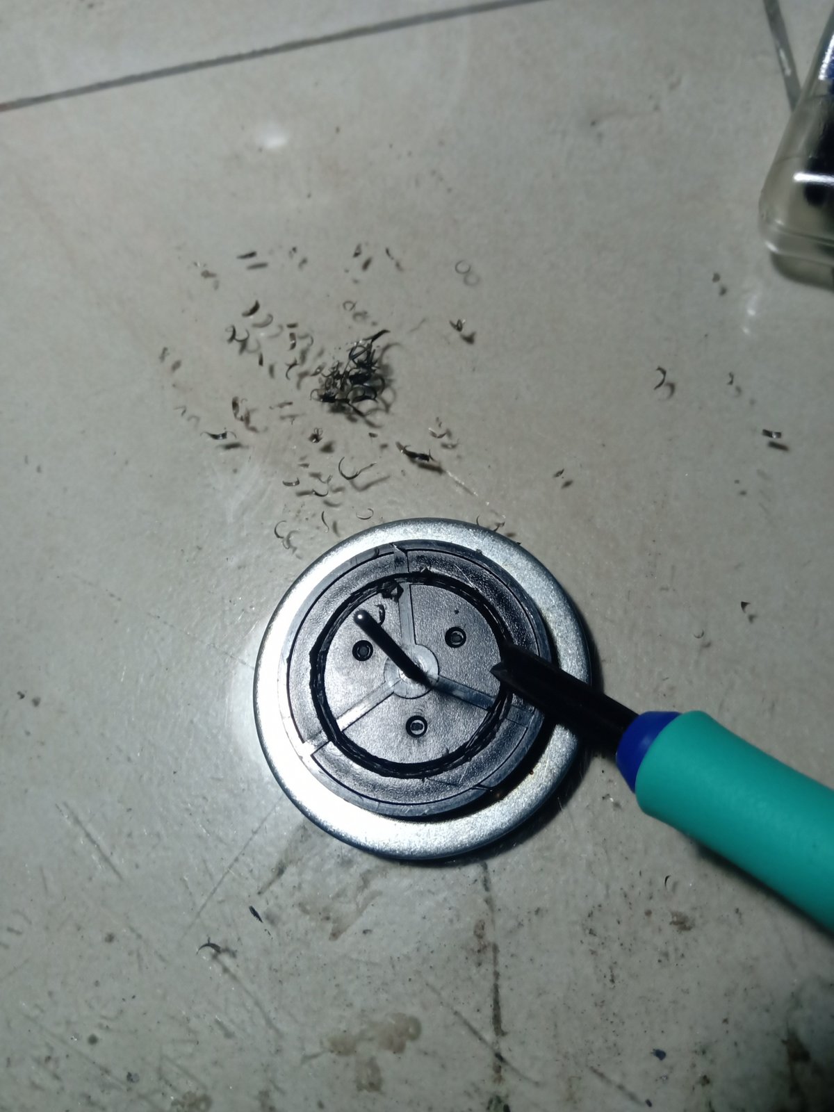

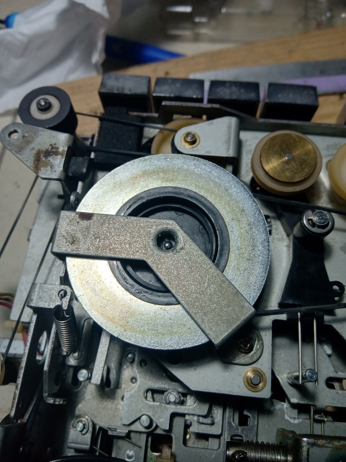

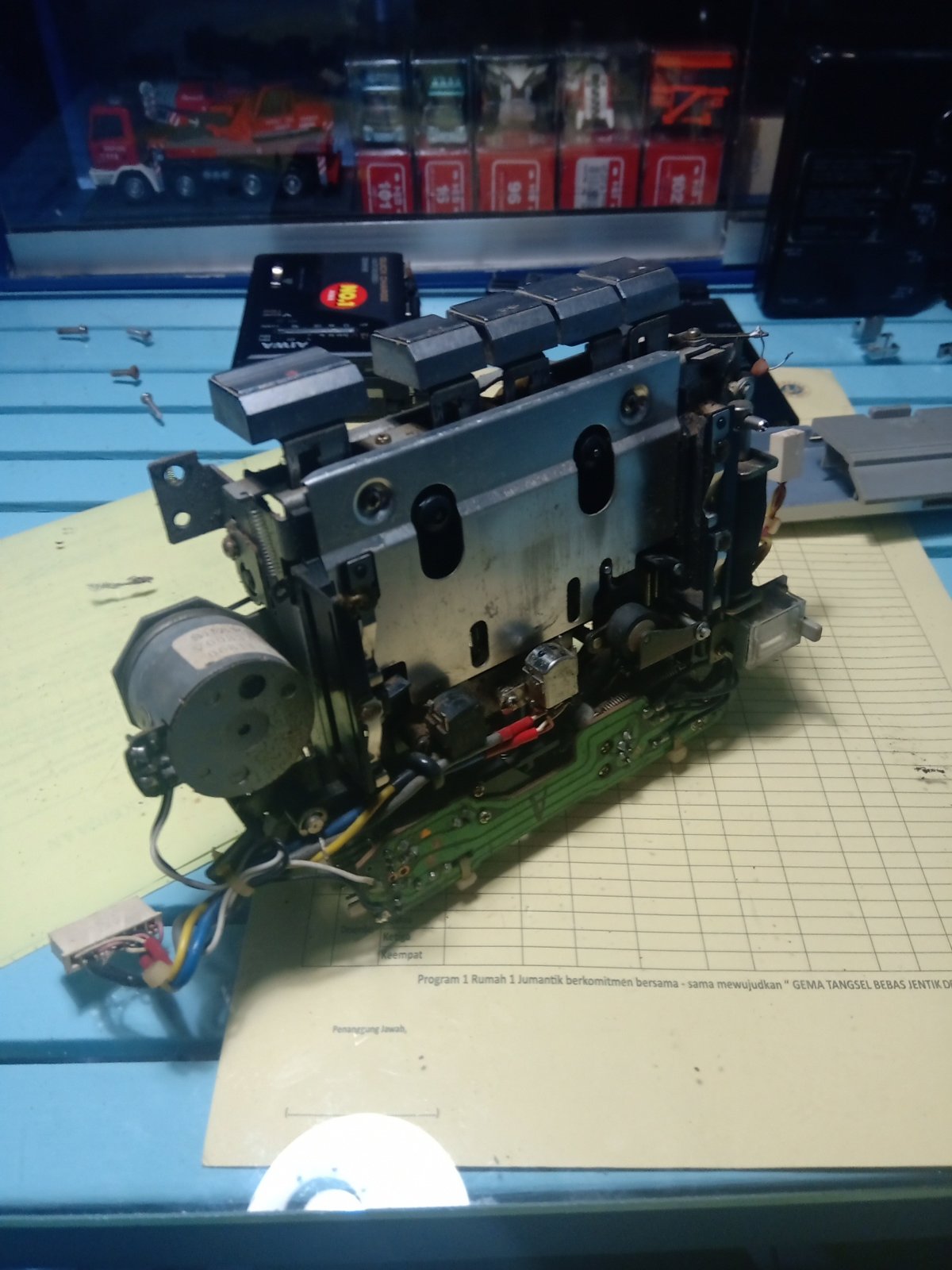

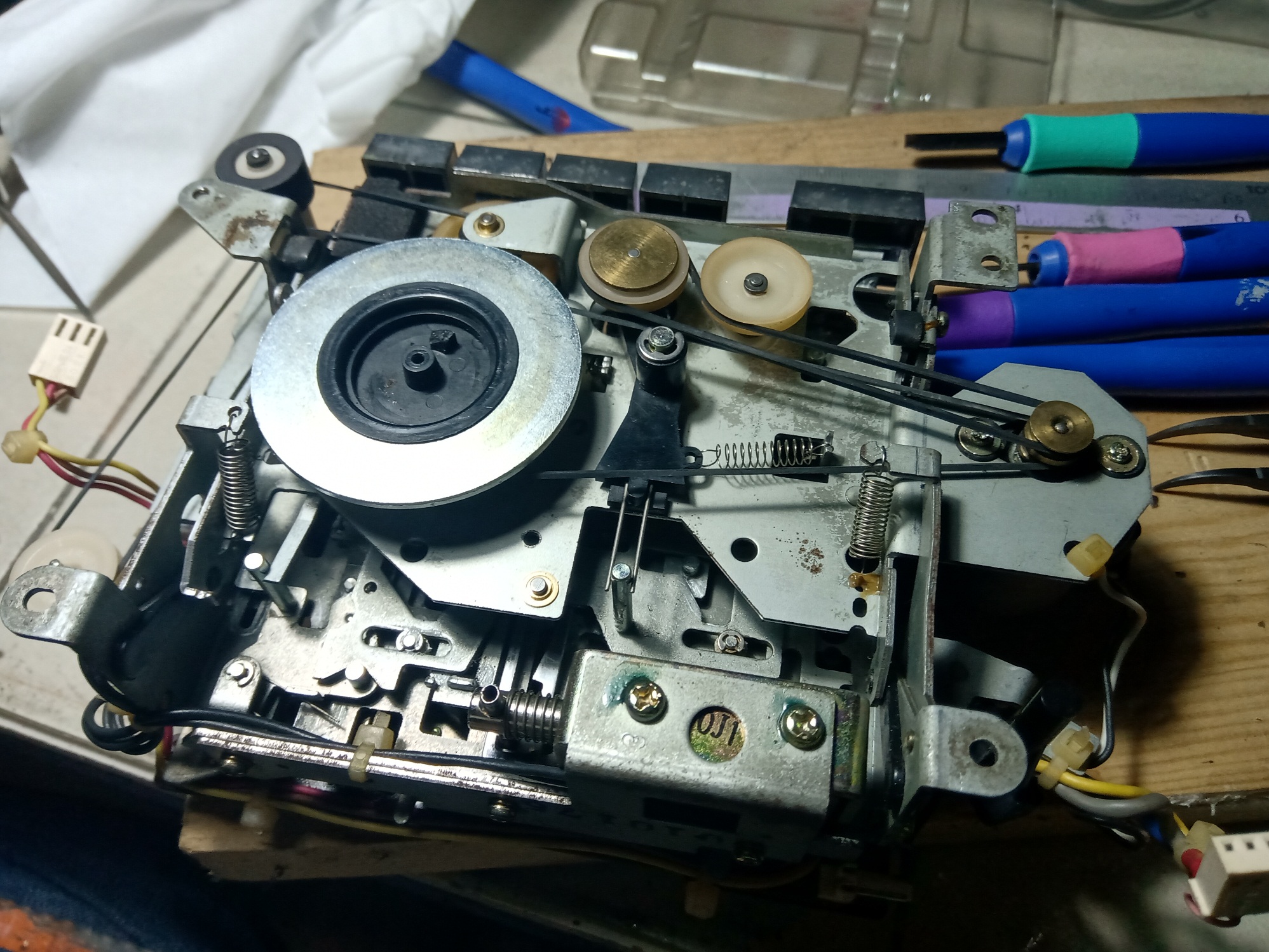

    The mechanism was equally easy to take out. Just need to unscrew 3 screws and release 3 connectors and the entire thing can be lifted out. I turned it around and what I saw really dismayed me. The flywheel was is bad shape. There are plenty of cracks and they almost goes all the way around. Not really something you usually see.
    A quick check, though, shows that it is still turning smoothly. So I surmised that it's probably still acceptable to use. There was no chips as well. So I decided to fill in the cracks. Some sort preventive measures from a catastrophic failure in case the cracks were to grow.
    That was easy enough to do, but apparently the problem was more severe. I refitted the capstan and found a suitable belt and I noticed that it was not turning smoothly. It turned out that the flywheel is warped. Should've checked that from the beginning...
    At this point, I'm almost ready to put this project on the shelf. I've no idea what other unit shares this mechanism, and it almost definitely impossible to find a donor unit. Ordering a machined part would be possible, but that would cost a lot and definitely not a quick process.

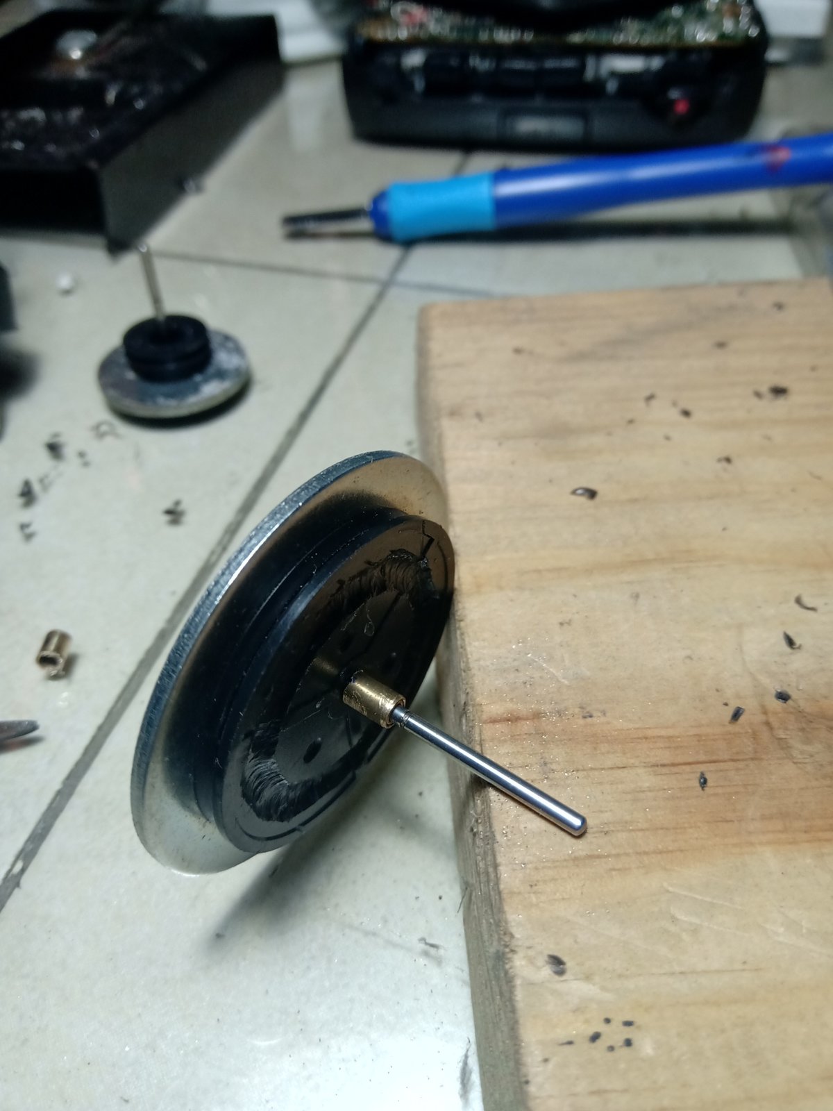

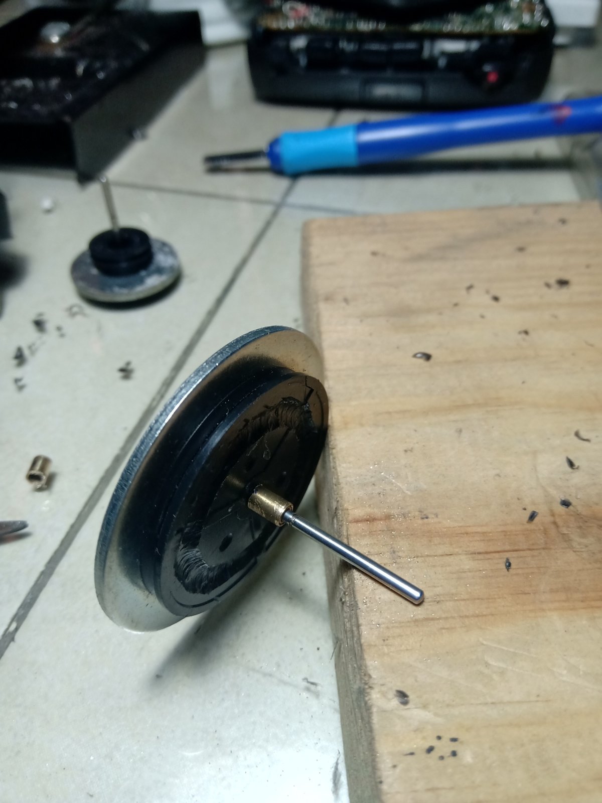

    My only other choice is to scavenge parts from other non-compatible unit. So I went through my pile of dead units and found a cheap Panatel recorder. The diameter was almost right. It was a little larger but I'm guessing it's still within the speed adjustment range. The more pressing problem was the fact that the other that the diameter, the current arrangement would make it unusable.

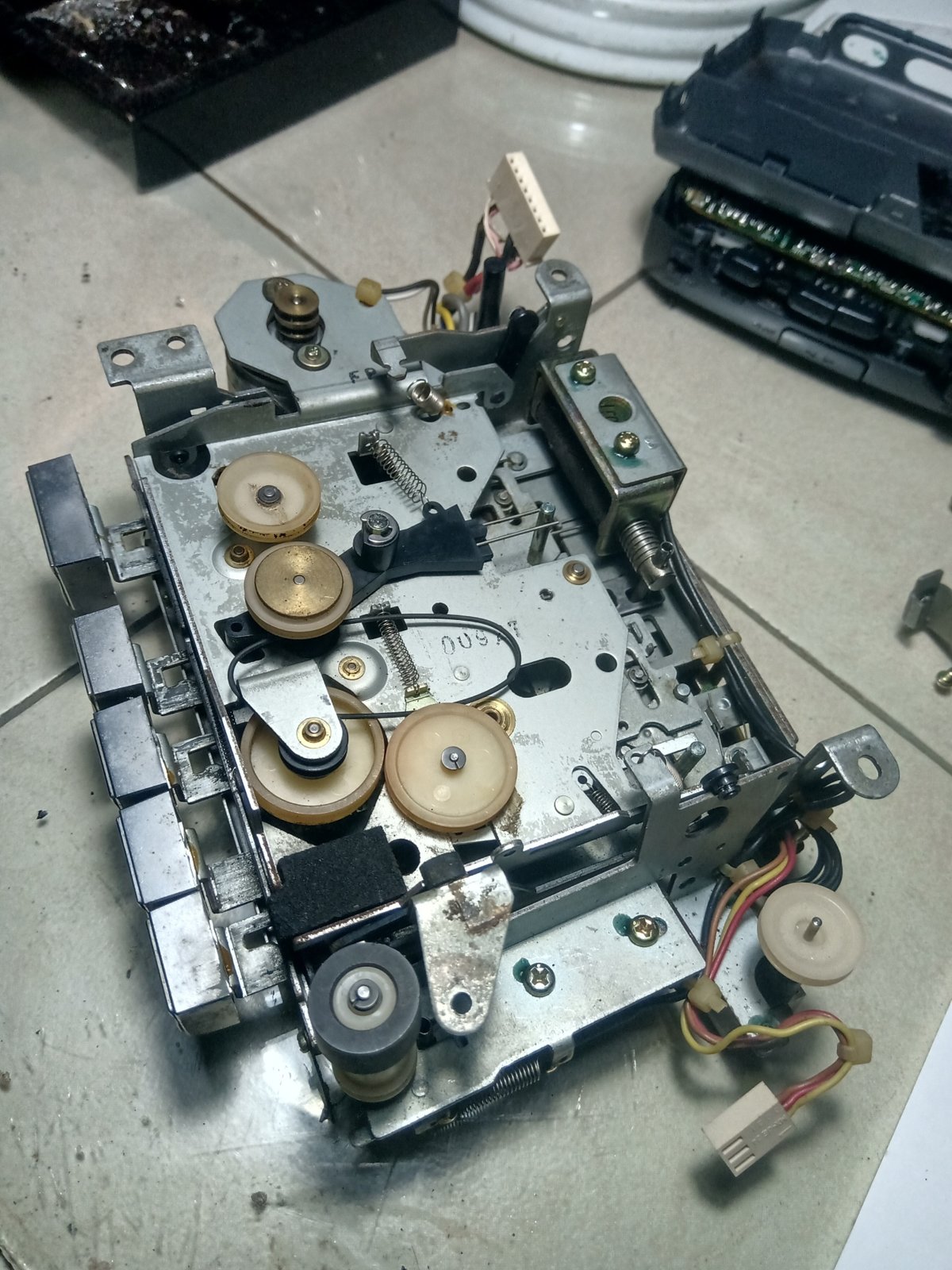

    For the GF-8, I need belt to ride nearer to the base of the capstan, instead of the top of the flywheel. And there needs to be surface of a thicker diameter for a rubber idler to ride on. This will in turn rotate the forward spindle.
    To fit the current capstan flywheel into the GF-8, I basically pulled the capstan so that it now protrudes from the other side. Then I took a capstan bushing from a Sanyo walkman to increase the diameter of the base. I simply cut it to length, then slid it down and glued it. I also need more clearance in the bottom the accomodate the tip of the idler's axle. I managed to get that by cutting a shallow ring in the plastic.

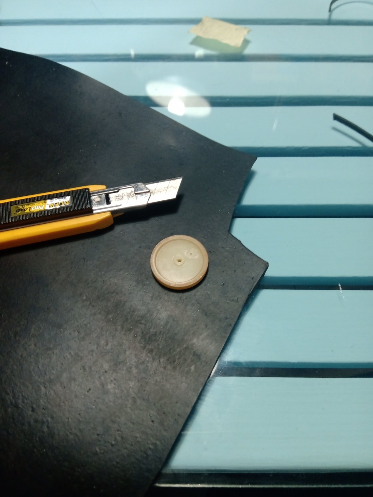

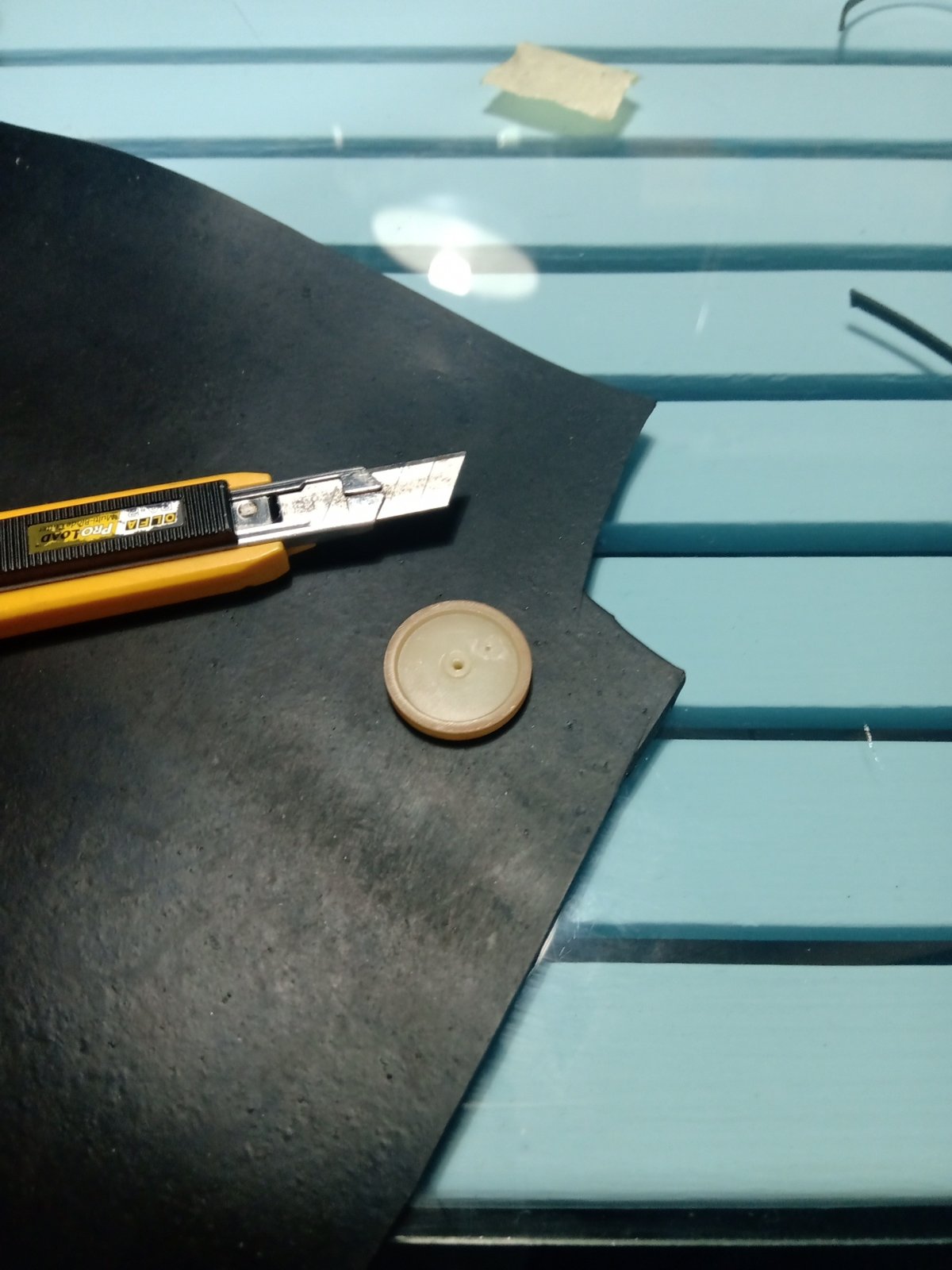

    After that it's basically just some cleaning and fresh rubber all around. I couldn't get an idler of the right size, so I made one from a sheet of neoprene.
    Everything fitted back nicely and it now works like a charm. This new flywheel is definitely not as precisely made as the original and is much lighter as well due to it not being a full-metal construction, but I definitely think it's giving a very satisfying performance.

    How did you make the neoprene round?

    In this case, since this a a grooved spindle idler, I just cut it into a long strip and glued it in place. I can use tools to make rings, but that hassle doesn't seem to be necessary in this case.

    What a clever restoration. It looks as if the original flywheel was suffering from the dreaded "zinc pest". I have seen a model railway locomotive in which the chassis had bent like banana because of it.

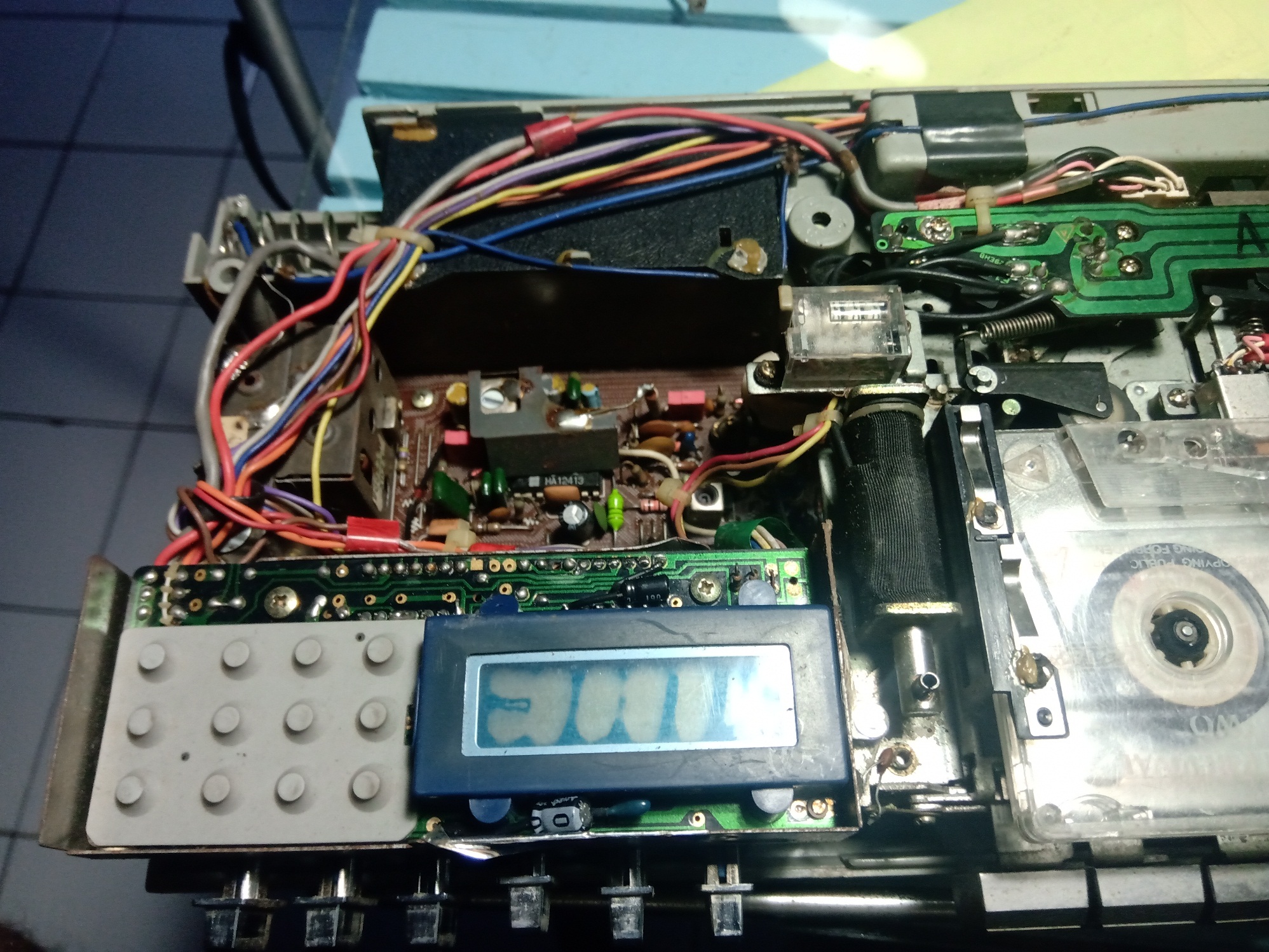

    Oh, Thank you! That's some excellent information, something's that I've been wanting to know too actually. There isn't much info around about this thing. When I got it I definitely didn't expect it to be from as early as 1982. Quite modern stuff with equally modern styling. The original retail price was apparently JPY 58,000.
    The radio was dead in the beginning, and the seller said that it was because it needs those extra AA batteries (the springs for those abtteries are totally corroded) and I though he was just making some random observation. But now it does work with the springs replaced. So it's good to know that that's the expected behaviour :ok
    On thing I found odd is that I don't need to press the power button to play a tape. I just need to put a cassette in, and it immediately plays (with sound as well). I know that this is an auto-play mechanism like a car stereo, but I expected the mechanism to just engage and not turn on with the power button off.

    Great to hear the radio is working. I think the AAs power the microprocessor that controls the radio. While other manufacturers had made radios with a normal tuning knob but a digital display, the digitally controlled presets on the GF8 and a few other Sharp models were new to Boomboxes.

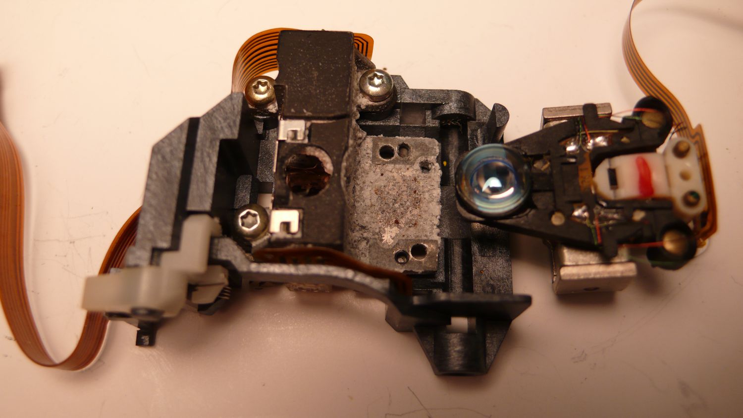

    I found my photos of Philips RCD2 laser mechanism!
    With lens moved out of the way:
    further disassembled to reveal the prism smothered by crystallized metal oxides:
    I bought five or six Philips Discmans with the same mechanism, they All had been killed by Zink Pest!!! I mailed the whole bunch to kaosuncd.com, and with his magic touch he fixed two RCD2 lasers for me
