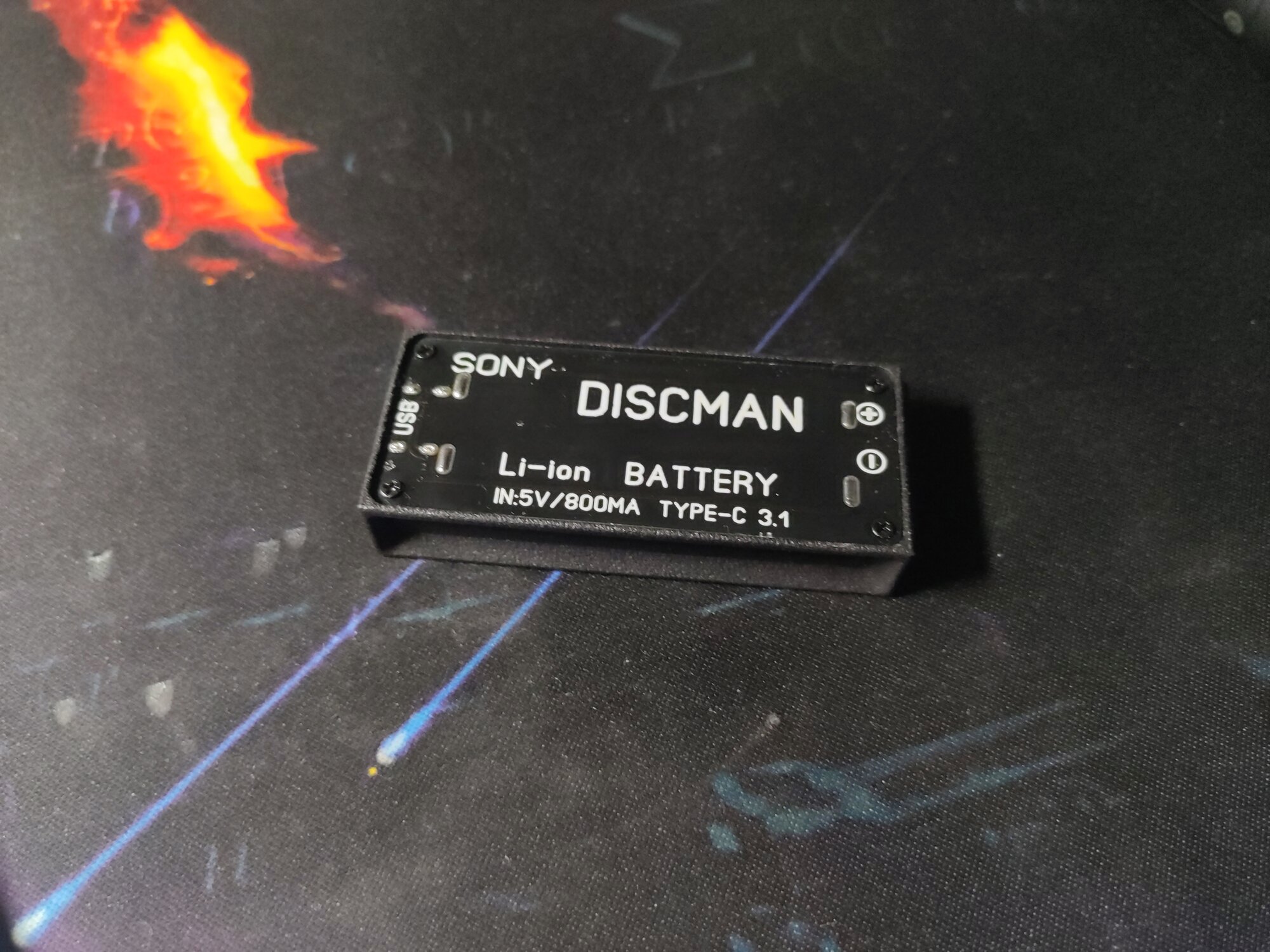

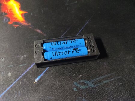

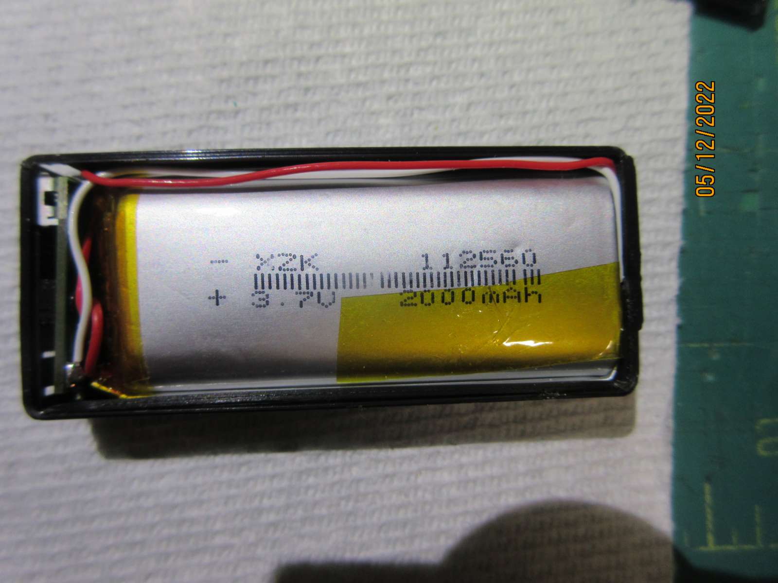

    Created this thread as I wanted to know opinions about new replacements of the BP-2EX battery which was used in a lot of SONY Discmans.
    Some time ago I purchased one based on 2 x 10440 lithium cells, which I was quite disappointed of.
    However, measurements done when powering a D-250 unit with my bench power supply revealed the fact this device can't operate at a voltage below 3.7-3.8V.
    Given the empty voltage of the 10440 cells is 2.75V, I realised a majority of the cells' capacity is actually not used in this battery pack.
    As-is, a full charge can provide playback for 1.5-2 CDs, which isn't that good at all.
    Recently I saw @Hyperscope was using a different kind of battery (the one in picture attached) and wondered if this one is better than what I have. Hence why I created this thread.
    Anyone else having information about similar batteries that the 2 mentioned is invited to the discussion.

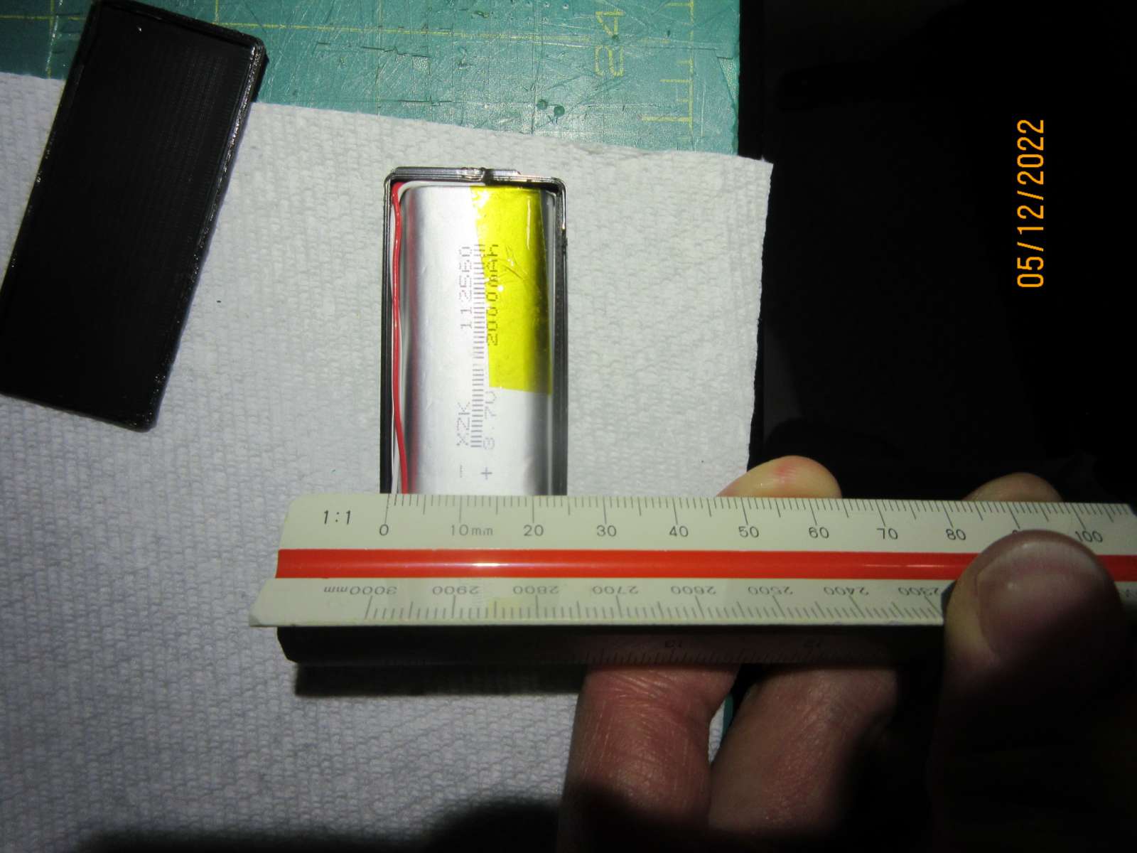

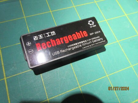

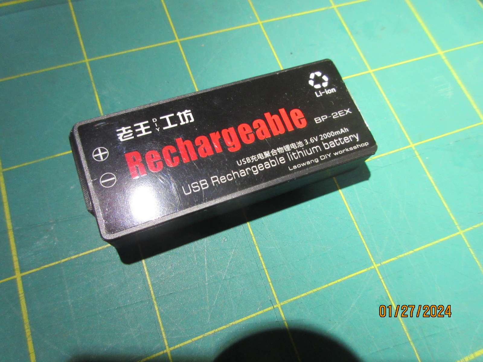

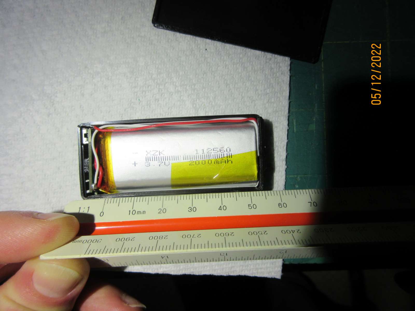

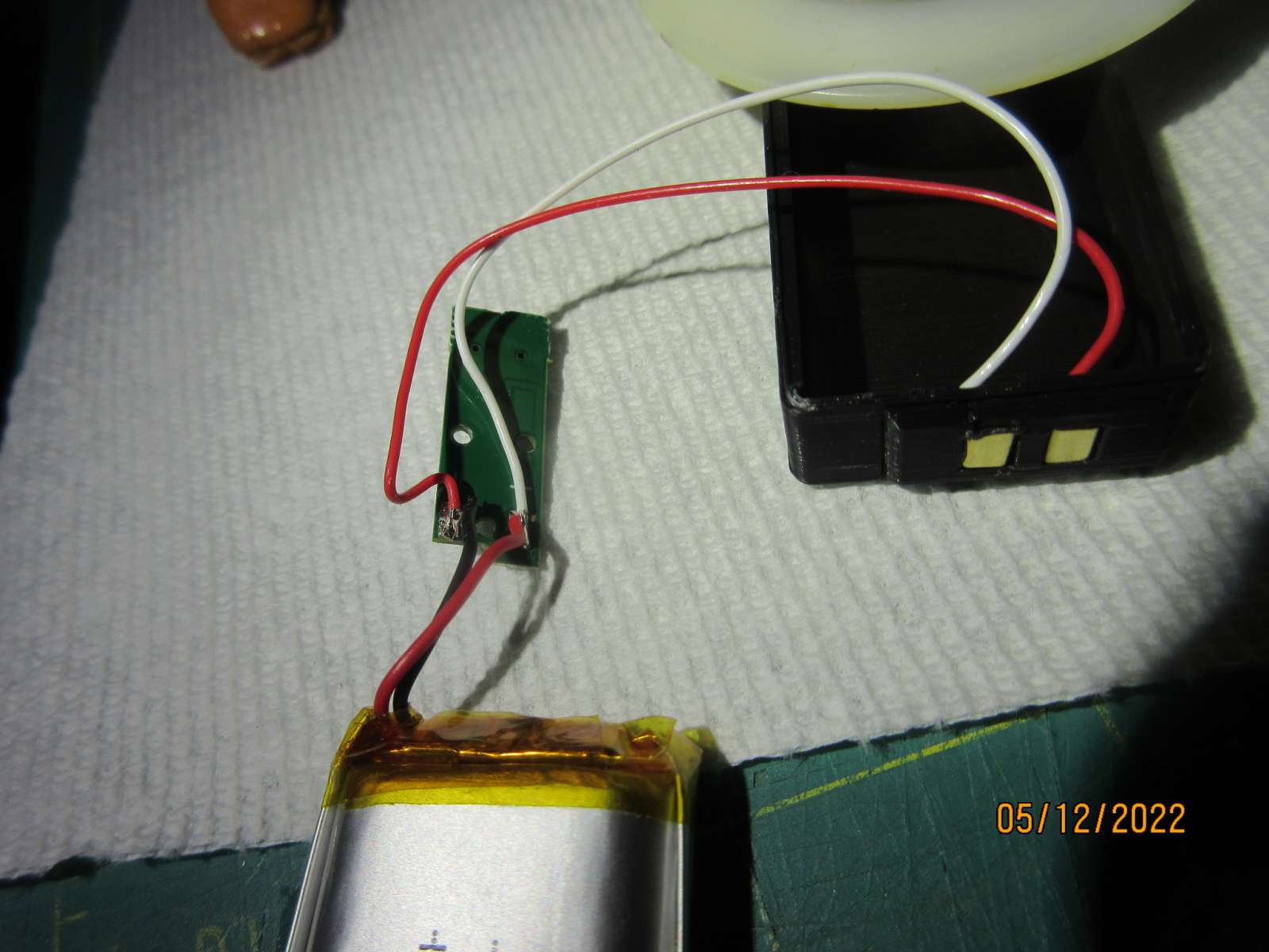

    Yes the e-bay seller is called wickedkraft and is located in Singapore. (They also have a BP-5 battery for the D-35 /D-350 and D-311 which requires a charger since no room for internal USB charge circuits. I was going to get this battery too but never did. I suggest you buy one since there is one up there now! ) I came across the BP-2EX battery and bookmarked the seller. Months later, when I went to buy one, they were all gone. So I had to message them and ask for a BP-2EX, he made one, listed it and I bought it.
    I would rate the BP-2EX they make as "fantastic". Very nice label too. It is a 3D printed plastic box with glued on flat lid containing a 2000mah lithium battery pack with a standard USB charging circuit in the end of the box. I opened it right away to check :biggrin:. Have not timed it or measured how long it lasts exactly in the D-555... but would say 3+ hours. I have pictures of the battery used inside if you want.

    Several years ago I came across this video which was the first time I had seen or heard of new battery possibilities: Sony Discman DIY 3D Printed Replacement Lipo Battery.
    I believe all these DIY type BP-2EX will all suffer from the same problem alluded to in the first post, that is, much of the cells capacity will not be utilized before the Discman cuts off due to low voltage. Will require a different charge / drive circuit with voltage regulation in the battery. Or, in the case of the wickedkraft BP-2EX, just enough capacity to make for a "good enough" run time in most Discman players.

    Attached pictures with the battery I have now, which I'm quite disappointed of.
    In regard to pictures of the internals of this BP-2EX made by wickedkraft, I do want to see. Curious if there is any space left to modify it.

  5. Hyperscope

    Did a battery run time test with the D-555 doing intermittent listening over a 6 day period. Using the above e-bay BP-2EX battery I noted the following:
    minutes of play until the first battery indicator segment went out.
    An additional 31 minutes for the second battery indicator segment to go out.
    Then 36 minutes further play time before the third battery indicator segment went out.
    Then 179 minutes before the final fourth battery indicator segment went out.
    At this point the battery indicator was empty and started flashing.
    6
    more minutes until stop.
    So 280 minutes playtime on the D-555 using this battery. Intermittent use over 6 days to "simulate" realistic use.
    4 hours and 40 minutes available. Pack measured 3.56v at failure.

    Want to add some feedback in regard to the battery in original post.
    In the meantime got one and tested it: compared with the 2 x 10440 cell one I used before, the difference in autonomy is significant.
