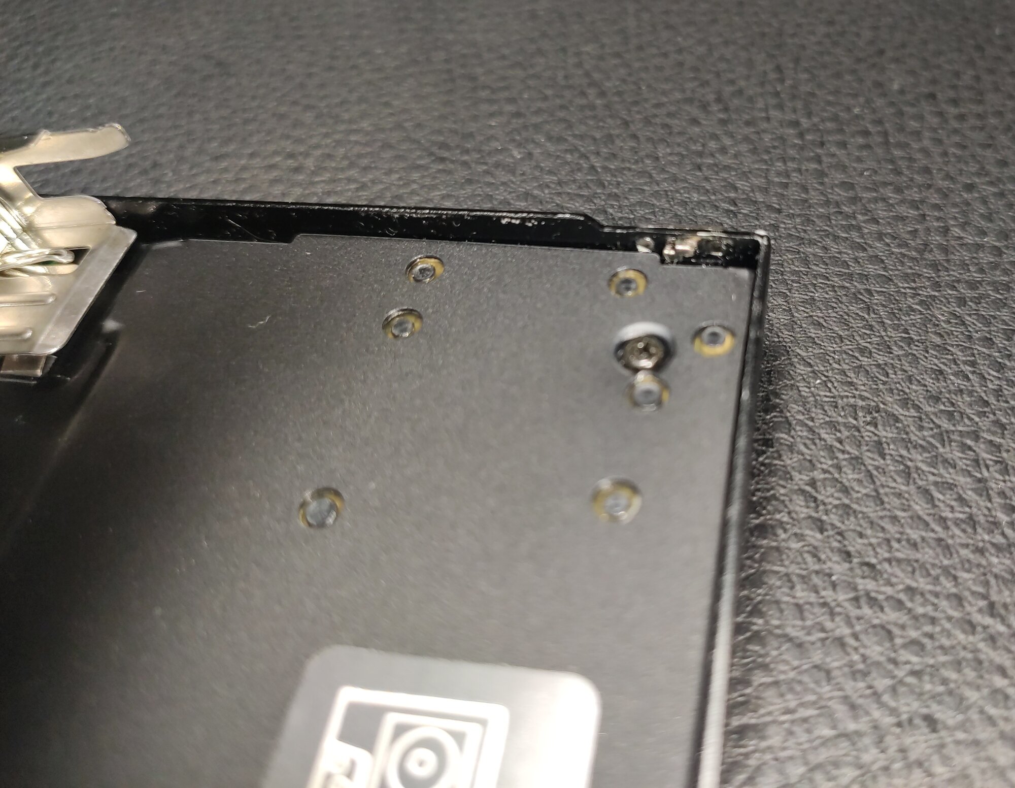

    I have a current issue on my WM-F102 walkman. All works well apart from the face doesnt close properly. It's missing the lock bit. The piece doesnt appear to be in the service manual. This is the screenshot from it.
    You can see in the attached screenshot the part is missing. CAN ANYONE HELP?

    The latch part is not listed in the service manual because it's part of the door (no.14 on the diagram) and was sold only as an assembly.
    Notice in the attached picture that part is stamped on the door, so it's not actually a part that can be replaced, you need to replace the whole door.
    My recommendation is to get a cheap donor unit and repalce the entire door given it's dented anyway.
