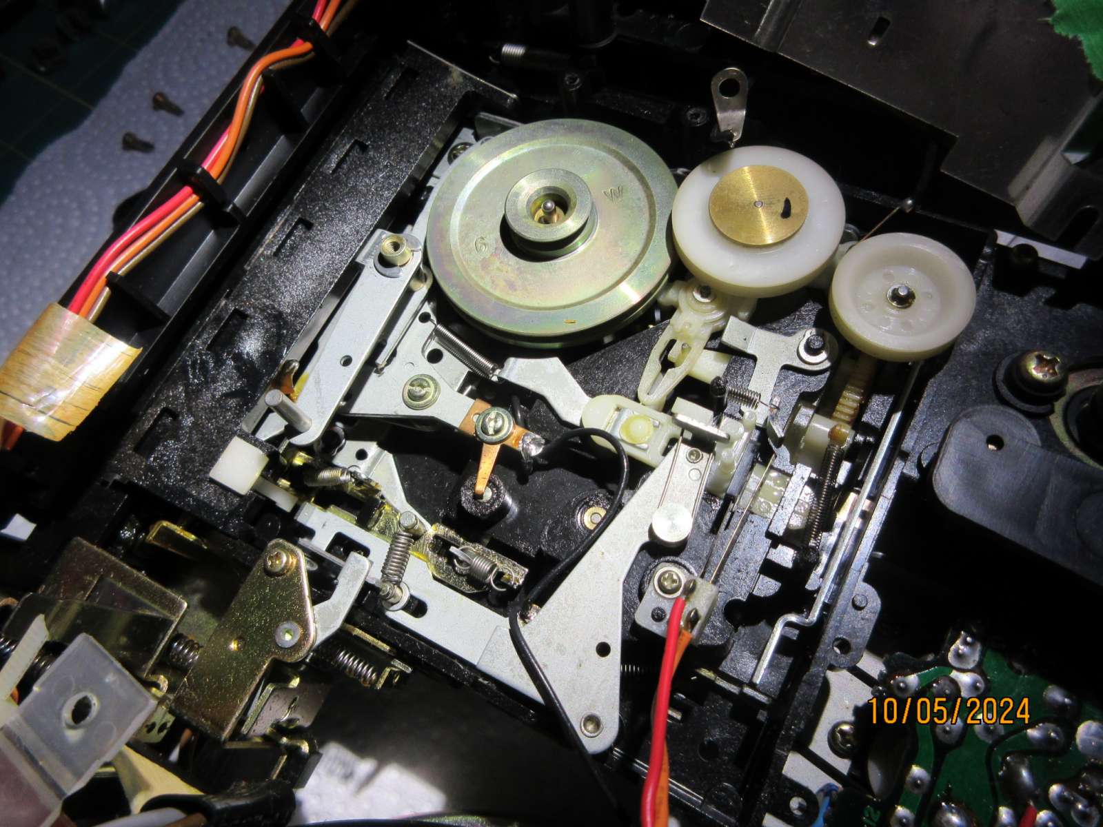

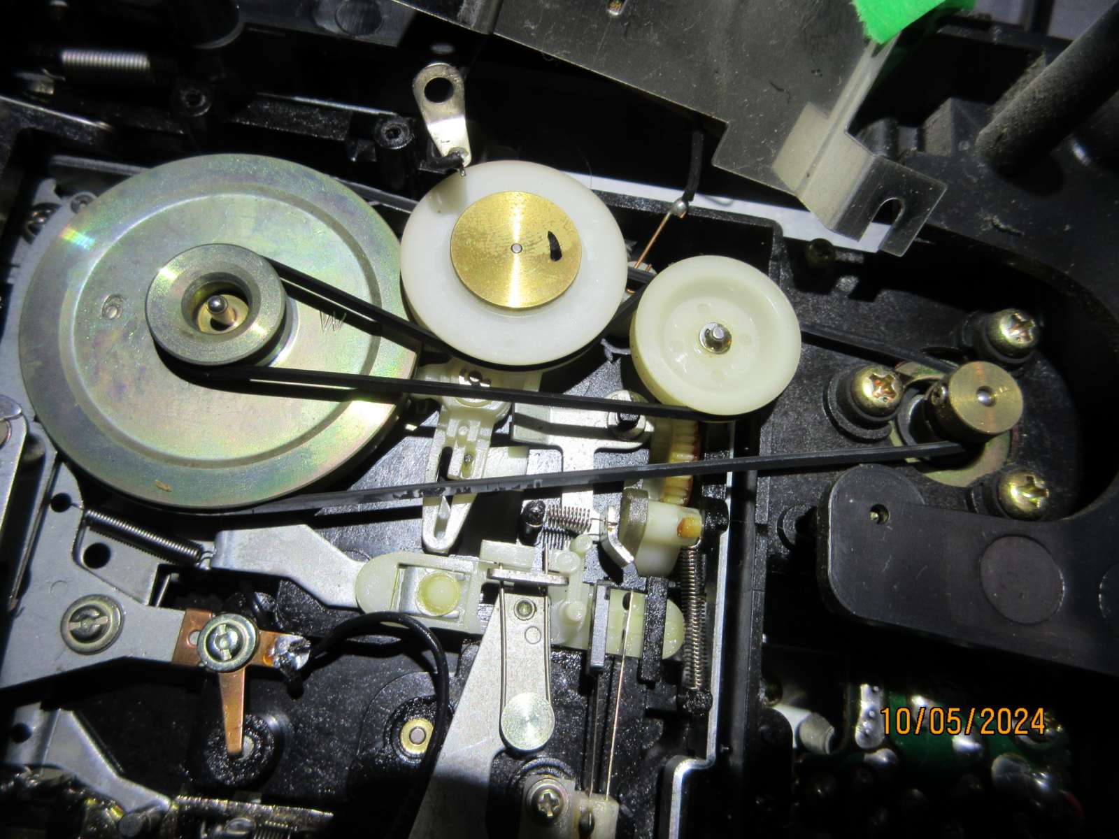

    Uses two belts in the Cassette plus one for the counter. The belts are from Turntableneedles.
    Square Belt, Small 10.0 Inch 1.2mm x 1.2mm
    Square Belt, Small 5.3 Inch 1.2mm x 1.2mm
    Square Belt, Orbicular 6.0 Inch <--- for counter belt 1mm x 1mm (smaller square)
    As it came from e-bay the AM radio worked briefly before fading away. FM was fine.
    Cassette turned but weak. No wonder. The old belts, 48 years and 7 months old, were dry and stretched. And the pulleys were filthy with rubber residue. It took about 25 cotton swabs and 70% alcohol to clean them fully. And many small 70% alcohol wipes pressed with a plastic "blade" into the V groove of the pulleys. Oiled all I could with 100% synthetic "liquid bearings". Radio faded away from aged electrolytic capacitors. This was solved by a general replacement with Nichicon FG and FW. (Yes I know it is not necessary to replace all with audio grade, just that, being a fool, I simplify by ordering all the same type capacitor.)
    Cassette mechanism old grease was a combination of grey grease, still soft and without evidence of hardening, plus some orange hard glue grease on the mechanical cassette buttons. And even that orange grease was soft and not really a problem. I did not have to loosen or dissolve any grease. Just a re-oil on some points to rejuvenate.
    The 3 idler tires were in extremely good condition. Smooth hard black rubber without powder residue or cracking. They wiped up great with 70% alcohol. Did not use Rubber Renue. Maybe should have?
    The pinch roller cleaned up superbly too. I would say this cassette mechanism had under 100 hours on it?

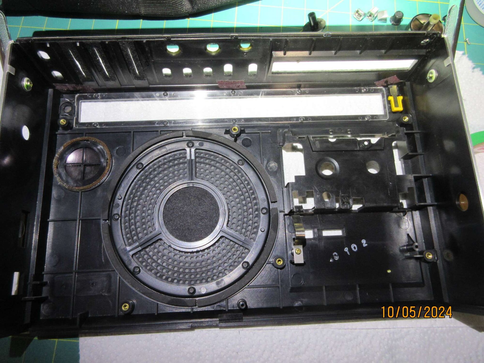

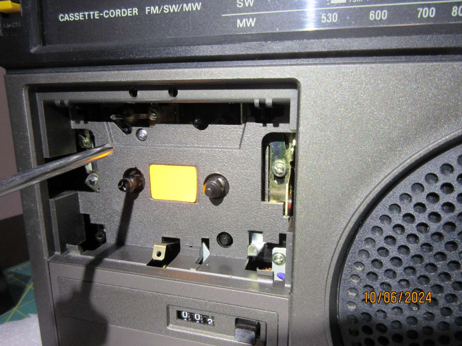

    Brass inserts for the 6 long screws that hold the back cover in place.
    Ugh, one of these styles, have to remove cassette door and take out
    this single screw before you can pull out the chassis from the front
    "shell" housing. To remove cassette door one has to carefully pinch in
    the two side plastic clips on the moving door part. Tricky as they could
    snap off at any moment. Idiotic design. Why is that single screw needed?
    I assume it is to align the inner chassis with the front "shell"?
    It's all plastic so no about grounding.
    Belt path. uses a 10.0 inch main belt that is 1.2mm x 1.2mm.
    And the smaller secondary belt is 5.3 inches and 1.2mm x 1.2mm.
    From Turntableneedles.
    Took about 25 cotton swabs to clean the pulleys and motor brass of
    old rubber residue and dirt.
    Conveniently opens on plastic hinges for easy belt access and replacement!
    (Except for replacing the counter belt - that needs to full access which
    means removal of internal chassis from front shell. Easy. No screws.
    Just lift out carefully after removing slider knobs and tuning knob.

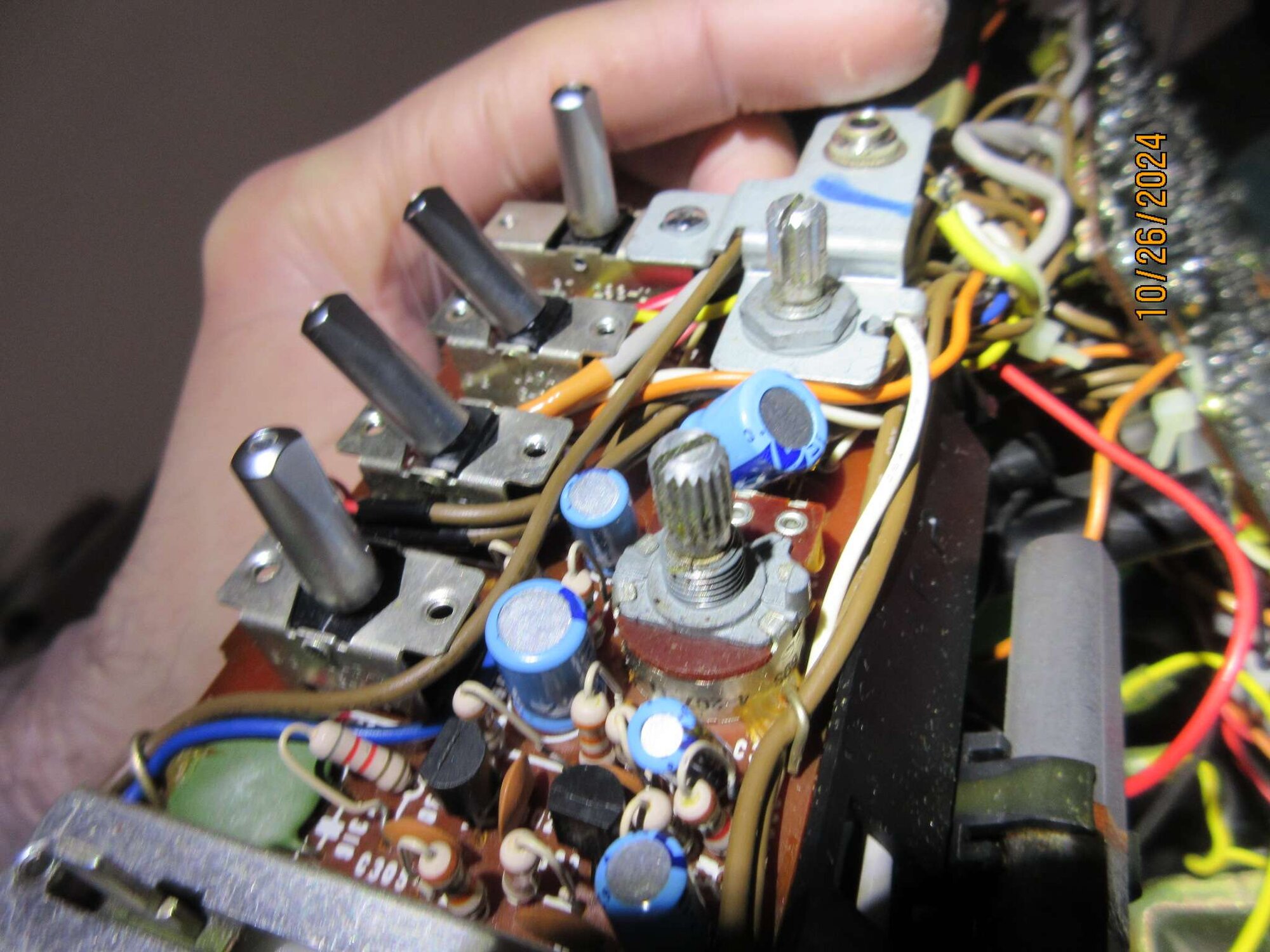

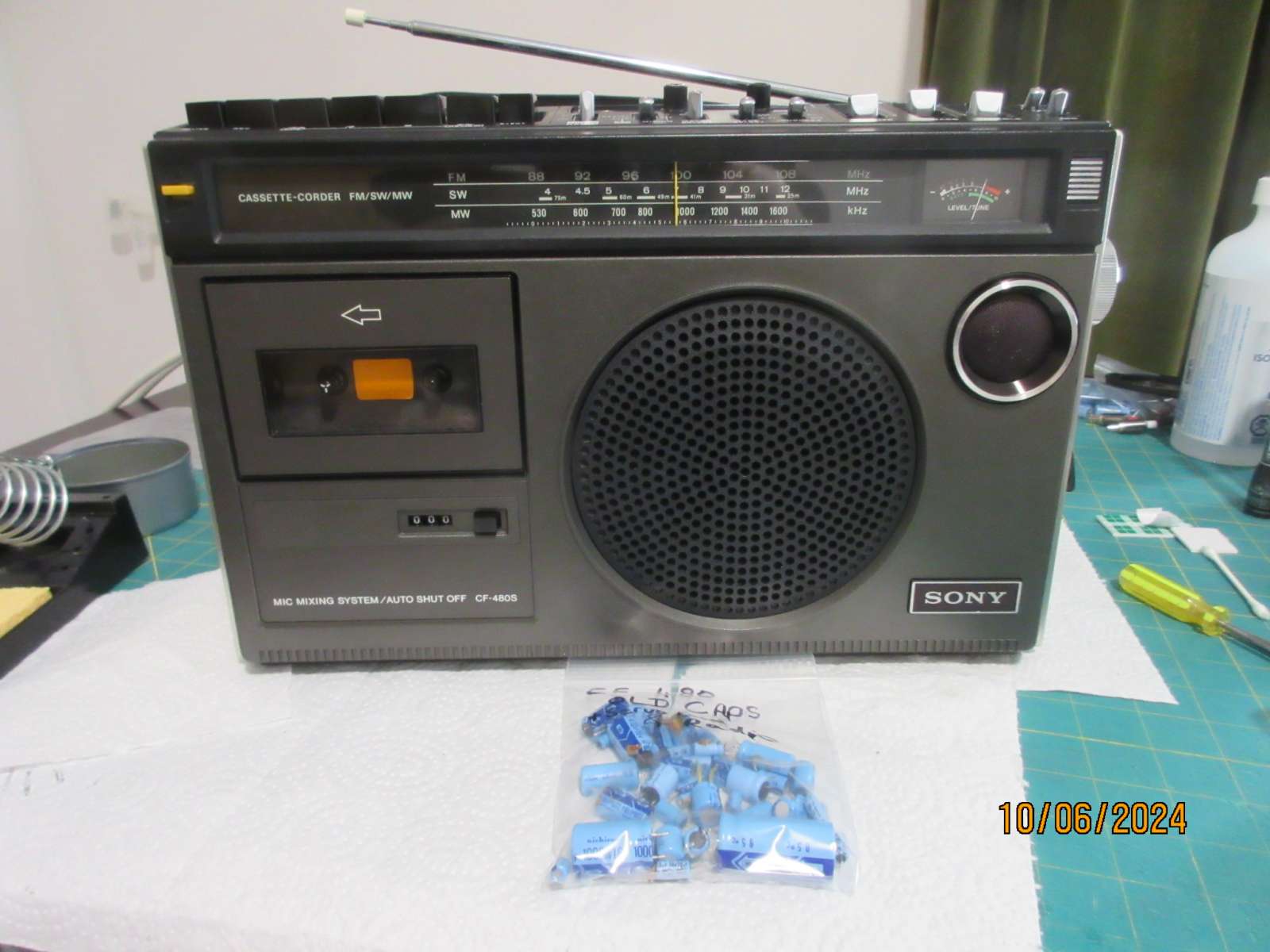

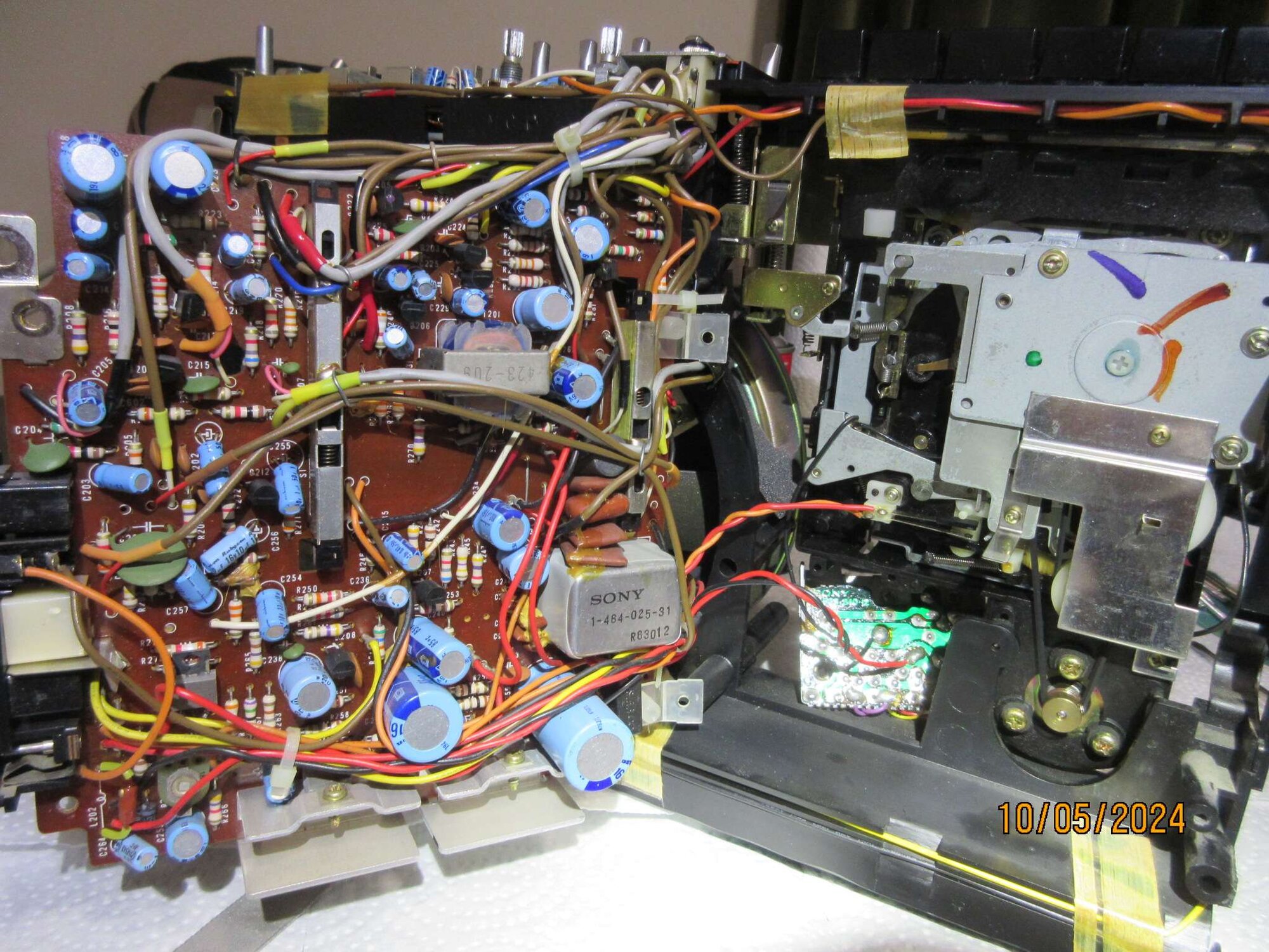

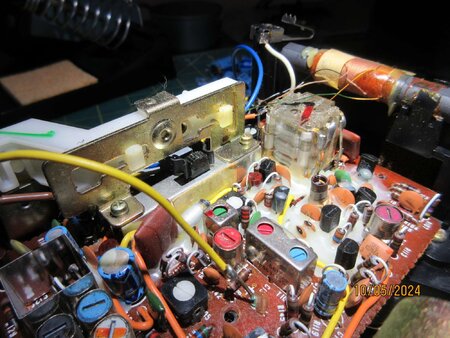

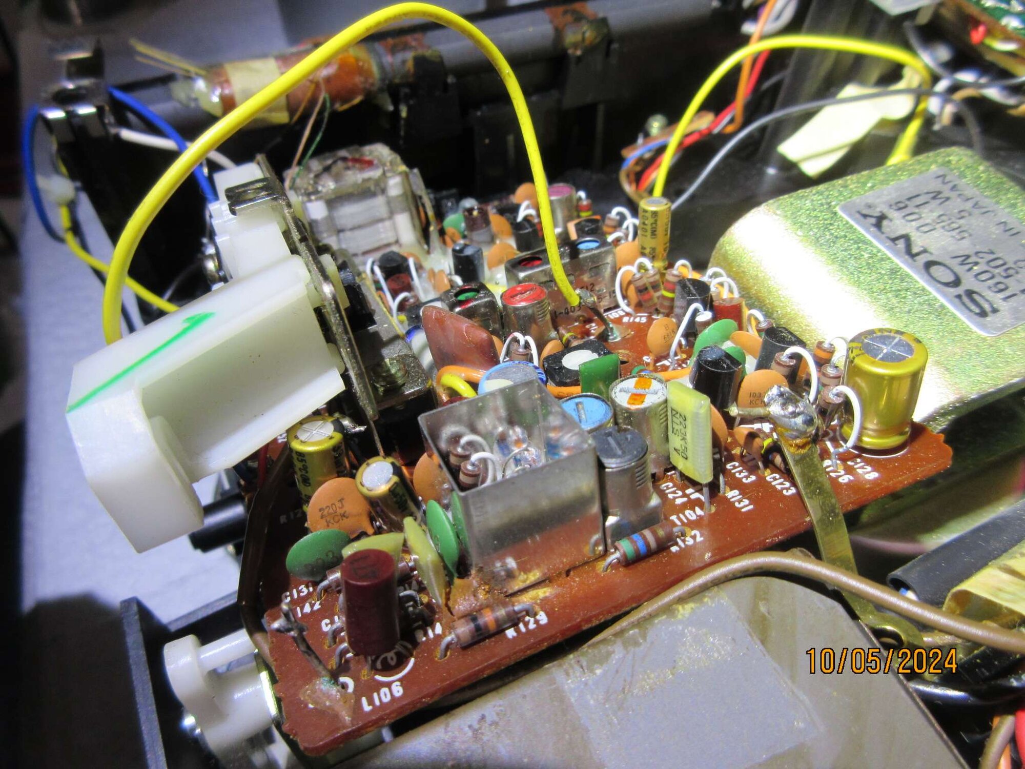

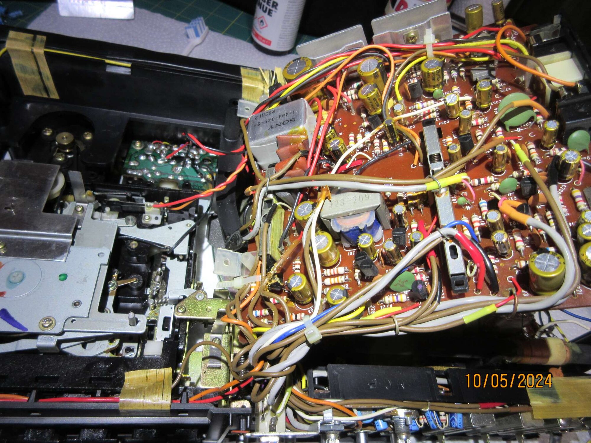

    All electrolytic capacitors replaced.
    Radio board has 5 electrolytic capacitors.
    EDIT: Electrolytic caps almost all replaced, this pic at
    this stage shows 1 left to do still.

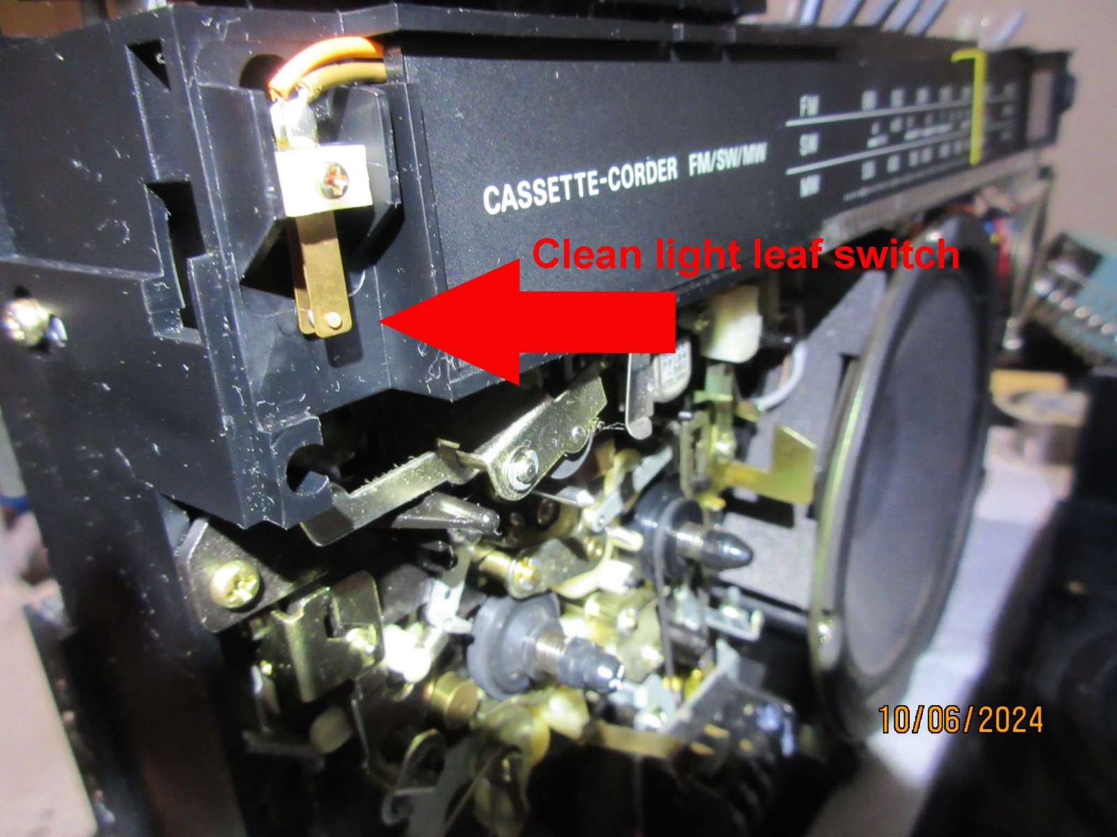

    When chassis is removed don't overlook this little leaf switch!
    It is for the light. And in this case it was heavily tarnished / oxidized
    with filth. I just use 99% alcohol on Q-tip that is flattened.

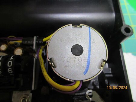

    Motor has what appears to be a date code. 02766E. February 1976?
    Congruent with date of this radio of 1976 from Radio Museum.

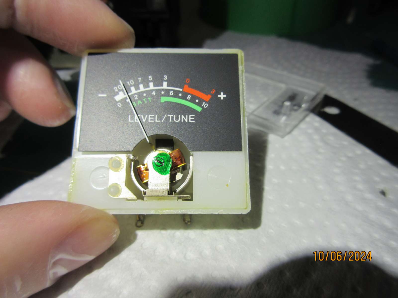

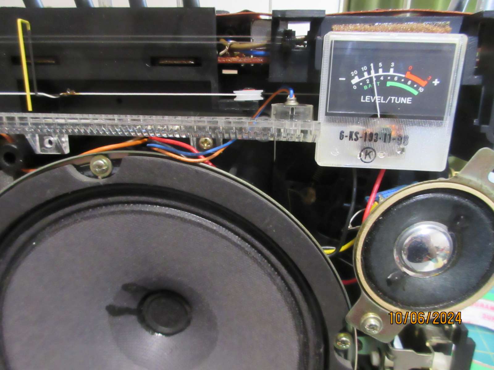

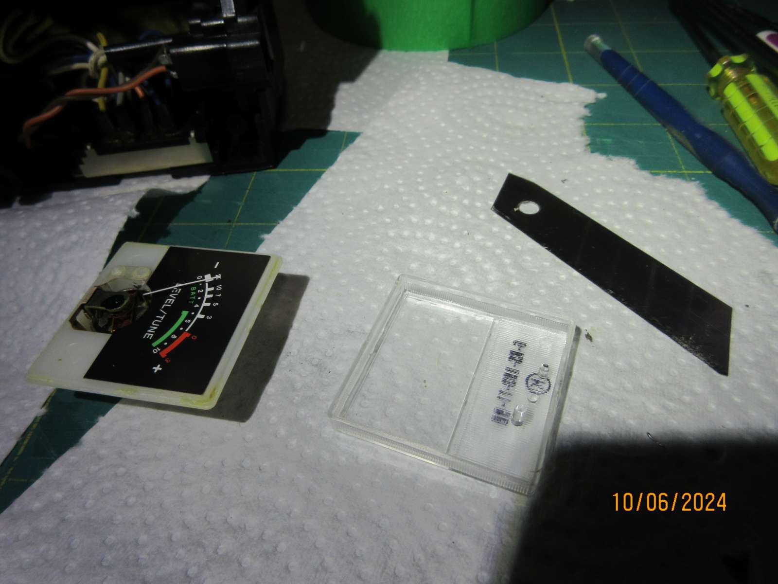

    VU meter was stuck. Youtube videos explain to fix this common issue.
    Remove VU meter and carefully open up. It was lightly glued in this case.
    Not held with tape like the CF-490 (CF-1990 in Japan).
    Place tiny drop on nail polish remover on the green screw lock lacquer.
    This softens it. Then use jewelers screwdriver to slightly loosen the screw.
    Turn Counter Clockwise. Till needle moves fully again. Blow on the needle.
    Don't touch it. Too fragile and easy to bend or break. Once it moves freely
    put back together and re-install. Just like the youtube video taught me.

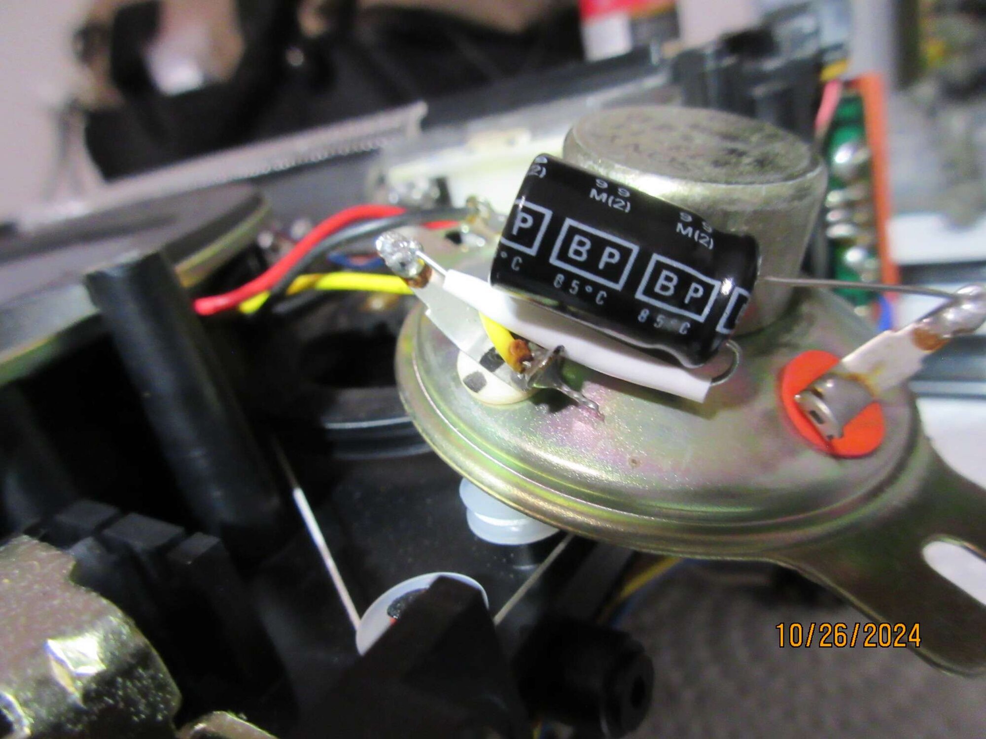

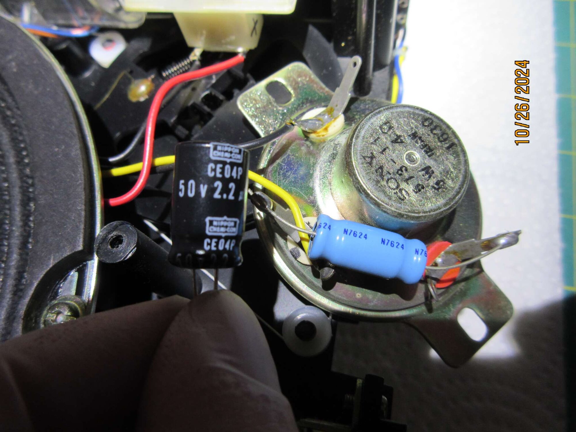

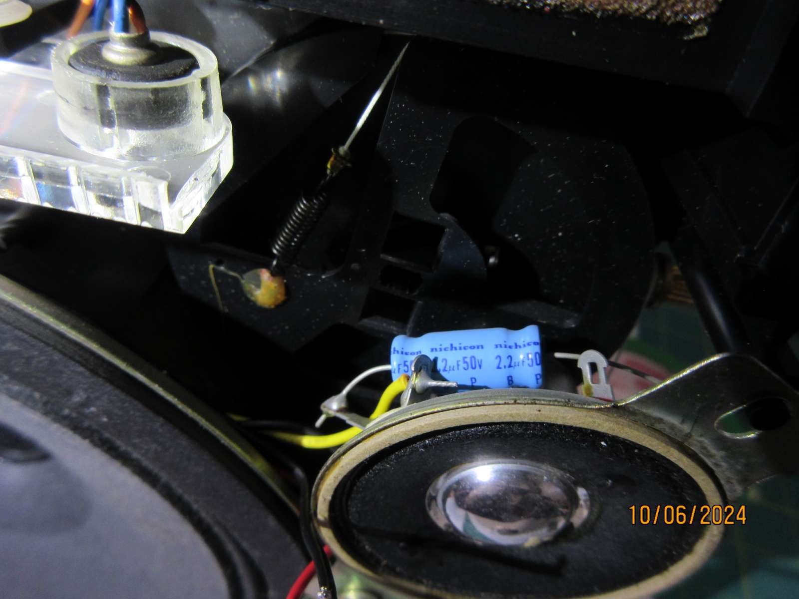

    Uses a 2.2uf 50v Bi-Polar capacitor on the tweeter.
    Great. I ordered 2 for the other radio cassette boxes
    (CF-1990 and Sanyo M-2448) and now I have to order a 3rd.

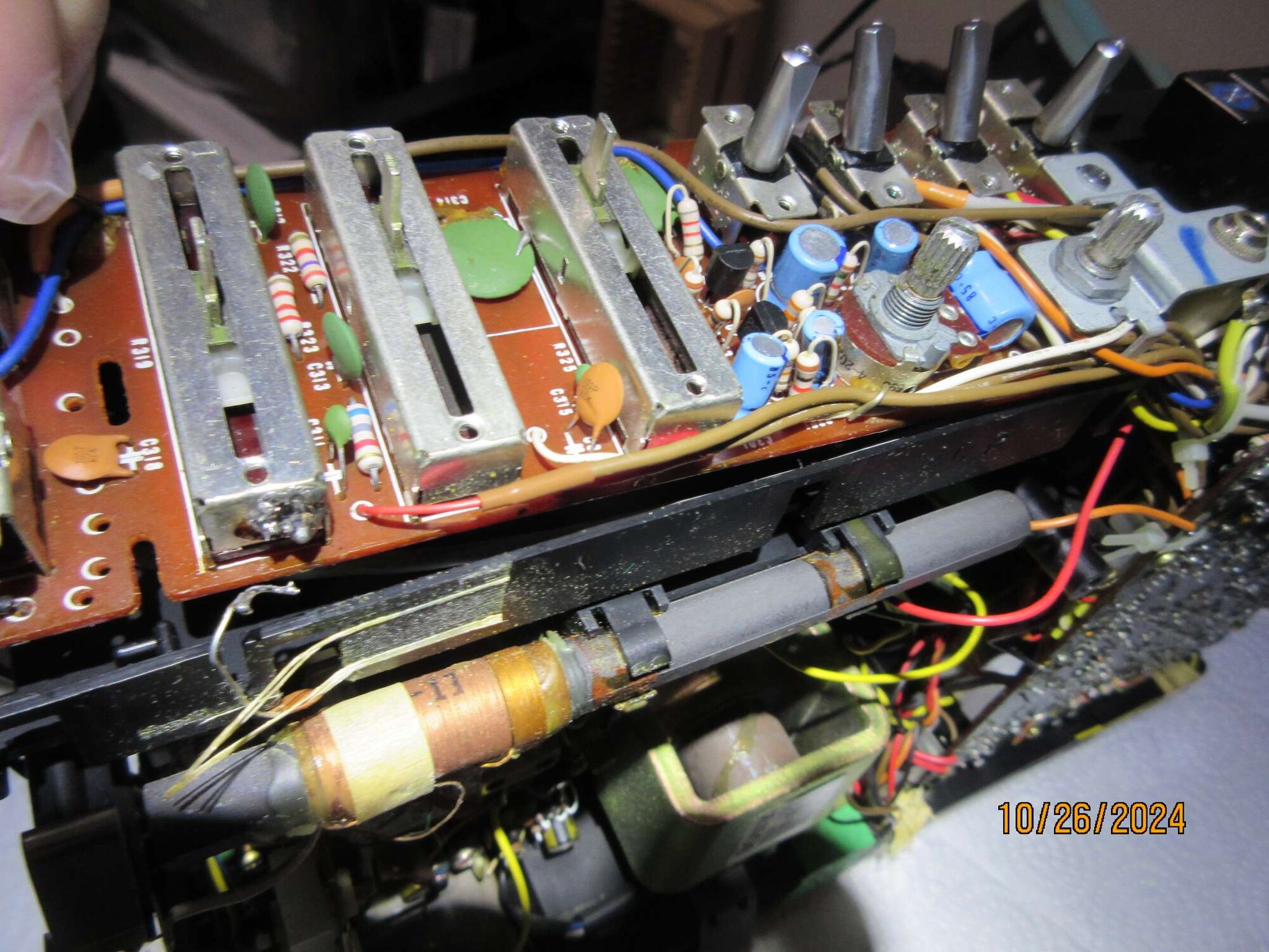

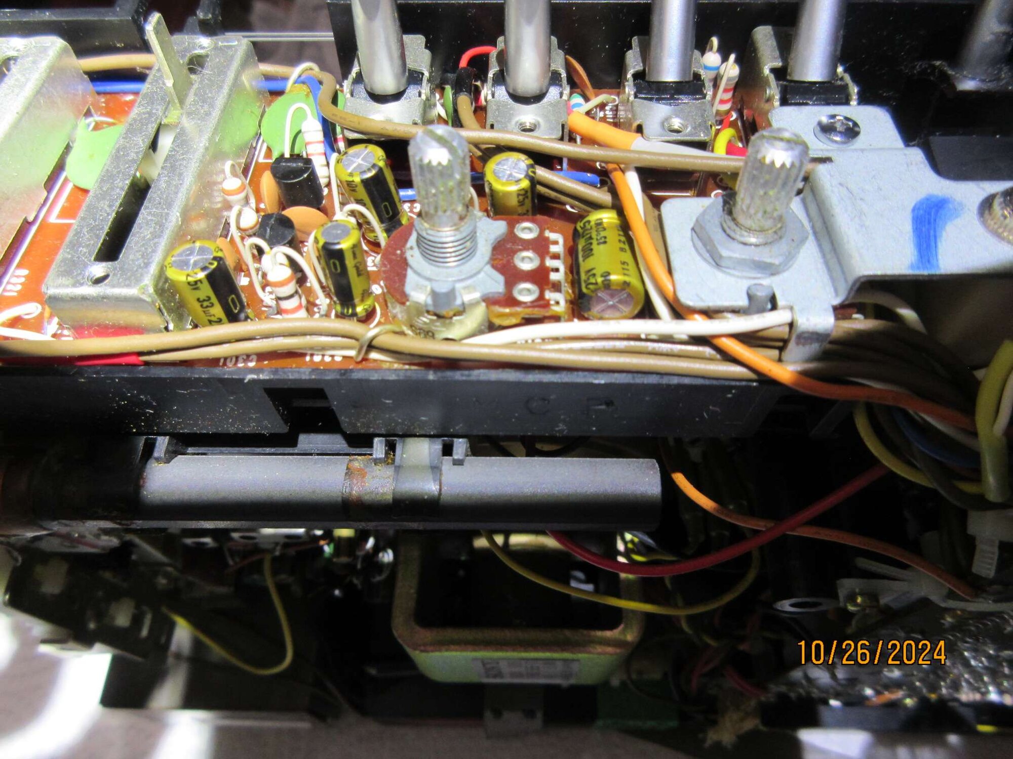

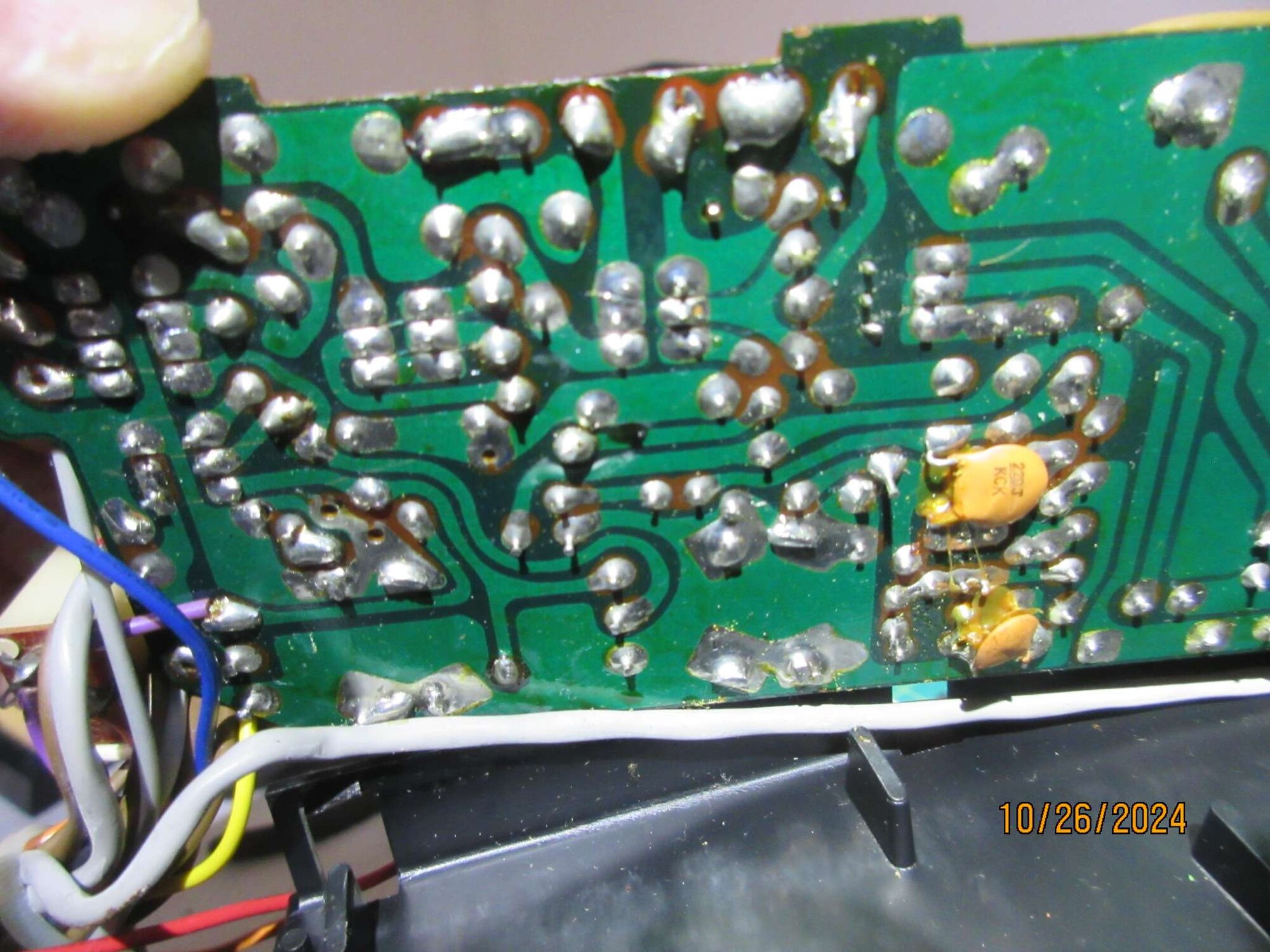

    Update: The 2.2uf 50v tweeter capacitors arrived. Have some pictures but server error prevents placing them here (at any size). When forum accepts pictures again I will upload along with service manual captures of the top mixing board layout. (NOTE: picture of board back with the traces was adequate. Make sure to take before pictures in case a solder bridge is accidentally formed in the process of changing the capacitors.)

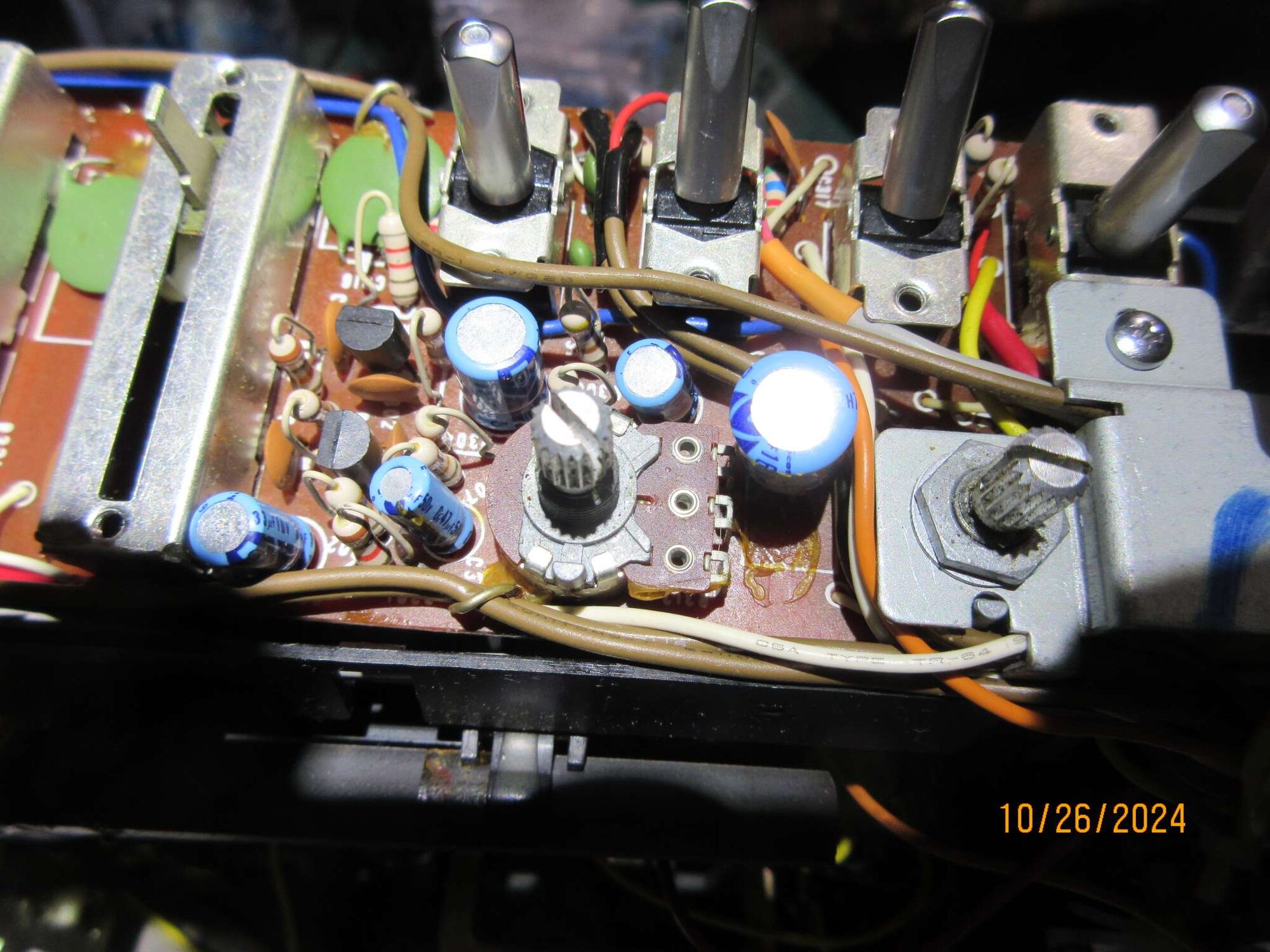

    I also recapped the little "mixing board" in the area of the volume and source sliders. 5 electrolytic capacitors: Two 100uf, Two 33uf and one 0.47uf. (The original cap voltages were low, 10v and a 6.3v etc., new ones are 25v and 50v. If this helps any future readers.)
    The circuit board is held with black plastic tabs holding it down.
    It is easy to remove the circuit board. Both sides have tabs holding it.
    Here is the back of the board to see the trace layout and check in case
    a solder bridge is accidentally formed.
