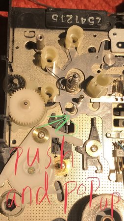

    In play mode,when it stops, the correct behavior is :the play button pops up, motor stops,battery light goes off.

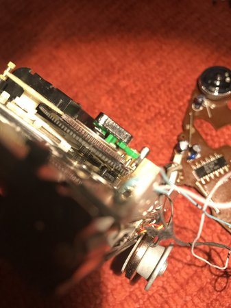

    In your case, I think you didn’t get ‘ the black thing’ in the right position ,that would cause your problem.
    the right position of the ‘black thing’ is shown as this photo .
    Please check yours.
    The automatic stop function is one of the most clever designs by Sony engineers and I will explain how it works later:)

  6. David-ease
    David-ease Member
    30
    China

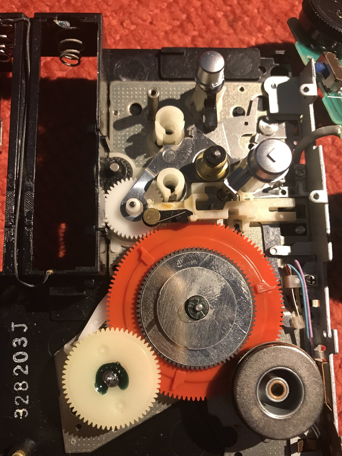

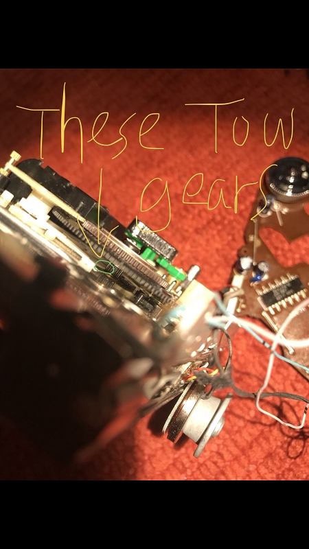

    Since the black lever is in the right position, there is another possibility that would cause the problem.
    Check if the big center gear assembly is a bit ‘too high’.
    if it is too high, the black little gear could not reach the white gear, these tow gears are shown in this picture.
    The automatic stop function works like this:
    When in play mode, the big center gear and the magnetic gear are all rotating, when the tape reaches the end, the magnetic gear stop, but the big center gear is still running, the gear levers under the big center gear detect that the magnetic gear is not running any more,and the plastic lever will then push the steel lever and pop up the play button.
    I don’t know if I make it clear enough:)

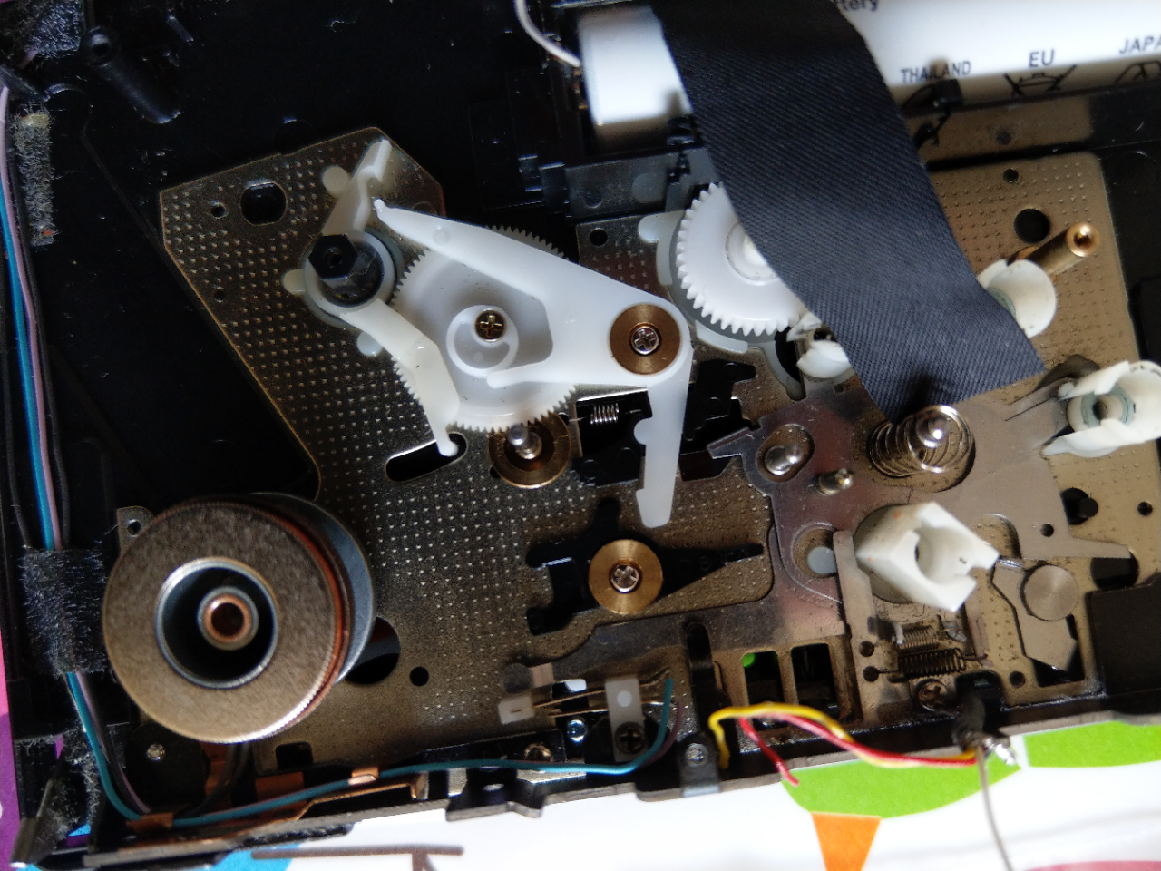

  7. David-ease
    David-ease Member
    30
    China
    Look carefully at these pictures and understand how it works.

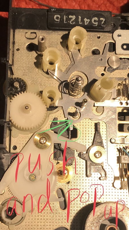

  8. David-ease
    David-ease Member
    30
    China

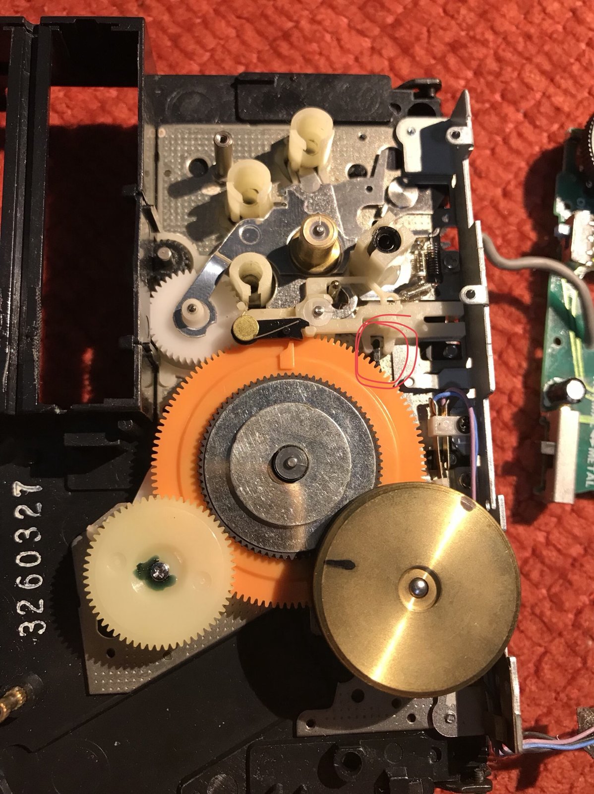

  12. Dag
    Dag New Member
    21
    Sweden

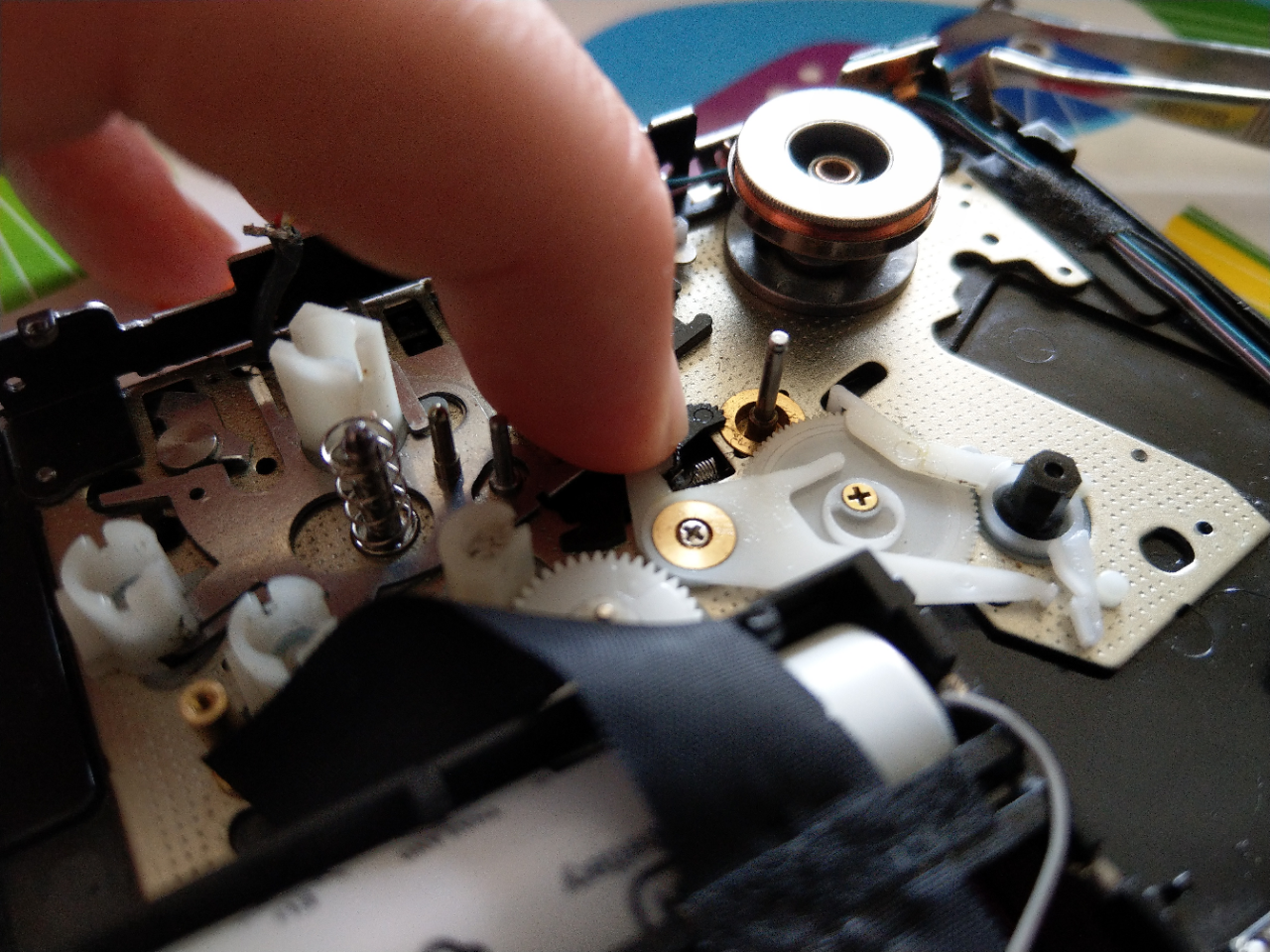

    Very annoying! As can be seen next to my fat finger on the image, the first tooth of the little black plastic part that should engage with the black gear under the big center gear is missing. I opened up my other walkman for spares, but it had exactly the same issue. This is the explanation why the auto-stop doesn't work.

    there are four teeth on that black part ,if the teeth is missing or broken,it won’t work.
    it seems like you are too rude to it.
    When installing the big center gear, you should take care of it and avoid damaging it.
