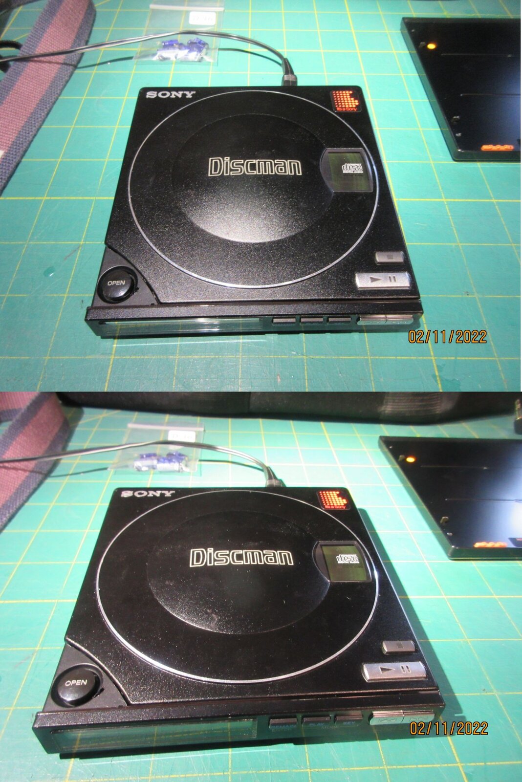

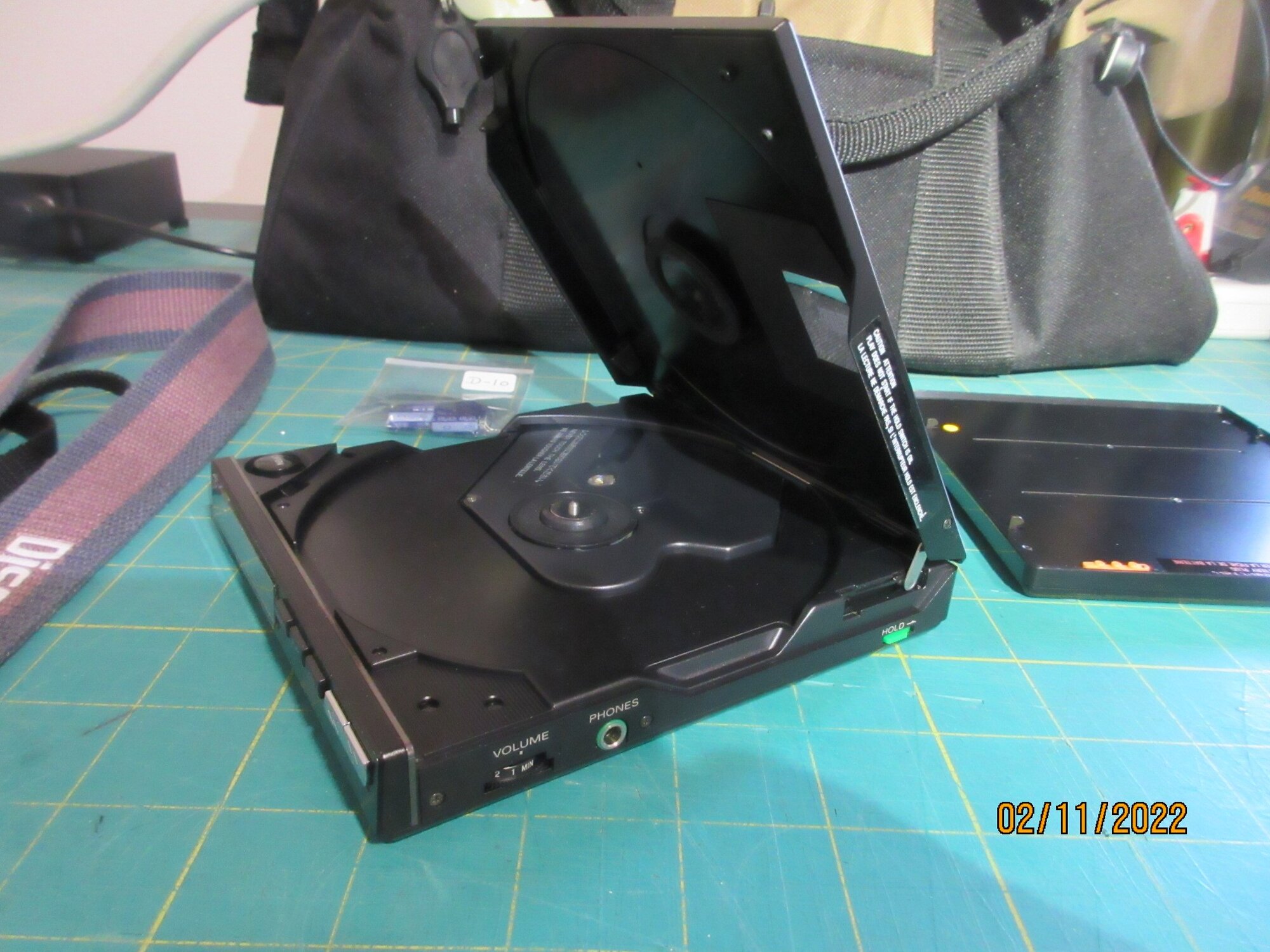

    I was wary about trying this model due to the various cosmetic issues like, uh, the front bezel cover falling off. And the Stop, Play / Pause button group falling out. And the triangular black plastic cover piece surrounding the Open button that tends to always fall off and get lost. All these problems are the result of glue that dries and fails over the years.

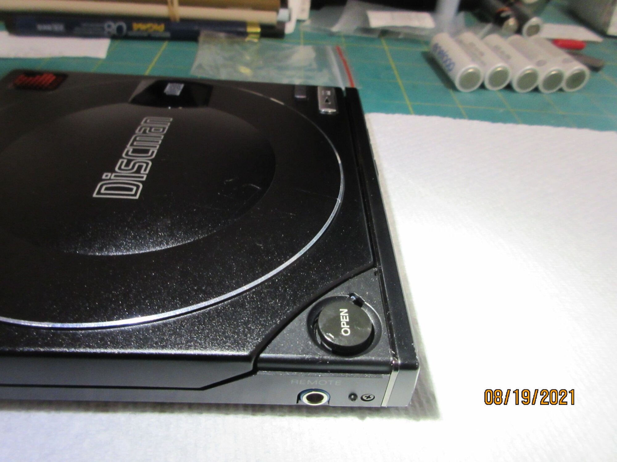

    So I finally found one on e-bay that was not working with great condition - and intact - even the triangular corner piece was in place! Upon arrival, however, the corner piece was missing. The shipping box was opened by customs and the player had been re-wrapped. Seller said the corner piece was loose and just sat in place. So we could only assume it fell off in a sorting / inspecting facility and, with no apparent visible place it came from, was simply discarded! Perhaps it sat on the floor to be swept up later by the cleaners. Or perhaps the seller never really included it, lost it, couldn't find it etc., Who knows. So that was blow #1.
    The Sony D-10 was a beautiful heavy player. Wow it was so heavy! The lid felt so strong and thick.

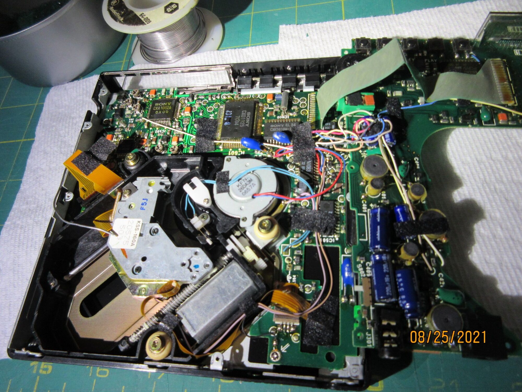

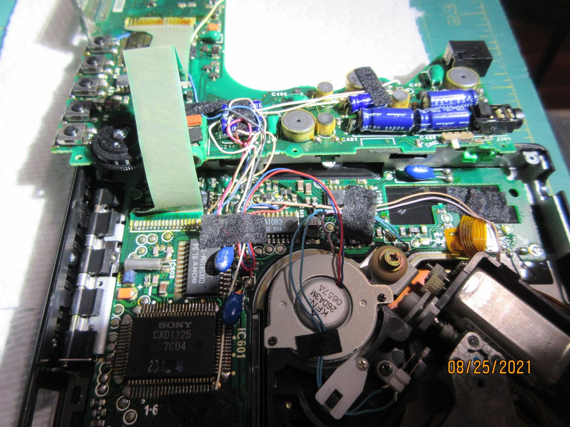

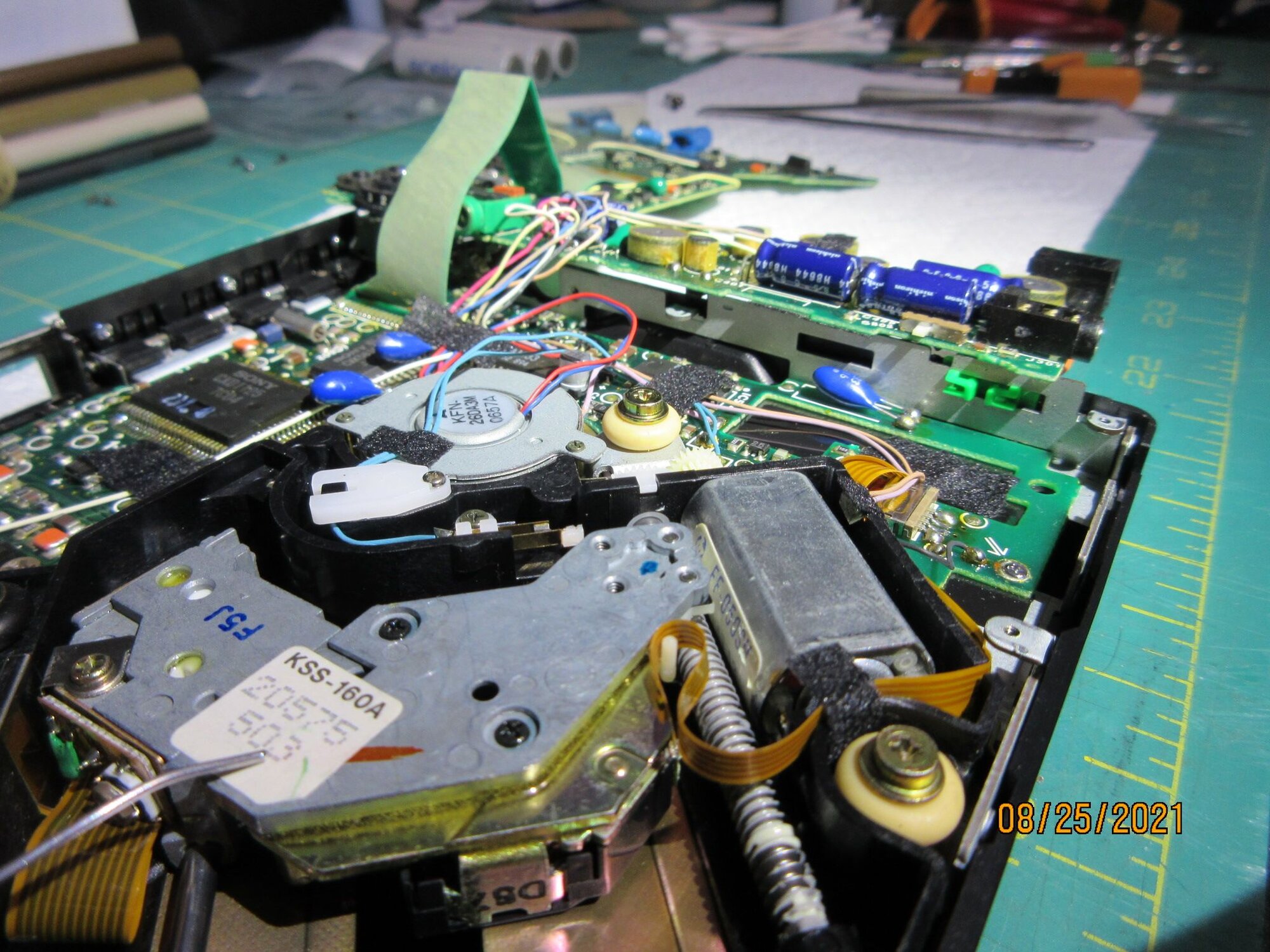

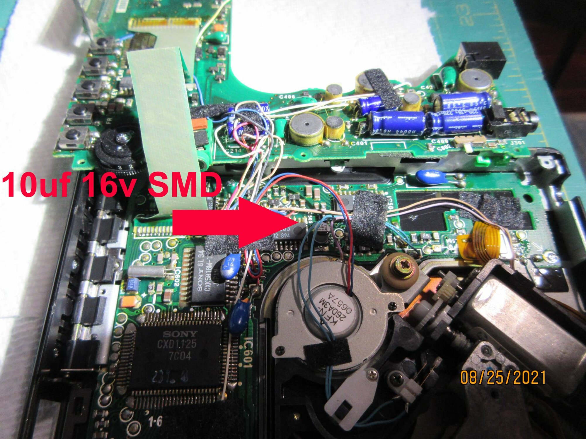

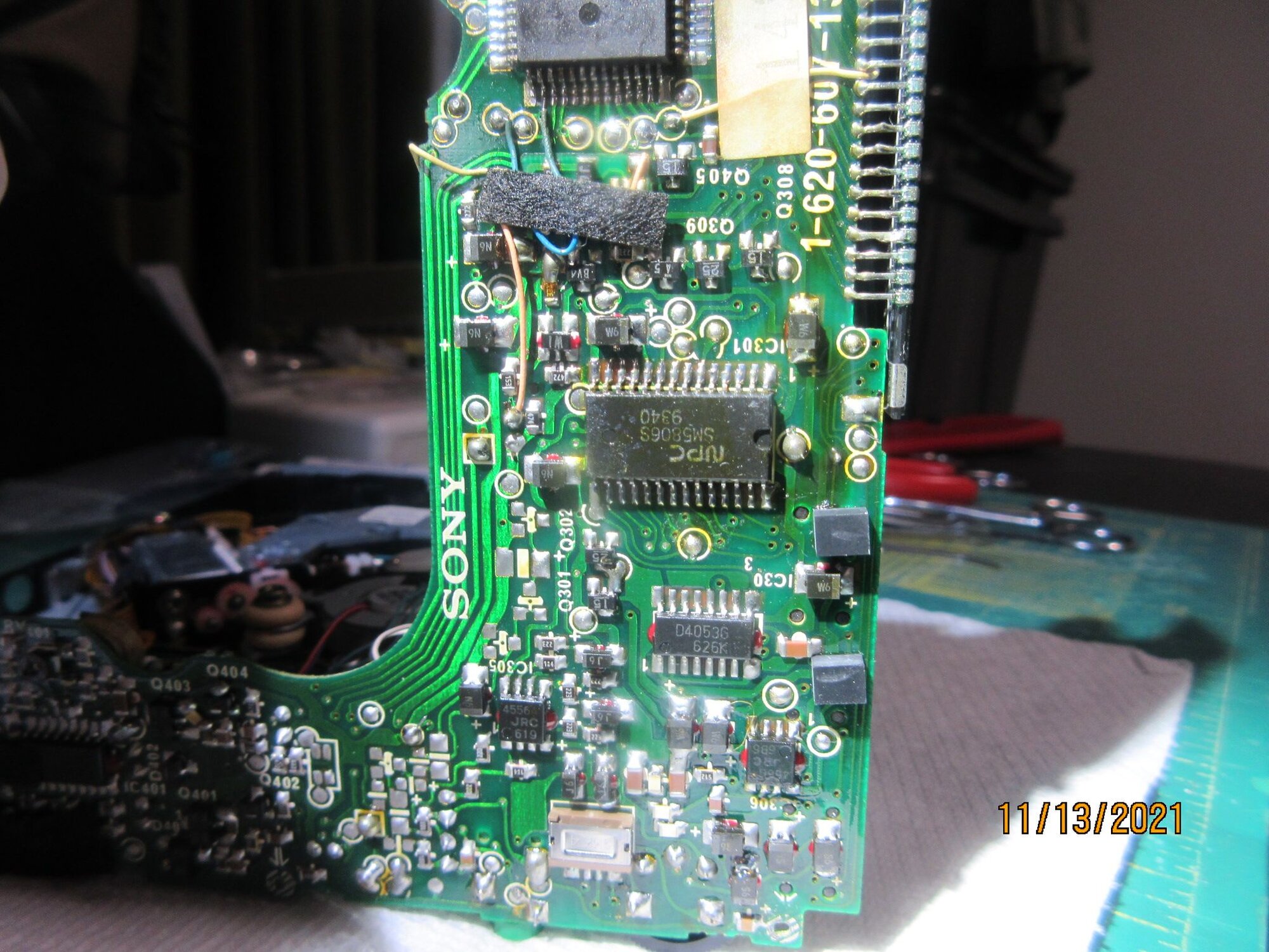

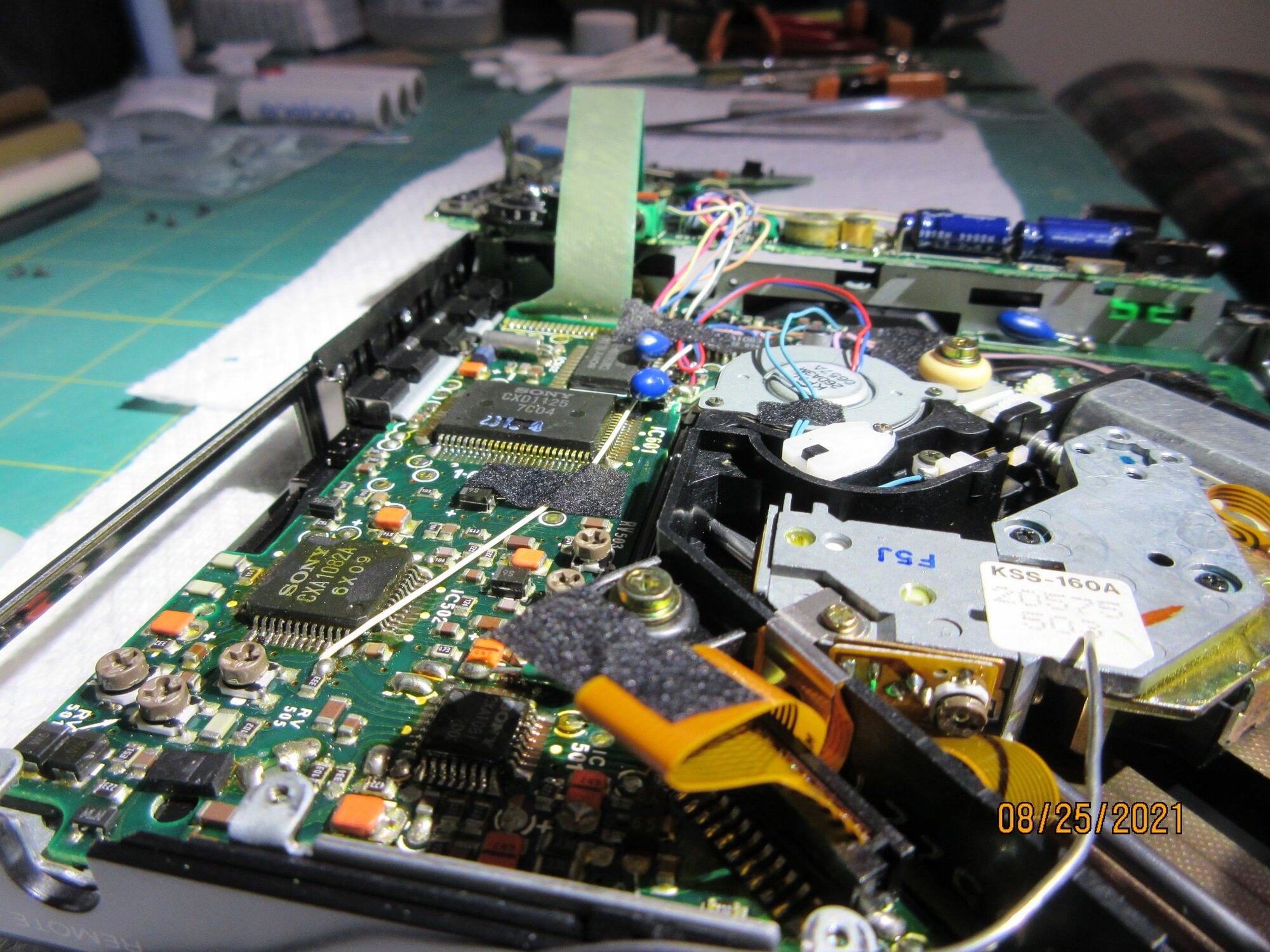

    Straight off to Kaosun it went for repair. I opened and check for obvious things like the infamous cold solder joint / break to one of the inductor coil legs. I noticed it had a single 10uf 16v SMD capacitor. I replaced it and found that it was wet with leaking electrolyte underneath. Don't all SMD caps fail and leak from their base in due time? That's what I read others claim. All devices with these aluminum SMD caps are doomed to have leaks and have their circuit traces etched away. Unless caught in time and replaced.

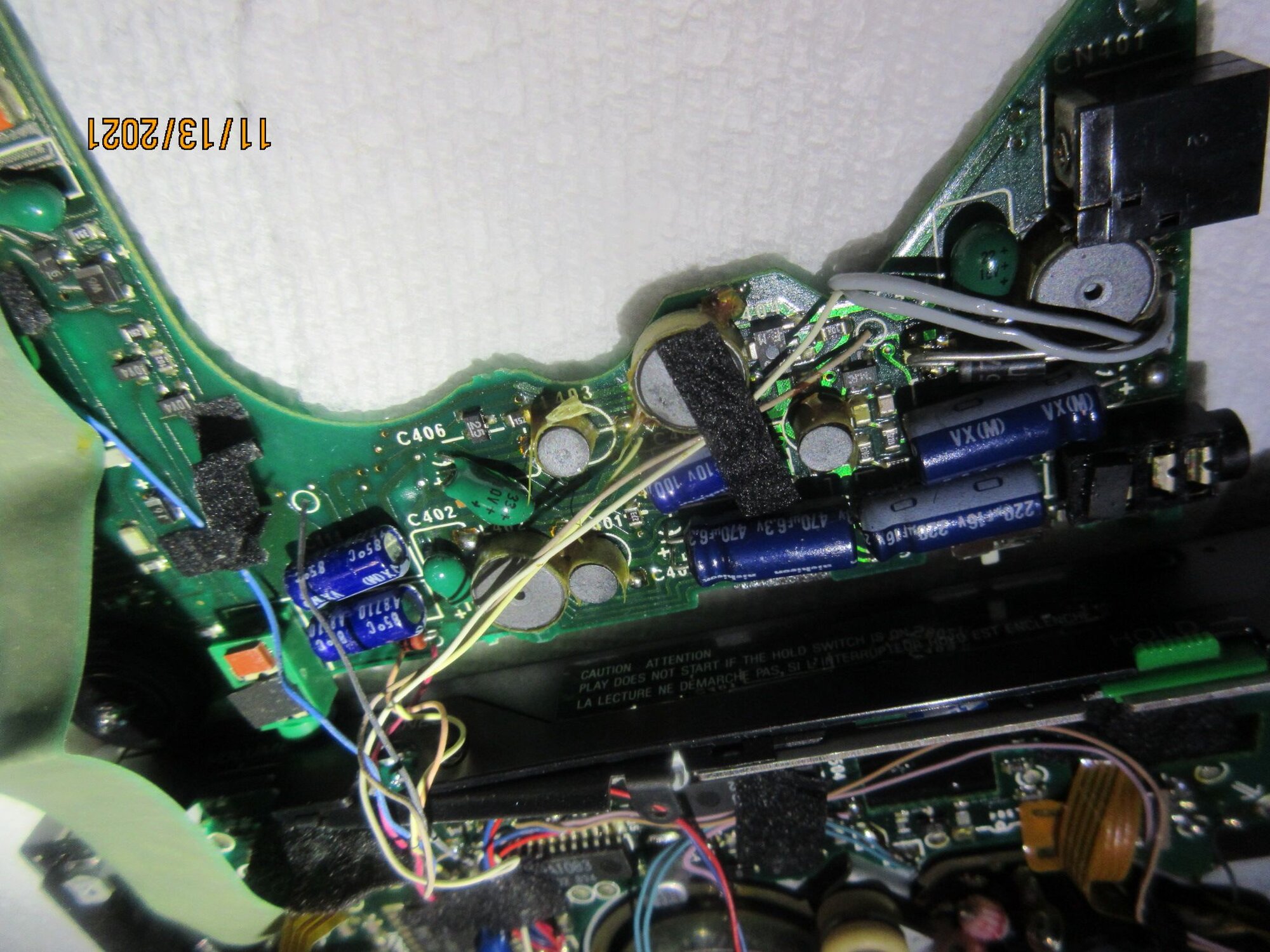

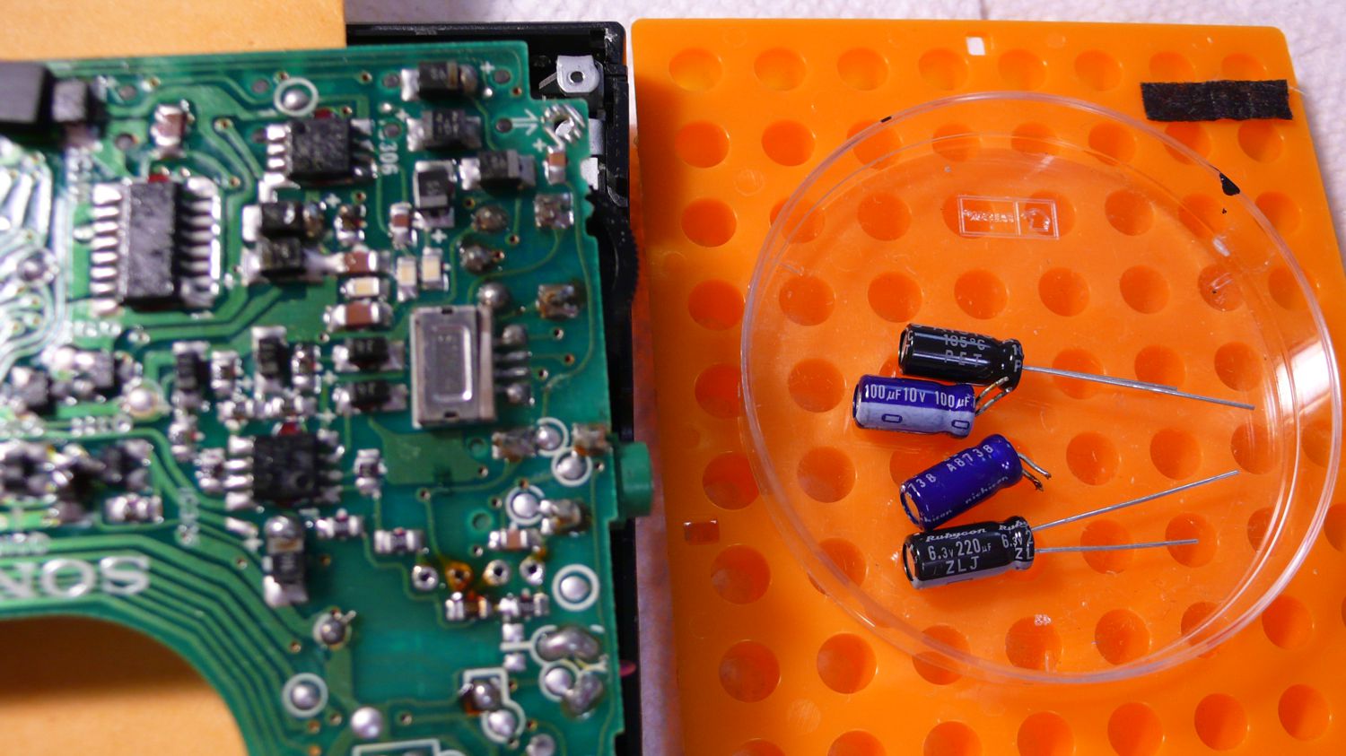

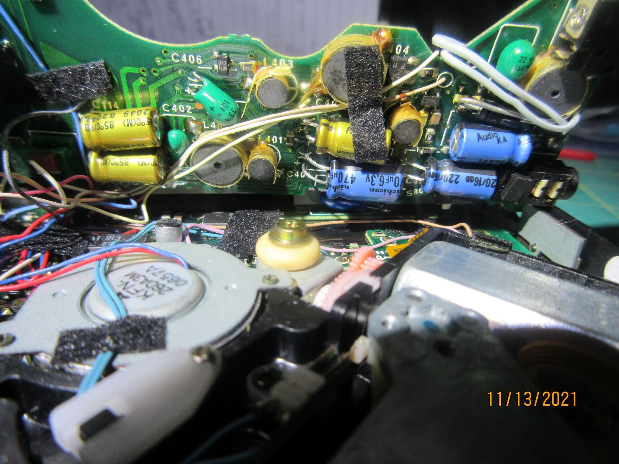

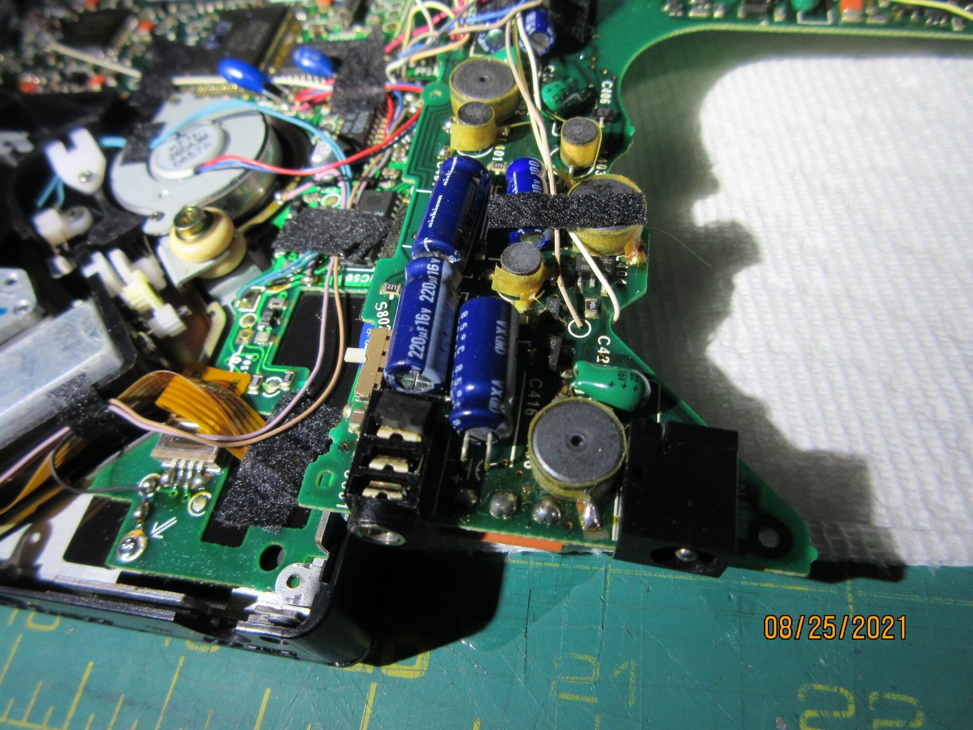

    Replaced all caps with Nichicon Fine Gold and Nichicon KA. After several days of listening and some burn it time determined to have had negligible impact. Blow #3.

    The famous hallmark "missing corner triangle" around the Open button.

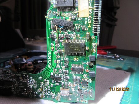

    Infamous inductor coils and their legs which... break off. Or otherwise
    fail to connect to the board. Notice the large format hole-through dipped
    Tantalum caps. These seem conspicuously absent in later models where
    they switched to SMD variants.

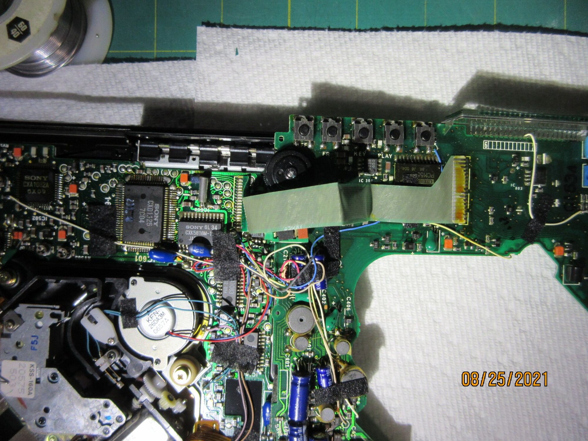

    Before Capacitors replaced.
    After Capacitors replaced.
    Beware the 10uf 16v SMD that must be replaced due to leakage.

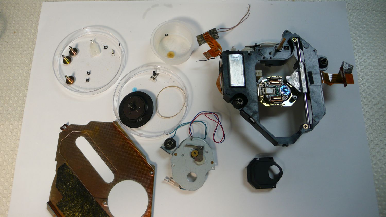

    back to D-10: spindle motor and belt are un-breakable but still have to be fully disassembled, cleaned and sintered brass re-soaked with fresh oil (Mobil 5W-30):

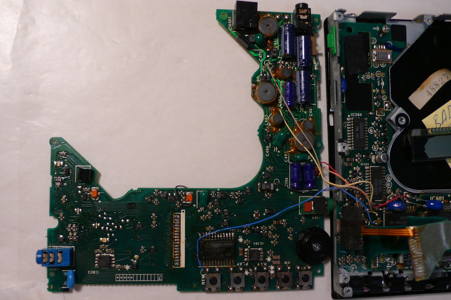

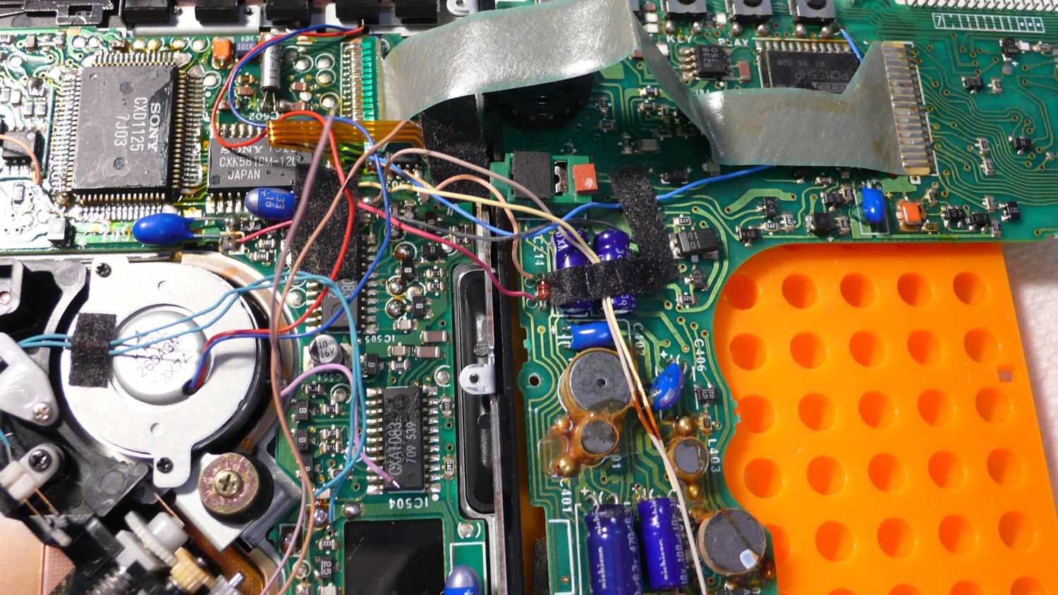

    I prefer Rubycon ZLJ series for h/p coupling here, but legendary 220uF/4V Black Gate caps fit well also:
    For some "seriously disturbed" D-10 you have to desolder flexboards, this opens PCM55 - Burr-Brown multibit DAC, something I see in all my favorite Discmans:

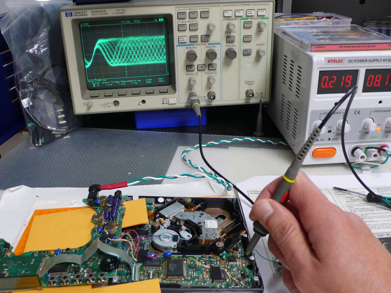

    Eye-pattern tells if laser mirrors got hazed and if CD-R will be playable:
    Absolutely all belt-drive spindles (Sony D-50 MkII and D-100, also Toshiba XR-9437 and XR-9457) are noisy because of the hi-speed drive motor: you have to pay for this goodness by inconvenience! Also, none of the tracking will be as silent as in a swing-arm Philips CD10 but it should not be any worse than Sanyo SF89 in D-66/D-303/D-350

    Good recommendations Jorge. If the belt is really unbreakable then it warrants a second look at a D-10. Worth going in deep and cleaning the bronze bearing then. On my sample CD-R played and it was quite resilient on a scratched up CD I keep around for that purpose. Rubycon ZLJ okay. Black Gate, sure, I wanna try them on D-555 too.
    The spindle motor was quiet - it was the worm gear / sled slewing motor that was noisy.
