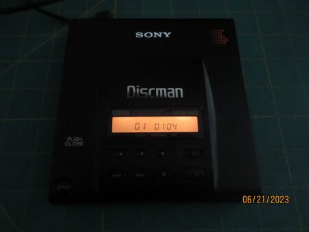

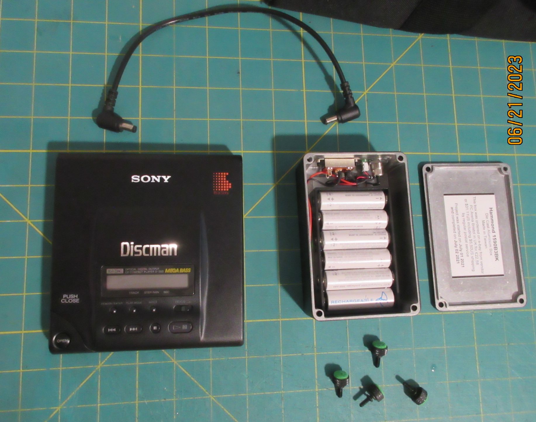

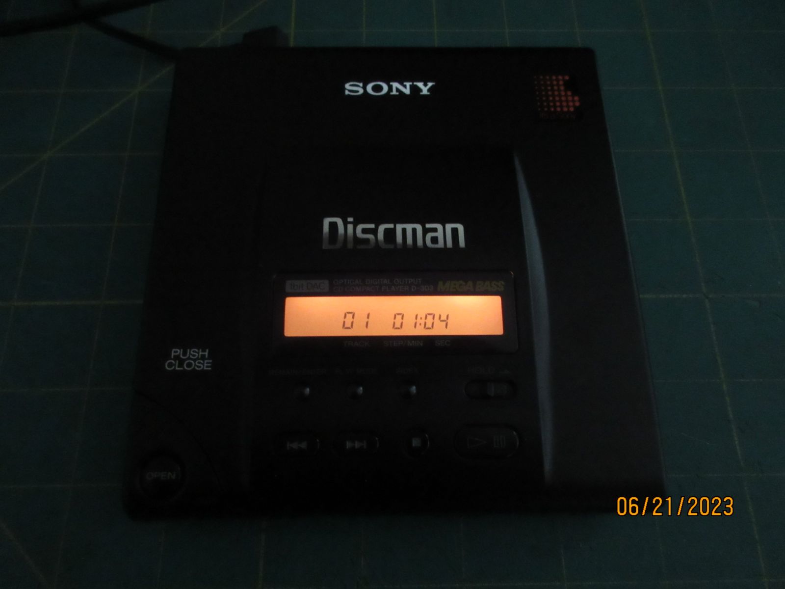

    Sony Discman D-303 from 1991. Was this Sony's second 1-bit DAC Discman after the D-99?
    Old head-fi.org threads from 20 years ago had much speculation and interesting comments on the D-303. Some said that it was a type transition model from the old to the new Discman's. One user had access to an old Sony catalog or ad that listed it as a "Special Purpose". Due to Toslink optical out and gold plated line out? A type of "line out specialist" some theorized. The D-303 had the best line out of any Discman, only the Denon DCP-150 with the AD1868 DAC was better etc., etc,. The amazing detail, wide sound stage, accurate bass and the least distortion were praised.
    Finally in February 2022 a D-303 in the proper condition and from a serious seller appeared on e-bay - and I got it. Upon first listening it was quickly apparent to me... that it was worth keeping. And the D-10 was going to be sold. The detail from headphone out was impressive when listening to the usual rich multilayered ambient electronica of choice. Line out through a Headroom desktop amp was indeed warm and rich and impressive.

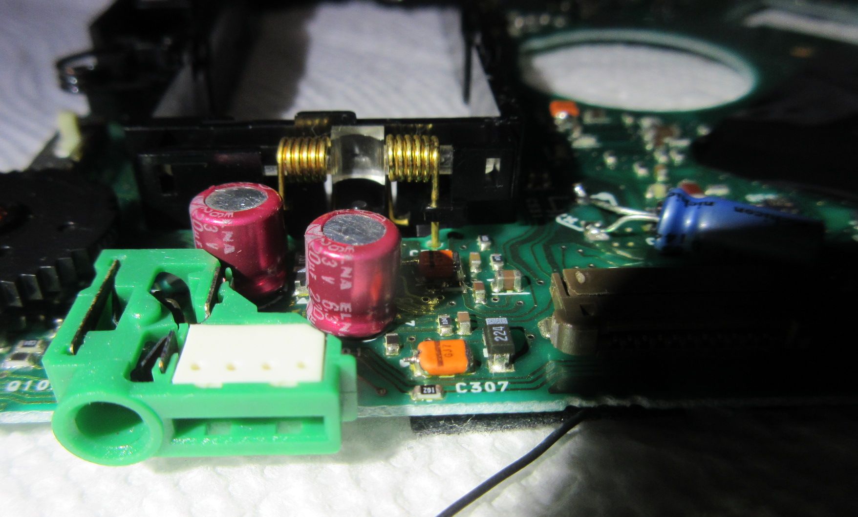

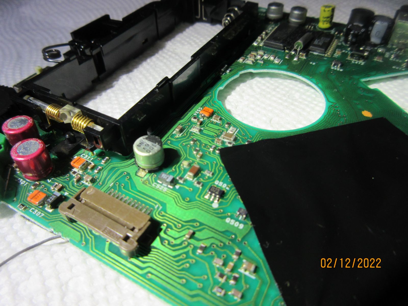

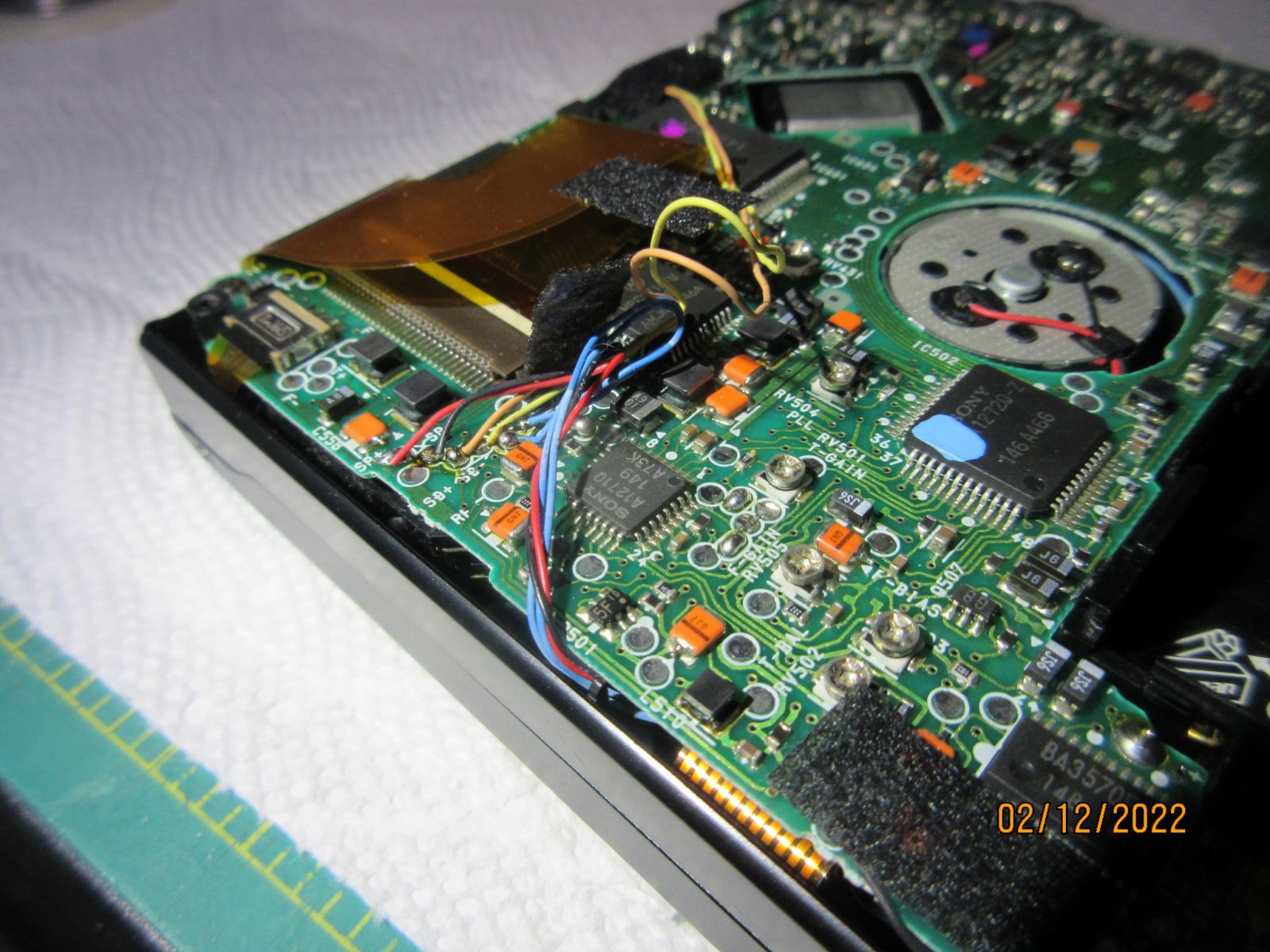

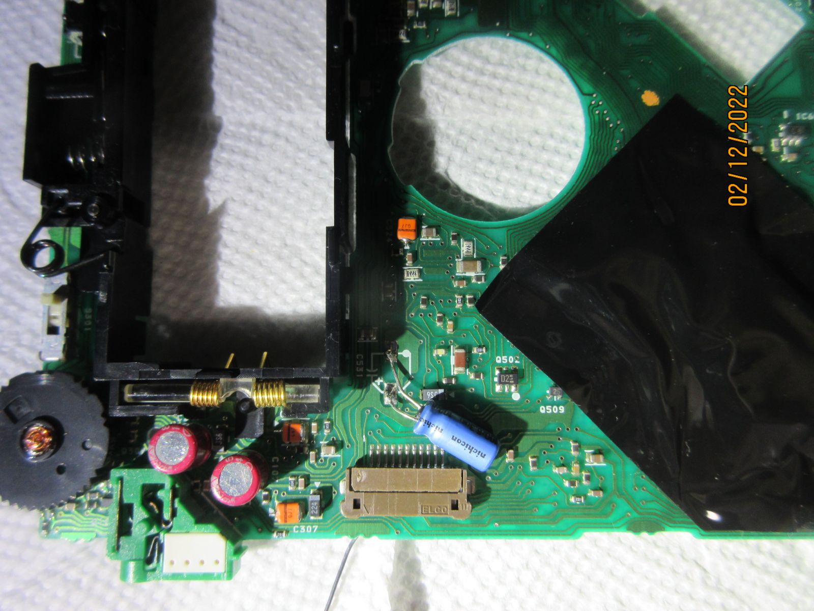

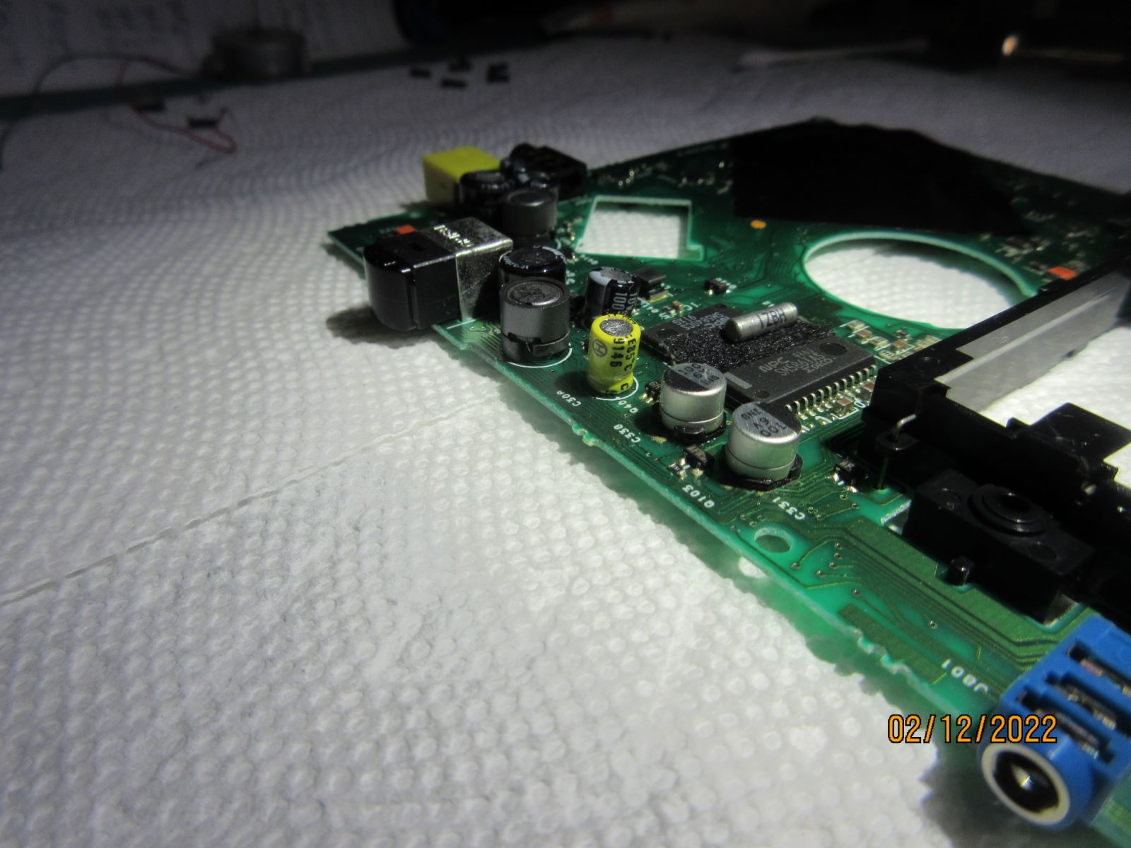

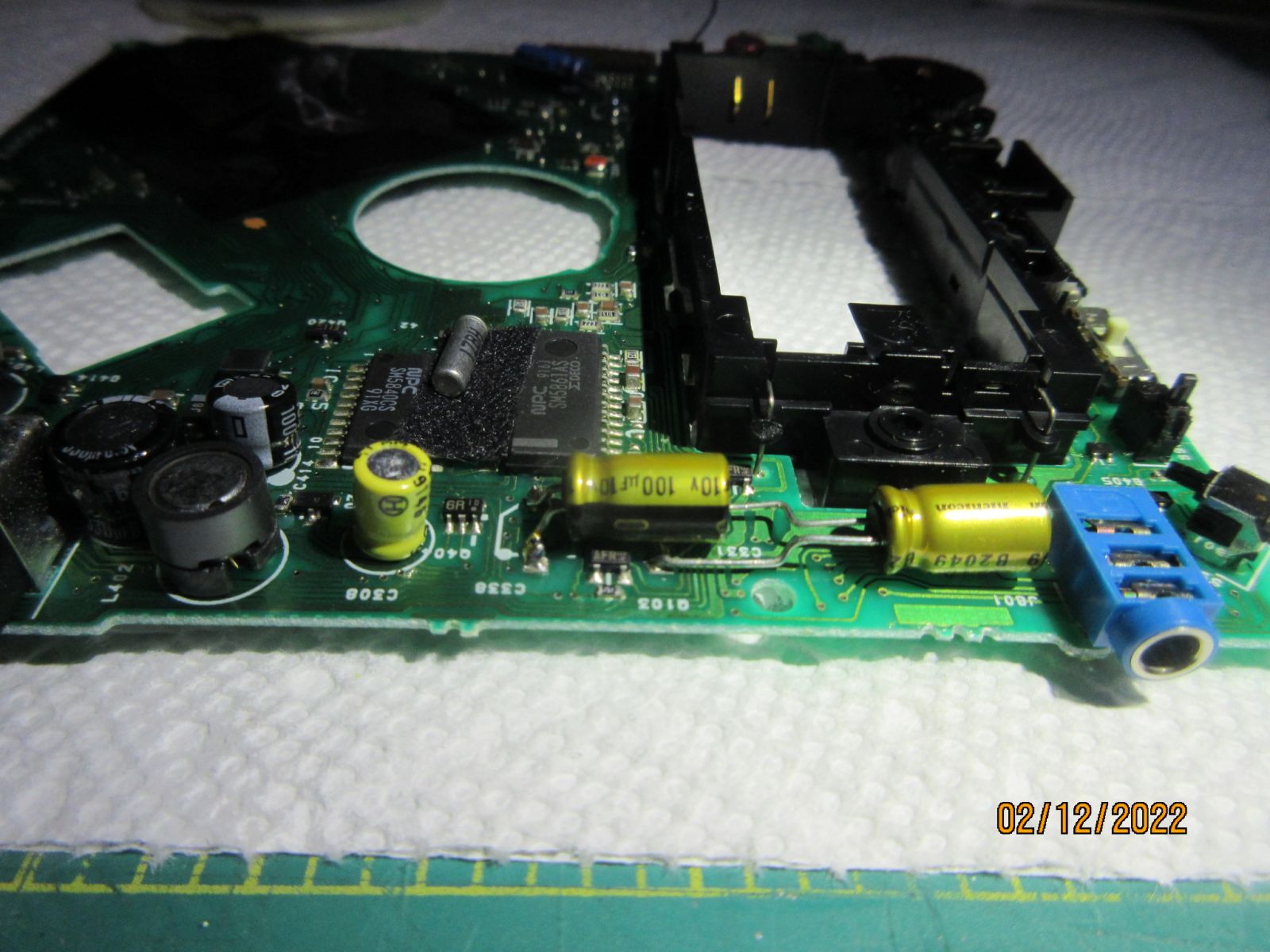

    D303 suffers from the same deadly 100uf SMD aluminum capacitors as the D555 does. And the garbage spindle motor Mabuchi RF-410CH from th D-35 / D-350. The worst of both "classics". That motor needs to be replaced with the $1.50 ebay one Mabuchi RF-410CA. Once the sled and gears are cleaned and re-greased with Teflon PTFE Labelle 106 life can go on. Until those other pesky electrolytic capacitors go bad in the future. The board is packed in tight and some of those values are near impossible to find in such small sizes. It won't be fun replacing all of those one day. I left them alone since they are working.
    Additional motor info: The Mabuchi RF-410CA from e-bay is usually described by some sellers as NOS from a warehouse. They are probably old and definitely have dry bearings. They run scratchy and loud from an AA battery. As soon as they are oiled it goes quiet. They also have a small pinhole oil port leading to the bronze on the back / base bearing. Yes really. Not even the old original motors have that. I fed oil into the pinhole and let soak a few days. It was actually absorbed.

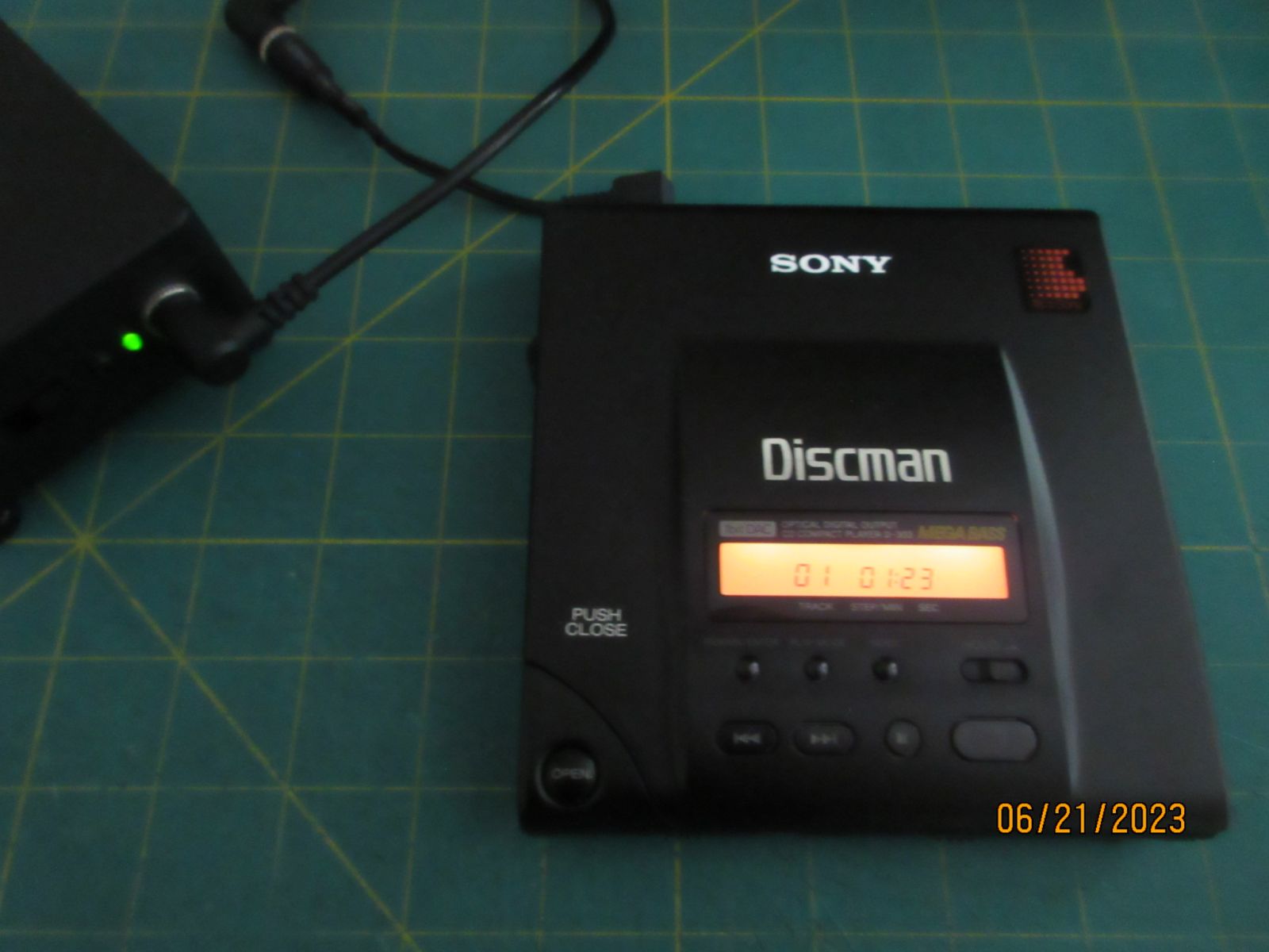

    The D-303 has a good look and style in my opinion. It tuns on 2AA cells as well as the lead acid BP-2EX using the famous little fold and battery holder spring arm. Same as the D-515 would later use. The orange backlight display is fantastic and just plain cool.

    Running from 6AA battery box into the DC9v input jack.
    Look at those funky red Elna 220uf 6.3v capacitors used on the headphone
    coupling! Interesting. They were actually putting some effort into making
    it sound as best as they could... without spending too many extra cents per unit.
    That's just a trace of sarcasm there folks :biggrin:

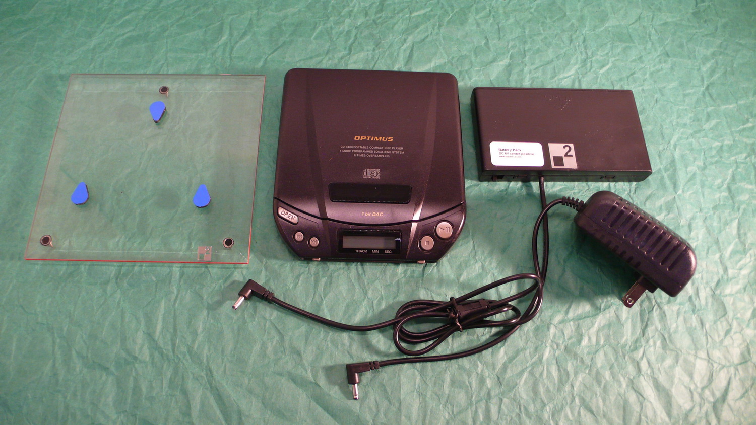

    @Hyperscope - unless you have it already, you Must try the most reviewed Discman ever made: Optimus CD-3400 (made by Mitsumi for RadioShack, also branded as Akai PD-X73 and Grundig CDP100).
    Radio Shack Optimus CD-3400 - Stereophile crowd just could not drop the subject, spent more time talking about CD-3400 than all other Discmans ever made.
    Before you ask - I do have a few and they do sound wonderful, especially with a new spindle motor, full recap, recalibration and Line-Out upgrade recommended by Stereophile
    Here is one of mine with full 'audiophile' kit, as recommended by Stereophile:
    I see one listed on eBay right now: real pain to recap and restore damaged traces but well worth the effort! :)

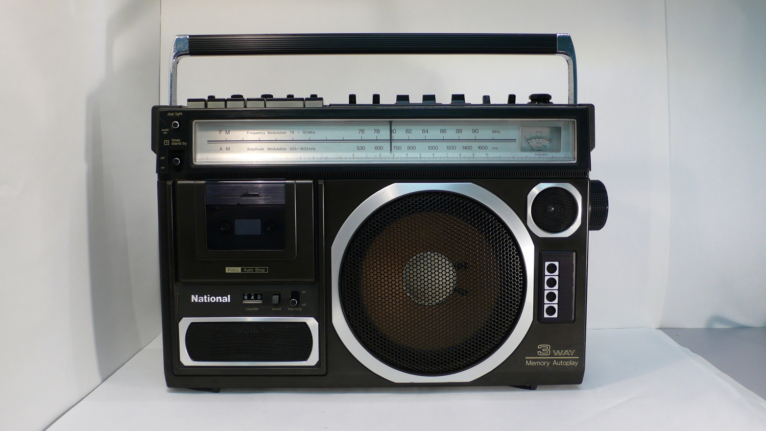

    Yeah the Optimus 3400, I read the articles and hype, but I am out of the Discman / portable CD player game for now. Denon-50 upgraded to AD1868 is something I want to try. The Denon-50 with 4AA battery inside plus that upgrade is something I want to hear. Apart from that I want to get back into Headroom Ultra Desktop Amps and several top new headphones plus maybe get a good fully serviced restored 90's Akai or 80's Nak cassette deck. And a couple of iconic 70's Mono boxes like JVC RC 550 and National 5410. By the way, did you ever get into the 5410 before the disaster, I see your thread where it arrives from a seller in Europe but then, no more...

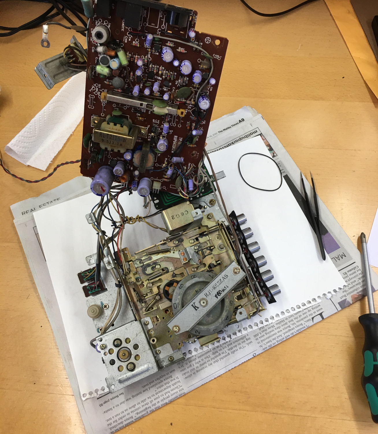

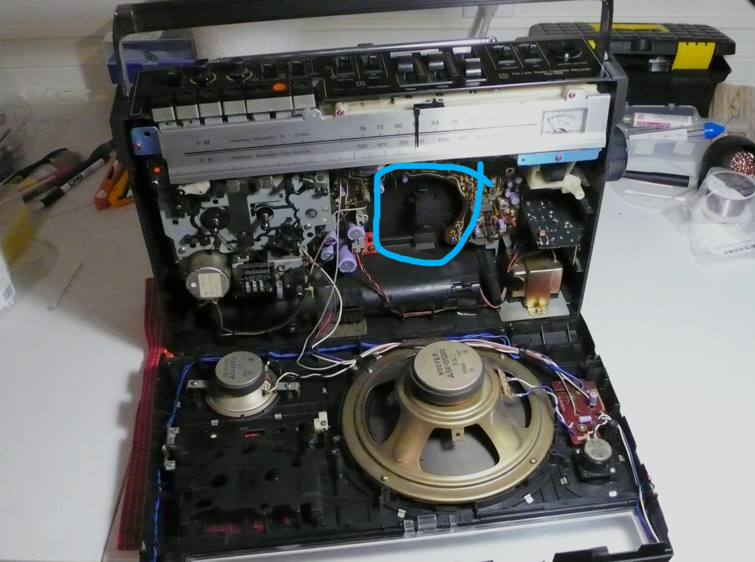

    @Hyperscope - Headroom amp is an excellent choice. My own 5410 is still in pieces:

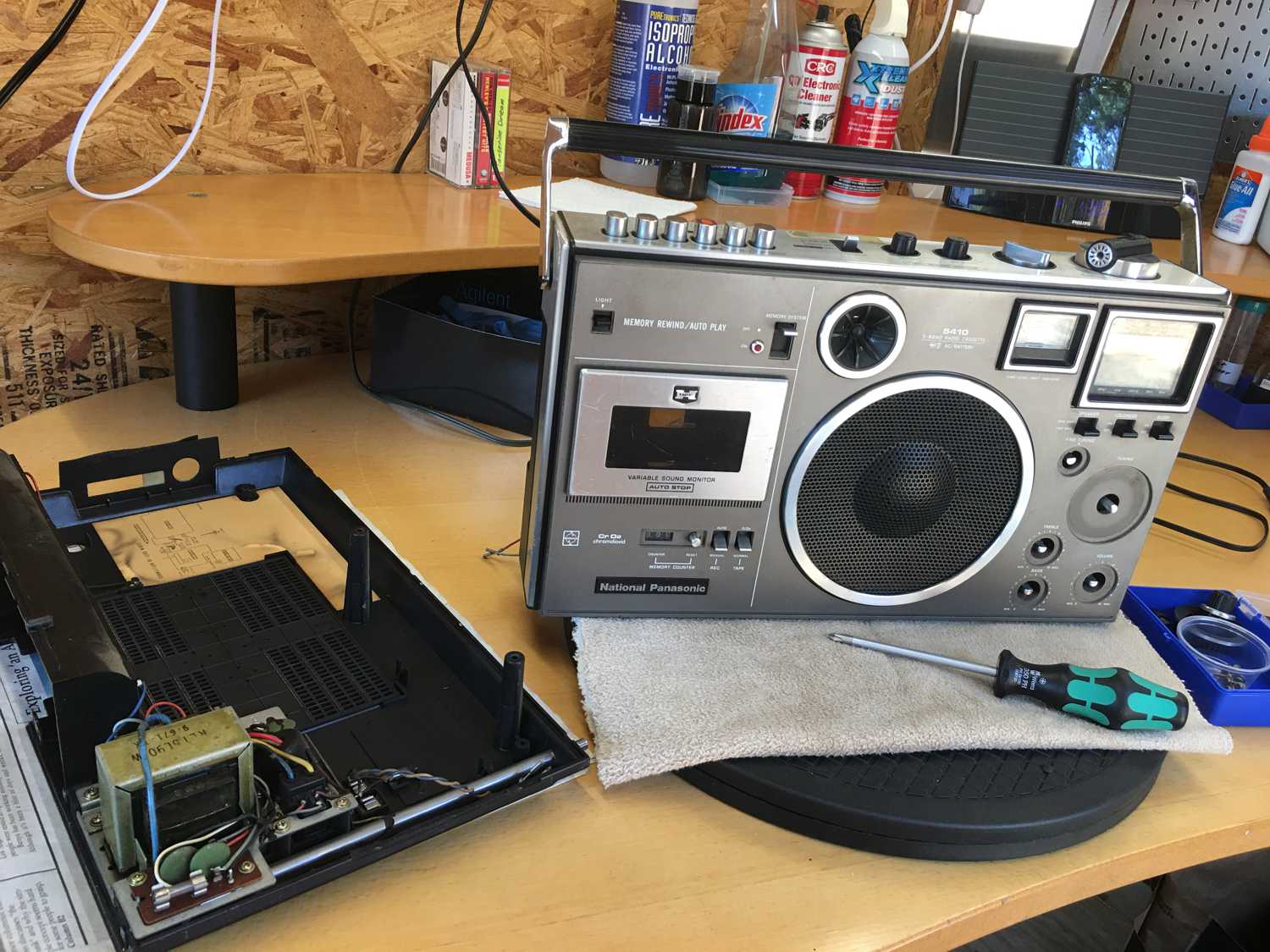

    Until fixed, I use this beautiful RQ-568:

    The RQ-568 is the other one on my short list along with Sony CF-490 / 495 or CF1990. RQ-568 has a big 6x9 speaker according to the youtube video where the guy takes one apart. Comments on this forum and "that other boombox place" say it is among the best few Mono boxes. So what does it sound like Jorge? Can you try and describe the sound range and bass response? As for the 5410, I am disappointed to read it is still in pieces :shakehead: you need to get that tuned up and restored asap and post a thread about it here on the forums :biggrin:
    EDIT: As for JVC RC 550 my interest is in total speaker replacement, as others have done, plus installing a polarity reverse switch for the midrange (if I remember right) that is wired in reverse that you alone seem to have discovered and documented.

    @Hyperscope - RQ-568 deserves its own thread here at S2G, I will definitely post my resto efforts once final glitches get polished-out! In short, it is NOT RC-550! but on the bright side, it is manageable/portable even after a (more than a) few beers ;) Nothing special about its bass, but whatever is there is more controlled than I would expect from a bbox. One of the reasons (apart from presumably half-decent amplification) is that the 'baffle' which is just rather thin plastic front of bbox is also reinforced by the backside. Driver's magnet is pushed from behind by a rubber piece. Still rather iffy support for a bass driver, but better than what you have in most other b-boxes:
