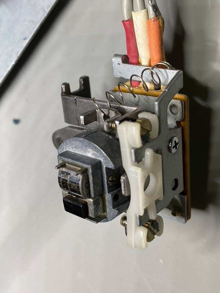

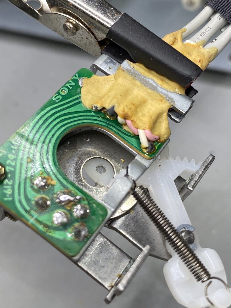

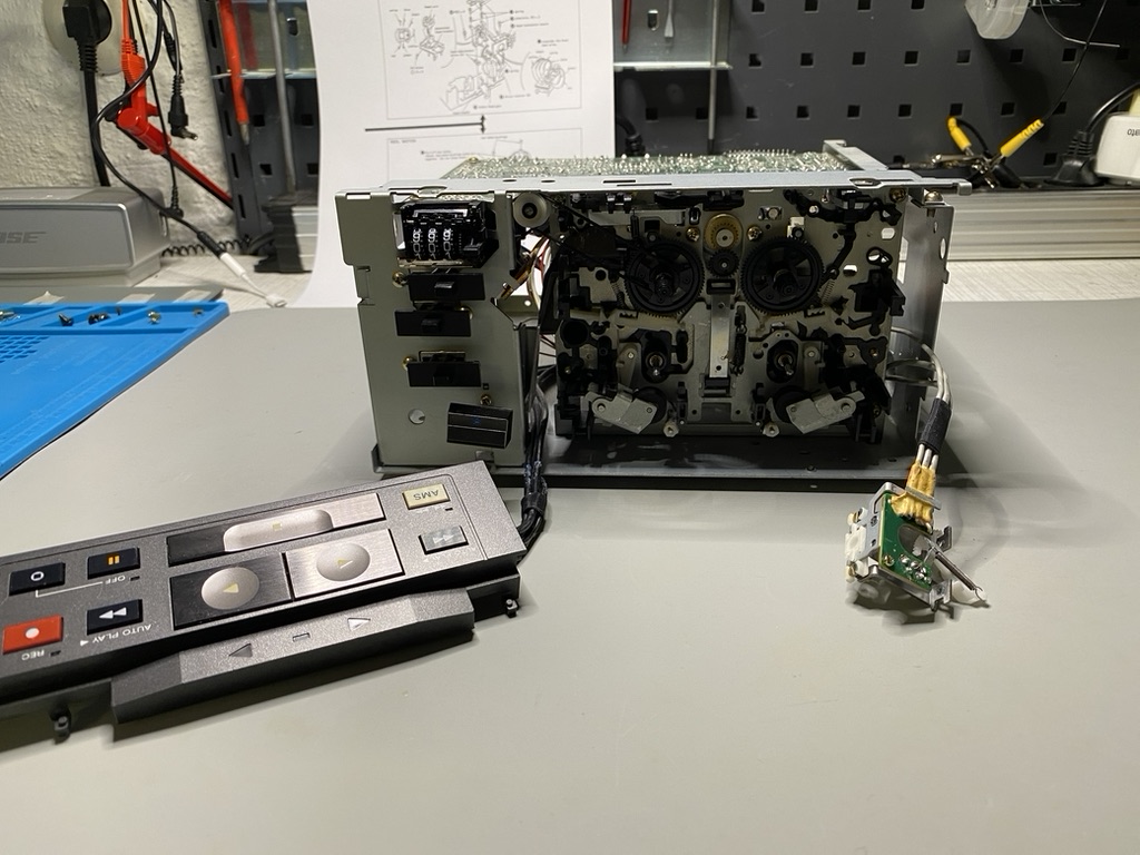

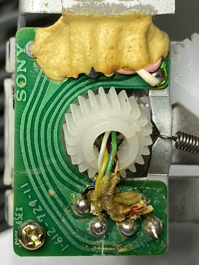

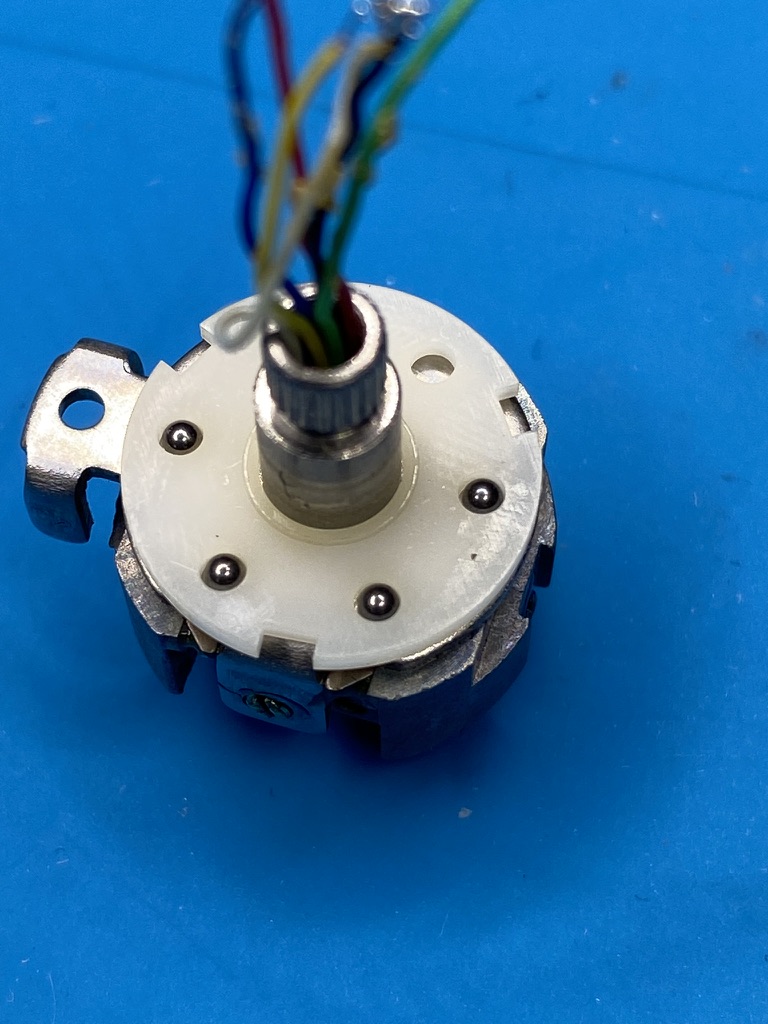

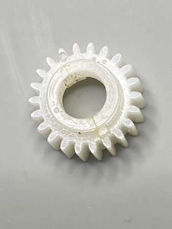

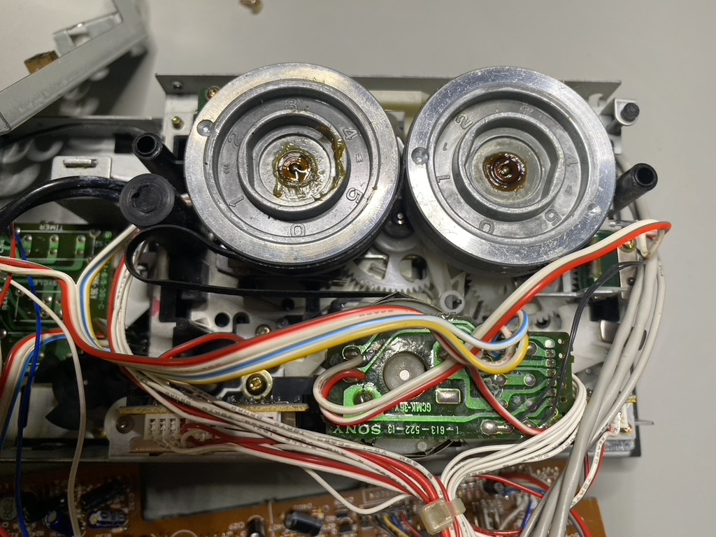

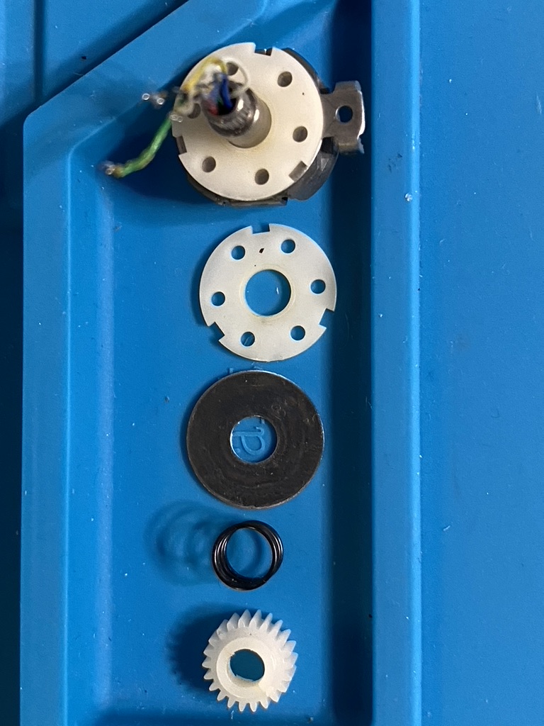

Hi, I post this as it might be useful for others trying to fix the same thing. This is not the right way to do it and maybe others can avoid some mistakes Primary I thought this would only require changing belts so that was what I started with. Removing the old belt was a hurdle. The belt was nice and dry but after removing the belt there was something left on the flywheels that I can only describe as someone trying to superglue the belts. I tried all solvents I had at hand but nothing worked. Ended up screaming carefully with a razorblades for quite some time. With new belts I discovered that the head would not go up against the tape and would not spin when changing direction. This turned out to be a cracked gear: Taking it apart all those very tiny metal balls came out... My plan was to increase the whole in the gear and then glue it onto the shaft. It was however very tricky to put everything together without those tiny ball running away. In the end I managed to get everything together and glue it. Later I discovered that the crack had expanded and where on the side the connecting gear would connect and the turning of the head would not work properly. As it was now all glued I decided to give up on autoreverse and fix the head. I removed the part that turned the head and put in a spring to hold the head in one direction while still being able to adjust azimuth: That worked great and it now plays well and has great sound. Funny thing if I press autoreverse the tape will now play backwards instead Anyway, I'm happy with the result but I think I could have avoided losing autoreverse if I've been more careful to position the crack of the gear away from the connecting gear.

Just a note, I got another FH-11 that I also fixed. In this the autoreverse worked fine for a while but then the cogwheel for the head cracked in the same way as i describe above. I recon I could have saved myself some trouble if i glued it in place before cracking but now i have to dismantle it. I guess this is a common issue?
