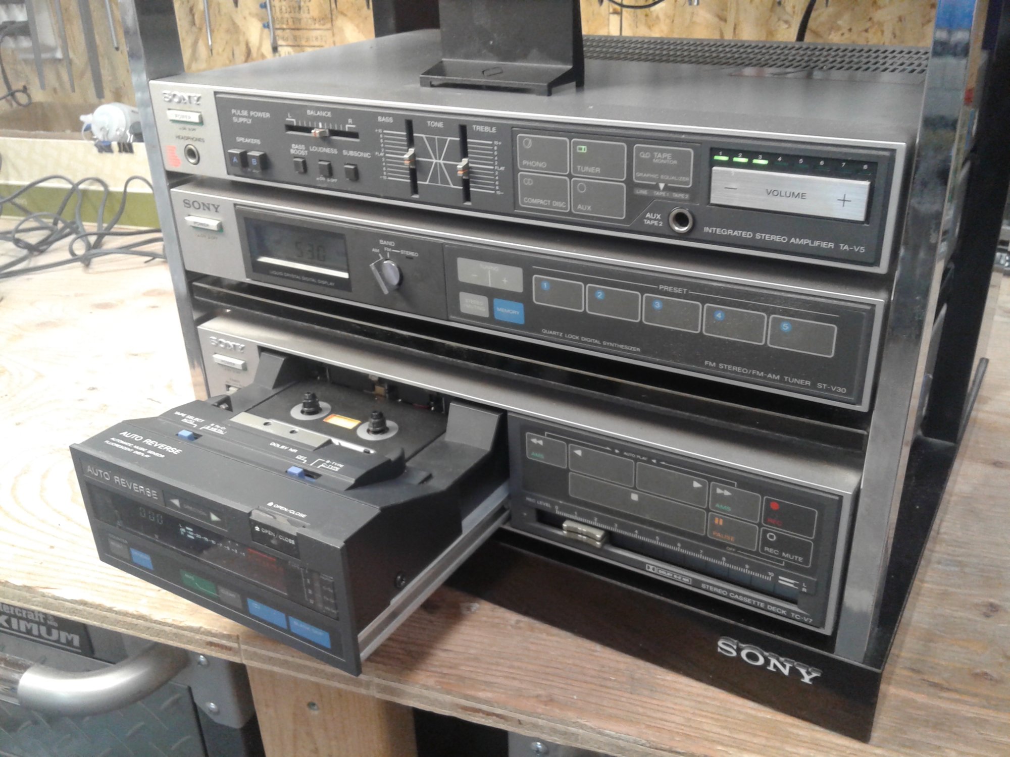

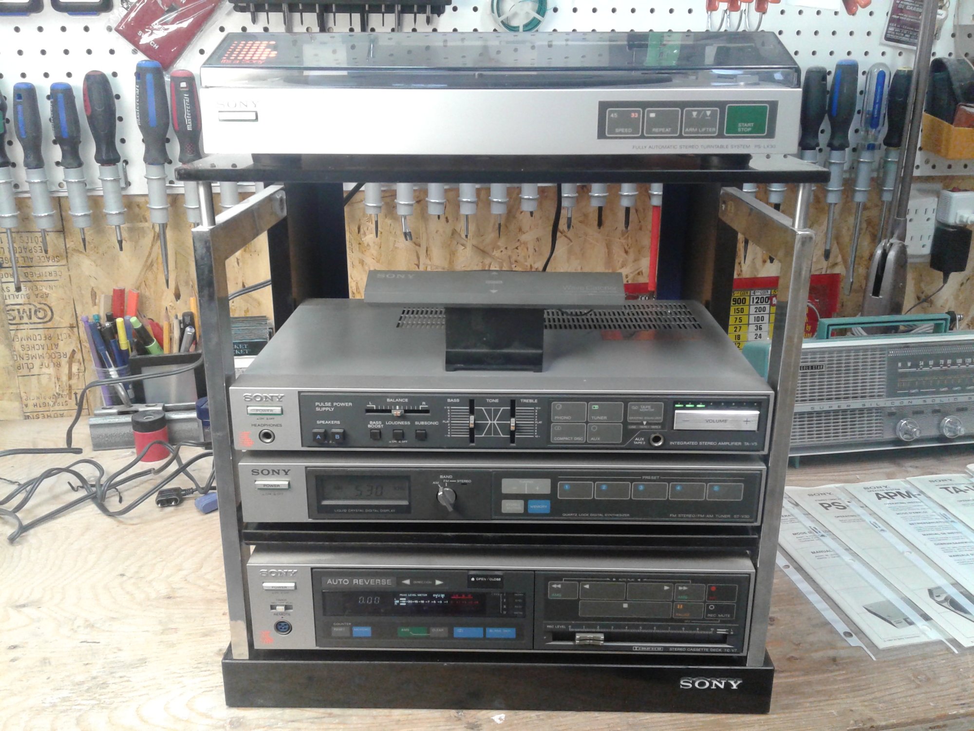

    Hi. I bought this complete system today for $40 locally. I knew the deck would probably need TLC like new belts. As suspected, play, FF, and rewind does not work. I can see that the spidles want to work but don't budge. The good news are.... the drawer works pretty good and the mechanism engages good too.
    So my question is... has anyone ever attempted to replace the belts on this deck before? Was it relatively easy enough to do? Were the belts common types. I only tried doing this once on an older Yamaha tape many years ago with success, so I do have some minor skills LOL.
    Would like any comments or advice form you guys.

    Nice! Is there a component missing? It looks like something should be below the TT. That stand is really cool, AIWA was doing something similar, some of these systems went for decent money back then. I'm thinking that since the cassette deck slides, that the belt is nice and accessible on the bottom.
    Sony BBoy likes this.

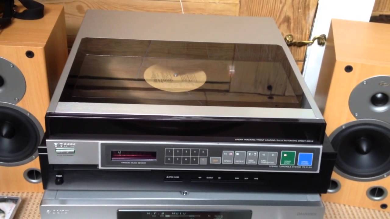

    I was wondering if it is the correct turntable for the system.
    With a drawer loading cassette, you would think the correct turntable would also be drawer loading (one of Sony´s specialities).
    https://www.vinylengine.com/library/sony/ps-fl77.shtml
    Good luck in finding one of those for $40 though.

    Thanks Mister X. The space is probably for the matching equalizer, which I will look for. I see them often enough on eBay and other means. I have an early CD player that will fit in there too. It doesn't have the cool soft touch pad controls. I will see about what you said about the belts being accessible from below?
