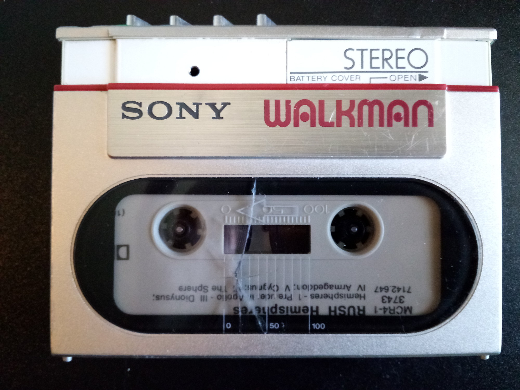

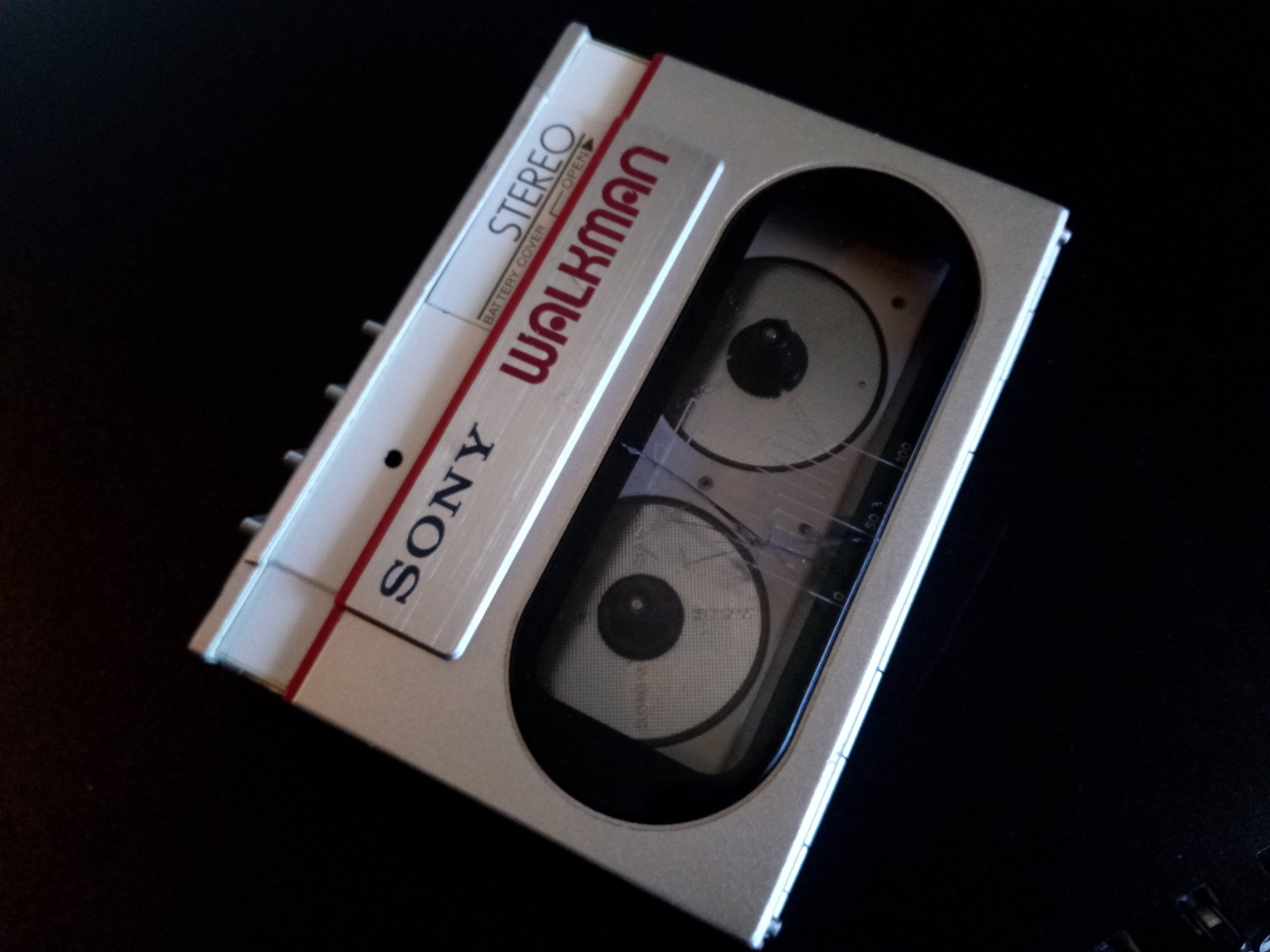

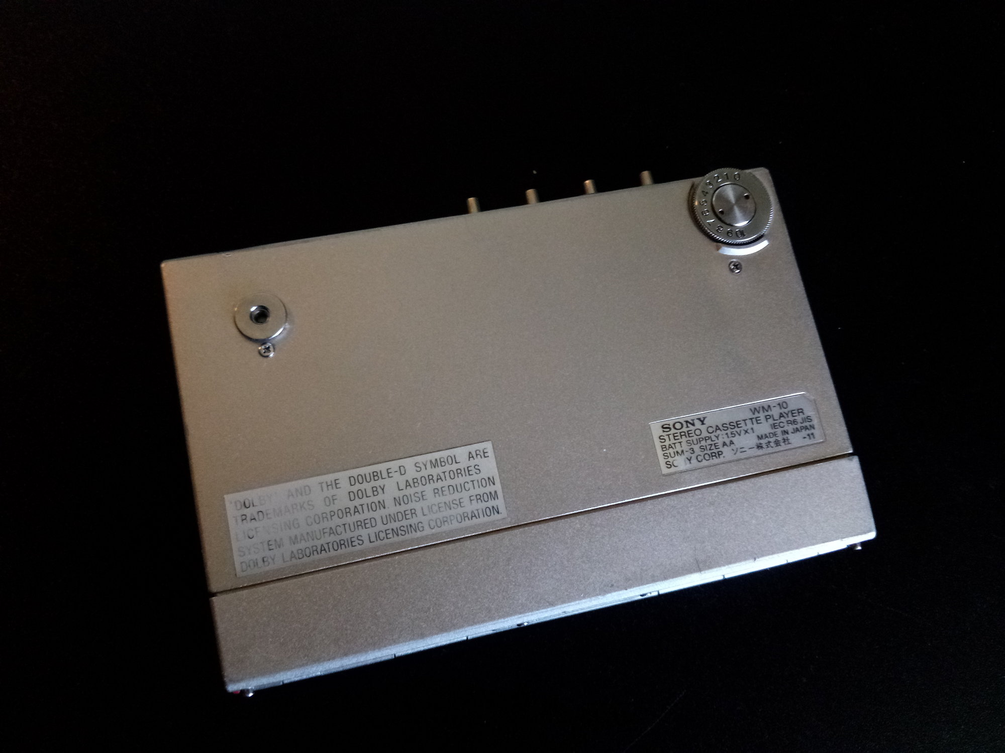

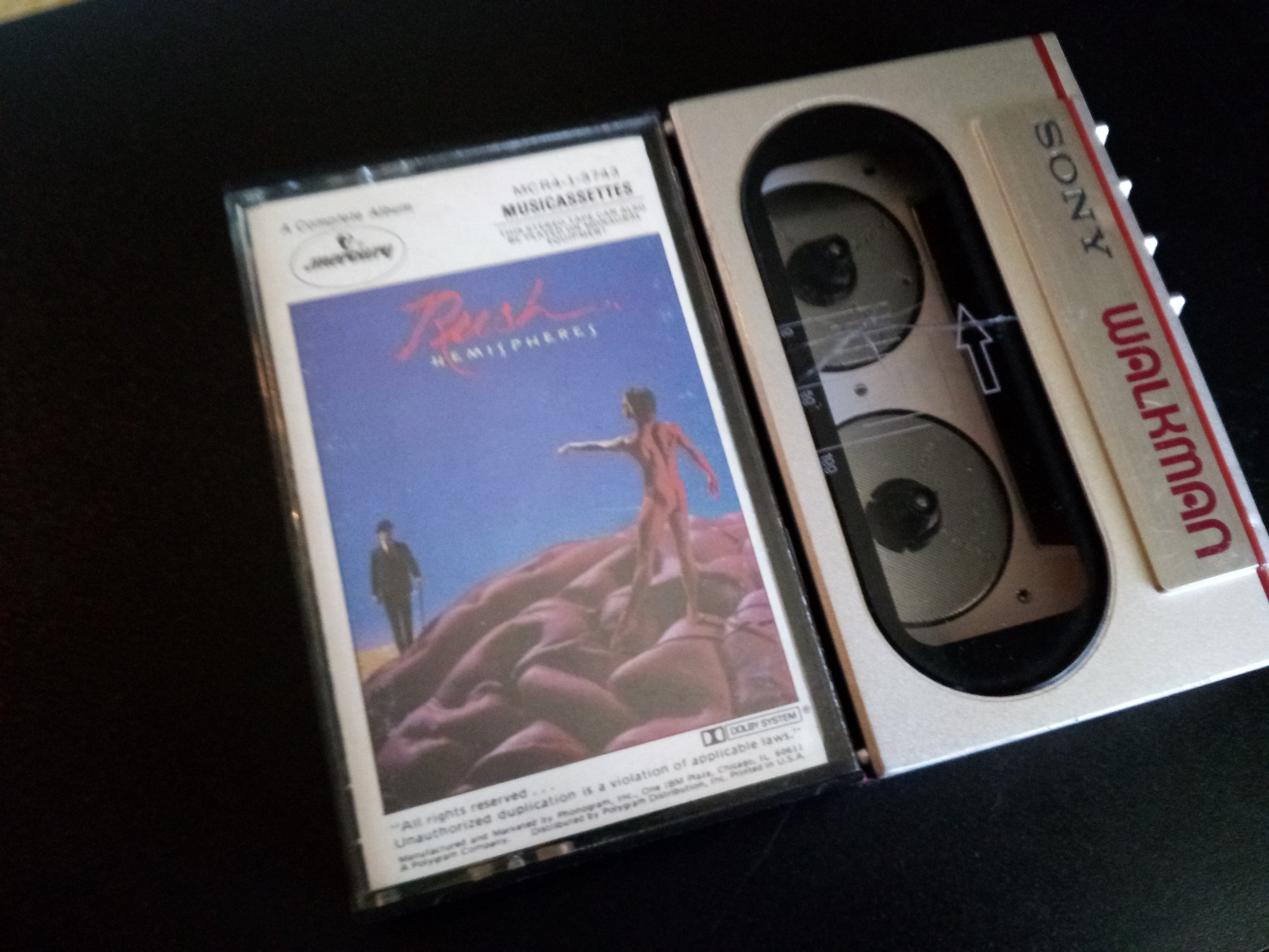

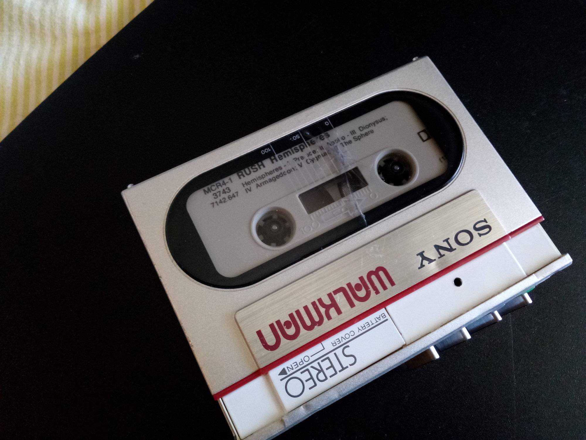

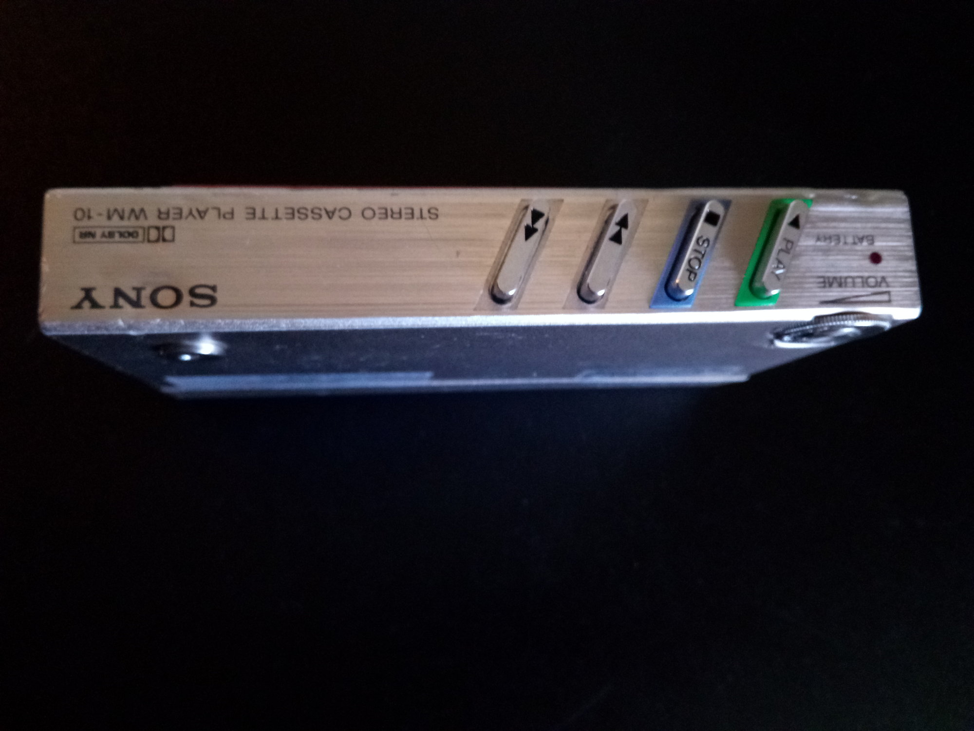

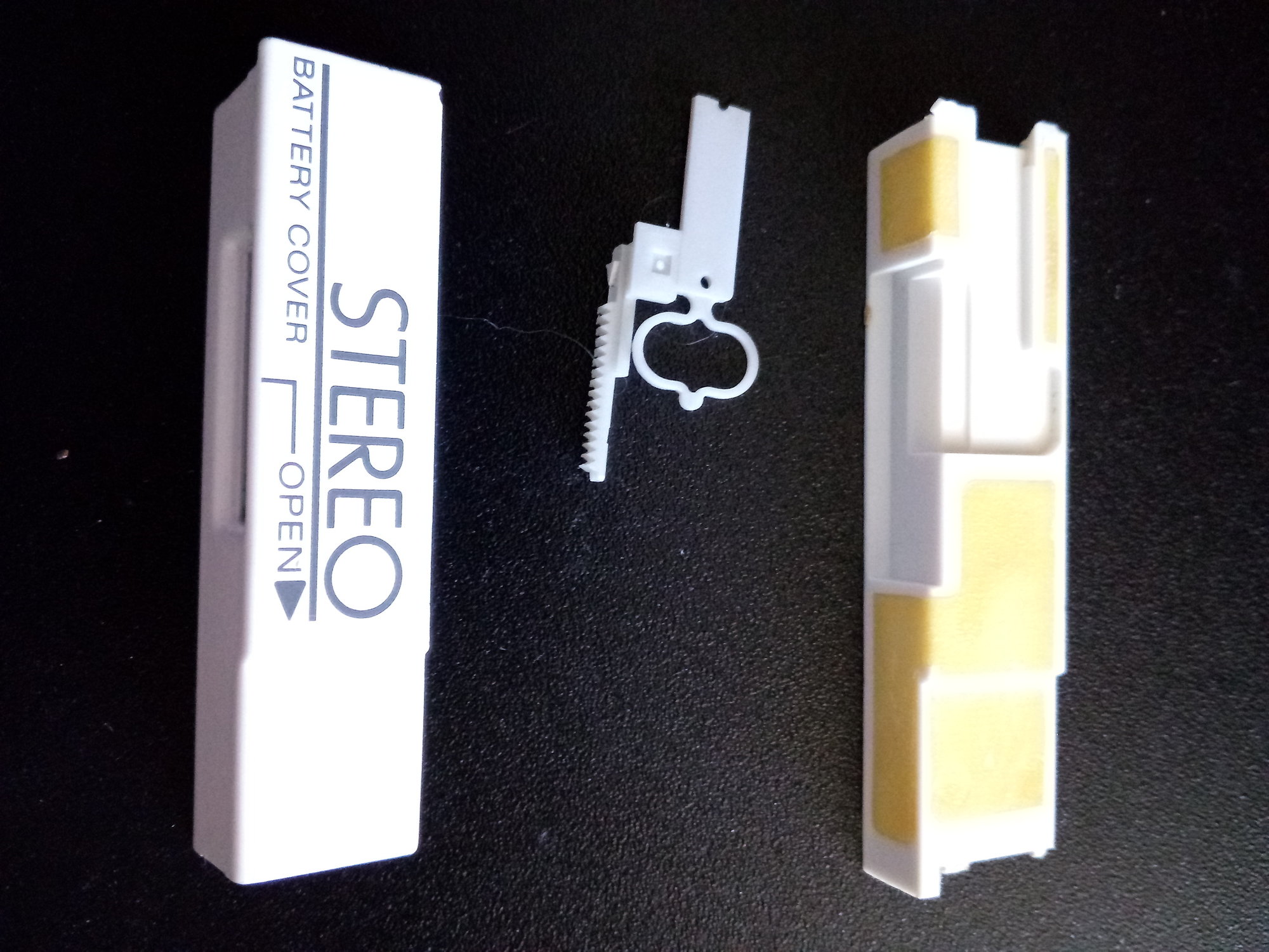

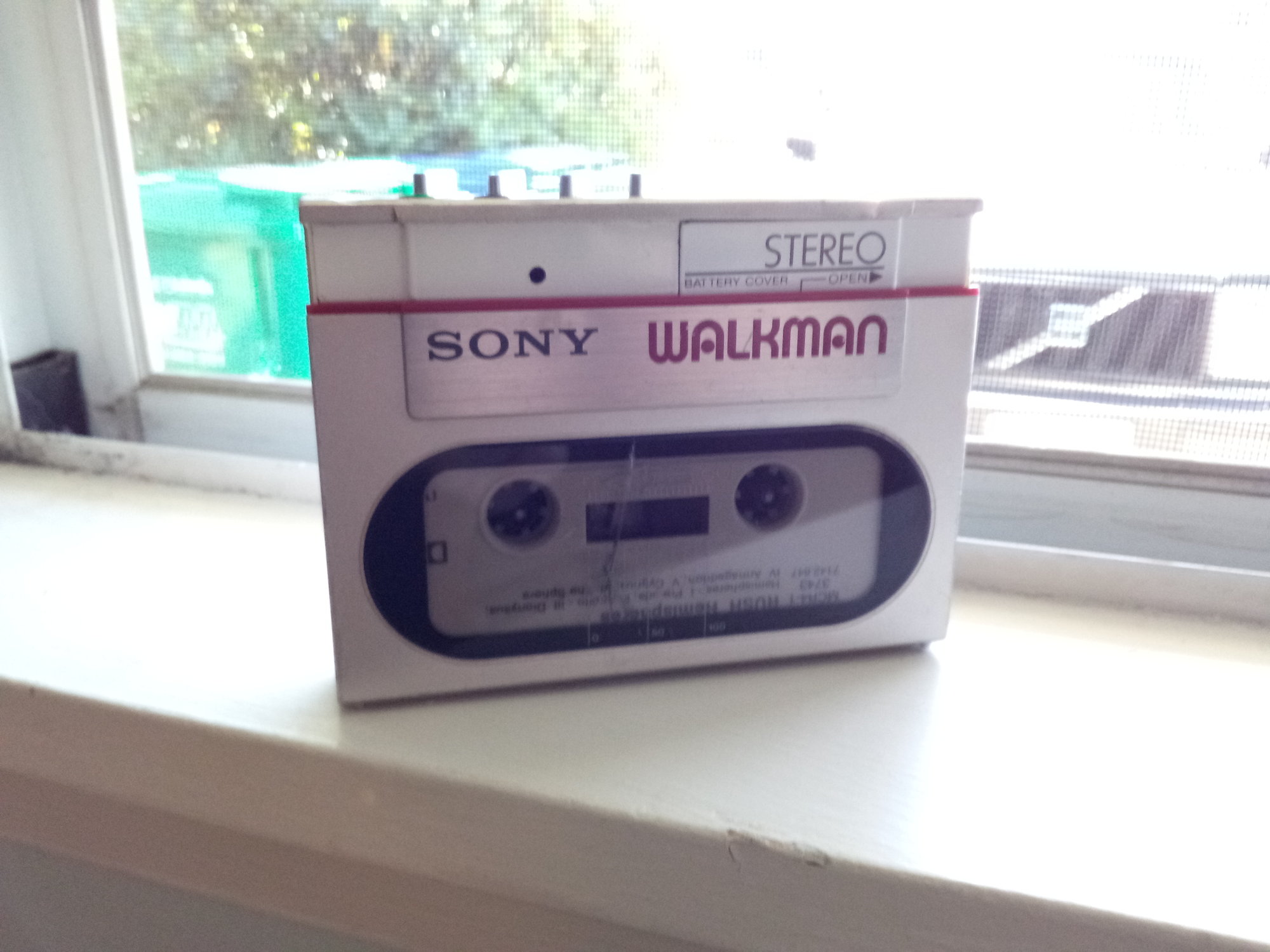

    Hello! I've never tried taking photos of my Walkman's, But I thought I'd give it a shot. My WM-10 isn't in great shape, but I very much like it still. I got it to the point where it is somewhat working but it has a few mechanical issues still, and plays way to loud even at the Zero position on the volume knob. any advice on what is wrong would be of great help. Anyway here are the photo's IMG_20180617_113243.jpg I glued the window back together but still has a bad crack
    IMG_20180617_113259.jpg IMG_20180617_113308.jpg IMG_20180617_113336.jpg Size comparison next to one of my favorite tapes IMG_20180617_113552.jpg the battery lid has a broken latch and fell out while I was holding the Walkman and it just fell apart when it hit the ground. Interesting mechanism though... IMG_20180617_113445.jpg IMG_20180617_113509.jpg IMG_20180617_113523.jpg Definitely one of best looking Walkman's ever made in my opinion.

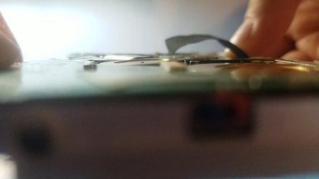

    Open it up and see if the noise is coming from the smaller wheel which I believe controls the play/ff spindle. It's a common issue I've heard. If the walkman gets squeezed to hard on the back it becomes lose causing it to wobble and the belt tilts it causing it to scrape against the back and one of the small white gears under it. This can be fixed by putting a pad under the wheel to level it out and a pad on the back (the shell) to be safe. I'll attach a picture of what it mine looked like tilted. Although yours sounds to be way worse to the point of it not turning.
    It is currently sent out to someone to be fixed. (Vosscollectables on ebay). I sent him my broken silver and red wm10 a while ago and he tried to fully repair/refurbish it for 80$ but he ended up offering me another unit that was blue and gold but in way way better mechanical and cosmetic condition than mine. In mine a battery desintigrated the electronics. Looked like the battery was in it since it was made. So he sent me the other one in fully functioning order. However in transit something must have happened causing that wheel to become lose. So he took it back free of charge and is going to send it back to be again within the next couple of days. Here are some videos. One that I uploaded of the noises and two of ones he uploaded after he did the pad repair thing.
    So since yours is having mechanical issues he should have parts for it from the electronically fried one I sent him. I highly recommend him if you resort to sending it out. I basically got a almost mint wm-10 for about 200$, (including shipping and the price I paid for the red and white one)
