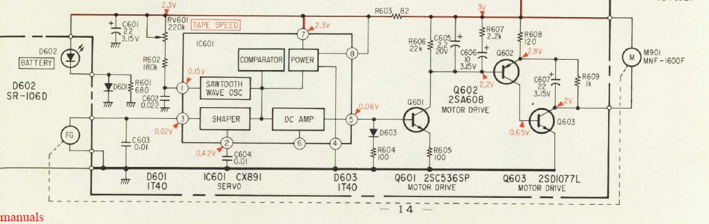

  12. Valentin
    1,527
    @Kili1234 I suggest creating a separate thread for the AIWA HS-PX310, as it is less likely you'll get an answer here, because of the keywords used in the title.
    Let's clarify some things regarding this thread: there are 2 different walkmans which people are talking about: the SONY WM-2 and the AIWA HS-PX310. The 2 have absolutely nothing in common, so no point in comparing faults between them.
    The pictures above are from the AIWA which uses a typical AN6612 motor governor IC. What I can tell about it, is it's susceptible to reverse polarity and the motor won't run at all when that happens (assuming everything else is ok).
    A motor running all the time would point to a shorted drive transistor or maybe even the leaf switch staying pressed all the time.
    The SONY WM-2 uses a very different servo circuit (with feedback from an FG coil), using a custom SONY IC (CX891).
    In the case of the WM-2, the IC is powered through an 82 ohm resistor, so it has some protection against reverse polarity, don't know if enough not to burn it.
    In the case of WM-2, start by checking the voltages that are marked on the servo schematic.

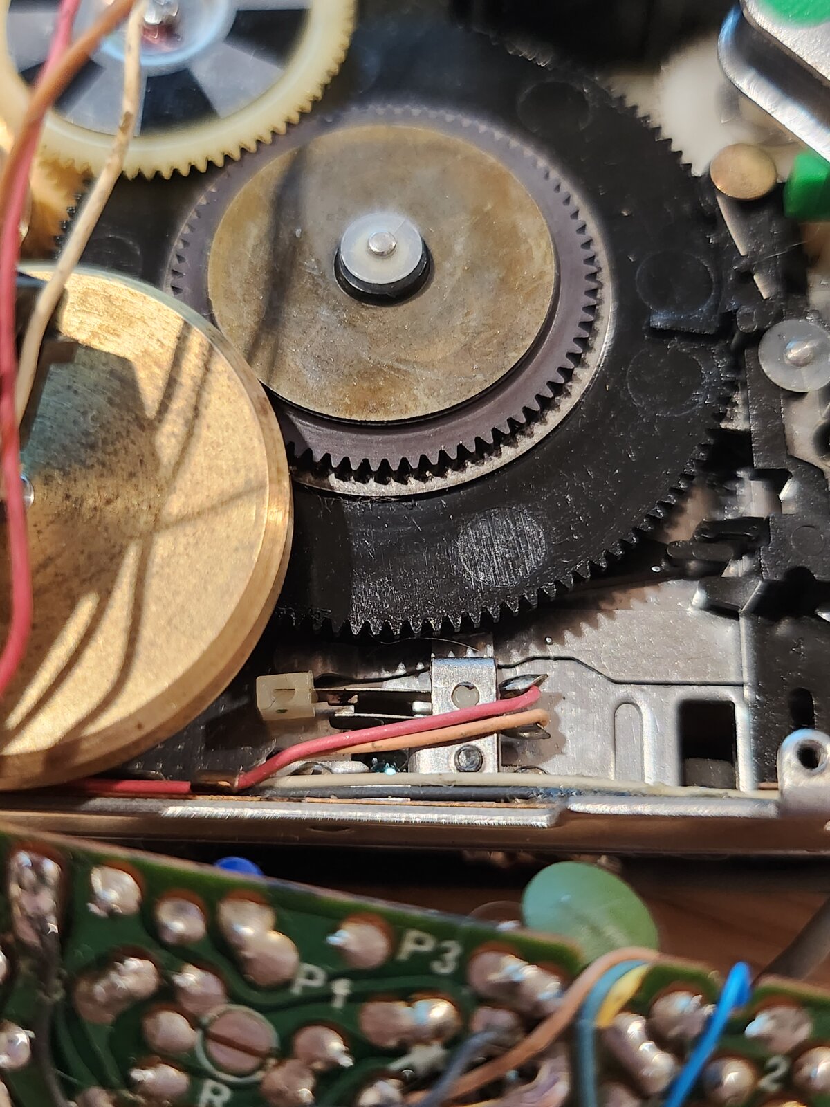

  18. Cassettecat
    Cassettecat Member
    31
    New York
    Hello! I'm having the same issue with my wm-2 motor running. It was fine and then all of a sudden it won't stop running and the volume is incredibly low. I've checked all the electrolytic caps and they are within range. What else can I check? There's no flickering of the led and no pinched wires.
  19. Valentin
    1,527
    Capacitors are not going to cause such a problem, even if they were to be bad (which I don't believe they are).
    The first thing I would check is the leaf switch (S901), maybe it stays engaged all the time. Note that the auto-stop mechanism not moving freely may also cause the leaf switch to stay pressed.
    Given one of the levers in this mechanism also engages the leaf switch, this can be a suspect even if the latching problem does not occur.
    Link here: https://stereo2go.com/forums/threads/sony-dd-series-play-ff-rew-buttons-not-latching.7524/
    The fact that volume is incredibly low may or may not be related to this problem. Does the volume change when rotating the potentiometer or it stays at a fixed level ?
    Is your current draw within specified values ? It should be 115mA during PLAY and 120mA during FF/REW.
  20. Cassettecat
    Cassettecat Member
    31
    New York
    Thank you for the quick response.
    I am looking now and when I press STOP or PLAY there is no change in the leaf switch. It only changes when I press REW/FF. I have attached a photo.
    The volume does change when rotating the potentiometer, yes. It goes from not audible to very quiet. I don't think the pot is the issue because when I initially was working on it, that was the only issue and I fixed it through cleaning and reflowing solder points. This issue only came up when I reassembled it for what was supposed to be the last time :(
