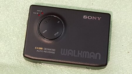

Hi all, My Walkman is struggling to play side B (as in when the side B LED is on). I can hear the poor thing slowing down playback and the LED even fades a little bit. Inside, the motor seems to be turning at the same speed no matter which side is playing. New, fully charged battery does not help. The tape is not heavy to turn or anything. Tried with several good tapes. Flipping the tape and making sure side A LED is on is the only way to listen at normal speed. Belt is new. Bought it from DeckTech on eBay for my model. Also replaced the pinch rollers. Capstans are clean and straight. No distortions or any issues whatsoever when playing with side A LED on. Not sure what is going on. Any ideas?

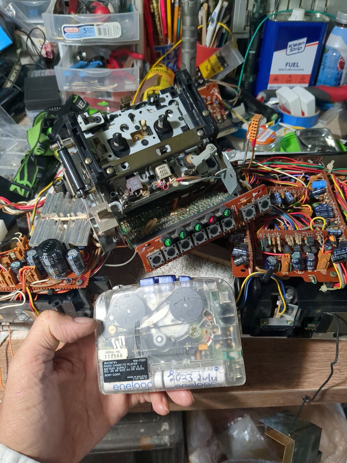

Yeah the standard usual you know. Take it apart. Service it. Clean it lubricate it put new belts in you know something like this picture here you know. Get all intimate with it. Here's a picture. Maybe not exactly what you have because I don't know what you have because all I know is some model numbers. I'd have to go search the internet to see what it looks like. But here I'll give you an idea as to what I've got and what I'm working on I am holding a Sony wm- fq01 I wish you had posted a picture of whatever a Sony 600 looks like that'd give me a lot better idea how to know what to look for. Maybe I have one without having to search the internet to understand what model it is.

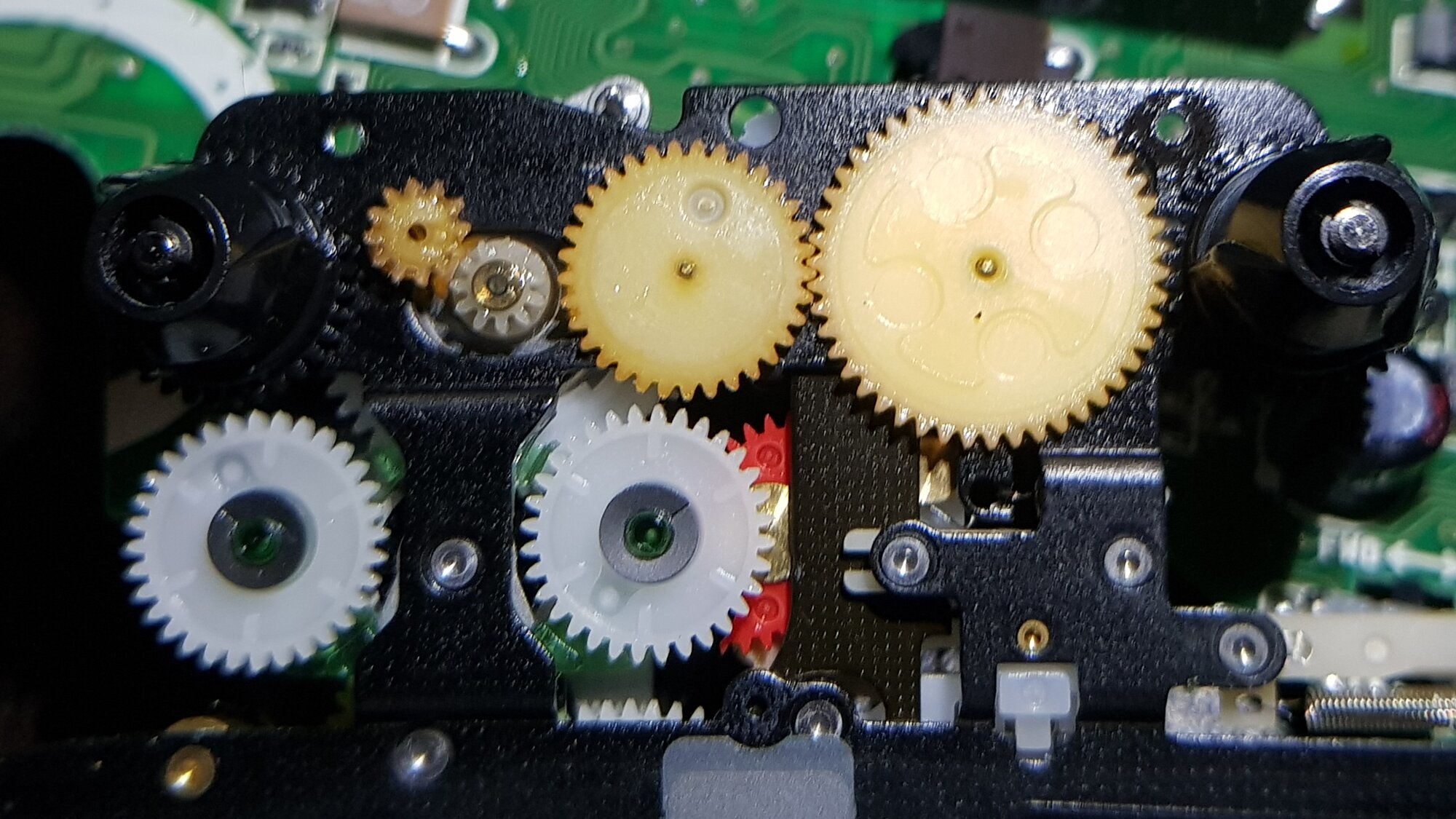

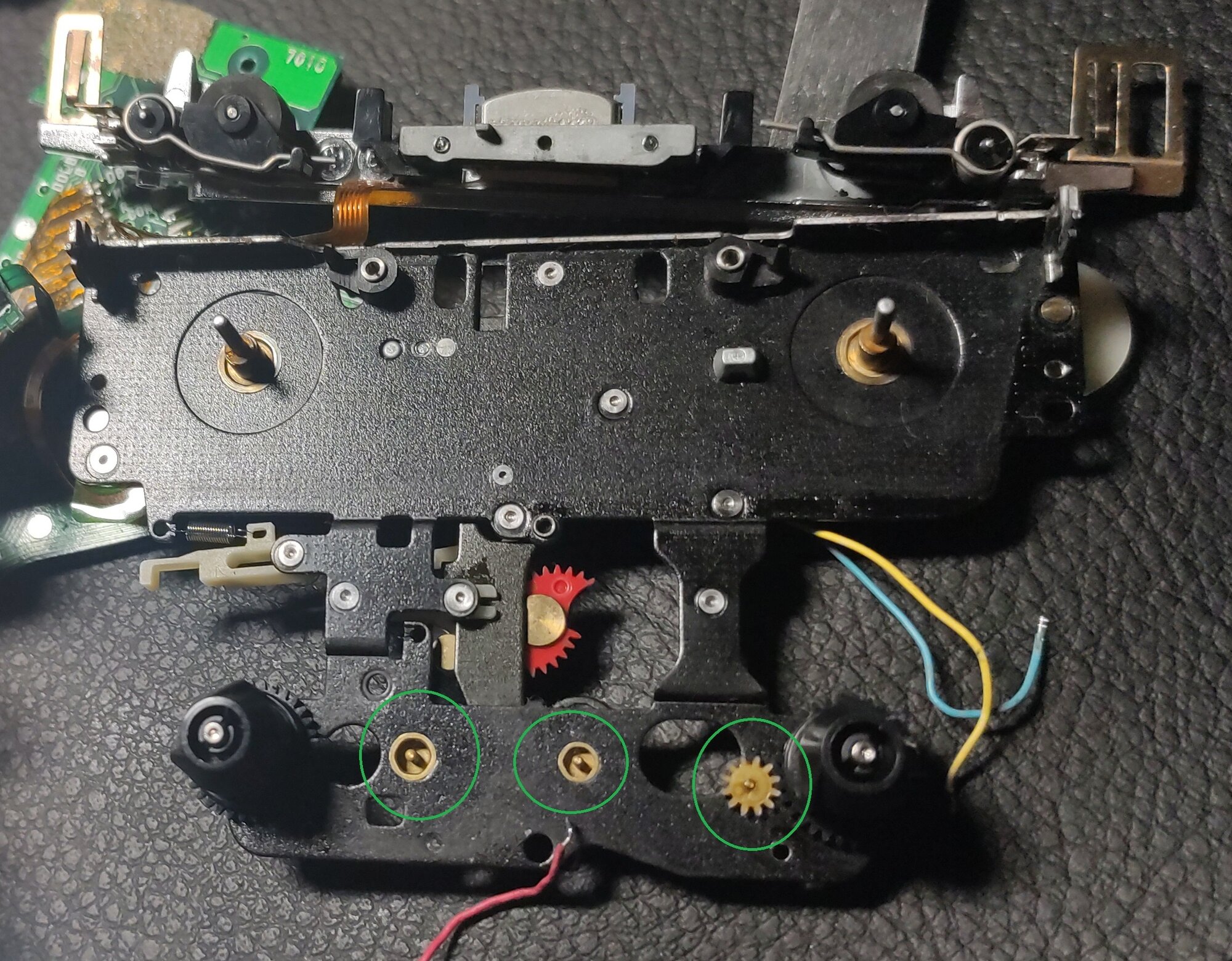

The WM-600 uses a 700 series mechanism, there are 2 things I would check: - do the table reels turn freely by hand ? Old grease is a common problem on the reel gears on these models. See picture attached. - FWD pinch roller is not fully disengaging, creating a lot of drag. The distance between pinch rollers and capstans in stop mode is very small in these units. Does the unit manifest the same problem if you run it without a tape inserted ?

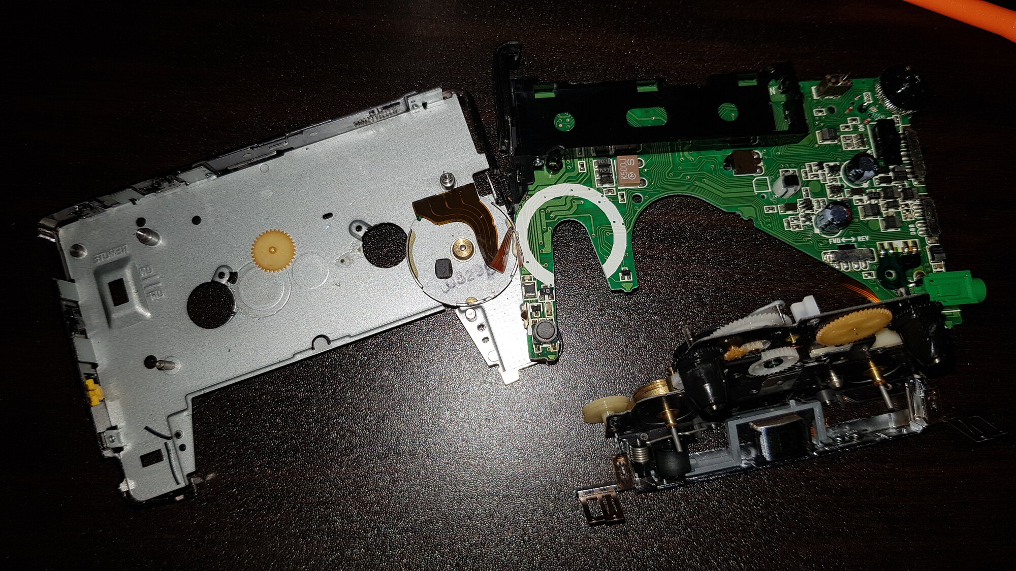

So I took it apart today. It was surprisingly easy. No de-soldering needed to remove the PCB. Thank you, Sony. I cleaned the gears and lubricated with a drop of WD40 using a syringe and needle. That's the only thin oil I have right now. If I made a mistake I will need to revisit it later. I could not remove the capstans. I'm afraid to break something. They are moving freely, however I noticed both have some play in the shaft. There was a small piece of old belt gunk inside the motor casing. Lucky I decided to remove the cover to take a look and found it. The motor is turning free, no noise or anything. I didn't have the guts to try and take it apart though. Used IPA and cotton tips to give all a good clean. See the yellow gears in the picture? They fell right off when I removed the mechanism. They are are not held in place by anything. Is this normal? Lubrication itself seems to keep them in place now. Initial testing looks promising. So far so good. Side B plays just as good as side A.
