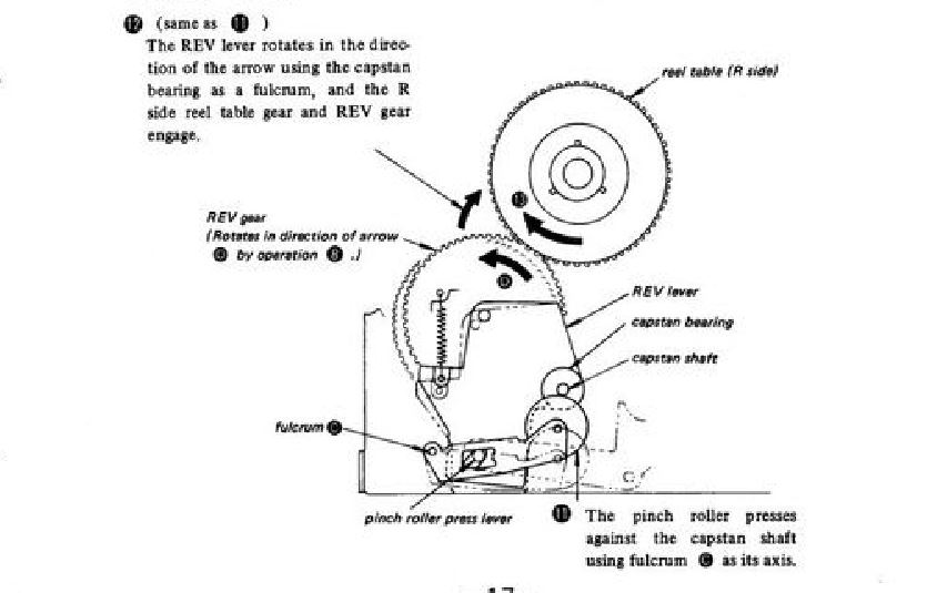

    the pinch rollers on the wm-7 are engaged by the internal switching lever, which is engaged by the 2 worm gears whenever you press one of the directional buttons (you can hear them whirring away when you switch direction)
    might be its not centered in standby, youll have to disassemble it and manually set it to the standby position (ie center it), if that is the cause. youll be able to tell if one pinch roller is slightly engaged when its stopped. though im unsure of how that problem would even arise so its pretty unlikely
    it could also be the worm gear responsible for the other side needs new lubrication as it cant fully engage the lever properly. which is probably the simplest issue to correct here (provided its a pinch roller engagement problem)
    there are also 2 gears inside for the corresponding direction, problem could lie with lubrication or dirt gumming up the gear responsible for whichever side is running slow (if it cant spin the take up reel properly it will slow down, since its driven by a gear underneath one of the flywheels)
    quite a lot of moving parts that could be responsible, plus common issues like dried up pinch rollers, wont be going absolutely everything but hopefully this helps

    The issue can be caused by too little pressure applied to the pinch roller, to the point where the tape simply slips through and all the pulling force is given by the takeup reel instead of capstan.
    Unless you bent some parts during the repair, there's really nothing to adjust. The pinch roller pressure is given by the force of the spring.
    If the lever was a problem, the mechanism would reverse as the mode switch (which is embedded into the camgear) would never go into the fully loaded position.
    You would also hear the motor is struggling to engage but without success.
    Note that hexagons in the reels that hold the clutch get rounded at times, requiring them to be glued;

    The 2 springs are used to move the 2 metal arms into position. Those parts hold an intermediate gear which transfers the torque from the capstan to the reel assembly.
    It's common for those 2 metal parts to get stuck, causing the reel to not turn as I've mentioned before. However you don't seem to have this problem, at least it's not hapenning in the video.
    As for the tape moving up at the pinch roller, that would indicate there's an aligment problem roller not being parallel to the capstan.
